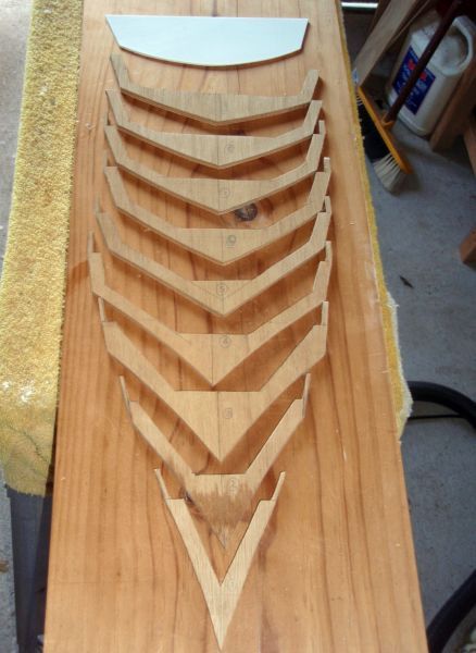

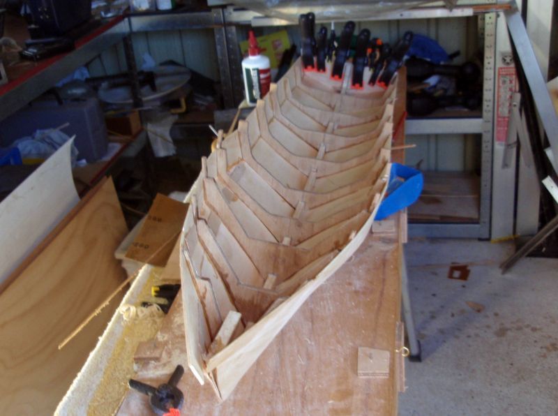

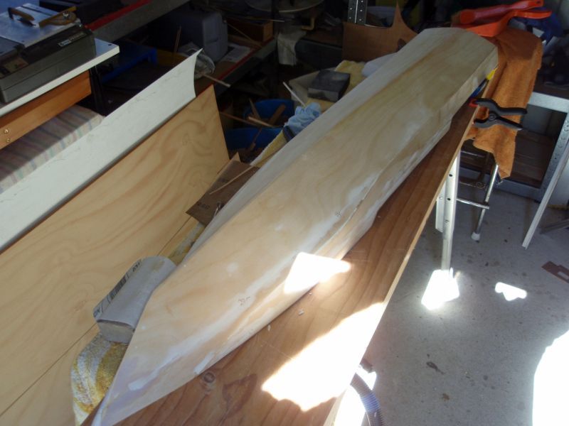

      After about 18 months of thinking and talking about it, much research, and invaluable assistance from a number of very kind people, I have finally started building HMAS Bundaberg. Bundaberg is one of the Armidale class of 14 patrol boats built in Perth, Western Australia, by Austal, for the Royal Australian Navy. All 14 boats are now in service doing off shore patrol work, and have proved to be very popular with their crews. They replaced the smaller Fremantle class boats.
      The model is to 1/50 scale, giving an overall length of 1120 mm, and is built from 1.5 mm ply on 6 mm ply frames, which in turn are mounted on a 7 mm pine keel. I had to plot the frames myself, as the builders were unwilling to part with that information, no doubt worried I would build a full size one in competition with them
      The hull is well under way, and prop tubes and rudder tubes with their associated mountings have been fitted. Following my usual practice, I have built all of these assemblies myself, allowing them to be built to suit the job.

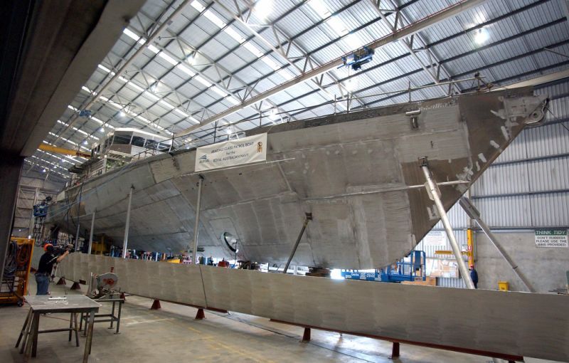

      Some photos below, including one of HMAS Armidale at sea, others can be seen in my albums.

          Hi Peter The new Armidales  look superb and a good subject for modelling . I know Alan Pew  did the Armidale  but I think he may well have had some assistance re- the drawings . I also like your choice of scale , big enough to work any water yet small enough to fit  conveniently  into the back of  the car.   I have been  trawling detail on the Roisin class of OPV , similar in some repects to the Armidale , Both Roisin and Niamh  were built at Appledore  and  like the Armidales would make attractive  larger scale models. Once again Alan has  made a  superb 1:72 Roisin . Good luck with the build.

            Dave, I was in contact with Alan regarding the hull frames. He told me that he was not prepared to pass them on, as he was planning to produce a 1/50 scale hull himself, at some time in the future. This is quite understandable. He also commented that the 1/50 scale would be far more suitable for an RC model than his 1/72 hull, which he felt was too small to easily fit RC equipment into.
            The first time I saw a photo of an Armidale I thought what a good model it would make, as it has pleasing lines, to my eye anyway, and is not too cluttered. Not having built a warship before, I have often been intimidated by the vast amount of detail many of them have, but I was confident I could cope with the Armidale class. The results will tell the tale, though.
            Peter.

              Hi Peter The knuckle  from the bow back looks quite a difficult feature to lift from photos . I’m  keen to see more .

                Dave, I used the side elevation drawing to try and plot the points on the frames, plus I also had some photos from the internet of Armidale under construction. These gave an idea of the shape, but time will tell whether or not I got it right.
                Peter.

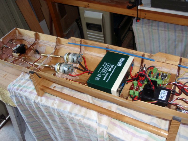

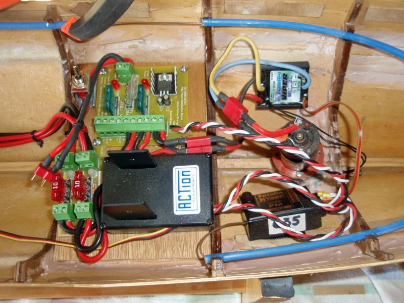

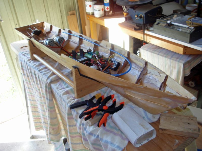

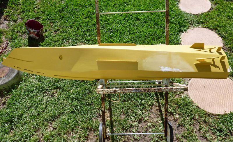

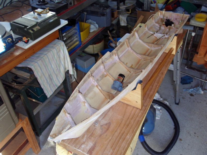

                  There has been slow progress on the build, but I have waterproofed with resin, and installed all the working bits, including the electronics. I have used one of ACTion Electronics amazing P94 units and, with the help of Dave Milbourn’s excellent wiring diagram, I managed to get everything working correctly, including the Raboesch bow thruster. The Armidale class have 5 blade propellers, and I was able to obtain 2 of the correct size from George Sitek, who was most helpful.
                  Peter.

                    Hi Peter question, what type of batteries are you going to fit ? and are you going to fit any additional ballast  other than the battery ?
                    Dave Wooley
                    #22648
                    Peter Fitness
                      @peterfitness34857

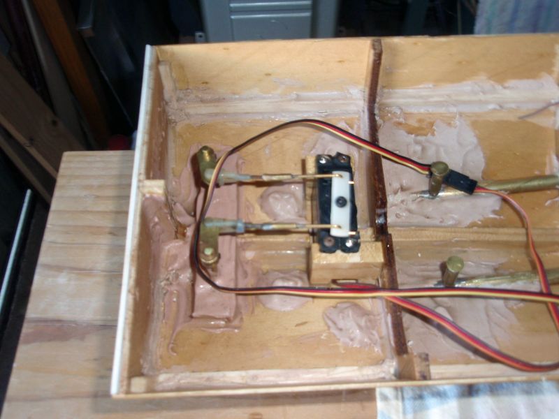

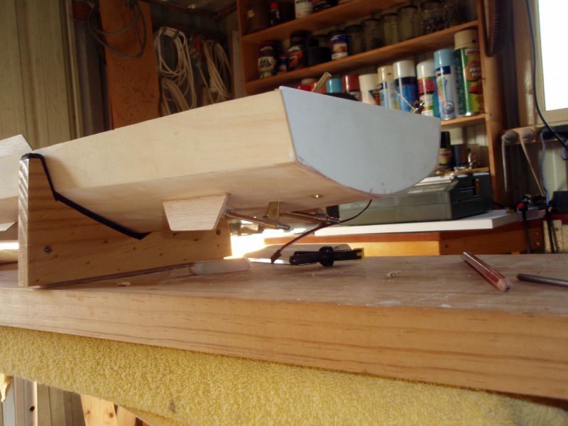

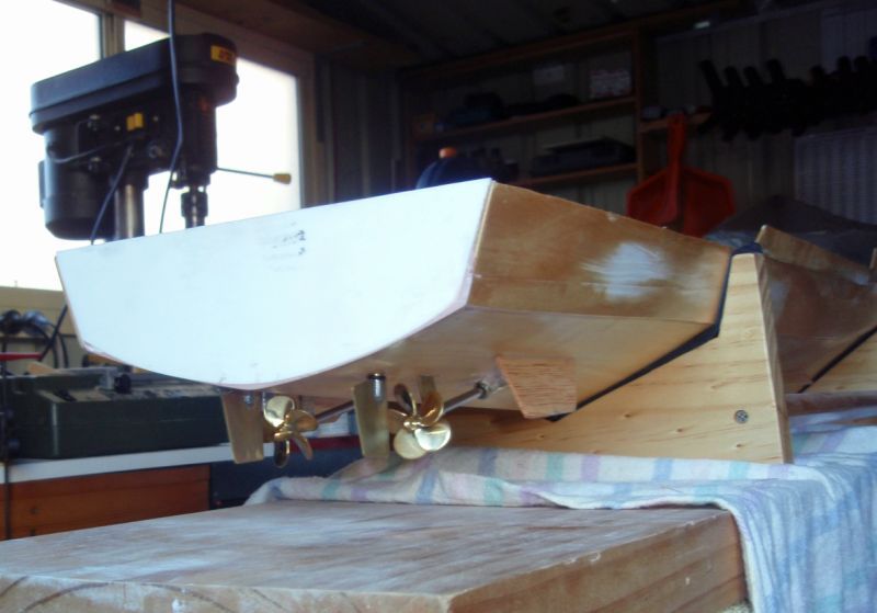

                      Dave, I’ve made provision for a 6v 10Ah SLA battery, so I will have to “suck it and see” as regards any additional ballast. I will be doing a test tank – bath – test to check what’s needed.
                      Some more photos, showing the props and rudders, the rudder linkage, and the battery temporarily in place. The long servo lead wrapped around the rudder posts will be replaced by a shorter one, it is all I have at present.
                      The filler looks a bit of a dog’s breakfast , but at least it won’t be visible when the superstructure and deck is on. It looks worse in photos than it does in real life.
                      Edited By Peter Fitness on 15/08/2009 00:08:48

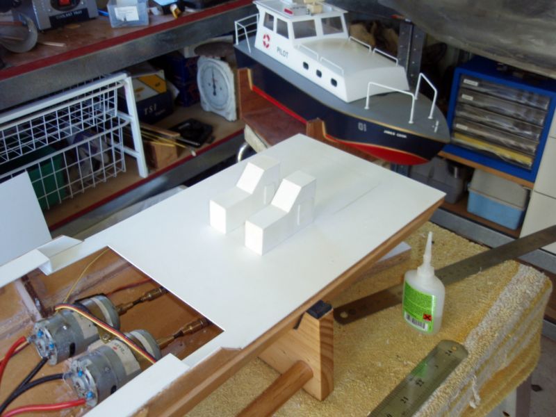

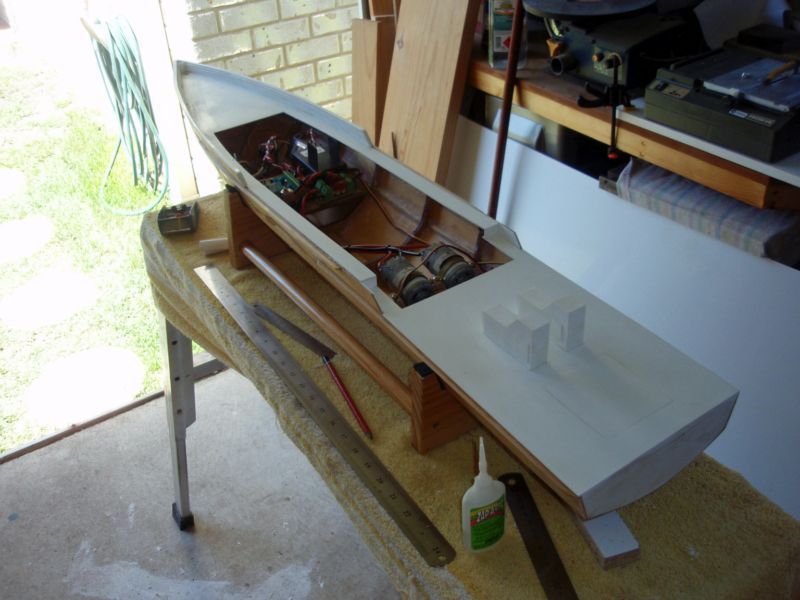

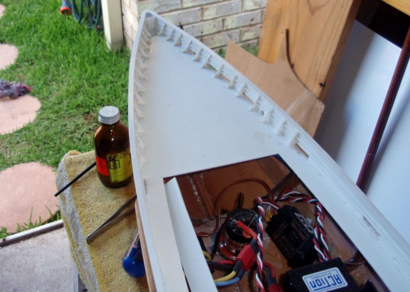

                            After a long break away from my shed, due to firstly, family, and secondly hot weather, I have restarted the Armidale class build. The deck is on, engine air intakes are built, and all the forward bulwark supports are in place.
                            I am now in the process of making some of the deck fittings, such as the anchor windlass and its associated equipment including chain rollers, as well as the anchor. It’s slow work and a number of hours seem to show very little result, but it’s very satisfying producing some of the fitting on my lathe.
                            Some photos of the deck etc below.
                            Peter.

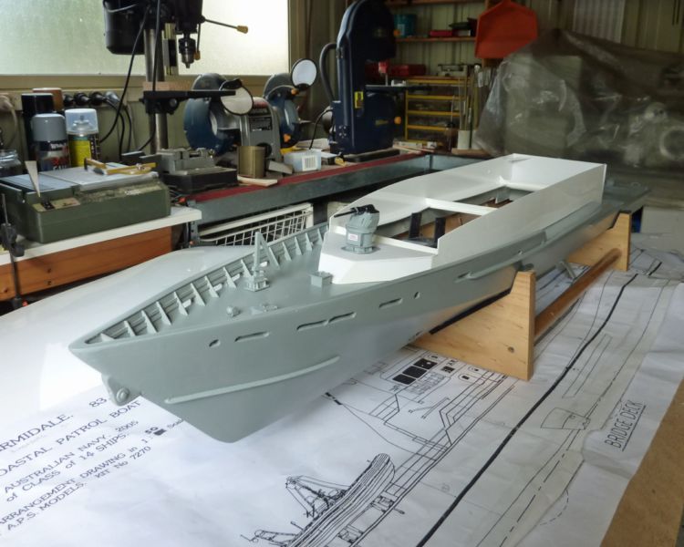

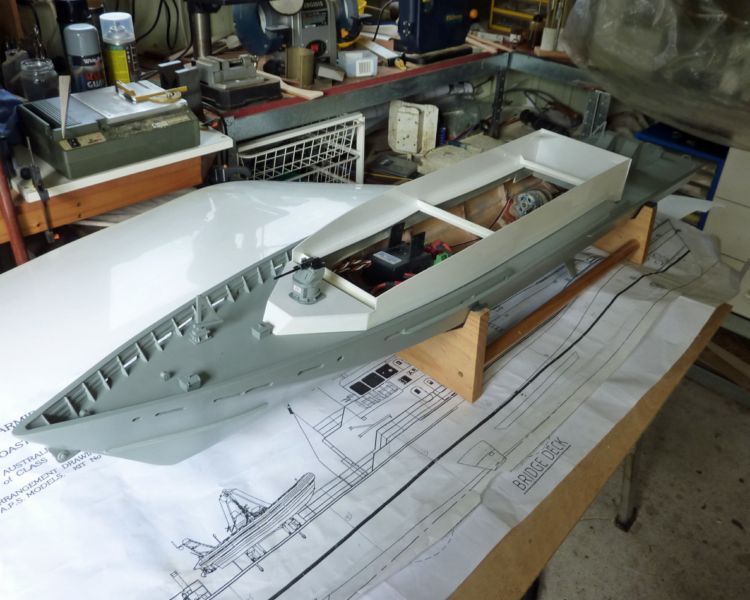

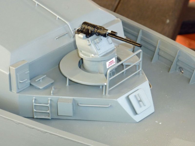

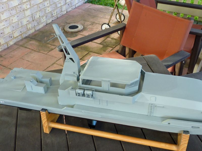

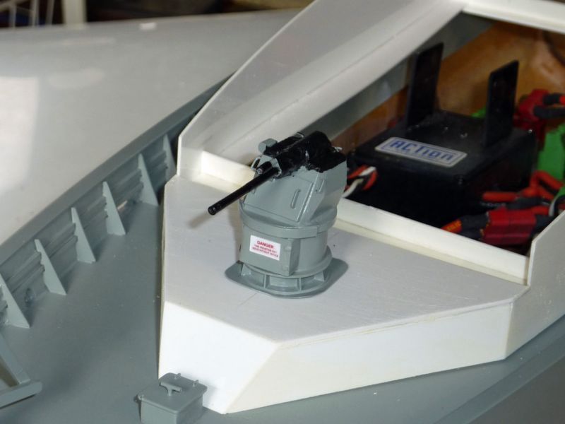

                              Some progress has been made in the last week or so, despite numerous interruptions. The hull has been primed and painted with the correct grey, or as near as I can get it. The hull bottom will be painted plain black with no boot topping, as is the prototype.
                              The Typhoon gun has been made, a little model in its own right, and the styrene superstructure is under way. I’m starting to feel as if I’m getting somewhere now, perhaps it’s the fact that the hull is painted, making it look like a naval vessel.There’s still a lot to do, though, and it will be some time before it gets wet.
                              Peter.

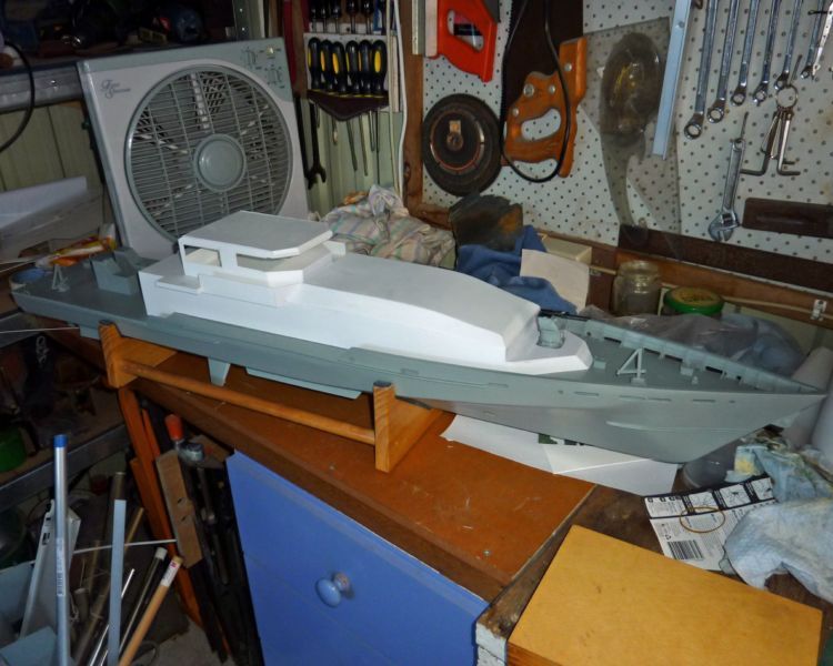

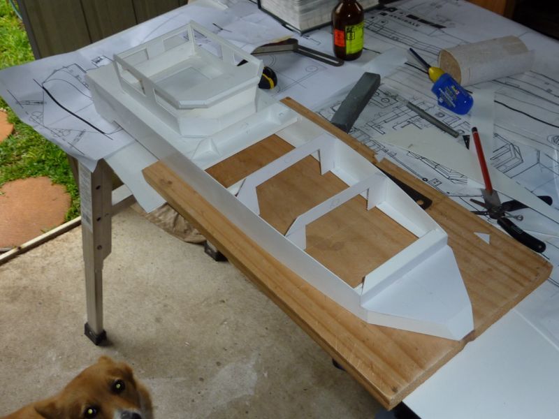

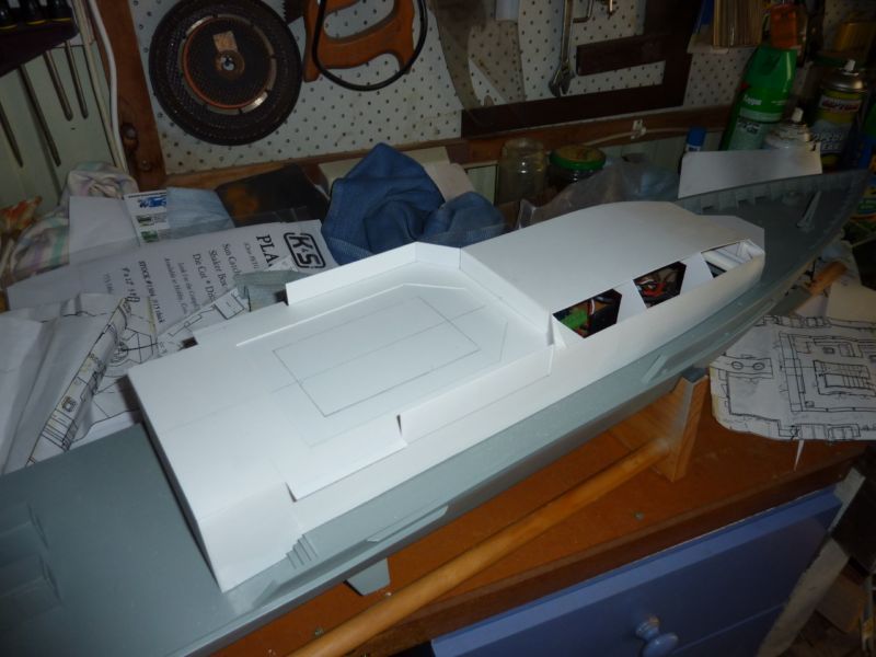

                                  Work continues, with the main body of the superstructure well under way. I’m finding styrene very easy to work with, it’s quick, clean and has a smooth finish which should represent the aluminium construction of the full size boat very well.
                                  There’s lots of detail to add yet, but I’m happy with the way it’s looking so far.
                                  Peter.

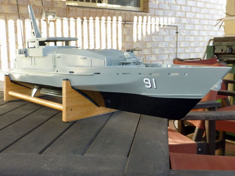

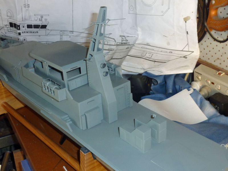

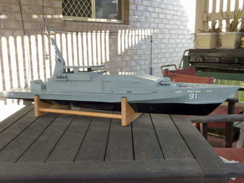

                                            The hull has now been fully painted, and the pennant numbers (BECC) are on. The superstructure has also had its first coat of paint, the mast assembly likewise, although more fittings have yet to be placed on the mast. I still have to make the radomes, the unusual dish shaped aerial and its associated mast, the 2 RIBs and their davits, and the deck has to be painted its final colour. There is also a lot of other detail to be added, but I’m happy with how it looks at present.
                                            Peter.

                                              It is a really nice looking ship Peter. I like the lines of the hull. It will fairly slice through the water and handle quite a chop I would think.
                                              David.
                                              #27340
                                              Peter Fitness
                                                @peterfitness34857
                                                Thanks, David. If she handles a chop like HMAS Larrakia is doing in this photo, I’ll be very happy. Larrakia is the second in the class, after Armidale.
                                                Peter.
