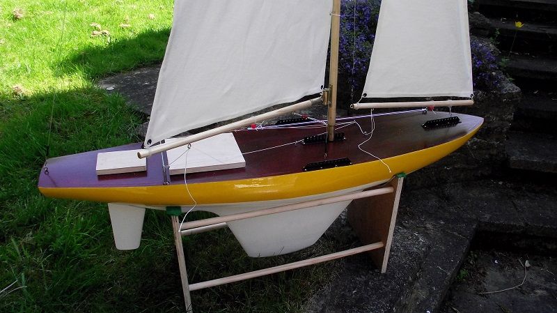

Waiting for the paint to dry on my Ardent I needed something else to do! so the next project was brought out from the corner of the dining room.

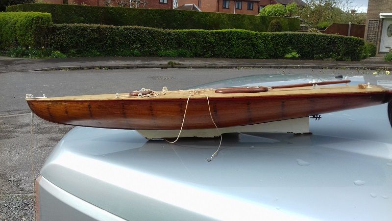

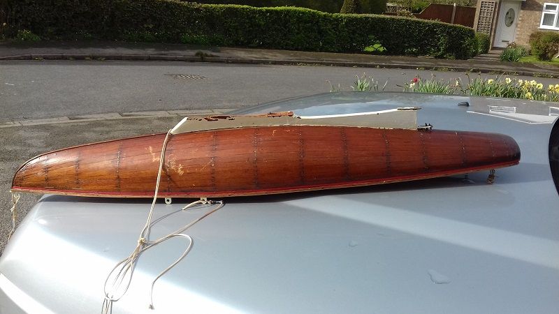

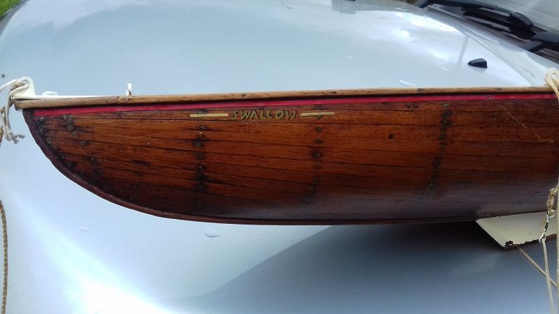

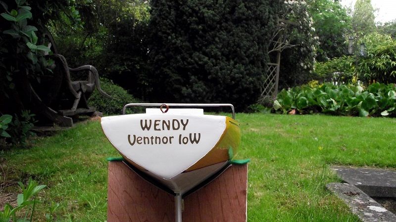

It's my friend from Boston's pond yacht that he built when he was 12 years old, over 50 years ago, he sailed it for about 3 years both on a local pond and on the open sea, often having to have it retrieved by a local fisherman when he couldn't keep up with it in his rowing boat! At that time he was at Ventnor on the Isle of Wight
After that it laid in various sheds and garages until this year when he brought it to me to see if I could do any thing with it, so here goes.

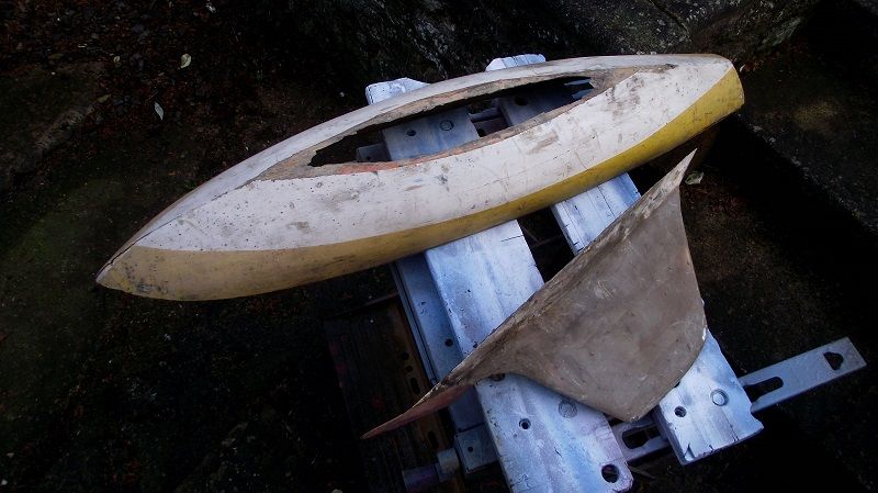

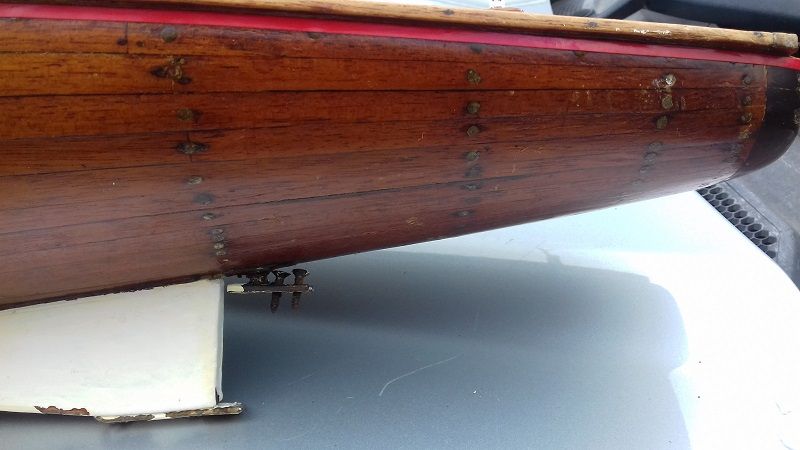

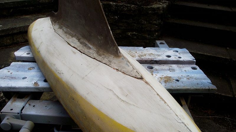

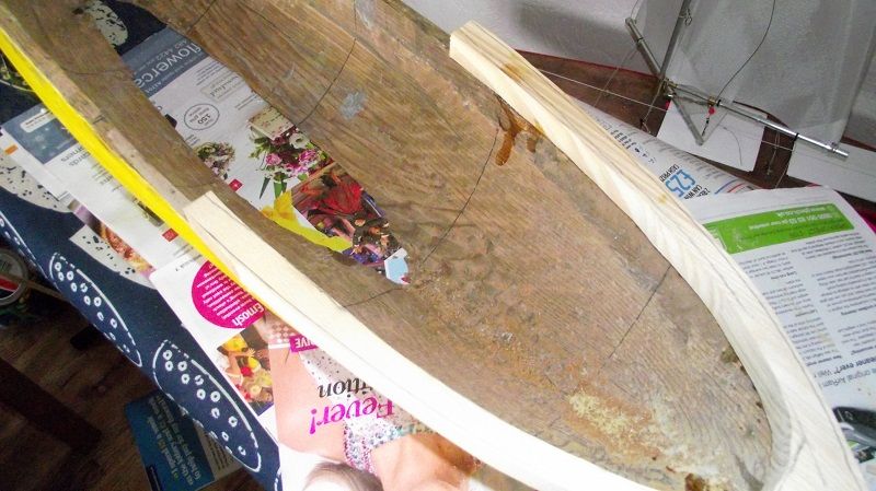

The keel has parted from the hull along one of the joints, it is built on the bread and butter principal.

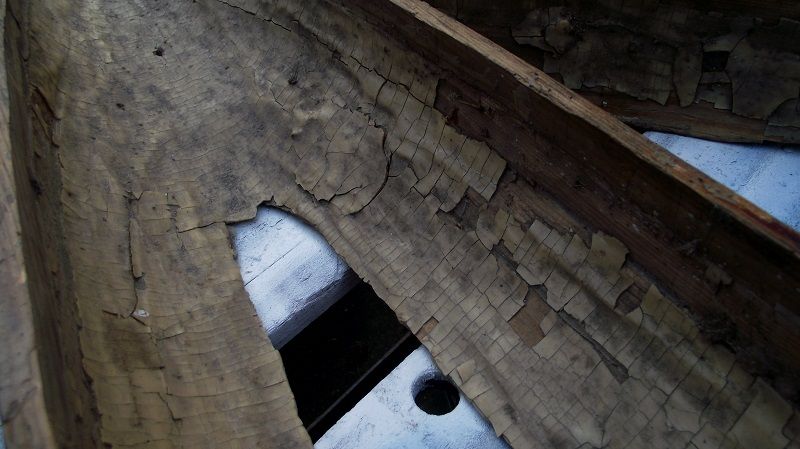

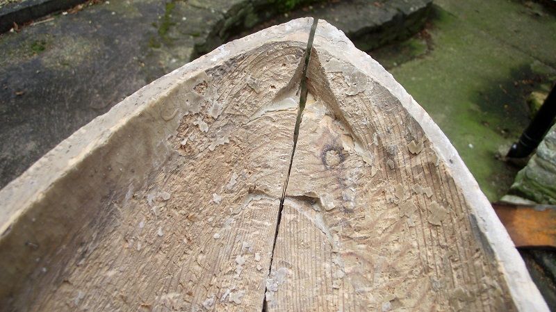

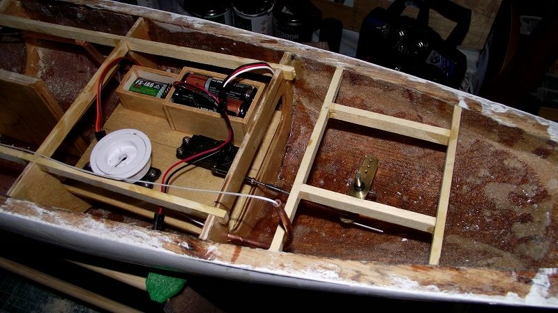

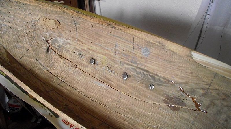

The inside of the hull was coated in a layer of cascamite glue and has gone brittle and crazed.

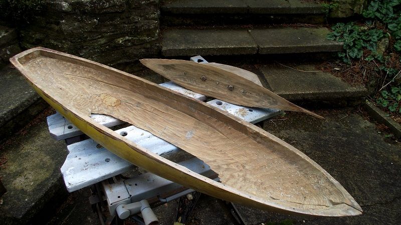

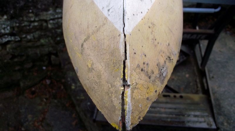

The bow has also split open.

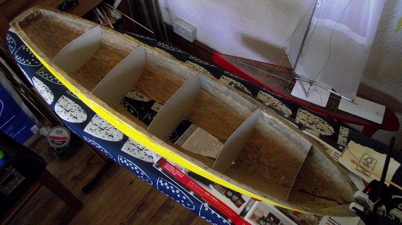

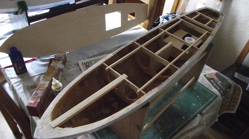

After a morning spent with a chisel all the old cascamite has been removed, the fact that it had crazed allowed me to flick each piece away from the wood quite easily, it just took time.

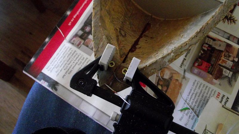

The split at the bow can now be seen, I will fill it with epoxy glue and clamp it together again.

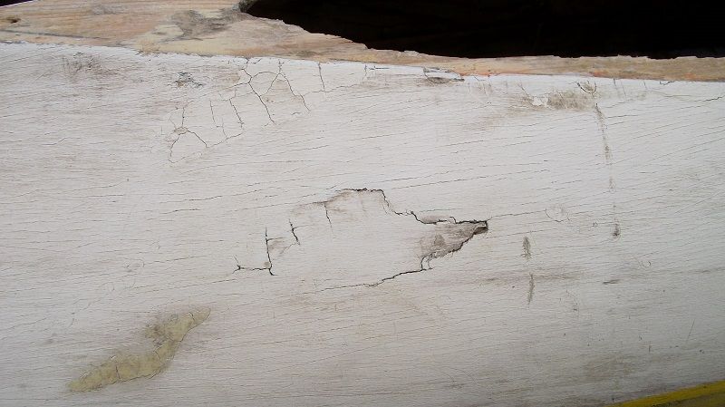

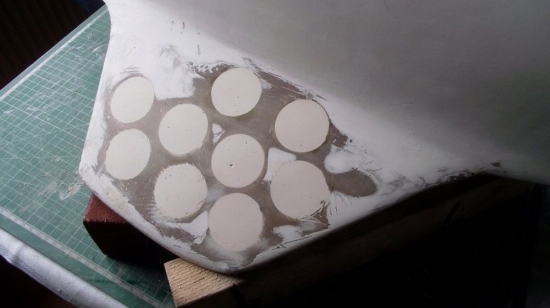

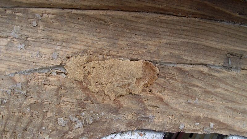

When I was removing the cascamite I uncovered this block of filler, with a corresponding mark on the outside of the hull, he must have broken through when he was carving out the inside.
The filler showing on the outside of the hull.

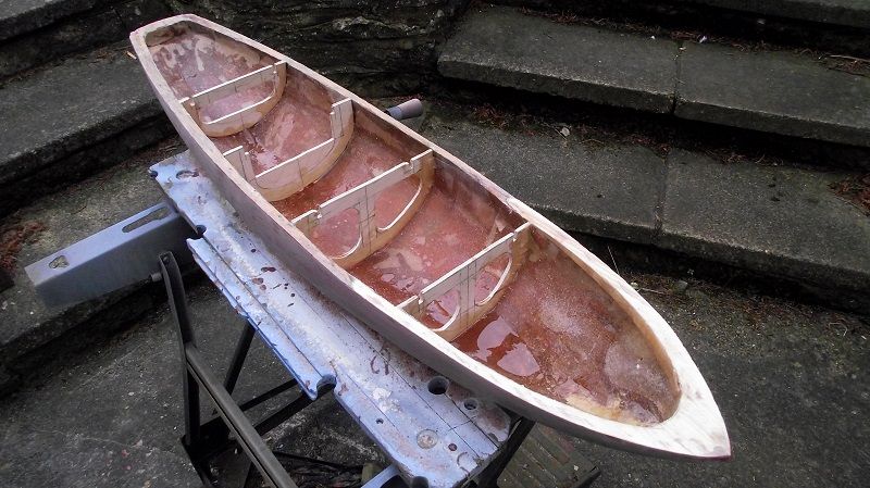

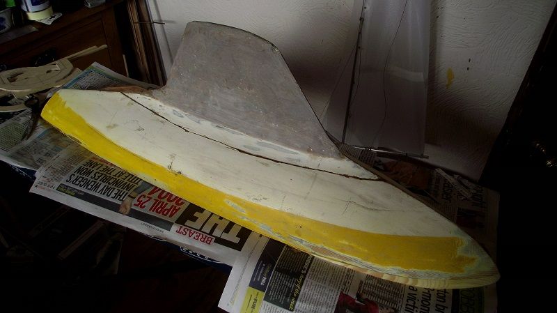

With the years of accumulated muck and dust sanded off and the joint line cleaned back to the wood it looks like the keel will fit back on quite nicely.

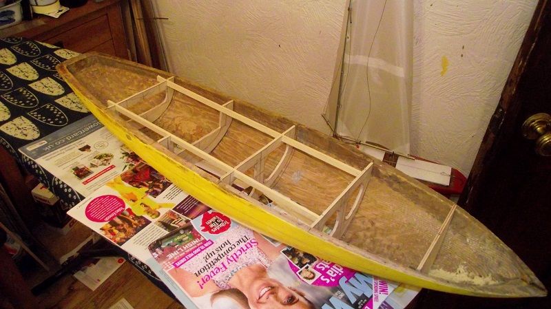

I intend to fit some frames inside the hull to help take the weight of the keel, it weighs 10lbs. I will also treat the inside with a coat of epoxy resin and glass fibre to reinforce the whole thing.
The outside of the hull I am not too sure about yet, so any suggestions will be gratefully received.
