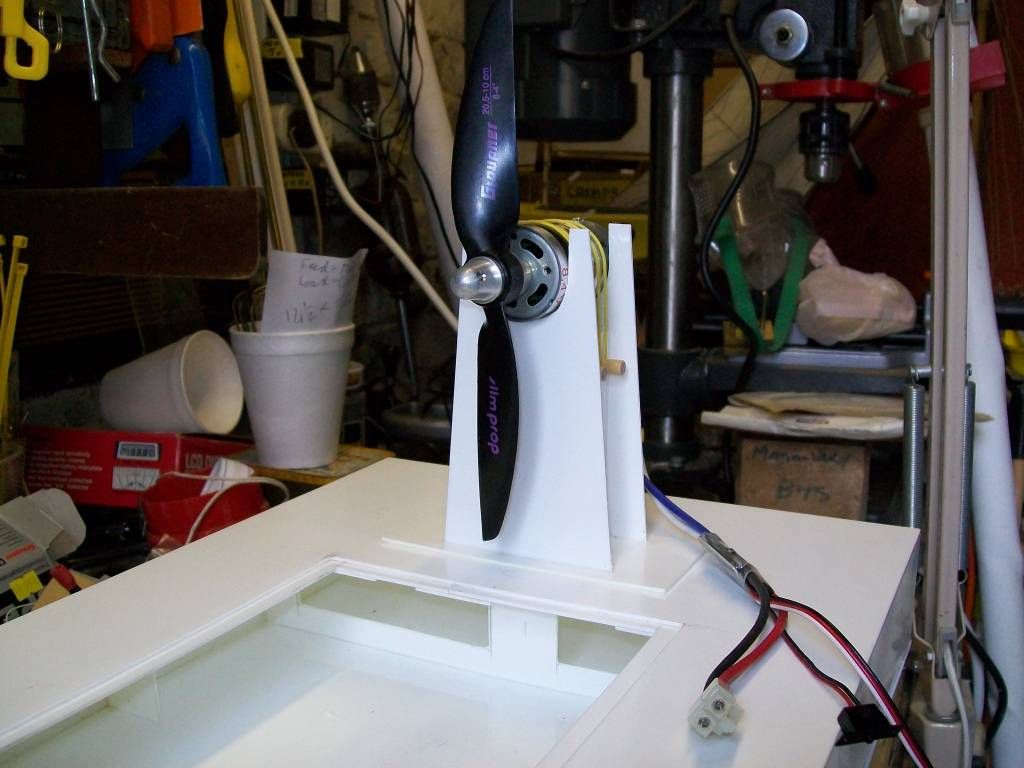

      Hi everyone
      I’ve nearly completed my scratch built Florida airboat from plans obtained from  ww.cajungatorairboats.com, the model is 24 inches long, 11 inches wide and the hull 2 inches deep made up of 1/8th ply and a balsa deck. Motor mount is 5 inches above the deck, so perhaps a 6 inch aircraft prop would be ideal.
      Would you suggest I go brushless or brushed motor and use lipo batteries???
      Thanks for any help or light you can shed on this matter

          If you mean 6″ diameter then it doesn’t sound enough. I built a Glynn Guest all-balsa airboat which wasn’t much more than half that size and was powered by a Speed 400 motor…………with a 6″ prop. What size prop is shown on the plan, anyway?
          If you want to go brushless+LiPo then read up as much as you can about operating and maintaining LiPo batteries first. You probably won’t need reverse so a cheapo aircraft brushless ESC would do the job.
          #25027
            I would probably choose a brushless for this, as you get more power for yer amp (hour/battery).
            I agree with DM, 6 inches is a bit small I would have thought for your airboat, 8 or 9 inches perhaps. Brushless motors are well established in the model aircraft world, so  decide on your prop size and call an established aeromodel shop and they would advise on the type of brushless for your craft….possibly an outrunner at a lowish rev/volt rating.
            I would hesitate before going LiPo , there are questions regarding longevity and certainly they dont take mistreatment. As you are not really weight strapped I would personally stick to NiMh.  But others wouldnt of course.
            There is a difference in mounting brushed/brushless in-runners and brushless outrunners….so you need to decide these bits before sticking lumps of wood together really !
            Ashley.. sudden expert after buying completely the wrong brushless for next project !

              What was I thinking when I said 6 inch prop ….. if the motor is mounted at least 5 inches above the deck, then that gives me clearance for a 10 inch prop …. so have decided to go for a 10 x 4 prop … I really must try to agitate the grey cells once in a while.
              I have practically made my mind up on a motor, so will go down the Emax 2815 /09 route, the model without radio or any electrical gear weighs in at 700 grams …. it should fly …. thinking about it seriously, it probably will fly … straight up … maybe I should have joined a model aircraft club?
              I’m also considering using 2x 3S packs wired in parallel to give double the running capacity and duration. Doing this can work out cheaper than buying a stonking big battery…..as I am oft reminded….” you are a tight bugger”!
              Speed controller only has to be forward as Dave so correctly stated…. so might save a few pence with that.
              Thanks again for your comments lads, when funds allow and my financial adviser (Wife) says yes, I will order the relevant bits and pieces and let you know if I have built a boat or a plane.

                I haven’t read much about them but I know enough to say DON’T WIRE LIPOs in PARALLEL! The current these things can put out is frightening and if you have them even slightly out of balance you’ll get a huge back-charge surge current which could melt anything in its path explosively, including the model and you.
                Now, to pre-empt the predictable macho “I’ve done this and it works OK” posting, all I have to say is matey – you have been very lucky. These things are potentially lethal and not to be mucked about with “because it does no harm to my NiMH packs”. Our Aussie agent calls ’em “Napalm Bombs” and for good reason.When you’ve seen one go up you’ll think twice about mistreating them.
                I’m not joking here – this is serious.
                If you want longer duration then fit a larger-capacity pack or, as Ashley says, use a  NiMH pack instead (my own personal choice, this). We don’t sell either type so I’ve no trader’s axe to grind here.

                                        I’ve just come across this thread.
                                        I’ve been operating brushless/LiPo airboats ( see http://www.rcgroups.com/forums/showthread.php?t=1530921) for three years or so. It’s based on the Skimmer. I’m using the same LiPos I started with 1300mah 3S (3S means three cells in series making 11.1v in total). But I removed the heavy 400 brushed motor almost immediately and haven’t looked back since. It’s been dunked, swamped, and totally filled with water including the radio. I’ve been able to crack open the throttle while it was inverted in the water and drive it back to shore. Amusing the onlookers and disbelievers alike.
                                        They do not explode, catch fire or have any ‘here be dragons’ experiences. However they do need some sensible and careful thought as they are not brushed motor with lead/acid batteries which can be mistreated and not be too harmfull. (What? shorting out a 20mah 12v battery isn’t harmfull?).
                                        As an earlier contributor pointed out, to get the best and safest use from LiPo you need to charge and discharge them properly. You can’t be casual about it. You must use a LiPo charger. That will ensure the battery will not discharge below or charge higher than the limits they will stand. Either excess and they are dead. Very expensive. LiPo compatible chargers may have a balancer to check each cell is treated separately (multicell packs have the normal two power leads plus a separate lead and plug to use in the checker ). If the LiPo charger doesn’t have this, a separate balancer to go inline between the charger and battery pack is needed to keep track of each cell. Normally the cells are charged at a rate to charge from empty to full in 1 hour. Cut off on full charge is automatic, but it’s sensible to monitor charging in the same way NiXx are at high rates.
                                        As an example of what’s possible, my small 50watt outrunner motor drives a 3 blade 5x3prop at around 14000rpm at about 5amps. There’s more about it here :-
                                        I hope it might inspire others to look at brushless as an alternative.
