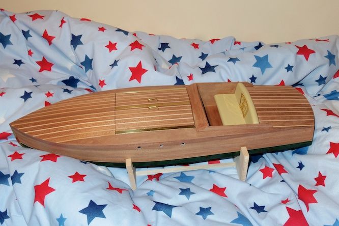

            And six months on since my last post the boat is almost finished.
            Just waiting for the clear varnish to be applied and the brass fittings attached.
            It's been quite a challenge – and it hasn't ended up exactly to the plans – but I've very pleased with the result.

                    The plans showed plastic strips for the deck but I choose 1.6mm square bass wood. The advantage is that it sands easily to make a smooth desck but doesn't look as white as plastic. I'm sure the varnish (first coat goes on today) will change the appearance.

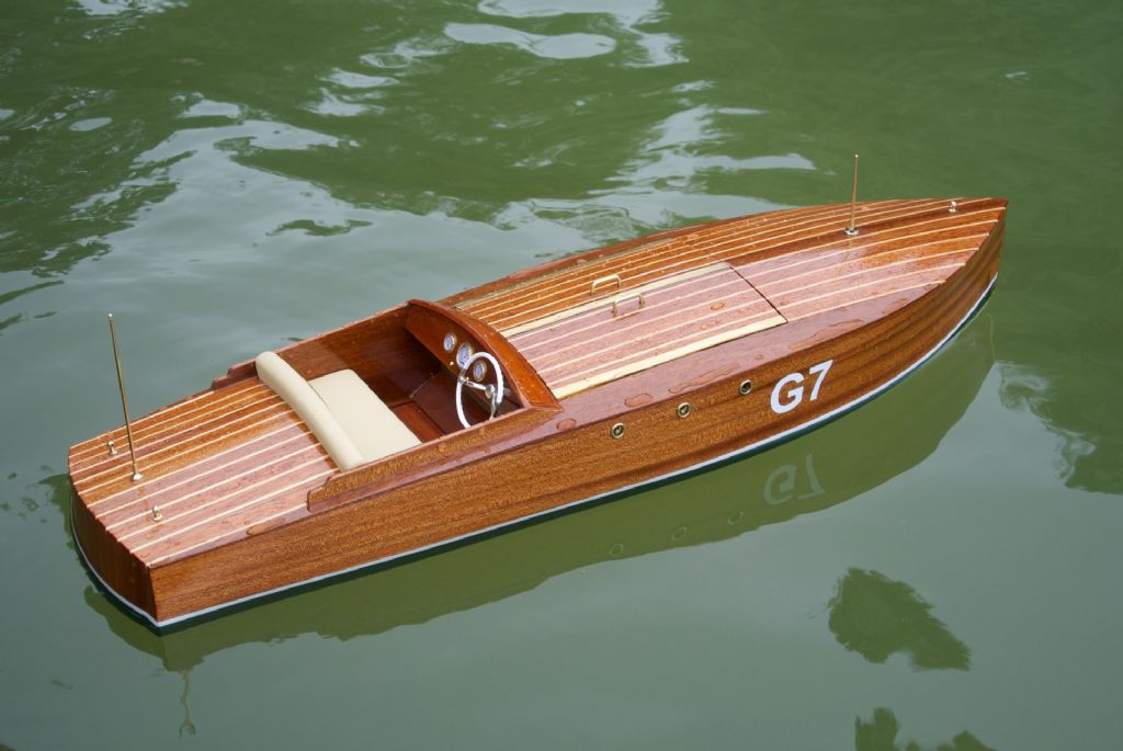

                        I did use the hoover brush to extract most of the dust but will rub over with some white spirit just to make sure. If I can manage to acheive the amazing shine as shown on your boat I'll be very happy – how many coats of varnish did you apply?

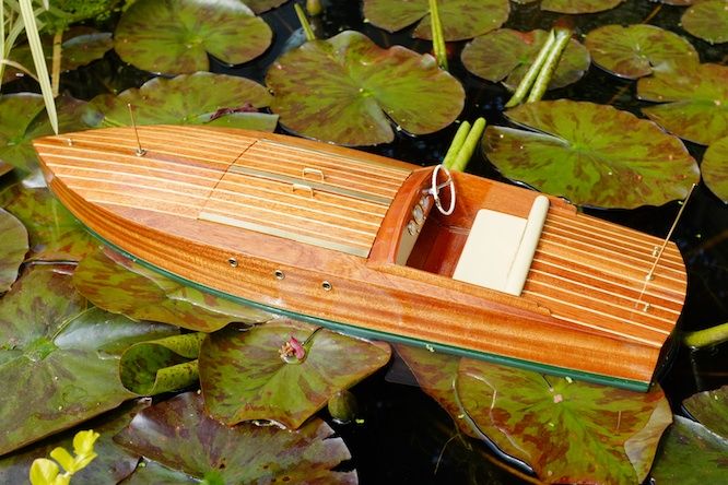

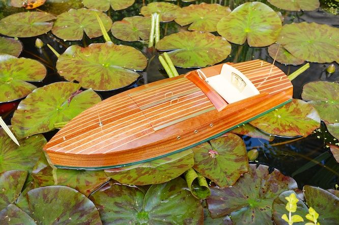

                                Well it's finally finished. I only managed 10 coats of varnish before I couldn't resist adding the brass bits today. A quick trip to the pond was the only time I had today.

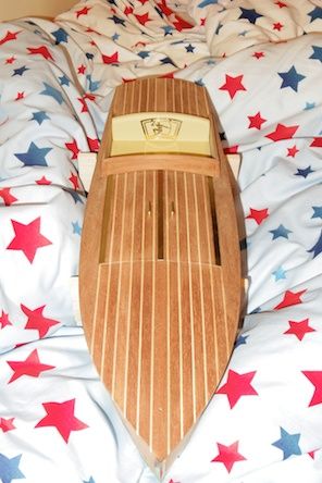

                                    3. I've just added the decals and maybe it was better without them (picture to follow)

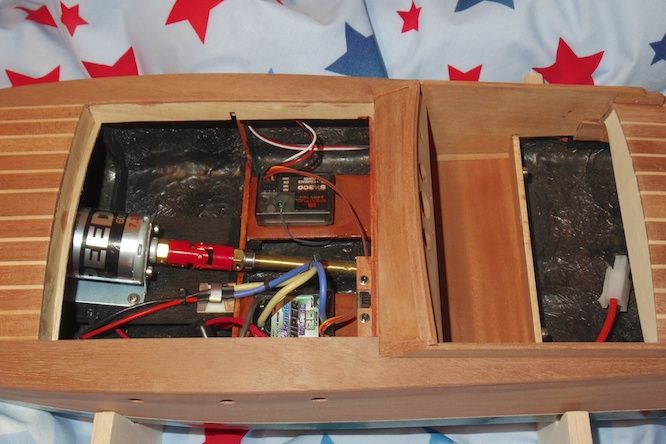

                                      And today was the day that the 1920's Racer hit the water for the first time – well over a year since I bought the plans. All went well apart from several learnings:
                                      1. At full throttle the boat climbs gently out of the water – a lovely sight
                                      2. But the small port holes down the side that are supposed to keep the motor cool manage to collect quite a bit of water! And they don't cool the motor either. Cleverly (luckily) no damage from the water as the electronics are all well out of the way.
                                      3. The electric 600 motor gets quite hot and is really noisy. Turns out most of this noise is coming from the relatively cheap steel motor mount I used which vibrates. Not sure how to tackle this one as a replacement motor mount would require quite a bit of re-fixing.
                                      4. I managed the classic mistake of not adjusting the frame rate in the Spektrum DX3R Tx for the analogue servo I'm using for the rudder. By the end of three battery packs the rudder was twitching really badly and it seems I've managed to cause enough damage to mean a replacement digital servo is required.
