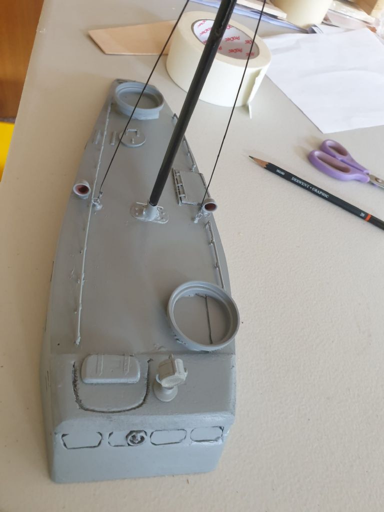

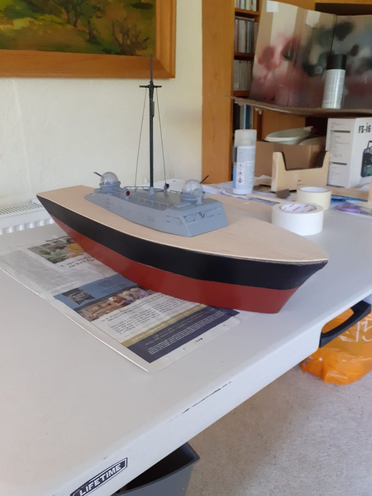

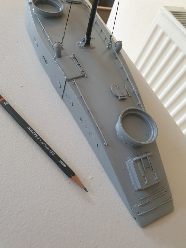

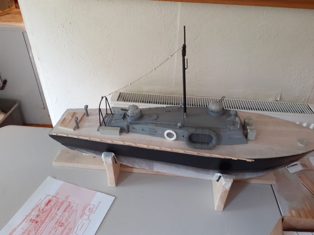

                                                    #97631
                                                    Philip Hughes 1
                                                      @philiphughes1
                                                      So uploaded some more details:
                                                      Bow masked off ready for repainting –
                                                      Sides i think look much better in the Matt as advised by you guys – not perfect but much better i think:
                                                      Some upper structure details:
                                                      Grab rails made in brass wire and in place: – cowl vents purchased – 3d printed i guess
                                                      grab rails.jpg:Mast constructed from wood:
                                                      mast done.jpg and put in place:
                                                      Top superstructure – nearly there: Gun turret 'holders' made from the upside down domes off small display 'thimbles' stands – with the turrets from the domed uppers.
                                                      Starting to come together – i'm proud for a first effort looking nice:
                                                      accessories shown from ebay and 3d printed and needs painting etc. Not fitted yet just put on for pic
