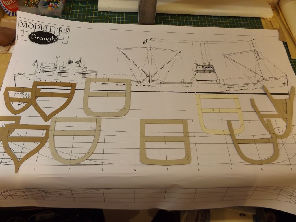

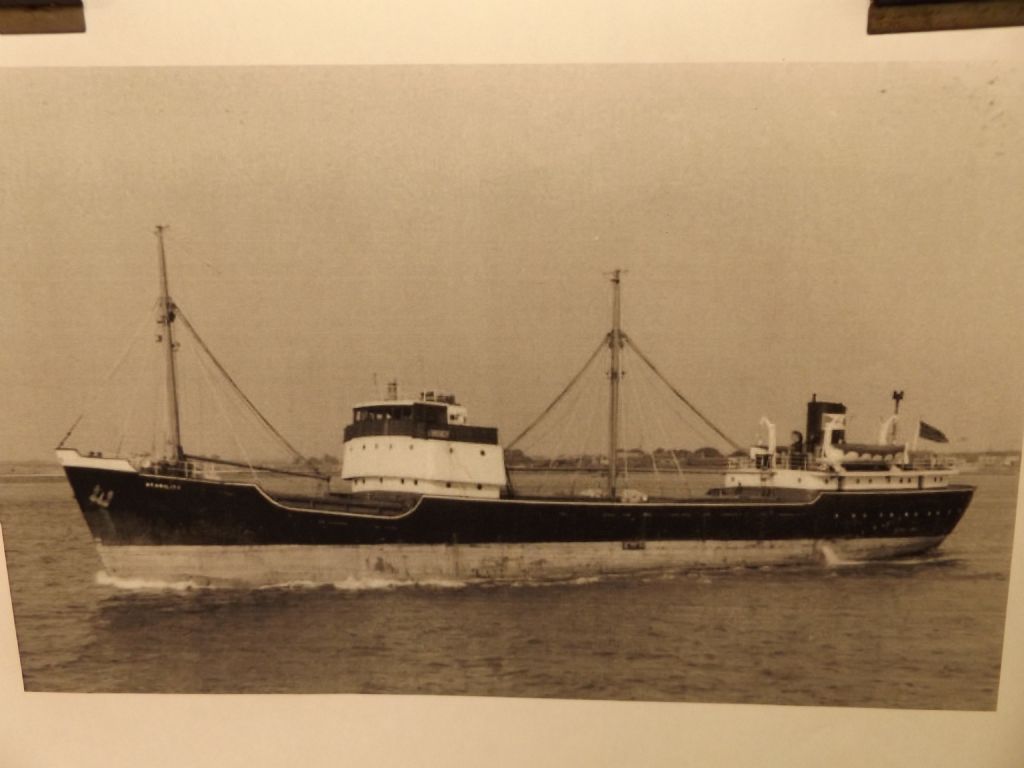

      I have been lucky enough to be lent a free plan published in Model Shipwright by Jim Pottinger for Stability, she was operated by F T Everard & Sons from Greenhithe, which is very close our Chantry club at Bluewater, During the late 60's I used to cycle over to Greenhithe clutching my Ian Allen ship spotting book to see which ones I could tick off the list.
      I have had the drawing enlarged to 1/72nd scale as she maybe part of a Quayside layout on my OO railway in the future (thought Richard would like that ! ) she will be balsa construction, ply for the superstructure and vital stats :- 31" long X 5" beam.
      So here we go with the card bulkhead templates ready to start cutting.

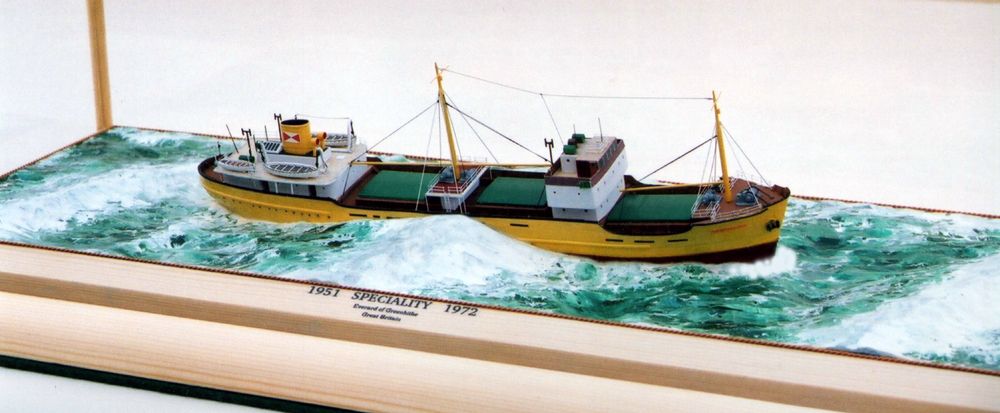

              They were smart little ships. Some of them were painted yellow, but I preferred the black ones like Stability – Here is one I built of Speciality. I sailed in the big Frederick T Everard myself in 1962, another yellow one –

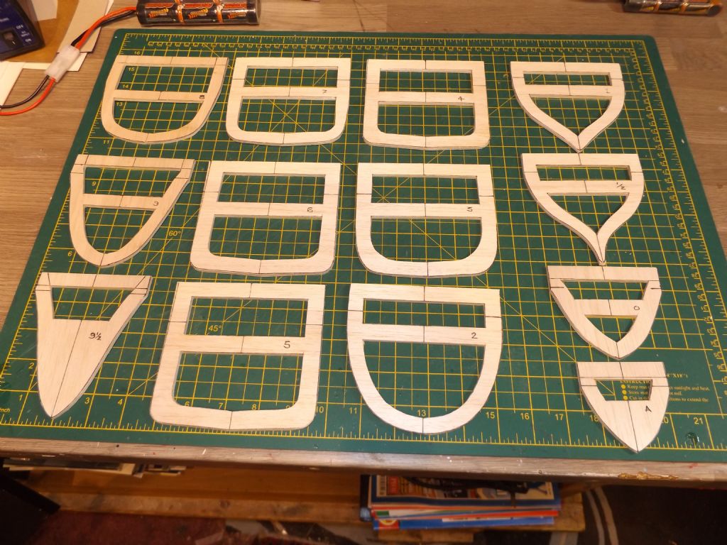

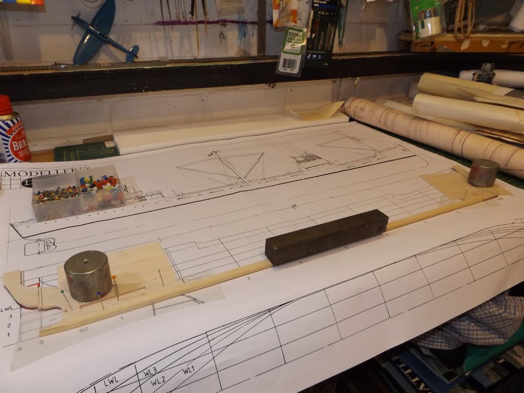

                      st 3 bulkheads.jpgHi All,
                      Nothing quite like a wet weekend for some cutting and sticking
                      The bulkheads are cross laminated 1/16" balsa to stop them splitting when cut out with a scalpel , the keel is balsa & obeche with the bow and stern being 1/8th balsa sheet, maybe planking with 3/32 as I have plenty in stock.

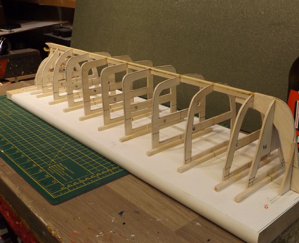

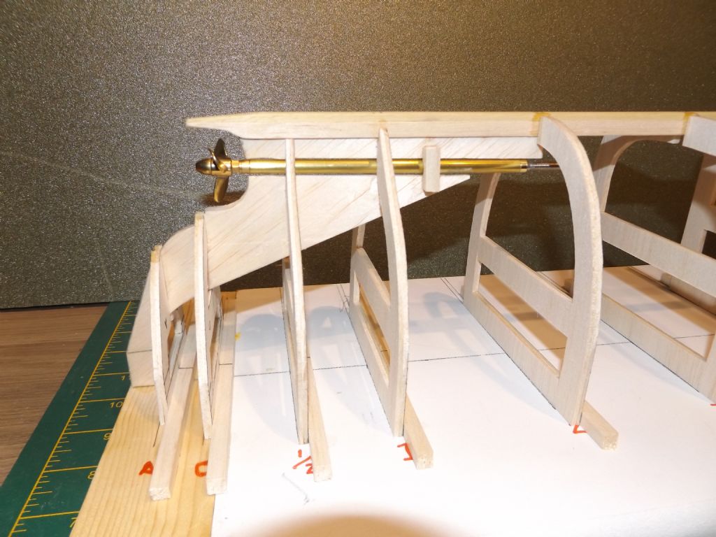

                                  st 5 frames.jpgHi All,
                                  Pressing on with this build which to be fair is the same as Oldenburg in many ways, so I may not post many more photos !!
                                  Well the frames are erected on the board with the keel in place and a dry run for the stern tube, then balsa planking next

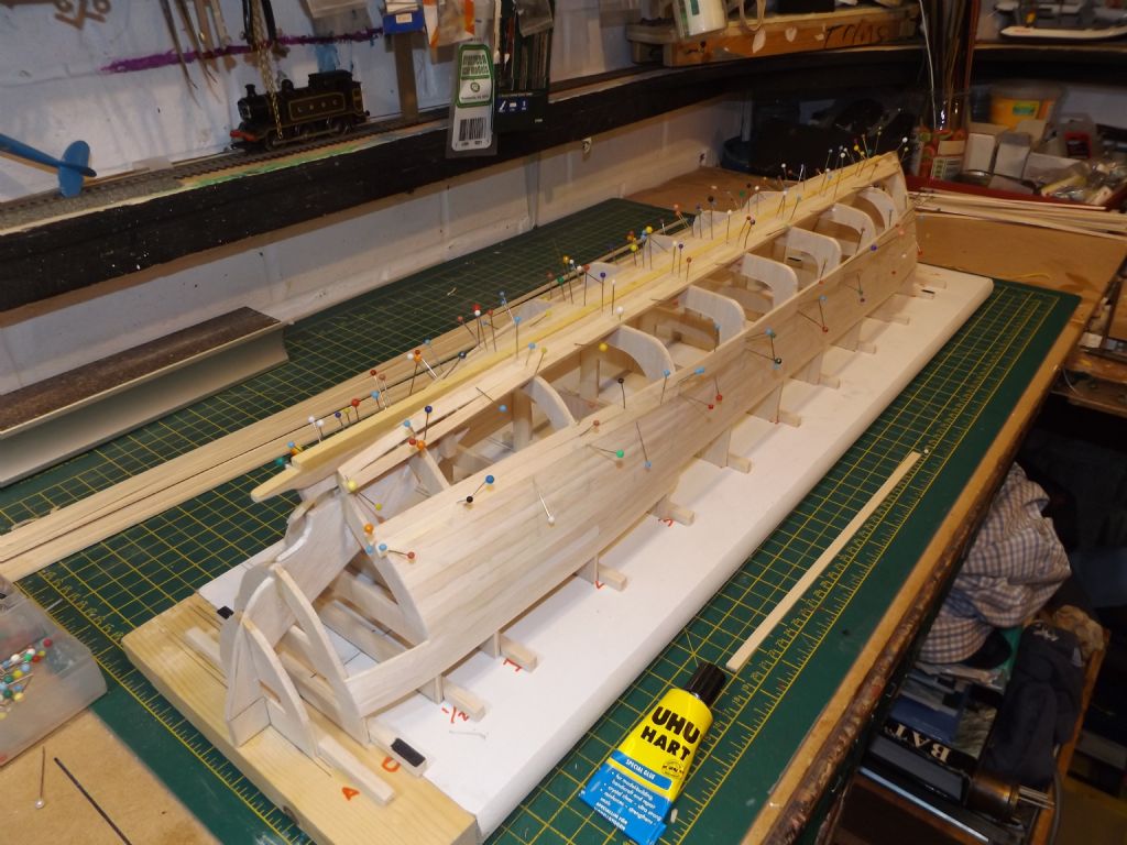

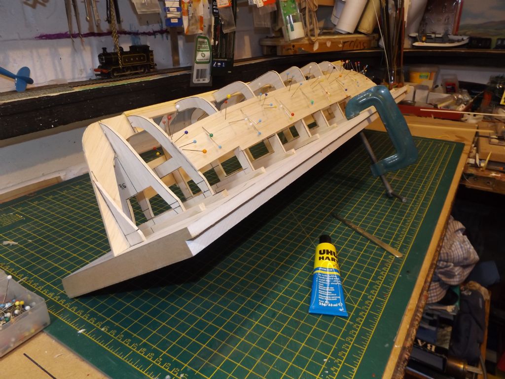

                                      While I wasn't watching the football, the planking has come along
                                      My top tip is when building inverted on a board is using a small G cramp puts the hull at a much better angle for planking access, my best investment years ago was 1 metre steel rule which I use for cutting the planks from 3/32" balsa, then plenty of pins and balsa cement and I'm back to being a 12 year old , love the smell of the glue !!

                                      Eddie Lancaster
                                        @eddielancaster
                                        Hi. Ray, don’t get too high on that stuff, we don’t want it bannedsad.
                                        See what I mean about different ideas when building?
                                        Regards.
                                        Eddie.
                                        #96575
                                          Hi Eddie,
                                          Years ago when we were Aeromodeller's with our balsa cement we just thought it smelled like Pear Drops times may have changed ?
                                          Have decided that the bow & stern will be balsa laminations as those 3/32" planks don't like going round corners !!
                                          #96584
                                            Balsa cement, one of the best smelling glues around. Right up there with the original formula contact adhesive Bostick.
                                            I think using balsa is a good idea Ray. There are very few woods as flexible and a little steaming makes it very pliable.

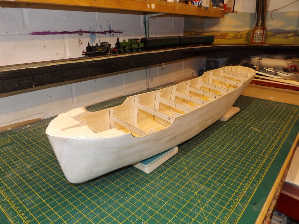

                                            #96710
                                              Stability has progressed and jumped off the building board, 1/2" balsa laminations for the bow & stern and plenty of lightweight filler.
                                              Off to London today for work to look at a refurbishment project in the west end, will be interesting to see if there is anybody on the trains? as maybe like me working at home has become the normst 9.jpg
                                              #96711
                                                Love the railway in the background Ray!

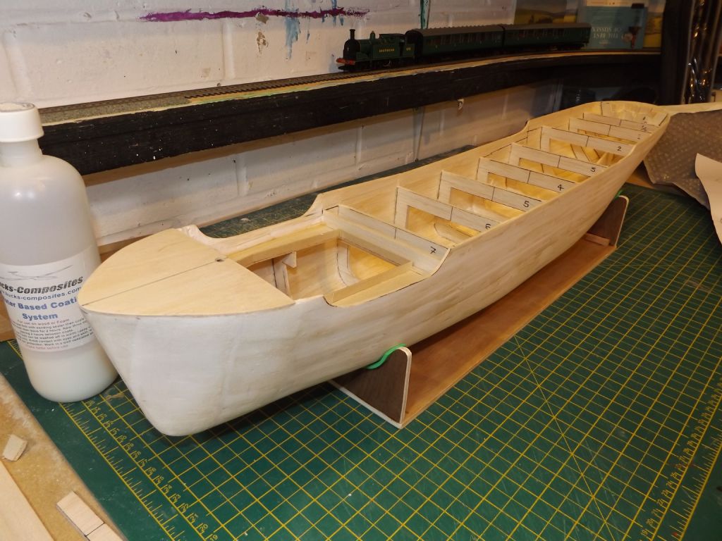

                                                  Not really rushing this build ! but she is sitting in her stand now, with the deck and hatch coamings fitting working towards the stern, the inside of the hull has been lightweight glass clothed between the bulkheads and sealed withst10.jpg water based resin, I will do the outside the same way soon, 2-3 coats and it will be ready for primer after I have cut all the various water ways and anchor hawse openings.

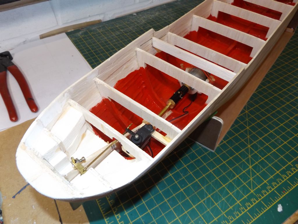

                                                      st12.jpgThanks George,
                                                      She is actually coming out smaller than I thought at 31" longst11.jpg but that's to suit my ideas for a dockside railway layout eventually

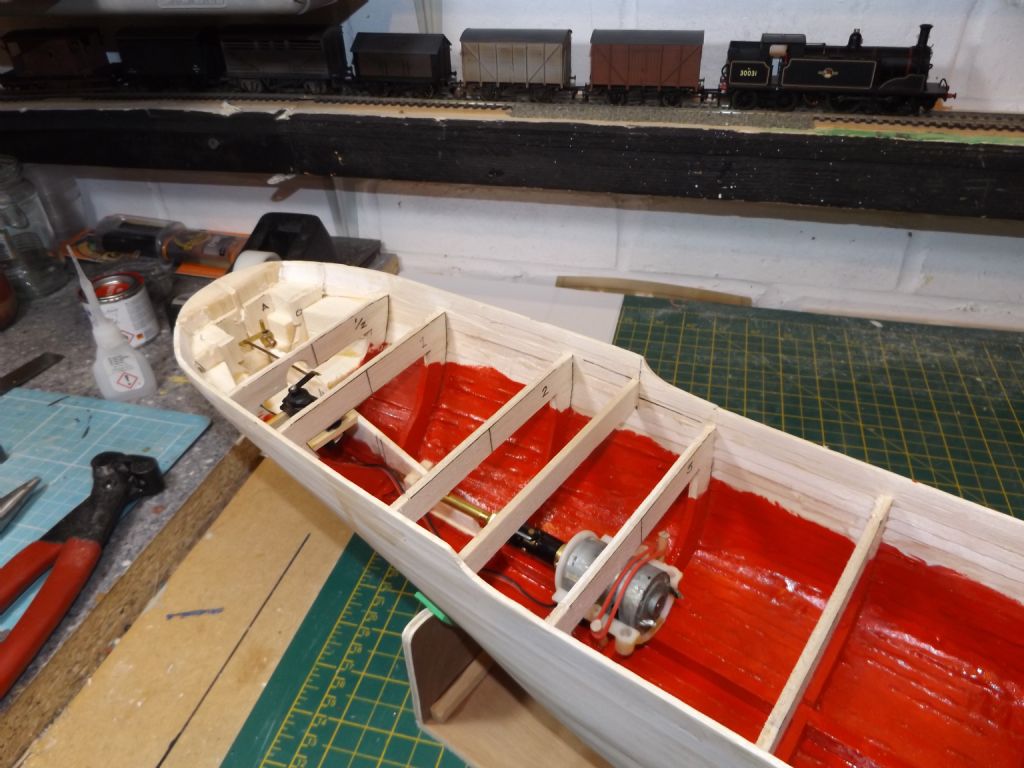

                                                      The inside of the hull is glass clothed and painted 2 coats of Humbrol enamel, 380 motor from the spares box, tiny rudder servo retired from an aeroplane, I wanted to get the working parts installed before I put the decks and hatches on access for the battery maybe awkward with the derricks rigged, but still pressing on
