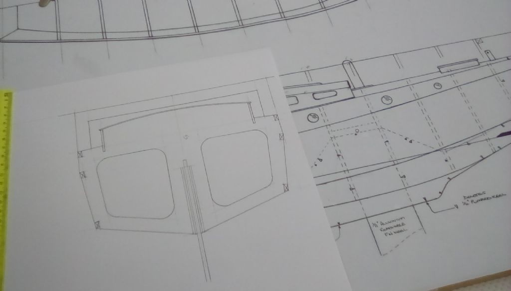

                Nice wet weekend weather, good for drafting the sections of the hull for the Eventide which I'm hoping will be a pretty little yacht 😀⛵ it takes as long to draw as the build will !! img_20200725_153427.jpgonce I have all the bulkhead s we will be cutting wood 👍

                                              Hi Brian,
                                              I photocopied the general arrangement and plan view enlarged to the 1" – 1 ft then trace onto tracing film, and using those views measure and draft the bulkhead s, I have 3 left to draw plus the transom, then we can get building 😀👍⛵

                                                  Hi Brian,
                                                  I think if you have the book everything is shown to build a real boat so it's all there 😀

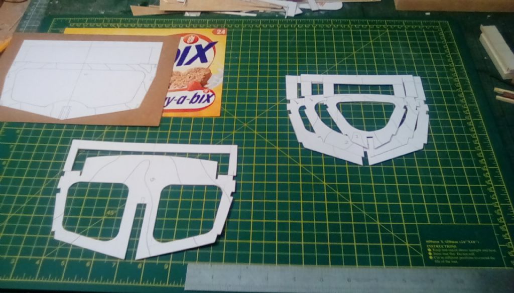

                                                    Now with bulkhead s all drafted I have spray mounted photocopies onto some card to make templates to draw round, I find this a good way of checking the sizes & positions of the chines etc before I start cutting wood 😀
                                                    My wife forced me to go to Maldon in Essex this week 😉⛵bought a great book, Yachting World Annual 1957 with loads of classic yachts & motor boat designs, happy days 👍img_20200801_151628.jpg

                                                      wish I'd thought of spraymounting my tracing paper efforts when drawing the frames for the Fisher. I cut out in card from the tracing paper but spraymounting would have increased the accuracy and saved me some agro. Still, I'm not tempted to start a new scratch build just so I can use the spray!
