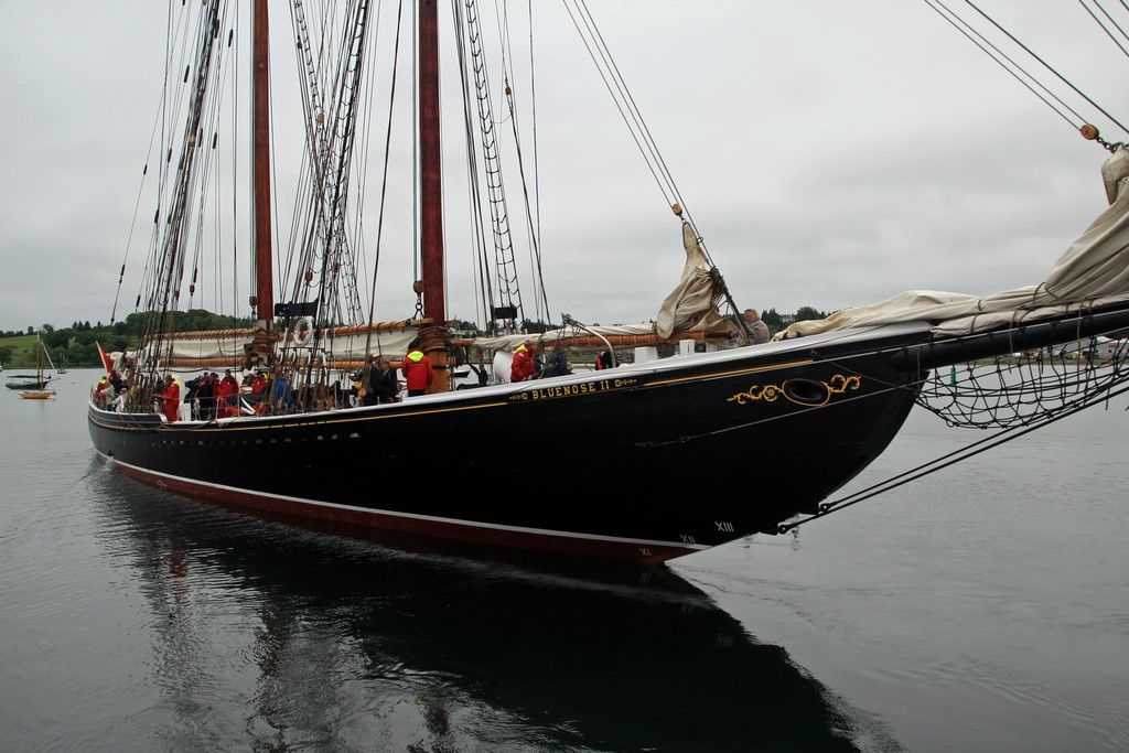

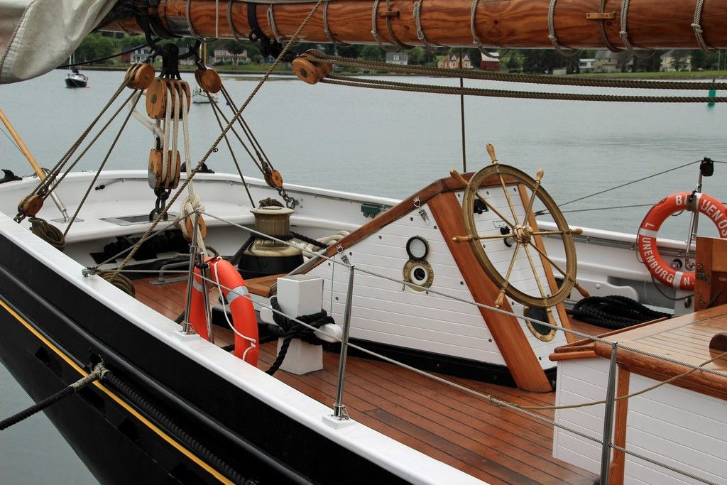

                            I saw Bluenose II when we were in Nova Scotia last summer and have uploaded some of my photos here:
                            a couple are reproduced below. She is a very impressive vessel and surprisingly large when seen close up.
