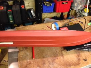

      Hi,
      I am a 14 year old and have taken an interest in boat modeling after my grandfather introduced it to me. I have a 3D printer at my disposal so the actual manufacture of parts is relatively easy. The problem i have is i have a second hand boat hull that my grandfather had picked up along the way but it didn't come with any designs or scale therefore i am struggling to see what i could actually make it into because of my lack of real world ship knowledge.
      The dimensions are:
      Width (measured at 5cm intervals starting at the front): 10, 15, 19, 22, 24, 26, 28, 28, 28.5, 28.5, 28.5, 29, 29, 29 with a rough total length of 84cm. The depth of the boat is very shallow V hull that starts at the back at 7.5cm to 6.5cm on average to then 1cm at the front.
      I would quite like to make a fast attack craft and am not to fussed about precise scales but would be good if it looked realistic.
      Thanks Any help would be most appreciated

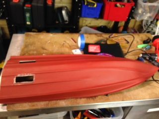

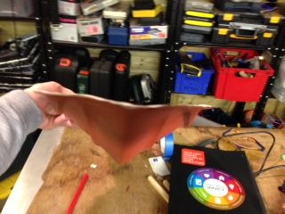

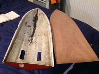

            Hi, Thanks for responding Hope these images help!

              Hi Mathew, nice hull you have there, a fast electric I think. It wasn't meant to be a fast attack boat, but it should convert quite nicely. you need to keep it light, and plan the interior for acces before you build.
              google a picturef model slipwaySentinel. it is a good looking boat and you could take the layout asthe inspiration for your build.
              keep coming back with your questions, and we will learn from you about using a 3d printer for modeling.
              Charles.

                Thanks Charles! Yeah, slipway looks much more like the shape of the hull i have! Now we know what it could look like do you guys have any suggestions of ways in which to attach the deck to the hull and if so what should it be made from? I have stacks of nice 2-3mm plywood that i was considering using but the problem i have is how to make a clean cut join between the hull and the platform because the actual line on the top of the hull is not completely straight in the y axis?
                Any suggestions?

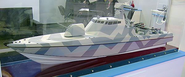

                  Hello Matthew and welcome to the forum.
                  Your hull would make an excellent shallow draft fast patrol boat such as the Fast Attack 50 craft from Tampa Yacht.
                  A straight forward build with the potential for very high speeds.
                  You can join plywood to the hull with a twin pack glue such as Araldite but you might have to 'scribe' (shape the plywood by notching) the wood to make it fit the hull curve.
                  The first thing that I would do is to make sure the hull is 'square' (level and non twisted) and then fit some stiffening bulkheads to prevent the hull from twisting and flexing.
                  btw don't forget that most 3D printed items are water soluble and might have to be treated before using on your boat.
                  PM sent

                    I'm sorry to be a party-pooper but that hull is a fast-electric model and looks very much like it was intended for twin waterjet drives. It is very little like HMCC Sentinel, which is more of a "short, fat warship" (according to Vosper's designers) and certainly not a planing hull. Trust me – "Nellie" is a ship very close to my heart, even if she looks like an assortment of grey sheds stuck on top of a sawn-off minesweeper hull!
                    Paul's suggestion seems more in line with the hull shape, or there's always Slipway's Kawkab fast patrol boat.

                      Yeah, i can see where you are coming from with that! The slipways, that you and Paul have suggested, do seem to look more like the right shape. While i was searching for the slipways i came across these? Opinions? Good or completely ridiculous?s6303030.jpgimg8454.jpg

                        It's a lot more like it, matey, but you are really starting off the hard way, though. I'm sure your grandad has every good intention for your modelling interest but this isn't the ideal model to begin with. The hull you have will need a lot of power to get it to perform (like a big fat brushless motor) and probably a surface drive etc. This sort of hull can be very unforgiving if you set it up even slightly wrong.
                        IMHO you'd be best off starting with something like Glynn Guest's Elco or Vosper MTB's. These are made of wood from published plans; designed for novice boat builders and are guaranteed performers with relatively cheap motors and batteries. The plans also have quite a bit of detail of such items as guns, torpedo launchers etc – that would be a great place to practice your 3D printing skills.

                          Hi Matthew

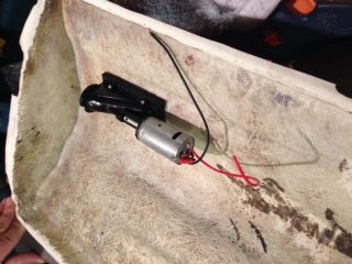

                          The Ghost is really an old design and something of a technological dead end but it is proving fun to reverse engineer and design as a model. The research is just about complete and I will be producing cad drawings over the next few weeks.
                          Your hull has those two cutouts for waterjets …..do you have both waterjets and are they both complete?
                          If it were my hull I would build what is called a 'freelance' model (which is basically something that you make up) I would use the Tampa Fast Attack or the patrol boat that you have shown us as a basis for a simple but effective model.
                          If you build a freelance model you can play around with the boat and add all sorts of bits and pieces, freelance is fun.

                              Nice! Would love to see the CAD for the Ghost, sounds very cool and yes those 2 holes are fitted to jet motor mounts and intakes i have printed for the complete water jets and i intend to get a big beefy motor on a prop to add some real power given how weak the jets are!
                              Also, with the actual super structure aspect all the guidance on 'freelance' would be most appreciated! I apologise for my lack of boating knowledge! Oh so freelance is like looking at a boat and sort of using it as inspiration but actually making up?

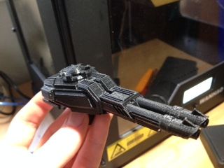

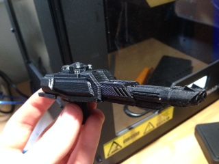

                                    That's very interesting, Matthew
                                    Tell us more about the 3D printer, please
                                    Was the water spout made, complete with the innards etc?

                                      Hi Bob,
                                      The 3D printer is a WANHAO Duplicator 4S (The dual nozzle model). Therefore meaning i can print in 2 of the 3 possible plastics at any one time. This dual nozzle type of printer allows me to print what i think you are talking about with the image above, complex innards.
                                      Although, that laser cannon type thing was made completely with the 3D printer; it is for show so has not actual innards such as piping or channels that you would use to fire projectiles/water. However, i can print absolutely anything, joints, gears, propellers ect and blocks/objects of material with complex pipe work in build.
                                      The way in which i do this is use either PLA or PVC (the 2 none water soluble plastics) to print the main object with then PVA (the water soluble plastic) in all the places you don't want there to be any plastic at the end.
                                      The reason one must do this is because the PVC or PLA cannot be printed into thin air so requires the PVA as a support structure (serving a purpose kind of like scaffold in real buildings) so once the item is constructed up in layers with all gaps filled with one of the 2 plastics it is then submerged in water. Resulting in the PVA dissolving leaving your complex item ready to bolt straight onto your boat!
                                      If you have any other questions on the subject i might open a separate thread about it and would be very happy to answer them.

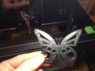

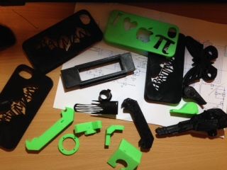

                                            Also to your comment on seeing some of my work, i have some examples here;
                                            Just a general array of nick knacks and experiments!

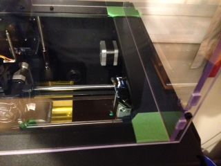

                                            Using the 3D printer to improve the 3D printer! (mounting system for top perspex)

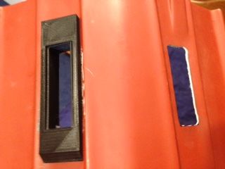

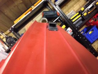

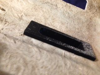

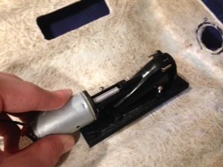

                                            My current project, this is the underside of the boat with my 2 part jet mount connected. The idea behind this is that the motor have a easier and more manageable mount that is more water tight instead of having the jet straight onto the boat hull. The printer is currently working on the other mount for the hull (should be all attached my this evening).

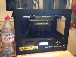

                                              We would like to see a picture of your machine, please

                                                Here; sorry picture quality not great.

                                                  Thank you, Matthew
                                                  Is the plastic hot during the printing process and how do you get over the unevenness of the printed layers?

                                                      The way in which the 3D printers are very clever with the layers is that because there surface area to volume ratio is so tiny it means the surface tension stops the plastic from spreading allowing for it to print 0.1mm layers, which yes then does leave a slight ribbed affect but only at 0.1mm intervals so it isn't a huge problem
                                                      Yes, the filament comes on a big spool and it heated in the nozzles and a stepper motor pushes the hot plastic out where needed.
