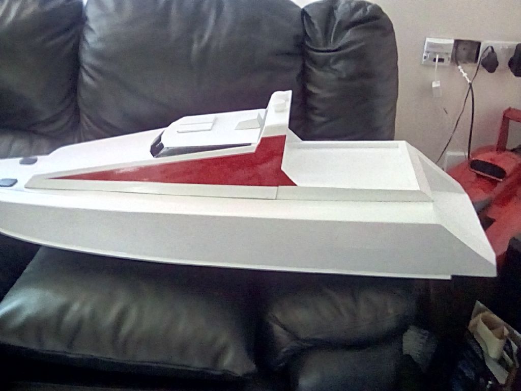

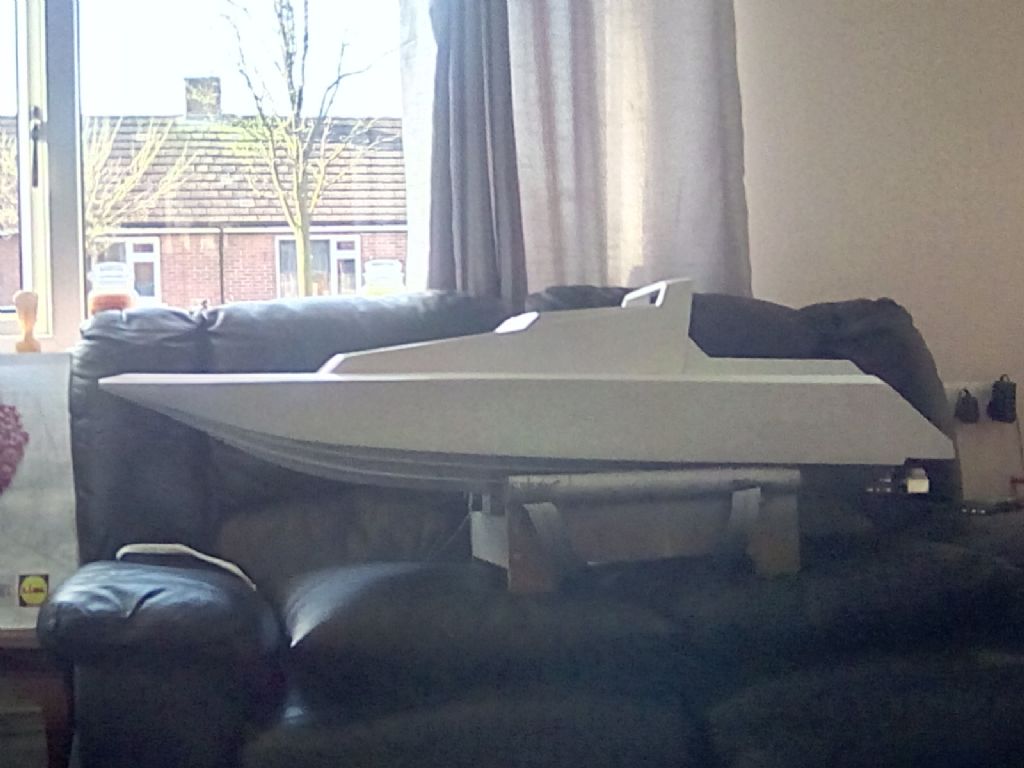

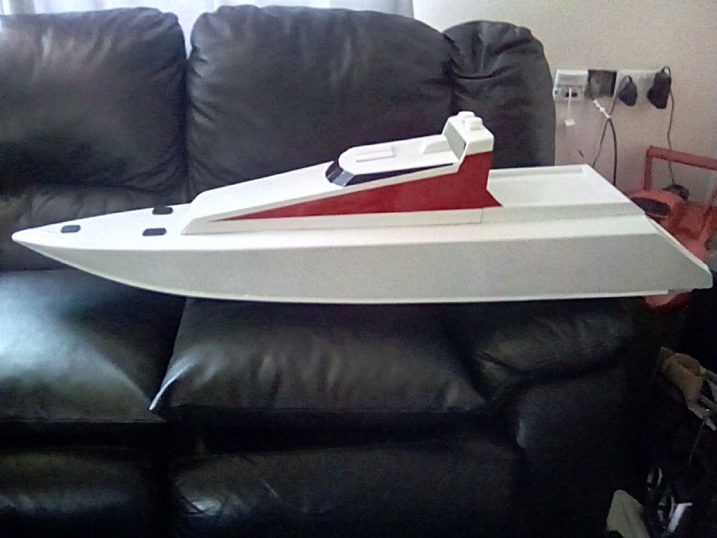

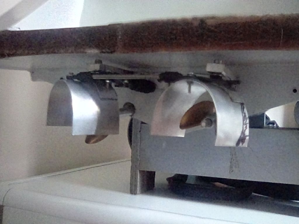

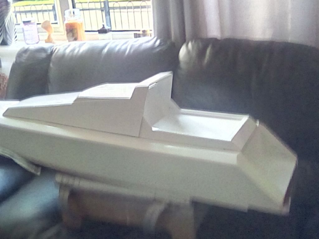

      Hi everyone,hope you like my representation of vac2.couldnt find any plans to build from,so its built from an old hull(originally was a copy of the italian challenger)so not quite the right shape.ive modified the stern to make it close to real thing.couldn't find a supplier for the drives,so i made my own.work really well as long as your not heavy handed.superstructure built from balsa scaled up from a drawing I did from a photo. Not an exact copy but close enough for me.part of the fun of our hobby with a dash of poetic license. img_20180202_102436.jpg

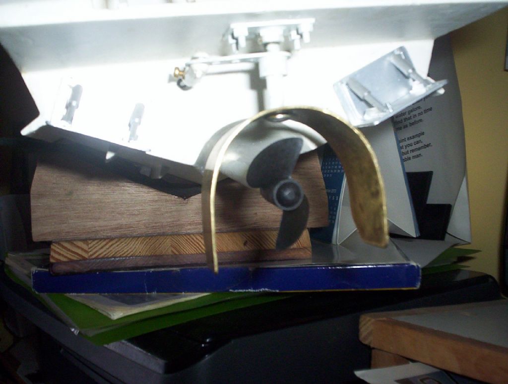

          Hi Nick and is it welcome to the forum? I see you have two albums already!
          ​Very interesting, and having just looked at pictures of the real thing, a good representation at the rear. Do I presume the cowls are for steering, and if so how effective are they? Also do you use differential prop control.

            Hi Ashley,yes she steers very well with them.no need for differential prop control,both motors run up proportional to each other, obviously they contra rotate. The more power you put on the quicker she turns,very much like the real vc2 its designed go in a straight line rather than sharp turns,but it will spin out an bite you if you get too heavy with the rudder stick. Took a bit of work to get it right,also prop choice was a big bug bear.thanks for the welcome.

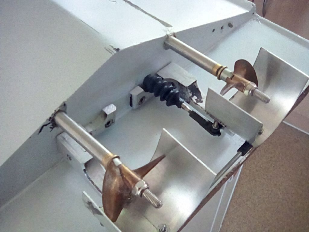

              Stern shot

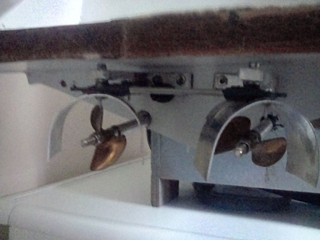

                Hope fully these are better shots

                  Stern shotHope fully these are better shots

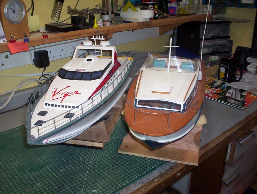

                    hi ya Nick intriguing build – looks interesting the twin drives and rudders – as far as plans go there are a set of semi scale plans for the Virgin atlantic 2 boat issued with model boats mag, back in the 1980s – which I built my version from – and so have several others on this Forum. Although this version is only single prop, it suffers from cavitation if you try to do tight turns with it A member of this forum has managed to rectify this problem by fitting a standard dagger type rudder instead of the horseshoe. Here is a link to one or two of the builds on this forum which you may find interesting.

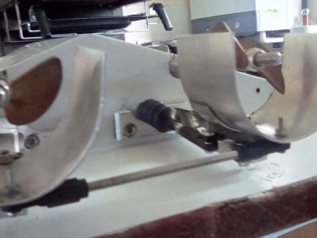

                              I was interested in the difference it made to your hydro pontoon,especially when you switched to lipo power.the hydro style props do seem to like lots of power.lots of prop wash,I get big rooster tails off all 3 boats. The biggest problem I had after sorting the props was getting the two drive's perfectly lined up,or else it fought it's self in a straight line and made a big difference to straight line speed.

                                Twin drive

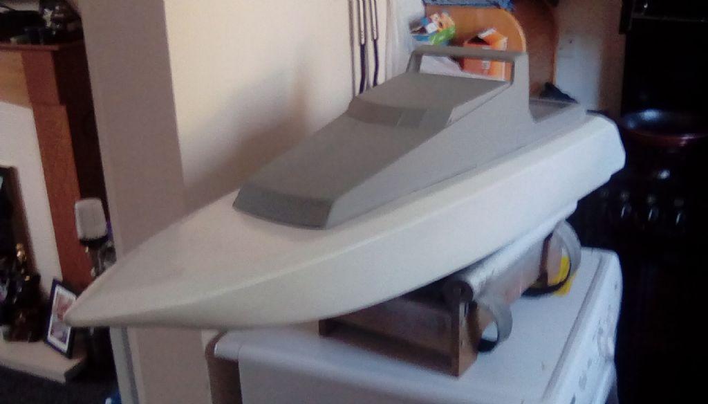

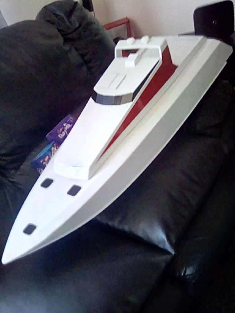

                                        hi everyone.getting there.back on the water for another test run tommorow.time to get the detailing done and decals.anybody have any ideas for the hand rails? Was thinking about using stiff copper wire?
