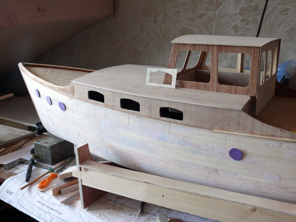

                      Latest work in progress
                      Veneered the top cabin and added new window shapes, to see how she looks and invite your comments
                      #67023
                      Banjoman
                        @banjoman
                        On the whole, Bob, I think she looks very pretty indeed! A most impressive build, this!
                        The only thing, if I may make so bold, that I would perhaps suggest that you try a few alternatives for is the shape of the cabin windows. At least from the photo, their upper, curved lines, seem a tad exxagerated, making them look (to my eye at least) a bit squeezed in, if yiu see what I mean.
                        I would suggest either a top line that follows the cabin roof line, or a less pronounced upper curve …

                        #67024
                          Many thanks Banjo, for your constructive comments
                          Please excuse my sloppy workmanship, compared to your finely built model……My model is only a spare time filler, to occupy my idle hours……….That's my excuse, anyway
                          I fancy the windows with an arched top, but there's not much meat left on the top cabin?
                          I could make a token effort though
                          The lower windows were just a quick paper cut out for effect

                          Banjoman
                            @banjoman
                            Bob,
                            Please don't do yourself down! I see no sloppy workmanship here, and I rather suspect that you have forgotten more model building skills than I will ever learn.
                            I agree that arched window tops would look nice — I just meant to say that it might be worth trying out a slightly less marked arching, making the top lines a tad flatter … ?!
                            /Mattias

                              Hi Bob
                              Yes agree with Banjo, maybe the windows & portholes slightly smaller than the mock up for better scale effect

                                Thank you Ray
                                The cut outs were just there to get an idea of size etc

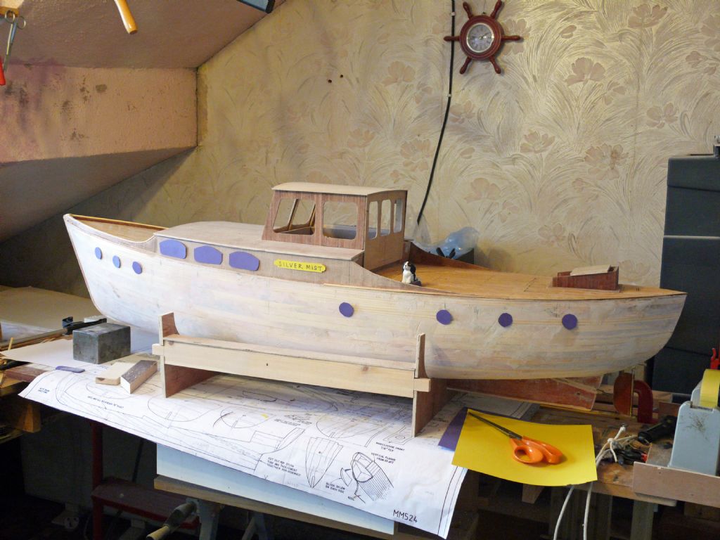

                                  #67034
                                    Thank you, Ian
                                    I`d enjoy turning the portholes, but brass is so expensive these days…….Especially 1" dia!
                                    So I`ll be using 3/4" brass curtain rings
                                    The windows….
                                    I`ve made a thin ply stencil for repeatability, but there`s no getting away without…..Window frames for a tidy appearance
                                    I could do with making a press tool for a quality window frame job, but it involves a lot of work
                                    Home made press tools are a treat to use!….. I used to use a heavy duty vice, with the tools bolted to the jaws
                                    Then place the sheet metal between the jaws and wind in……….With immense force, the jaws come together and the product is made………Lovely!

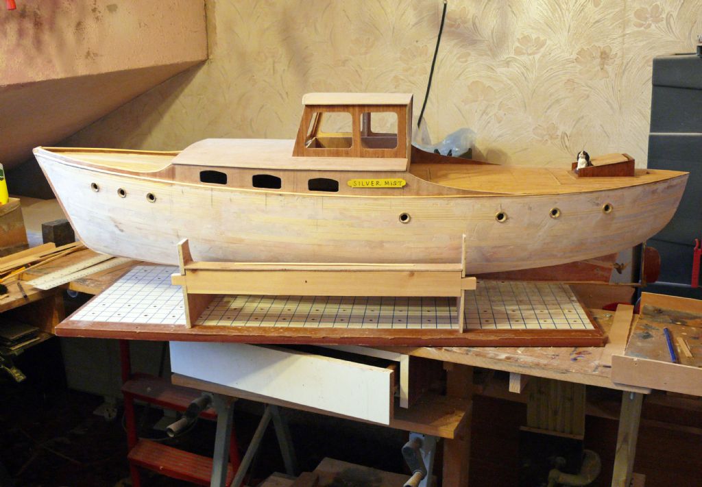

                                              Work in progress……
                                              Temporarily tacked on the curtain ring port holes for effect……….And they look good enough for a so called beginners model

                                              Banjoman
                                                @banjoman
                                                They certainly do, Bob!
                                                Likewise, I think that you have gotten the new cabin window shapes pretty much spot on — the arching adds interst, but is not so marked as tio make then seem crowded in.

                                                #67058

                                                  Ian Gardner
                                                    @iangardner62867
                                                    Looking very nice Bob.
                                                    I think at 21'' in balsa it was a beginners model- couldn't call your boat that, especially as she is planked throughout and actually your planked stern looks more elegant than the one Vic designed in my opinion.
                                                    I also think you have got those windows just right – bit more spaced out and the look a bit wider.
