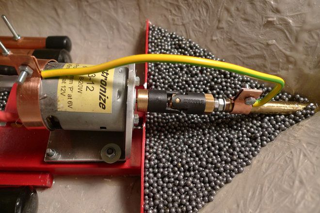

                        Ashley,
                        Having experienced trouble soldering capacitor legs to a motor can, I sorted the problem by clamping a copper strip around the end of the can, trapping the capacitor legs between the strip and the can:
                        You can just see the ends of the legs sticking out either side of the large ground wire.
                        I also used this strip to ground the whole set-up to the water via the propeller shaft, as David Harrison says should be done in the article that Dave M. linked to above (cf. bottom of p. 1 and top of p. 2 in the article).
