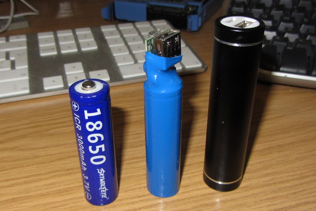

            At the more basic end of the scale is the single call 18650 version. Pictured below dressed, undressed and 18650 cell
            The clever bit is the tiny PCB that provides charging for the cell and 5v output for your device. Now if you can follow my strange thought pattern for a while…..

                The big advantage of a 18650 powered pack has to be the lack of weight. A 3000mah 18650 pack should not weigh more than 50g whilst Colins AA pack weighs 118gms. The difference clearly doesn't matter for most purposes but could be critical for others.

                  As Chris mentions weight:
                  The 18650 pack pictured above weighs 49g when removed from the metal cylinder. With the cylinder it's 70g. Its quoted capacity is 2200mAh.
