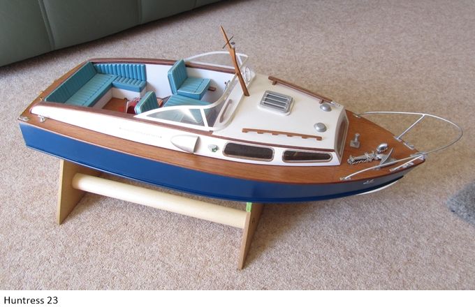

                          It's good, very good! smiley
                          Out of interest I shall have to compare the weight of the Huntress against the River Cruiser, both being the same length and very similar hull design. The latter being build like a proverbial house of something!
