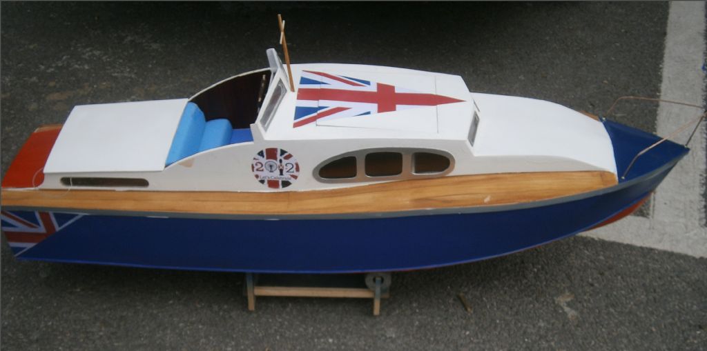

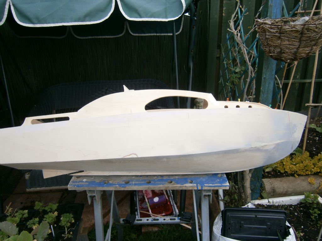

        Hi all Alun here in sunny Flintshire as the title says I'm new to the boating scene but have been rc crazy with cars ands planes over the years I have just restored an old sea queen which is a lovely boat and I will put some photos up as soon as I can . My main reason for writing this thread is that I have just ordered the new version of the sea queen in kit form and would like to know if any body else out there has built one and could offer any hints or tips in the building of this boat

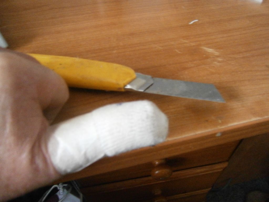

          wecome that is nice find, built one for the jubilee , using plank on frame, structure…
          a big boat , shall remember this build cost me the top of my thumb,,,,,,,,,,

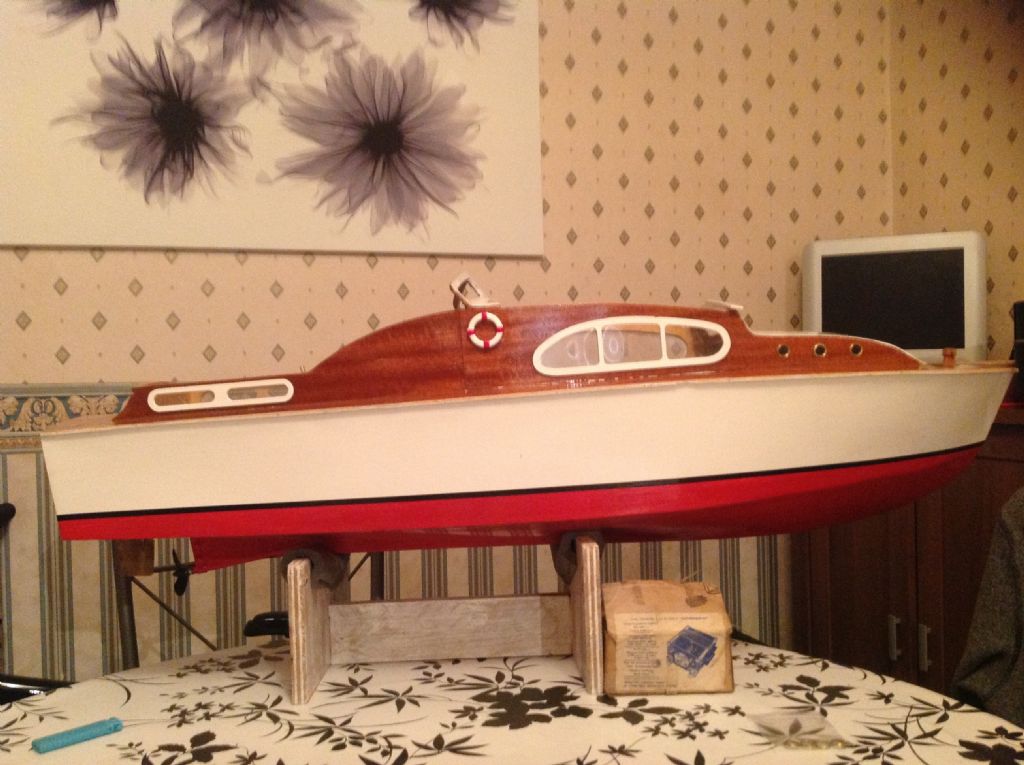

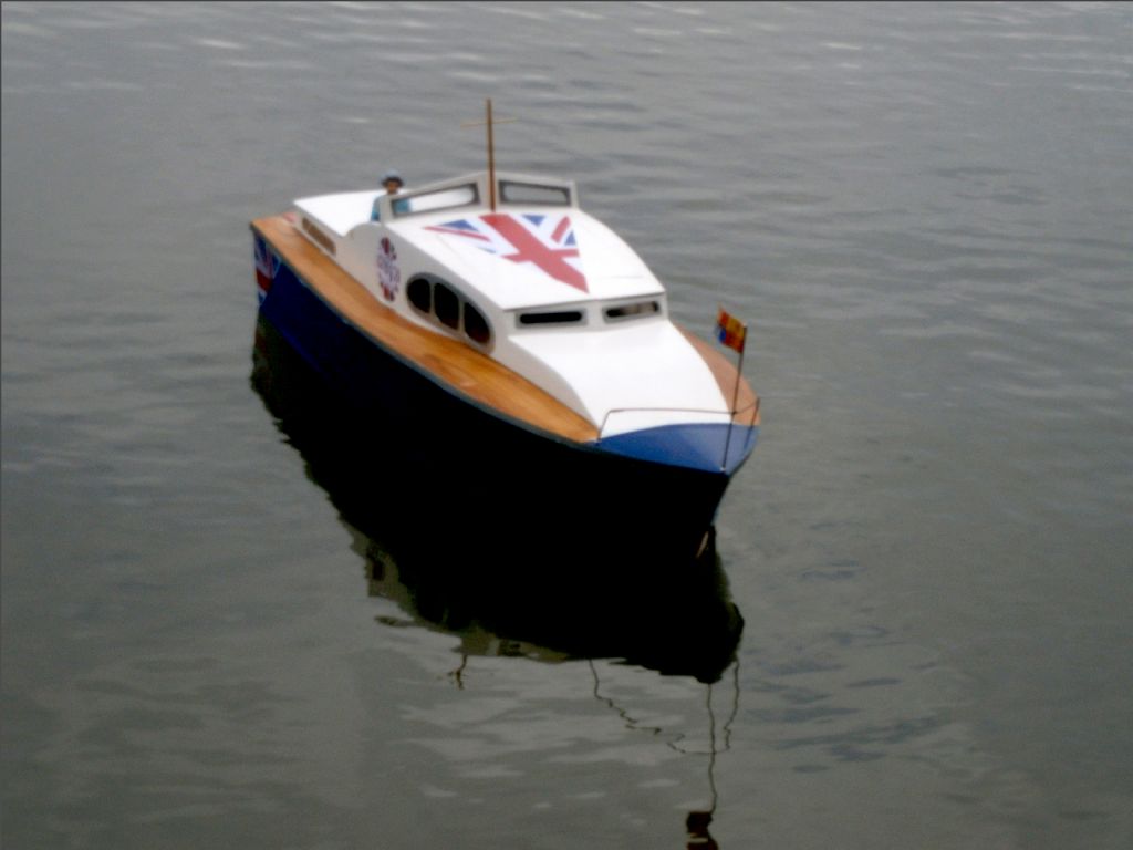

            Hi larry yes she is a good find she looks a lot different know and will soon be on the water, I have seen many of your posts on the Internet you also have the duck if I'm right I was thinking of restoring my boat back to how it would of been in he sixties / seventies I have a taycol supermarine motor in its original box which I got given about seven years ago but I could not be bothered in the end so I put a nice 850 torpedo motor in her instead , once I have worked out how to upload more pics I will show you more many thanks and happy building
            #38700
            Alun
              @alun
              Forgot to put cabin roof on sorry

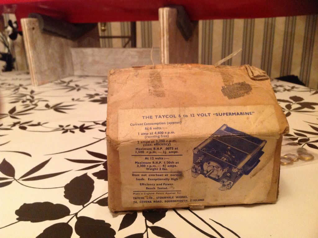

                Taycol super marine
                #38702
                Alun
                  @alun
                  Posted by Alun on 14/01/2013 20:21:28:
                  Taycol super marineUndecided yet if I will fit this if not I might sell it on and buy some more goodies for the new sea queen kit I have

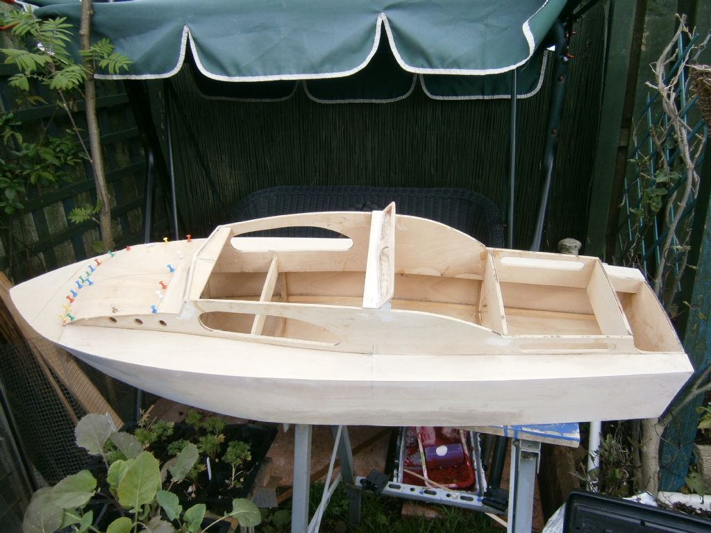

                                              Well hello all as some of you might know I have restored this sea queen and am building the new version of the sea queen as well , the new one will be built as per the instructions , but as for the old one I have decided to ic this one now I have acquired a very nice webra 61 (well nice know it has been stripped and cleaned ) I have but only one question and that is ,this one is for you Paul T lol what is the best coupling to use on this some what frowned upon beauty . Many thanks
