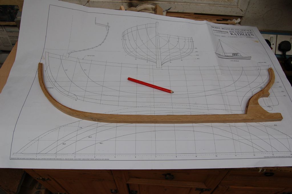

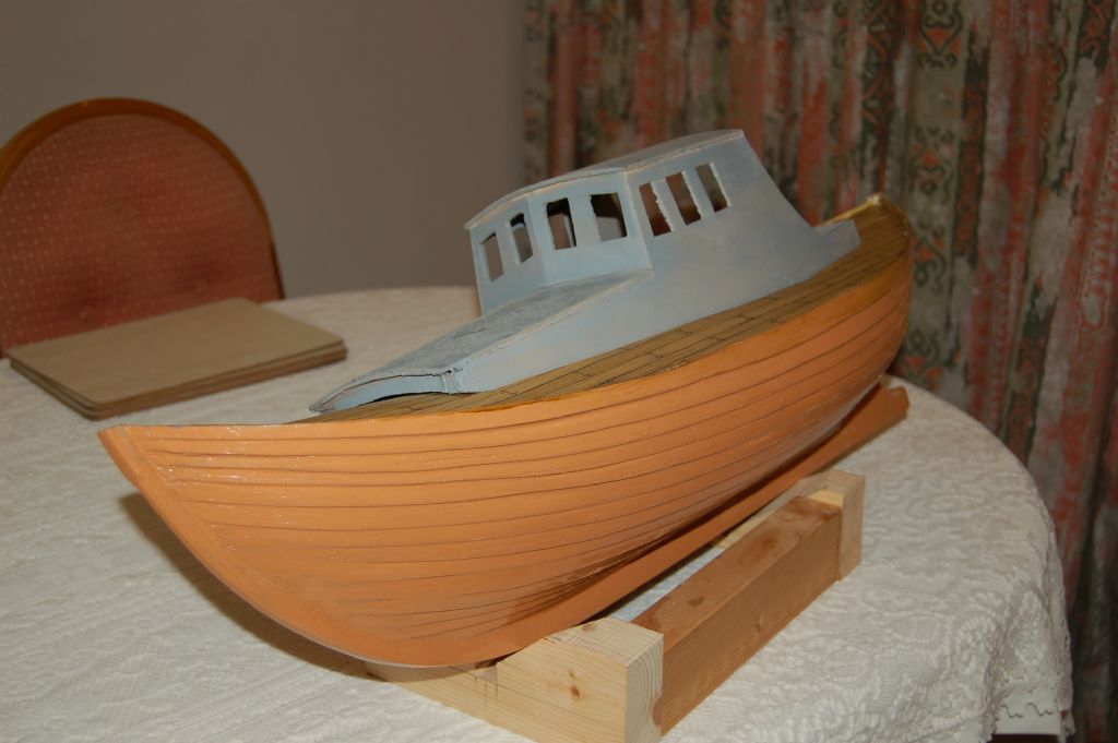

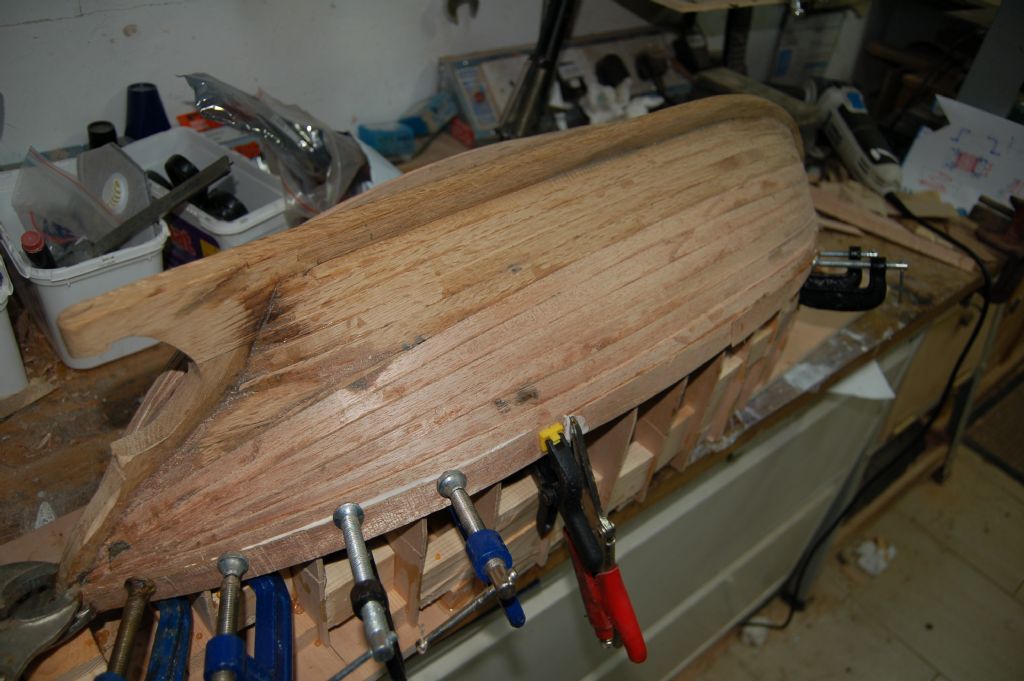

            Yes I a have been having a go at 'Kathleen' and I am building the clinker version of it, I have already built a Jim Pottinger design from the drawings scratch built 'Ravenna' which was my first attempt at a model boat build and came out quite well.
            I can honestly say that the clinker build was a bit too difficult for me to do, there are no instructions and its all up to the builder to sort it out, what I didn't realise was that the amount of wood required for the planking is quite a lot, and even with cutting my own planks on the bandsaw and joining up to make the curvature as linear as possible I am not all that happy with the results as it looks a bit like Noah's Ark ! mind you boats do look rather cumbersome out of the water.
            I am seriously thinking of planing all the clinker planks away and having a smooth hull, I also found that the strips of oak I used could be bent quite easily using a blowtorch on the non visible side and holding in curvature, they retained their position.
            The rear bottom section is particularly difficult with sharp return curves and I had to fill some of it in with a mixture of glue & oak sawdust.
            Anyways.. here are some pictures of the build so far…nb.. this is not the final paintwork.
            ..Bob Mc…
            The keel is done.
            dsc_0188.jpgPlanking
            dsc_0192.jpgThe build up to now…

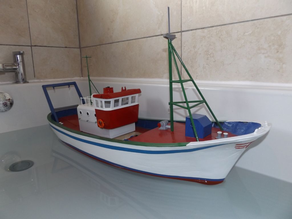

                        Jim Pottinger never shows any model construction, which I think makes it a more enjoyable build because you need to think it through yourself this is his Spanish Fishing Boat design. Regards Raysfb feb 19.jpg
                        #98642
                        Bob Mc
                          @bobmc91481
                          That is a nice job Ray… I fully appreciate the effort that goes into making these scratch built boats especially when the instructions are just a peice of paper with lines on it !

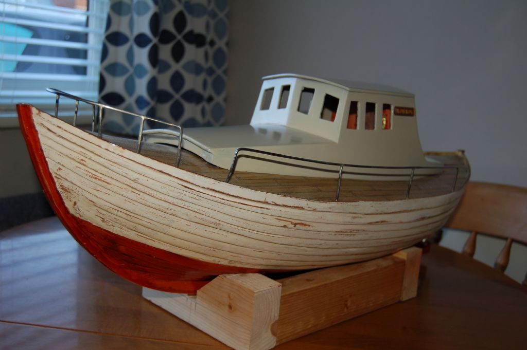

                          Bob Mc
                            @bobmc91481
                            Hi All..

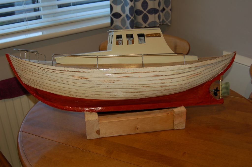

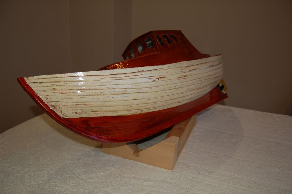

                            Decided to try and get an 'antique' style finish for 'Kathleen' this is not going to be the name for it, which will be 'Rob Roy' in memory of my brother Roy who died this summer… with me being the 'Rob' part.
                            Apart from the R/C bits and the motor I have used materials and paints/varnish which were lying around in my workshop, I also decided to make the rudder and steering gear out of brass which I think is more in keeping with the look of this boat , my brother would be proud to know that it has been built … economically, I hope to have a launching ceremony at Etherow so will have to enquire if I could have my sister in law on the jetty to officiate.
                            It still needs a few bits & bats such as the side rails and mast, so with a bit of luck she might be ready for next spring when weather is suitable for fine weather sailors…such as myself.
                            Anyroad up….below .. as she is now.
                            #98856
                            Bob Mc
                              @bobmc91481
                              Its Kathleen no more!
                              its 'Rob Roy' now, just got a few more things to sort out then I'll take it down to the water and see how she runs.
