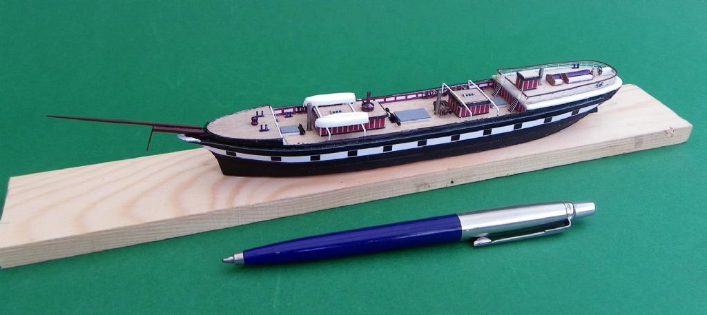

                                      #67658
                                        @bobwilson59101
                                        I have now completed the hull, and laboriously rigged the davits. I am all ready to start the masting and rigging!smiley The worst is now over, the rest is easy!
                                        #67659
                                          Hello Bob
                                          Another nice model, but why has she so many Jolly Boats?
                                          Could she have been a Whaler?
                                          #67662
                                            @bobwilson59101
                                            Hello Bob,
                                            No, not a whaler, but a class 1 passenger-carrying wool clipper of the mid 1870s. There were two longboats over the forward deckhouse, two lifeboats over the half-deck and two smaller double-enders on the poop deck. Frank Worsley, who was captain of Shackleton's Endurance, was apprenticed to the New Zealand Shipping Co, and this was his first ship.
                                            The term "wool clipper" was derived from the fact that they carried general cargo and passengers out to Australia and New Zealand, and came home with passengers and a full cargo of wool.     They were very advanced ships, some of them also carried frozen meat home, kept cold by dry-air compressors powered by coal-burning engines, but the ships themselves were propelled only by sail.
                                            Whalers were usually built of wood and were quite stumpy looking.
