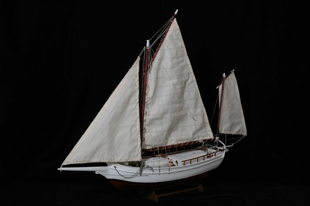

      This is my first post about my first model. I have built this from a kit, it is planked on bulkheads and the hull building and finishing was to say the least a challenge but not so much that i won't do another.
      Spray Port Bow
      Not sure how to include the album of pictures or how to include a link, perhaps this could be my first be of advice
      Have some video, will try and figure out the YouTube link next
      Thx

        Joshua Slocum “Spray” from the BlueJacket kit

          Congragulations. To build a first model plank on frame is a great achievment. The model looks great, and the finish is fine too. Give yourself a pat on the back, you’ll have an itch to build another now, then another……..etc.

            I worked out the video link and wow can you see the imperfections in the model when it zooms in!!
            Must try harder!!

              So I could really do with some hints on the following:
              Material for sails
              Material for the running rigging, you can see my reefs stick out here and there smiley
              How to generate authentic looking lettering, I used standard adhesive graphic letters
              Any additional suggestions would be welcome and I shall be browsing the forums for hints and tips

                For a kit build your model has gone together remarkably well and you are to be congratulated on the quality of your build.
                I presume by imperfections you are referring to the lines showing through on the cabin roofs.
                I wouldn't worry because, as in full size wooden boats, it reflects honest construction and gives the model character.
                For sails I use cut down Egyptian cotton bed sheets with a mild starch to stiffen the material, for letters I make my own with an electronic cutting machine called a Silhouette but if you don't want to invest in a machine there are people on line who will cut vinyl to your specifications
                Well done on a great build.
