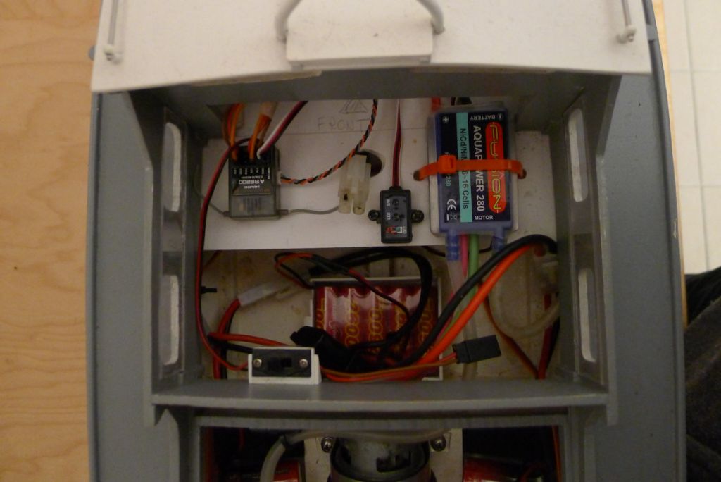

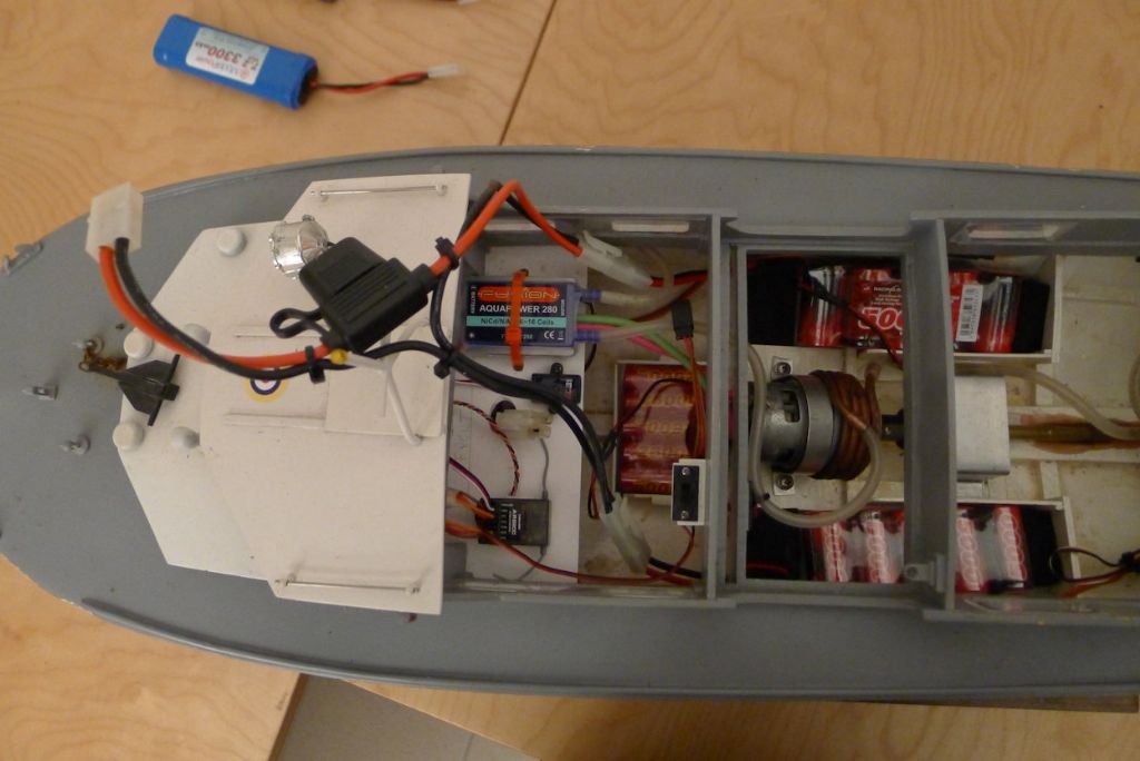

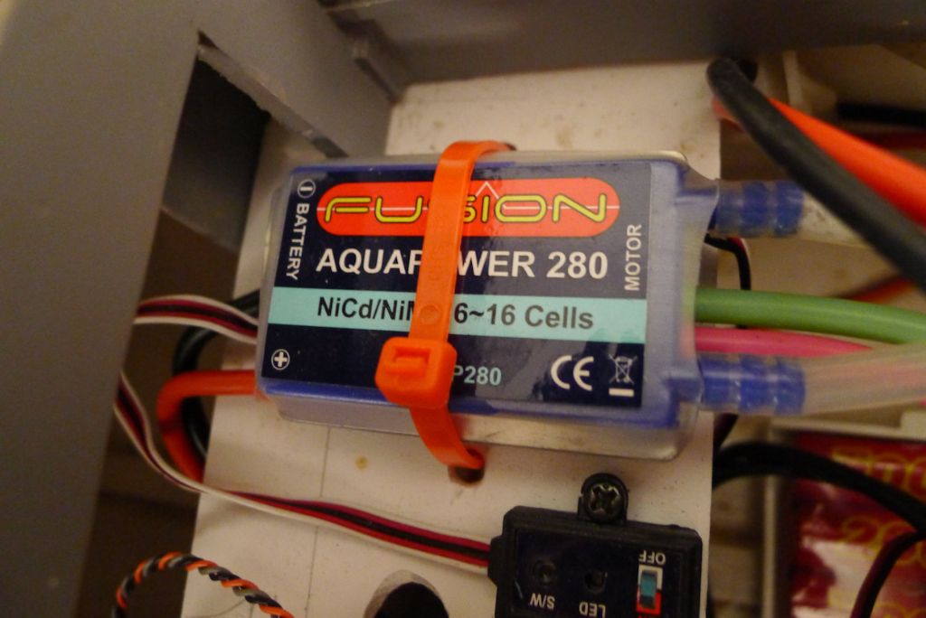

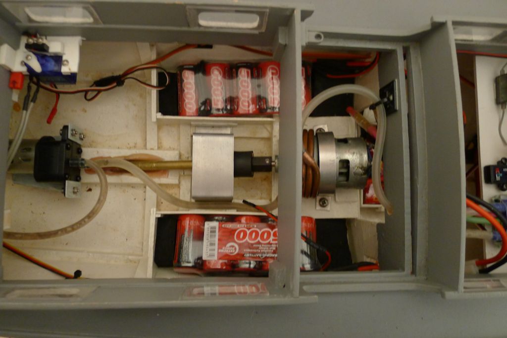

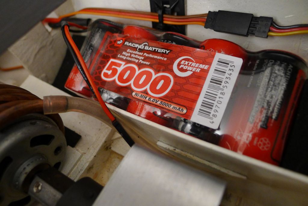

          Hi Grumps, I have a RAF Fire Tender of around the same size and hull shape as yours which was fitted with a single large brushed motor when it was refurbished a few years ago. I estimate the motor to be around an 800 size. It is powered from two 7.2 Nimh packs, connected in series to give 14.4V. This gives a suitable performance with the model planing at around half way down the hull. The problem is that it only lasts around 15-20 minutes. I have thought frequently about changing the motor out for a brushless equivalent but, like you, have been put off by the complexities of a new technology, buying new batteries, chargers, learning new procedures etc.. I am also put off by the frequency of failures of Lipo batteries that seem to invariably go in a spectacular fashion.
          If I was starting from scratch and knowing the limitations of my set up I might go for brushless but, I'm also quite happy with limited endurance and a technology I am familiar with.

            Thanks for this, Richard. Nice looking tender! Are speed controllers generally ok for 14V? I thought most were rated for up to 12V. I'd heard that Lipo batteries were temperamental – maybe something to avoid. But that does leave the possibility of brushless with NiMH, I suppose. I've assumed (maybe wrongly) that brushless are more efficient than brushed. Like you, I'm not too worried about endurance. I was mostly concerned that it would be difficult to get the boat to plane with a motorbike battery in the stern, or, even worse, further forward! Thanks again.

                                    OK, hands up, my apologies, It's got two five cell packs in not two six cell packs in so it is running at 12V. As they are 5000mah cells the motor must be pulling a significant current for it to only last around 20 minutes, (ball park, 15a?). The two batteries are separate but connected in series by a plug in lead. The motor and speed controller are cooled by another battery supplying a small water pump. The batteries are Component Shop batteries.
                                    Edited By Richard Simpson on 29/01/2023 15:54:28

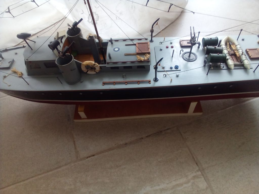

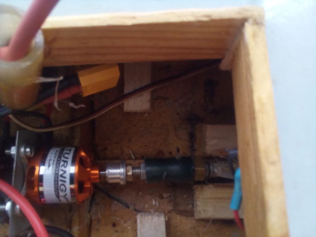

                                      A bit more practical experience for you to consider.
                                      I've an RTTL, it's about the same size as the mtb you're planning
                                      It's powered by a little brushless motor, a Turnigy 28mm 1100kv. I.e. It turns at 1100 revs per volt.
                                      If I use my 11.1 volt lipo, it is massively over powered and looks ridiculous, but great fun, and I've a throttle to slow it down.
                                      If I use a 9.6 volt nimh battery it's nicely over scale speed and runs for about 30 mins plus depending on how I drive. The nimh is a 4ah and the boat has a standard pitch 35 mm prop to keep the amps down.
                                      I chose to use one shaft to keep things simple, cheaper and lighter and consume less power than two would have, but that's down to personal choice.
                                      I've built a few quick scale models over the years, and I think one very important rule is to keep the weight down, it makes a huge difference. I build light anyway, but the advent of lightweight motors and batteries has made everything a lot easier. Don't even consider lead acid batteries, and seriously consider lipo ones, they are remarkable.
                                      If you do go for lipo, get a good charger, they make everything easier and safer, then just follow the safety rules.
                                      I hope that helps a bit.
                                      Charles
                                      #103713
                                      Charles Oates
                                        @charlesoates31738
                                        I forgot the pictures.
