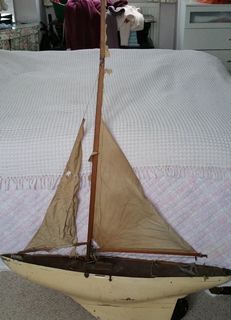

      I have photos of what appears to have been a very pretty boat which must be at least 50 years old, but I can't work out how to attach them to this thread (I am a new member).
      She is of great sentimental value to a friend and his wife. The yacht was given to her as a child by her father. She was brought up in a very poor circumstances.
      The boat is 90 cms long and the hull is about 23 cms high and is very heavy. She is called 'Pebbles' which is the wife's middle name and the hull appears to have been covered with gloss paint. But with some sanding it looks as though above the waterline was green and below a dark maroon.
      Having seen two of my scale R/C models and as a surprise for his wife, the husband has asked me to restore her or at least make her well again, which is a lovely challenge.
      I do hope someone can recognise this boat please. I would like to find some record of what she looked like in her prime so I can do my best to spruce her up. We are not looking to restore her to her original condition but if I could find details for instance of how she was rigged; whether there should be stanchions and a guard rail; whether the fittings are brass or painted black; the rudder/sail control and bow plate look like aluminium but I could spray in a brass. She will not be sailed but will be for display only.
      The lady to whom it was given apparently has no idea what it looked like when it was given to her. Given her childhood circumstances it may well have been given to her with rigging intact but maybe the hull had been painted then as 'Pebbles' is, as you can see, hand painted on the gloss white.

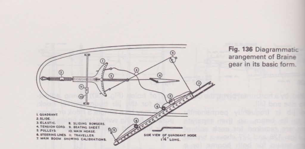

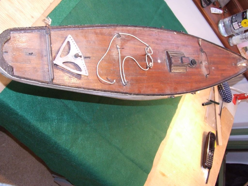

              The steering on your yacht is 'Braine' and attached is a sketch of how this would be rigged.
              Cotton Sails can still be obtained from Nylet.

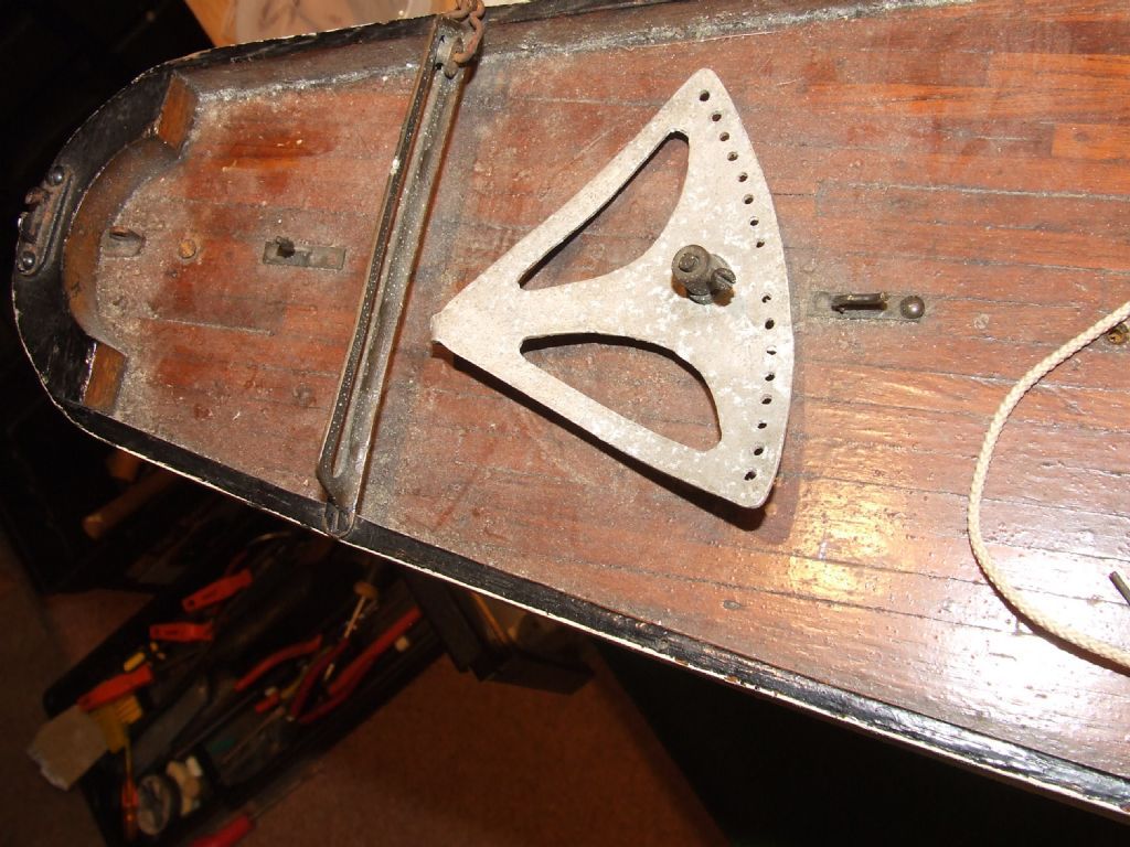

                ​Do you know what the quadrant would usually be made of? This one looks like aluminium but I wonder whether that would have been used on a boat of this age. Do you think it maybe an alloy that has been plated – say with brass or similar?

                  I've loaded your pictures, just to save you the aggro…….Hope you don't mind?
                  The main sail looks rather short, but notice there are a few remnants at the top of the mast, which could be the original sail?

                    ​Yes the original sail does go to the top of the mast which is broken just above the jib stay.
                    ​I took her into a local model shop today and the view is that it is probably a generic pond yacht.
                    ​Do you have any experience in restoring such gems? Nitromors on the hull and careful sanding (wet & dry) on the fitments – some are aluminium and others copper and brass. If the wood (pine) of the hull is good enough I may try and finish it as natural with a clear satin varnish. Otherwise spray red below and maybe white or green above the water line. What do you think?

                      Regarding the choice of material for the replacement Braine Quadrant, personally I would choose brass, but others would disagree, it's purely personal choice.
                      Replacement quadrants are still commercially available from Sails etc. in their vintage fittings range. Click on the drawing for the dimensions.

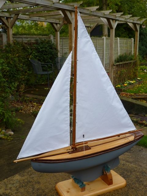

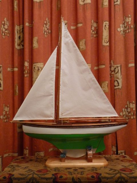

                        I was one of hose VMYG members at Warwick last weekend but I suspect we would stlll have struggled to identify your model. It does not have any identifying features that suggest it is one of the popular models such as a Star, Bowman or Ailsa.

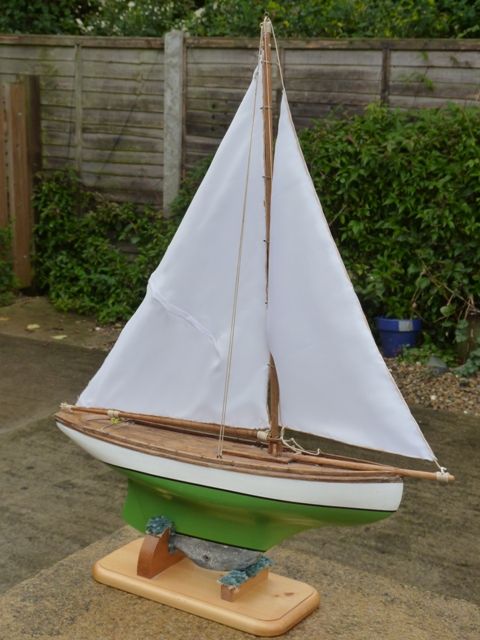

                        However, go along with your plan, strip off the old paint and varnish with Nitromors, give it a good clean up, paint it to your own choice, make some new sails and rigging and you will have a very pretty model. My wife Elizabeth refurbished a similar model for a friend of ours last year. It was around 70 years old and had been a gift to the owner's mother when he was born. He is a before picture:-
                        Here is one after priming the hull and test fitting the new sails
                        And here is the finished article.
                        The sails are made from a piece of cotton bedsheet. The normal practice is for the weft of the cloth to be parallel to the back edge of the jib and mainsail.  Typically the jib sail has about half the area of the mainsail and the height of the jib sail is about 75% of the height of the main.
                        The shrouds which support the mast and the sheets which control the sail/boom position were made from a stout white thread with bowsies made from short lengths of brass strip.

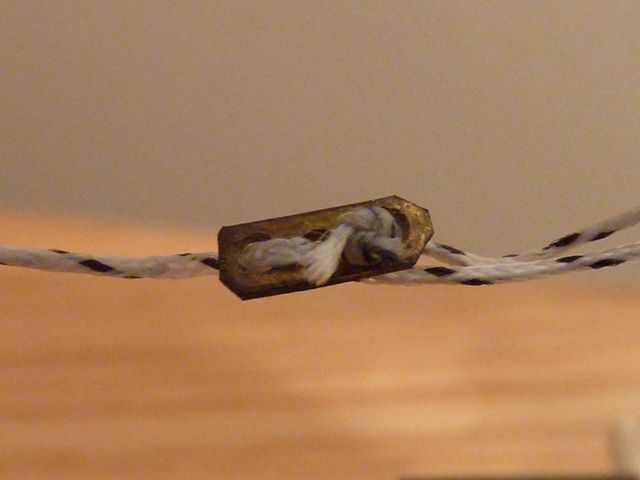

                            A bowsie is a simple rigging adjuster for letting control lines in and out.

                                Here is a (not very good) picture of a bowsie on one of our yachts. (its a bit small, about 6 mm long and 2 mm wide brass strip with three 1 mm diam holes)
                                The line is attached to a corner of the sail off to the left hand side. It comes through the left and centre holes in the bowsie then goes of to the right, through an eye fixed to the deck or mast, then back to the third hole in the bowsie. By sliding the bowsie along to the left, the length of cord in the loop is increased and the whole length becomes tighter. The tension in the cord and friction in the bowsie stops it sliding to the right and slackening off. The tighter you pull it, the tighter it grips, within limits.

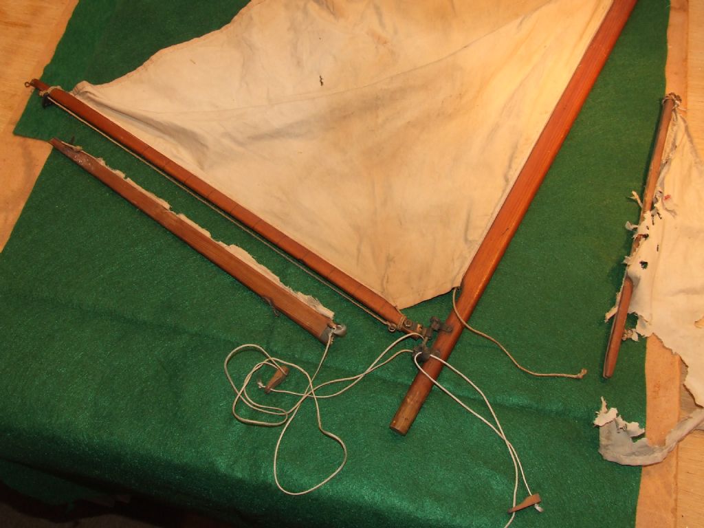

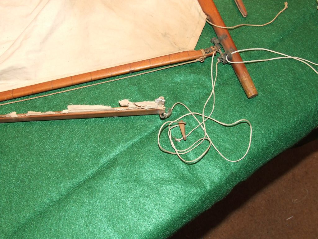

                                    ​As you can see there is a channel in the mast and boom for the main and I removed the old one by pulling a cord which was sewn (and presumably glued or stitched) into the hem.
                                    ​​So I think I need to sew a cord or glue s/s wire into the seams of the main and jib to either draw in or prod in the final sails. My wife has found a lovely piece of creamy cotton, almost like hessian that I think would be ideal for the sails.
                                    As you can see from the second photo, the jib 'arm' (what do you call the 'boom for the jib&#39 also has a channel in it and is has been nibbled! I'm guessing that the sails and that piece of wood have been a tasty meal for mice!
                                    ​Comments, criticisms and all suggestions are most welcome. I started the paint stripping yesterday. Under the gloss white is green; under the green is blue; under the blue looks like white and the base wood looks as though it could be dark stained. Am buying shares in Notromors.broken mast.jpg
