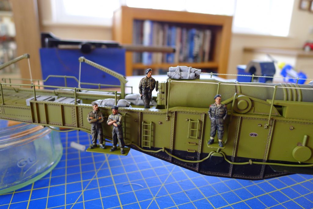

          Mark, for 1:33 scale I am sure that you could use either 1:32 or 1:35th scale figures and accessories. In which case there are huge ranges of figures in those scales amongst the plastic kit manufacturer's offerings for, mainly armour, based topics. These can be modified of course to suit any other setting. I have used tank crew and field kitchen figures to create deck crew for a coaster.
          There are also white metal figures available from Mountfleet Models and Dean's Marine as well as other model kit suppliers.
          As for a kort replacement have a look at the Mobile Marine Models website. Have you tried a repair on your cracked one? Slightly opening the crack with a scalpel blade and allowing some very thin cyanoacrylate glue to go into the crack by capillary action would be a very strong and effective repair.

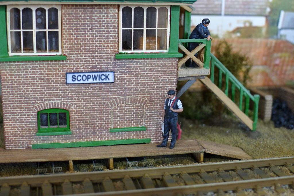

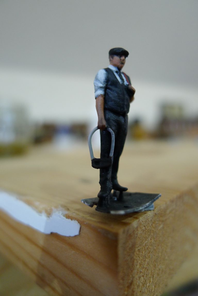

              The majority of general suppliers of railway figures tend to be either OO gauge, which is 1/76th or O gauge, which is 1/43rd.
              If however you go to the specialist figure suppliers such as Hardy's or Modelu then they do all their figures in a wide range of scales, including 1/32nd. 1/32nd scale in railway terms is Gauge 1.
              Modelu
              Hardys
              Not the cheapest but the quality of the figures are superb.
              These are OO gauge and a mixture of Hardys and Modelu

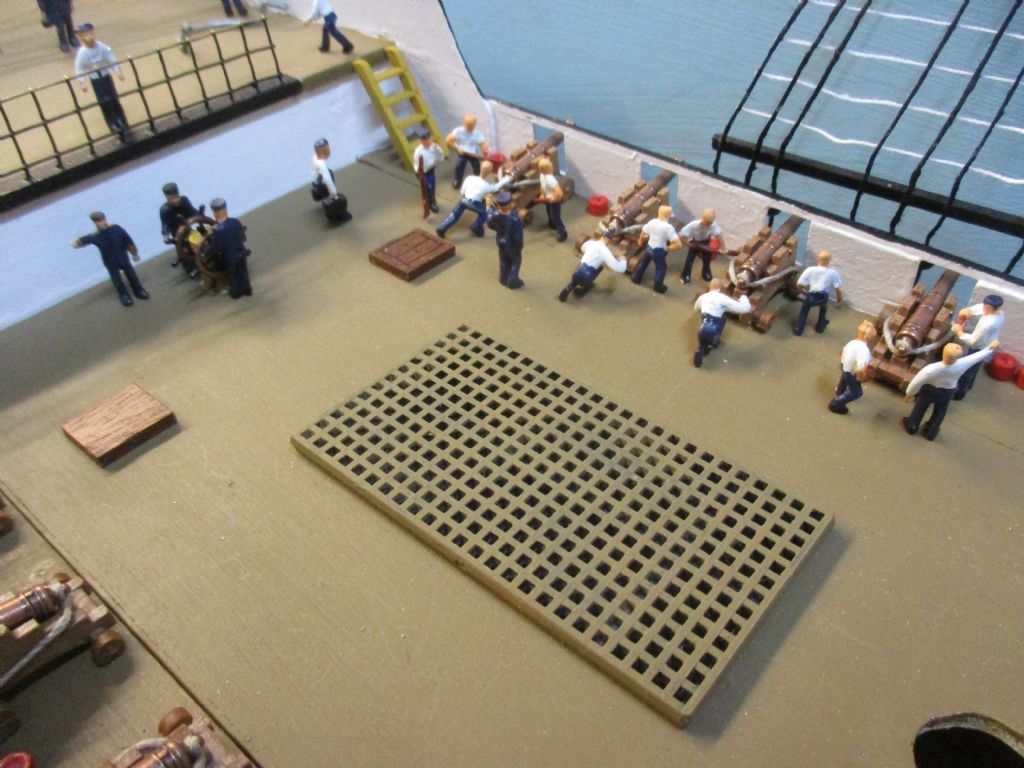

                                    Richard is of course right in that the figures have to look right, but a bit of cheating can even things up. LIKE putting figures next to something they ARE in scale with, and keeping them away from (for instance) doors if the figures were either a bit tall, or short for the doors.
                                    Without rereading the posts (as I a typing!) I would sooner see figures on a vesselimg_0515.jpg rather than not.
