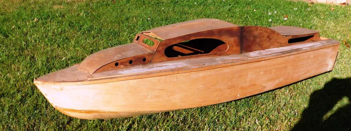

      Two days later the Sea Queen arrived .
      I had already bought it my dearest !!!
      So onto the boat, someone had just stop on it !!!
      50 pounds for the boat and 50 pounds postage via E Bay Global Shipping.
      It would have cost more in just postage within Australia !!!!!!!
      So this how the boat arrived and as per the pictures on E Bay.

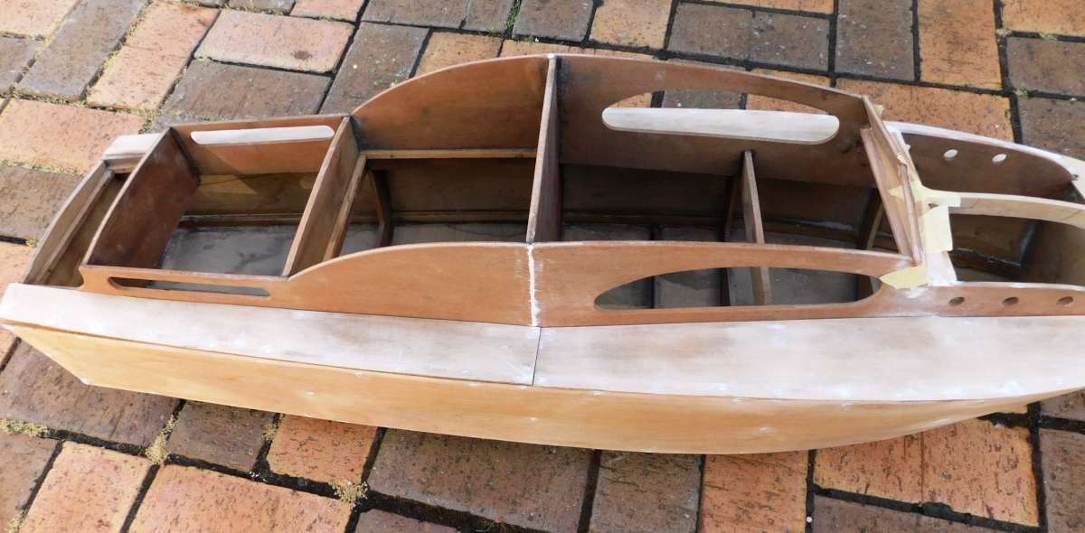

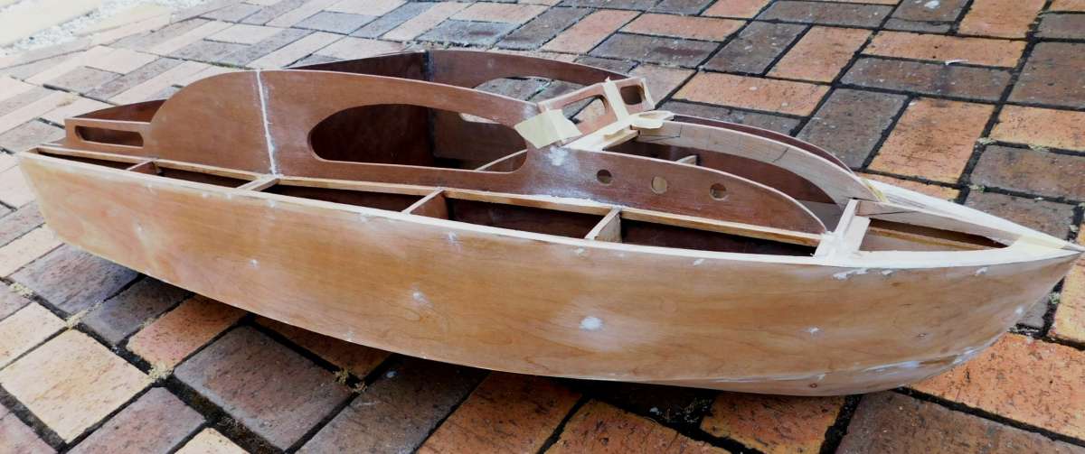

            HI All
            All the decks are off, cutout the bow section for reglue-ing as well as all the frames and stringers inside.
            Re-made the forward roof frame and added more timber to the back of frame 1.
            The new deck is going to finish at the back of frame 1 because that  I can save the deck skins.
            I have de-nail a lot of the boat and going to add chine rails to the boat.
            The motor is a Turnigy L5055C-700kv which I plan to run on 4S for about 10,000rpm with a 50mm CNC 3blade prop.
            I have started restoring the stern cabin roof, but the forward cabin roof is to be replaced.

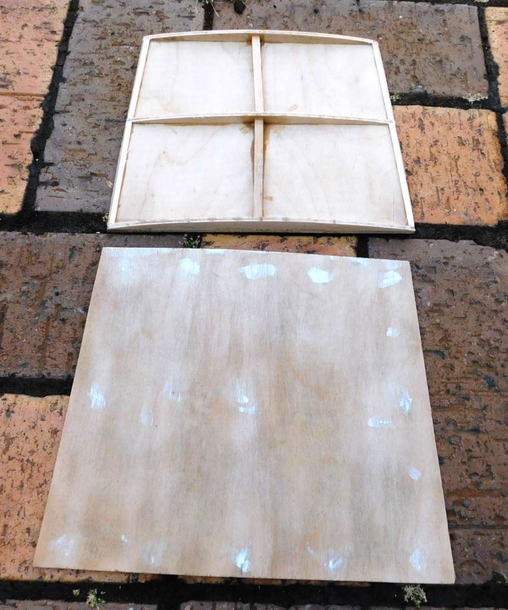

            #127377
              Hi All

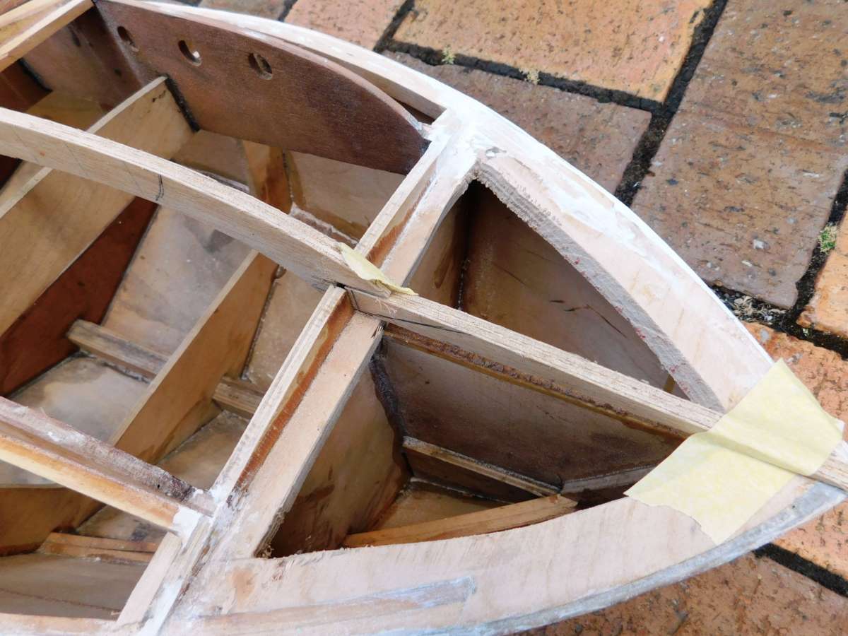

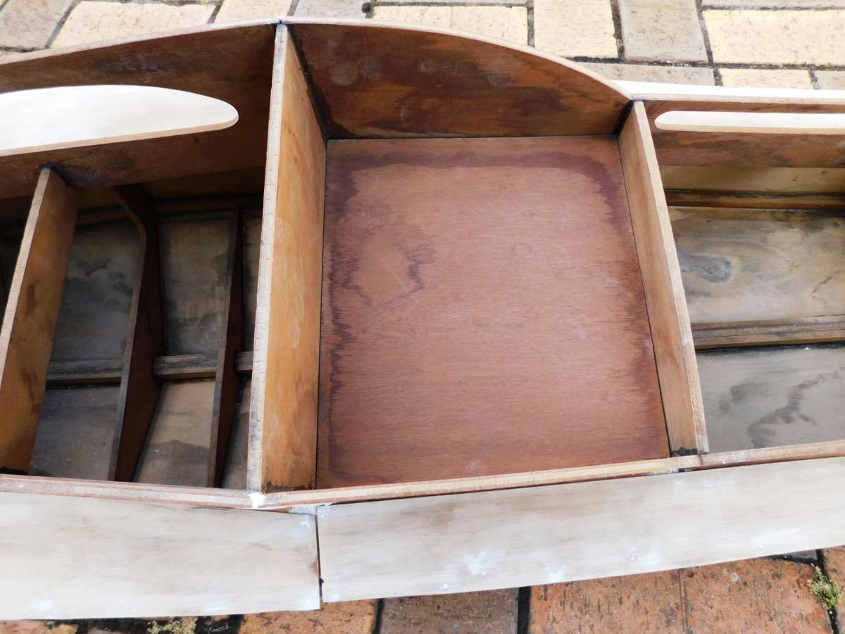

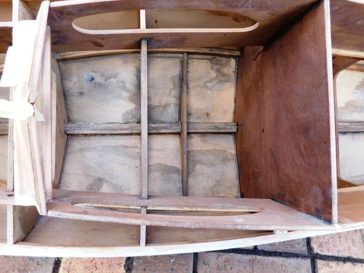

              A bit work on the boat with new forward deck.
              I was not happy with the forward cabin fixed roof, so I am making new ones.
              The stern bottom skins look a bit flexible, so I have add double stringers to the last two sections.
              The rudder hole is far to big, so that will be filled in and re-drilled later.
              HarryStern 2Bow 2ForwardCabin RoofBow 3Stern 1
