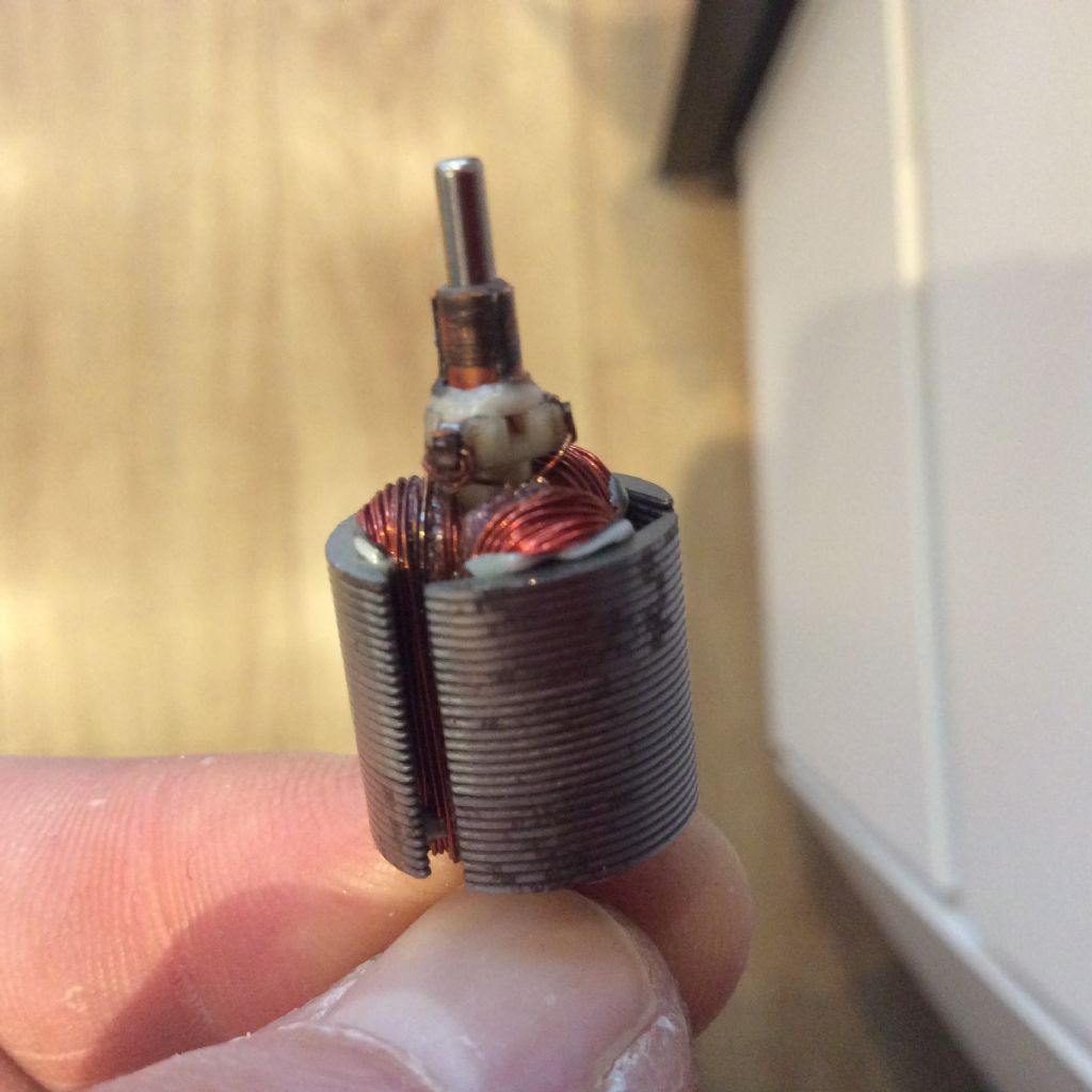

                    Unbelievable coldness at pond this morning by the new owner of Hornet was happy with it.
                    Lifeboat was ok until one motor packed up. Looks a bit melted. Maybe a 385 would be better than a 280? Happier at 7.2 all the time what with it being driven hard by and 8 year old!

                      Yes that’s cooked!
                      They really should let children do product testing, if anything can survive abuse from children you’ve got a winner!

                        Weight is the issue regarding a 385' and it would be slow on a 7.2 stick with the small props.
                        A speed 280 should be on on 7.2v. Never had probs before….

                            What if I offset the motor weight with a lipo stick?
                            Don’t have a lot of luck with motors, I remember melting a 380 in another boat last year.
                            I will let you into a secret, the port side motor also melted too in a bath test last week, so it’s either me or summing else. I had a spare armature so I whacked it in and it was ok.
                            Hornet was awesome though. Very big difference between a Nimh and lipo stick though. Interesting that.

                              How much prop was it trying to drive? That kind of damage is sually a sign of the motor being overloaded at the voltage its being run on.

                                15mm or so 3 blade. Propshaft felt tight on top bearing so maybe that was it.

                                  They are 20mm props, Cast brass 3 blade, From prop shop. I never had an issue with the motor/prop combination before, and I didn’t hang about! We could try the wattmeter on the boat with one motor connected to see if there is an issue? I have couple other boats with speed 280, no probs at all.

                                    The top bearing on the propshaft of the melted motor was very tight. Dunno why – perhaps it overheated?
                                    I had put a drop of light oil on it, but didn't overdo it as the couplings were grub screwed on.
                                    I have run a file up the bearing and now it turns freely. Filed a flat onto the end of the propshafts so now the couplings attach much more positively without stressing the plastic collars. Means I can be more liberal with oil now.
