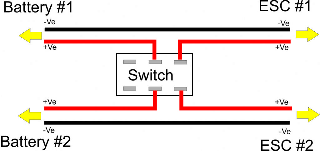

                  how do i wire two esc to two batts and one switch thanks
                  #60001
                    You use a suitably rated Double-Pole Double-Throw (DPDT) toggle switch like this. I would suggest 15A-20A rating. This one should do the job. **LINK**
