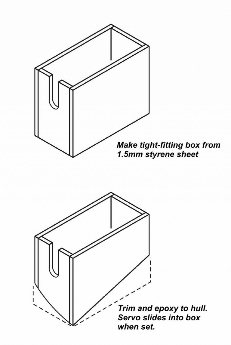

          Phil
          The problem is that there are so many different shapes and sizes of GRP hull. This is the method used by Model Slipway. It's easy and cheap to make. The servo is a firm sliding fit into the box; there's no need to screw it down as long as it doesn't wobble about.

                @mikefarrell21522
                Hi Phil As Dave said build your own .Every member on this forum will have scrap ply and I,m no different ,I custom build all my own .Cheap and satisfying ,Dave has done the drawings so satisfy yourself and make your ownwinkMichael

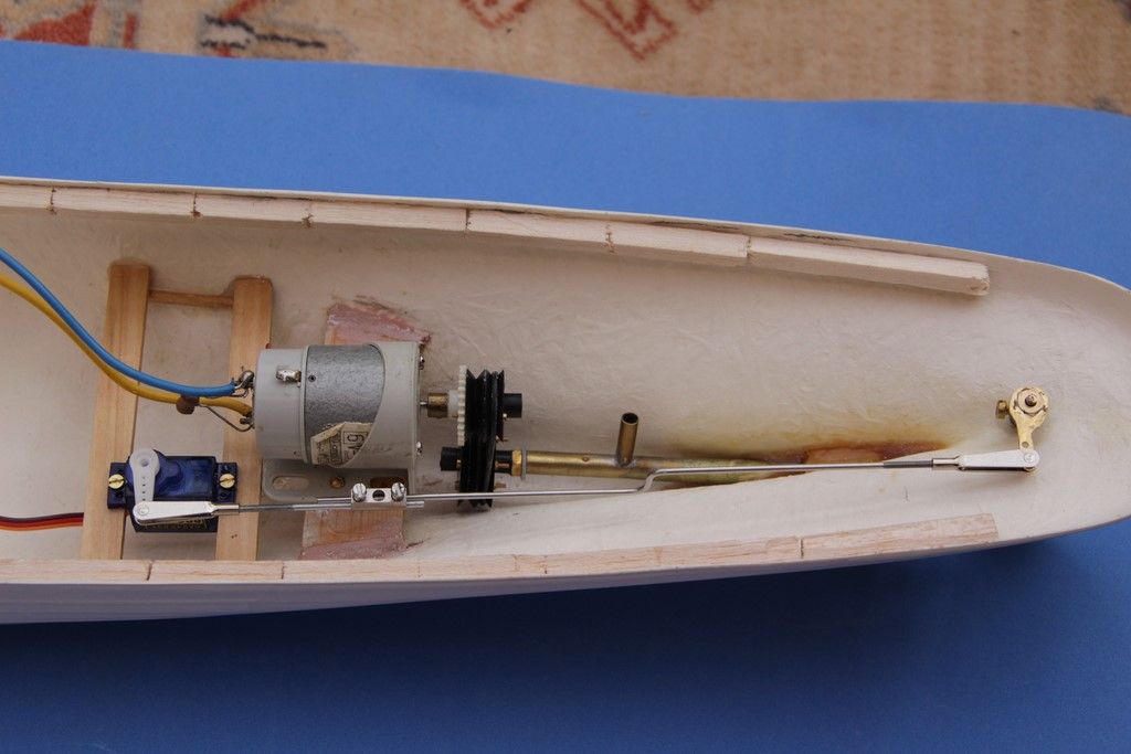

                    #55872
                      I usually simply epoxy a couple of pieces of spruce or lime stripwood across the hull at the required height and spacing and simply screw or bolt the servo between them. Easy to remove if you ever need to.
                      See pic below.

                                @charlesoates31738
                                The tried, tested and much used method is exactly as Colin has posted. It’s been used in countless grp hulls. It only takes a little time to do. It’s neat, you can remove a servo easily, and you can change the position if you need to. As the old saying goes, do it right, do it once.
                                Chas.

                                    I didn't see that one, Mike, but the job isn't one I'd buy anything especially for. Anyroad up, m'duck, who's to say that the clip will fit my particular servo exactly? If I have to modify a commercial fitting before I can use it then that rather defeats the point of buying it – which is to save work. If I make my own mount from styrene, plywood or hardwood beams then it's bound to fit. QED.
                                    #55904
                                      Most of my servos are mounted in little boxes made from plywood and balsa (as per previous drawing) and wedged in with a bit of card. Not had an issue yet with this. Does it for me.
