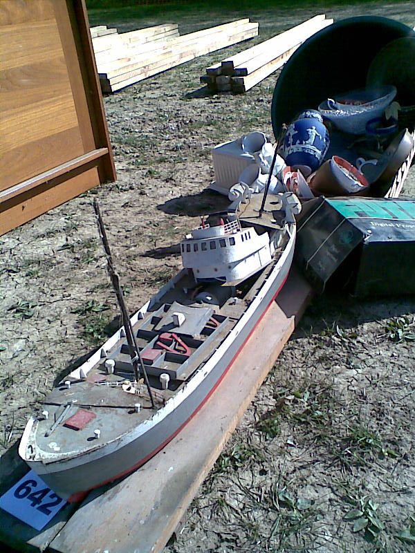

      I recently made a rash desicion and purchased a total wreck of a hull in the belief that with a lot of patience and some skill I could restore it.
      When the said hull arrived I have to admit I thought at 1st “this one may be past help philip” so she was placed out of harms way for future attention.

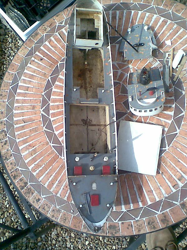

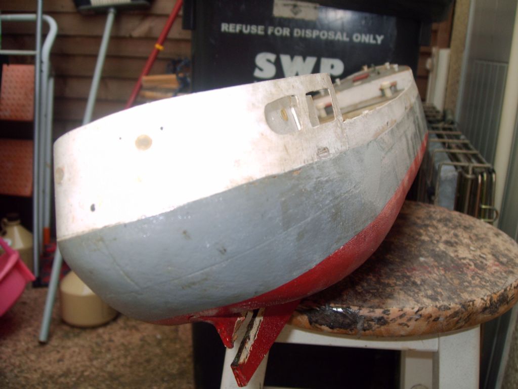

      then I thought what the hell give her a chance so here goes. The following pics are what I’d seen of her before purchasing for a really poultry £12
      Not so bad I hear you say
      then again may be not
      then again the basics seem to be intact so lets have a go

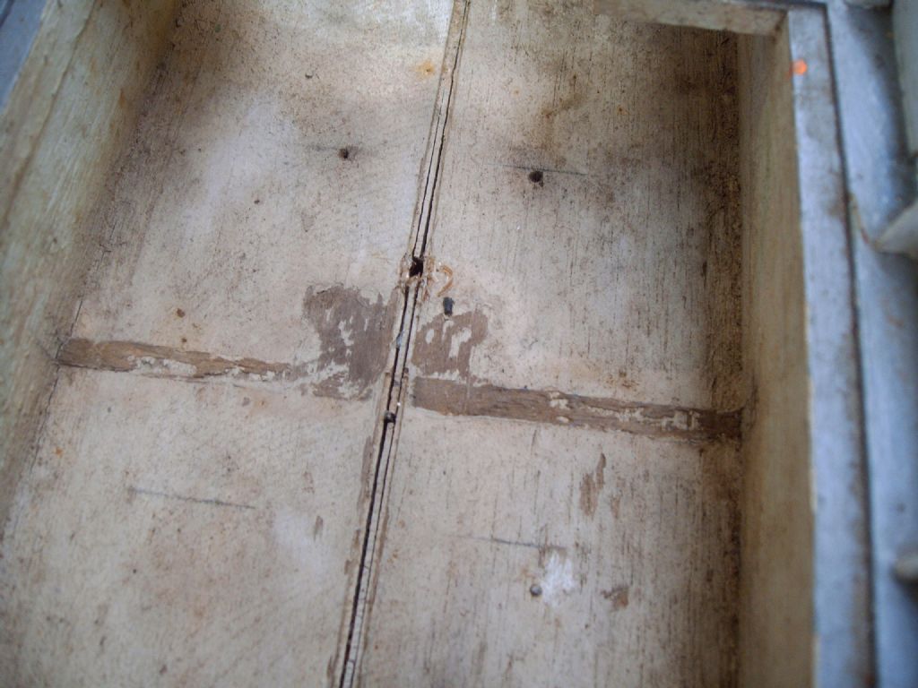

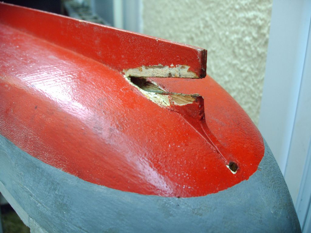

      When she arrived I realised that the problems where not explained in the pics. mainly the ply keel de-laminating was the bigest problem. however this problem was solved with a self mixing syringe of epoxy that could be squeezed into the gap and then copius clamps to hold her true and problem solved. A little 5 min epoxy has cured the rear shelter walls dislike of the hull and so with these issues solved I can now set about stripping paint and checking the rest of the hull.

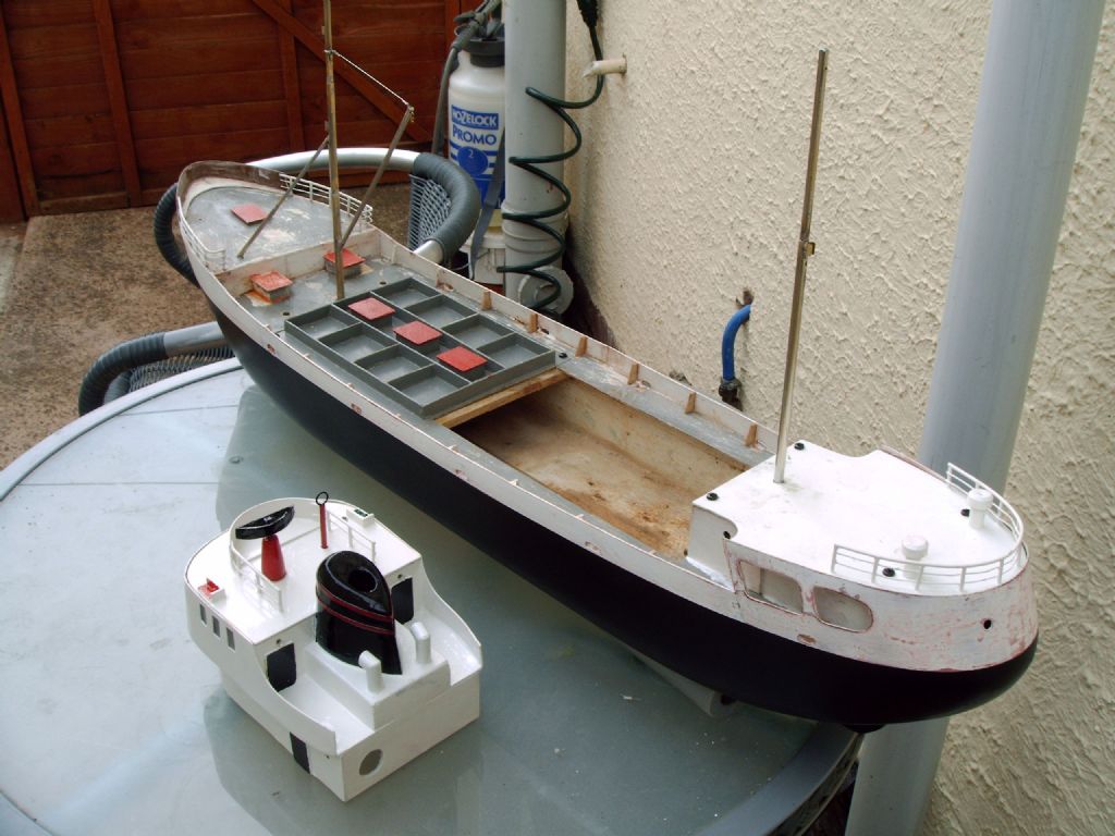

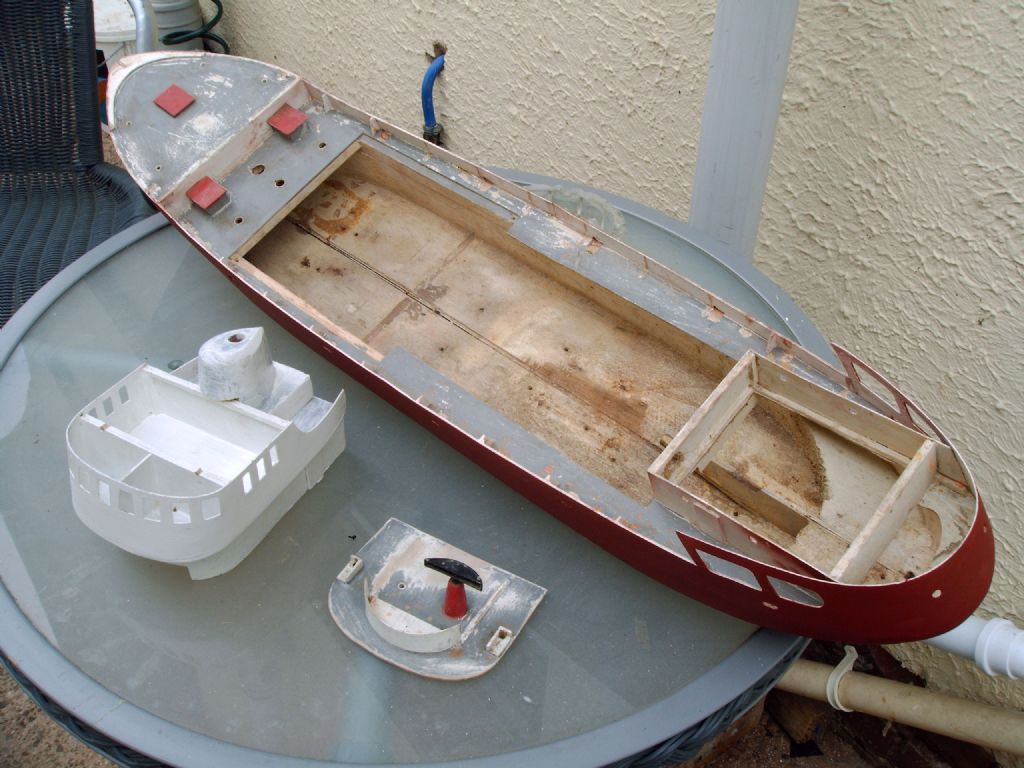

          a few pics of progress

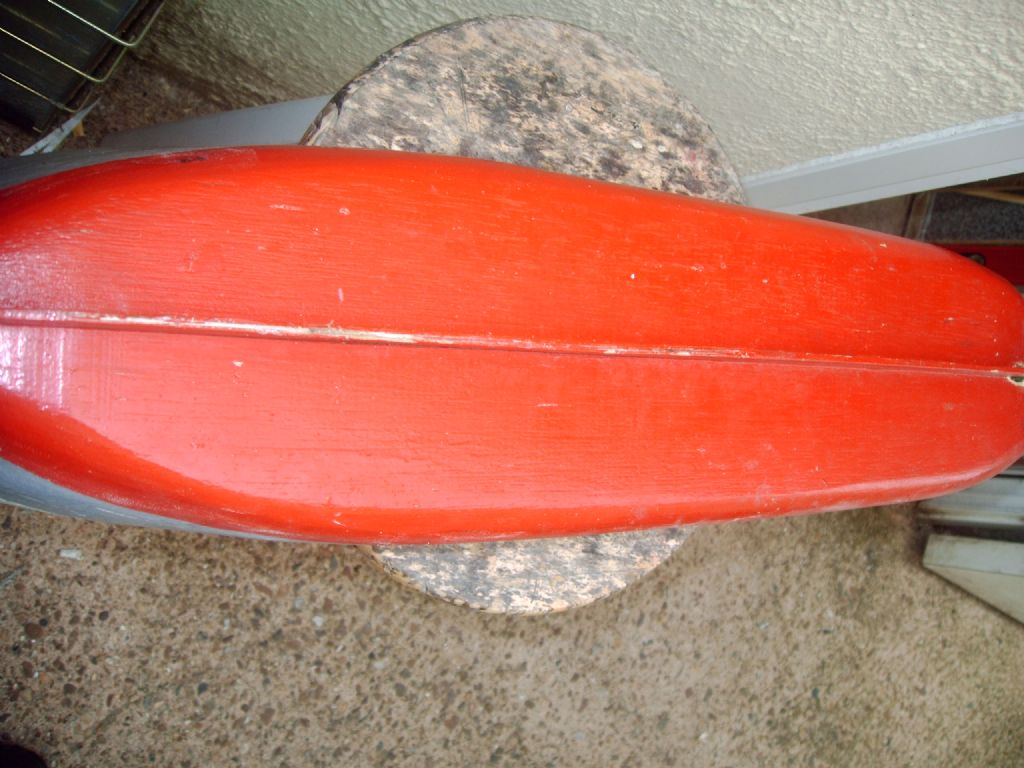

          the ply keel repaired and stronger than ever
          stern tube removed pending replacement
          the hull interior needs a little cosmetic work
          the gunwales and shelterdeck walls all secure
          And she’s ready for the paint removing

              Having read Pauls thread on restoring such models I was thinking of using paint stripper to fetch her back to bare wood as he recomends.
              However that may cause problems with this hull as its all balsa and I’m concerned about the absorbtion of A: the stripper, and B: the water used to wash it of, by the balsa and any issues that may arise because of this.
              So I’m simply rubbing her down thoroughly with sandpaper. already, I can see that this was never done properly as the hull sections where produced on a spindle moulder, and  the machine marks are quickly visible as soon as I started to rub her down.
              Weathers awfull today and given that these may well be lead based paints I’m doing the rubbing down outdoors with a dust mask, so as soon as I can I’ll get some more pics to show what I mean about the machine marks.

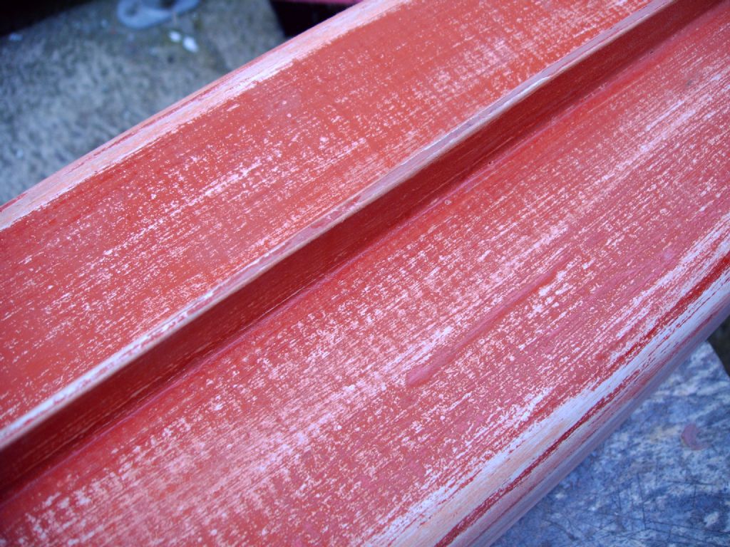

                    Here you go Bob as you can see from this pic the machining marks are so obvious telling me that she’s never seen serious sandpaper useage
                    Phil

                      Don`t suppose it matters, underneath really?

                        Prob doesn’t Bob but it does give an idea of the amount of effort put into the rest of the build I’d hazzard a guess it was built much as intended ie: quickly hence the water ingress into that keel. it’s not got anywhere else so prob happened while sailing due to an  inadequate paint finish/ quality. Having said that it is some 40/50 yrs old (we believe)
                        so provided the job I do is up to scratch then it should out last me.

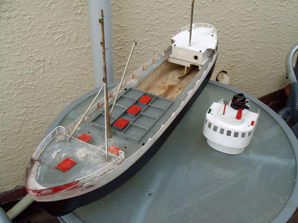

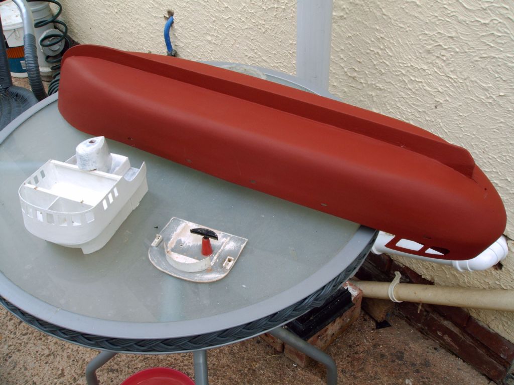

                          I’ve progressed a little on this one. the 1st coat of primer is on the hull outer. I think I’ll be following this with some high build filler primer, as despite best efforts the wood grain is still showing through, and there’s plenty of grain filler already on her. the bridge is starting to clean up ok too, in fact it’s nearly ready for the rebuild and lights etc fitting.
                          Next major job is to get some 1/32nd and 1/16th ply and rebuild the main deck and bulwarks around the bow

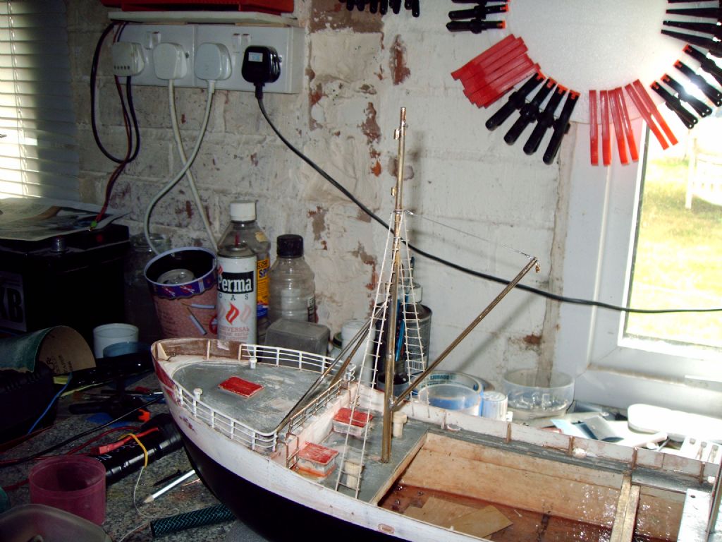

                                  I got the railings fitted to the bridge roof on the trawler today and with a coat of white primer applied it’s showing promise. some more time available to work on her tomorrow so hopefully some good wip’s after that

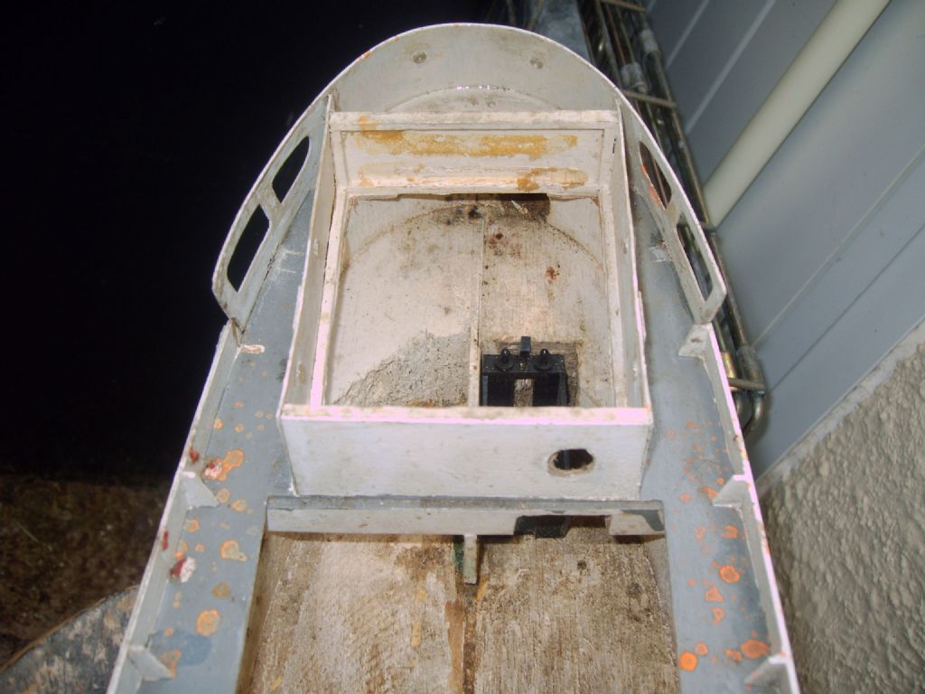

                                    the preperaton of the bridge and boat deck for primer took for ever! Or so it seemed!
                                    however with new railings and a coat of primer they’re starting to look a lot better
                                    now I really need the new ply to make the boat davits and a copy of the boat deck outline to go under this for support to the top edges of the shelterdeck walls, a very vunerable point when the boat deck is off to access the radio and tiller servo.

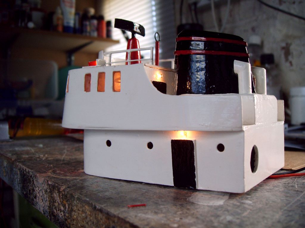

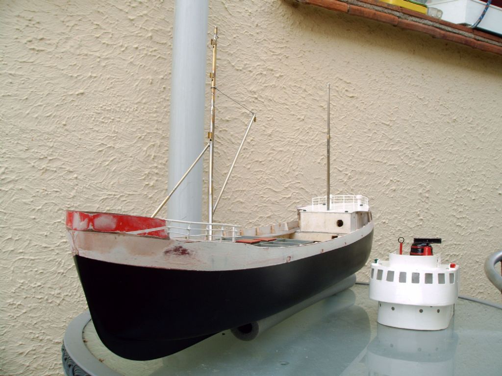

                                      A little more progress during one or too quiet moments prior to our trip to N/Wales next week.

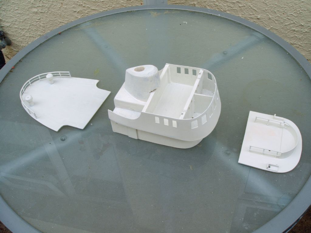

                                      The bridge is finished and wired for lighting, (more lights than last years Xmas tree)
                                      The forcastle has its prow bulwarks and most of its hand rails.
                                      The masts have been fitted along with provision for a full working set of mast head and trawl lights. (I do like to light up a boat.)
                                      The boat deck still needs its boats when they return from wales all nicely cast in prolypropelene resin courtosey of MMB
                                      Next job, After our hols now, is to paint the decks and insides prior to finding and fitting a suitable motor and the rudder.
                                      I just love this view of her looking really purposefull
