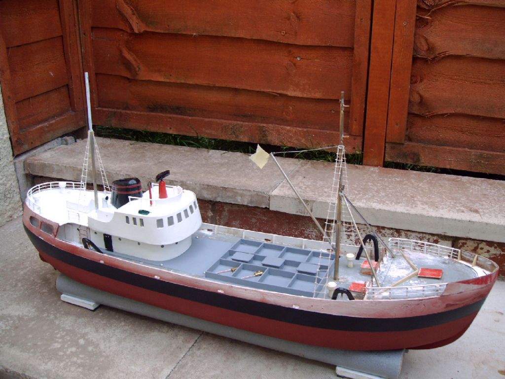

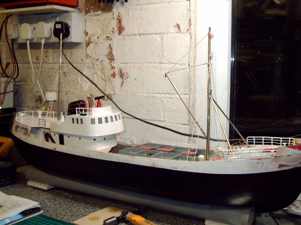

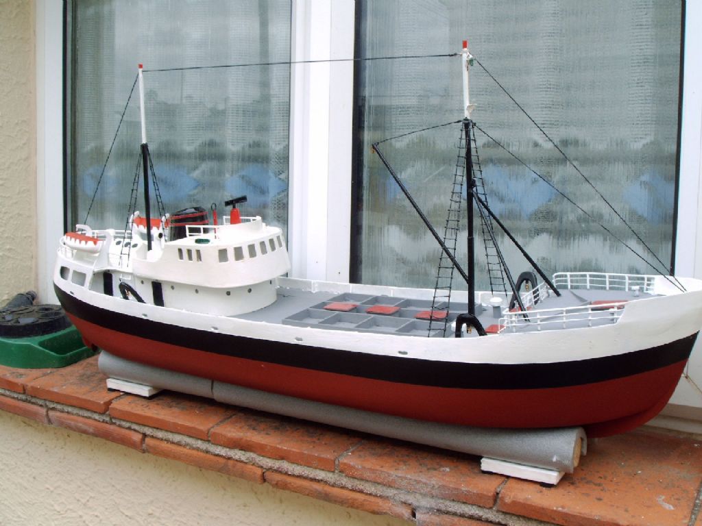

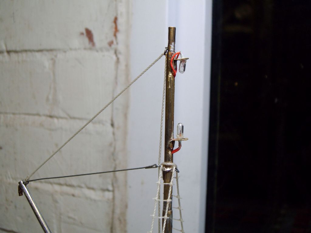

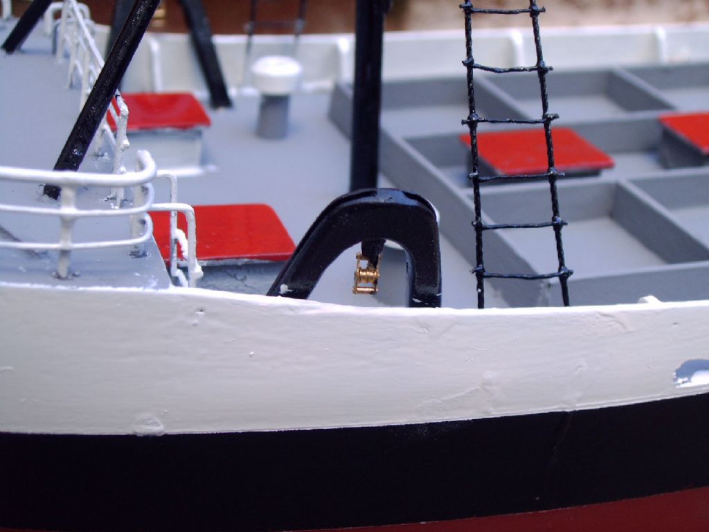

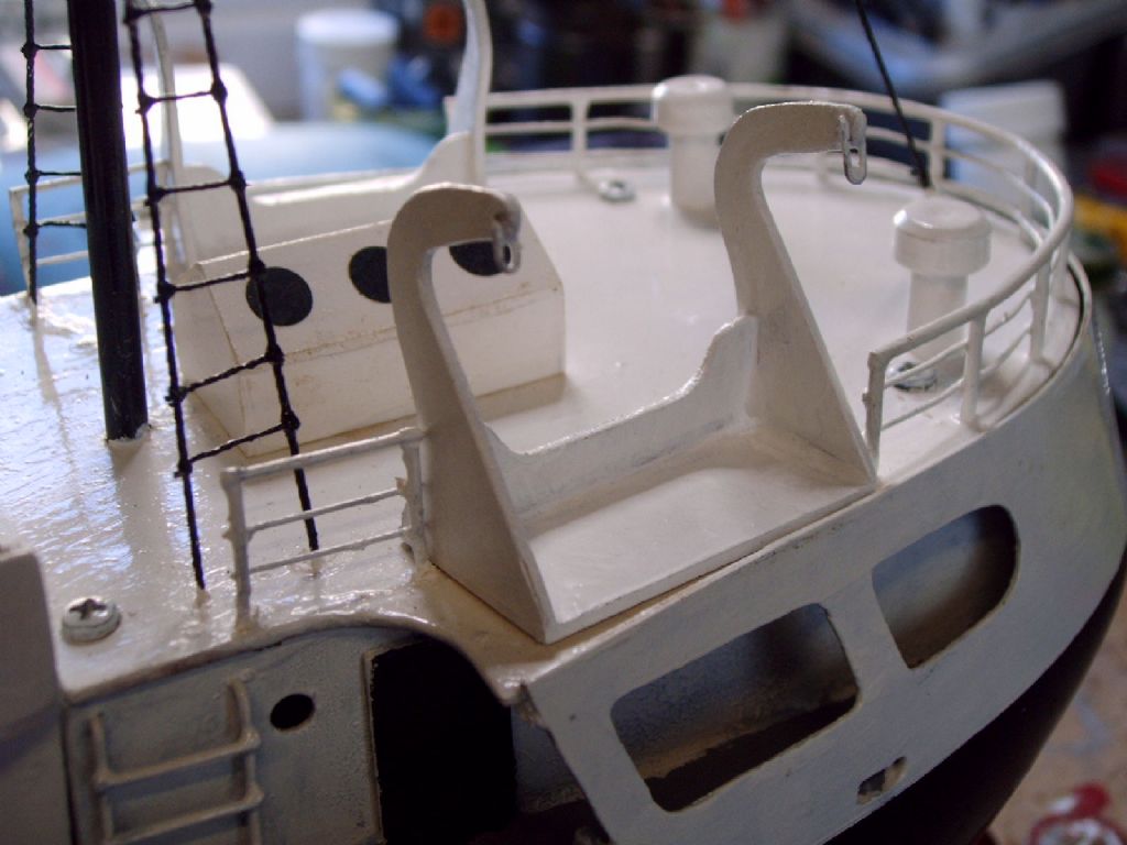

            A couple of WIP pics. Ive just about sorted the masts c/w ratlines and working lights inc the fishing lights wich will eventually be a 360degree green over a 360 white and the standard steaming mas thead light about 2/3rds up the mast
            and the 1st of  the trawl gallows has been made hopefully this looks about right.
            and a general view. the 3/32nd ply for the main deck repair arrives this week
            Phil

              Phil – as per post in my own Veron Trawler thread – don’t make the davits!  – I’ve got some original not-even-cut-out ones you can have.

              Phil Winks 1
                @philwinks1
                Hi Mike I must’ve missed that post mate although there are a couple of reply notifications I’ve yet to look at. shame really as you can see from the pics I’ve done all 4 however if the originals look better then I’ll take you up on that offer! PM tofollow shortly.

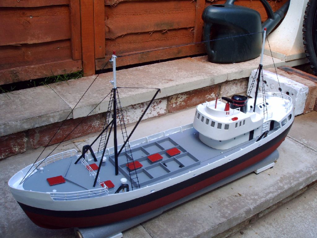

                As you can see she’s waiting for her main deck and bulwarks painting then a couple of winches and those lifeboats need fitting.

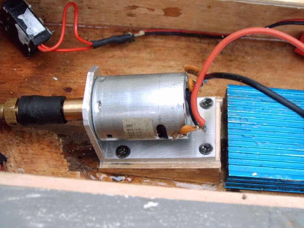

                Most of the running gear is sorted and 1 point I must make is the sheer quality of these MMB motor mounts justlook at the close up
                Truly a superb bit of kit and nicely priced as well.

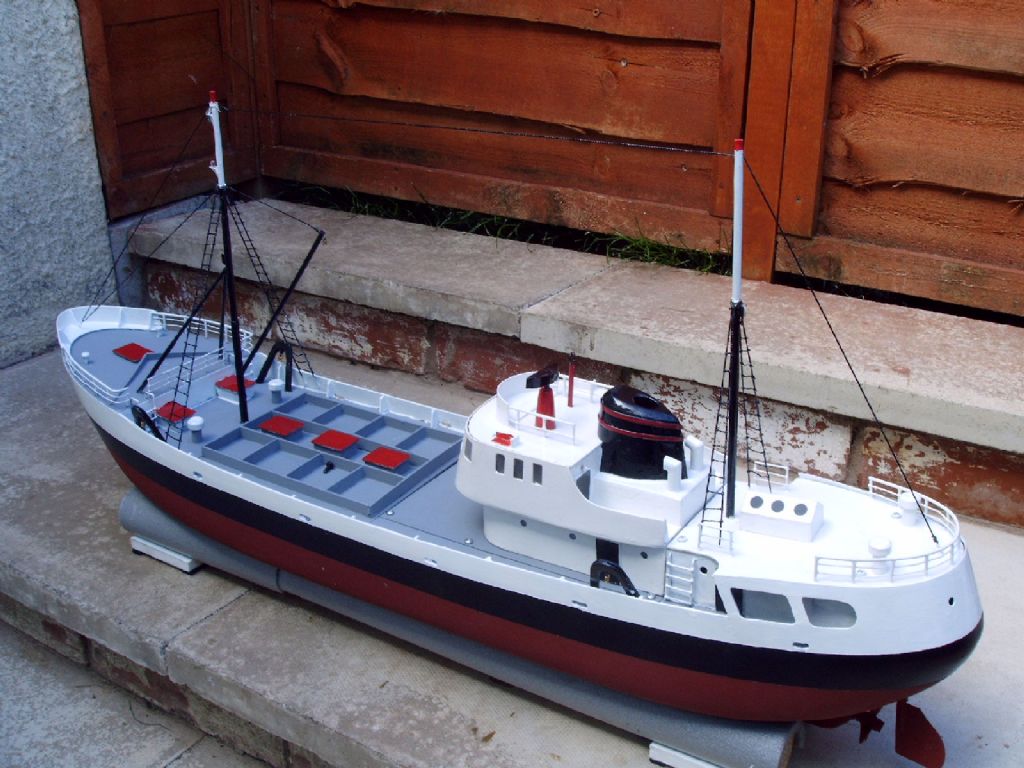

                      The paintwork has progressed well today as it’s been a glorious paint drying day all thats left to do is a little touching up of the main deck.
                      I still have to source/make the winches, fit the davits which Mike is kindly letting me have some original items then obviously fit the life boats, also the portholes at the rear need glazing and as far as the hardware is concerned all thats left to fit are a couple of switch units for all the lights. I reckon that after a breif sojorn in the domestic test tank (bath) she can get out on the water for the 1st time in prob 30yrs. Hopefully I’ll get a video of that later this week.
                      Right now the pics
                      Thats about it for now
                      Phil

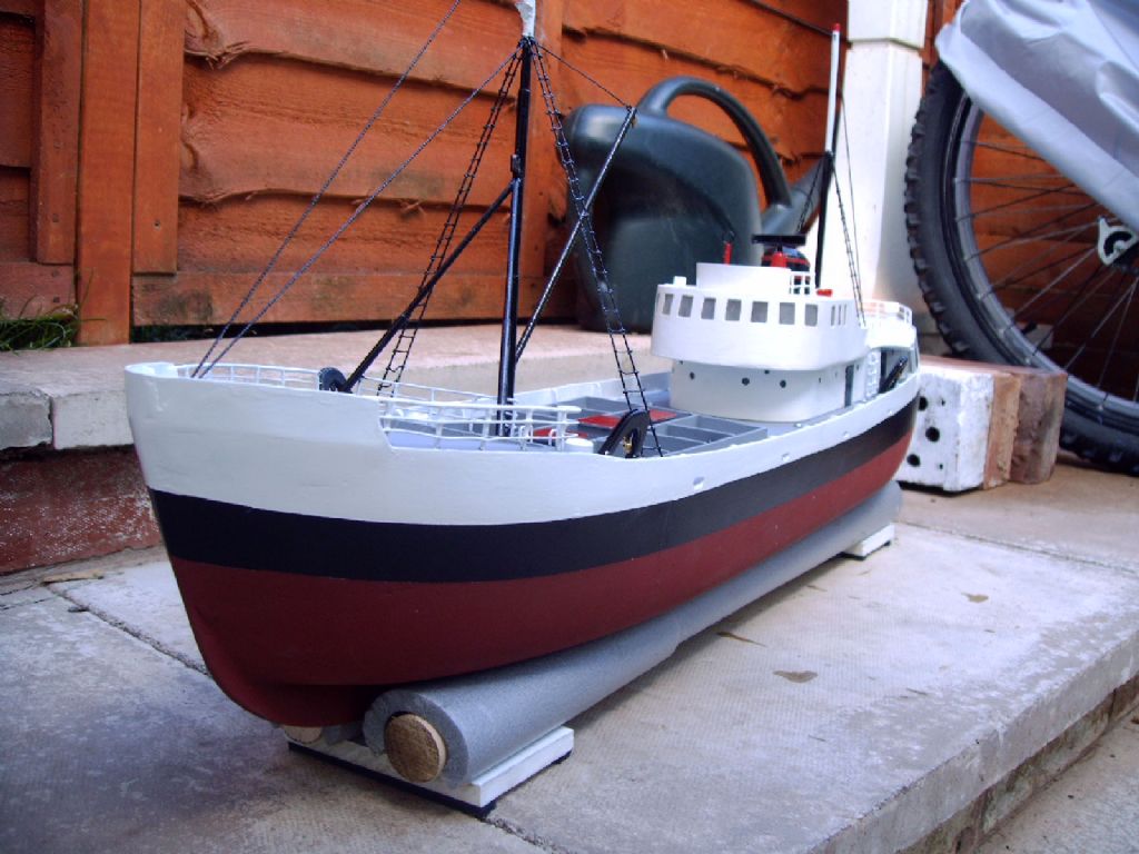

                        Well she’s had her bum wet at last and the results are very pleasing just look at the video
                        Phil

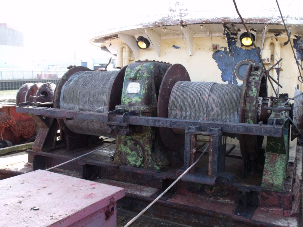

                          For when you build it – here’s a couple of pictures of the trawl winches on 1, Ross Tiger (the real thing) and 2, –  My Veron trawler, a scratch built affair based around two cut down film spools and plastic strip.
                          PS have sent message r.e. email
                          Mike

                            Well done, Phil
                            She sails very nicely and so quietly too?
                            You`ve got the balance just right……..How much ballast was needed?

                              Thanks for that Mike those photo’s are really just what I need.

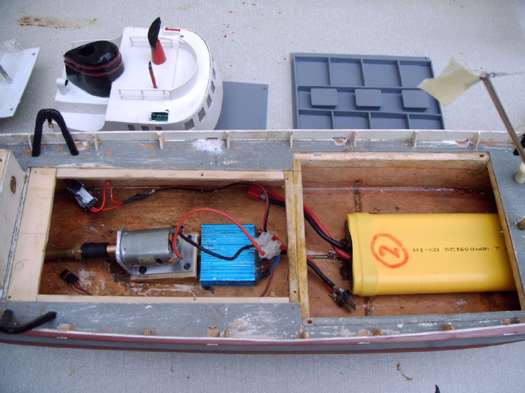

                              Hi Bob me auld mate it took 26ozs of lead and a 12cell (2x6cells in parralel) nicd bty pack to achieve that nice balance and depth in the water.  Lots of wood in the bottom of the hull in this one!
                              The lack of noise is down to good motor/propshaft alignment and most importantly an MMB rubber coupling. absolutley so much better than those plastic huco couplings I used to use and cheaper too!!

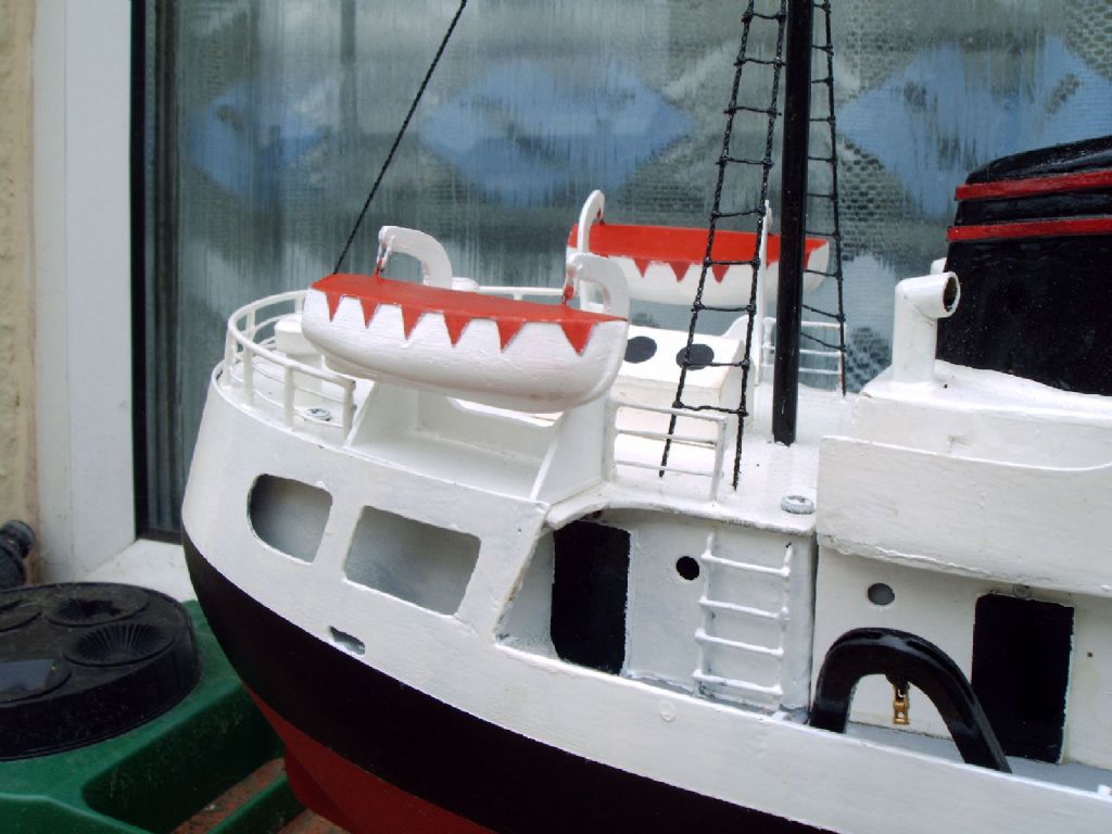

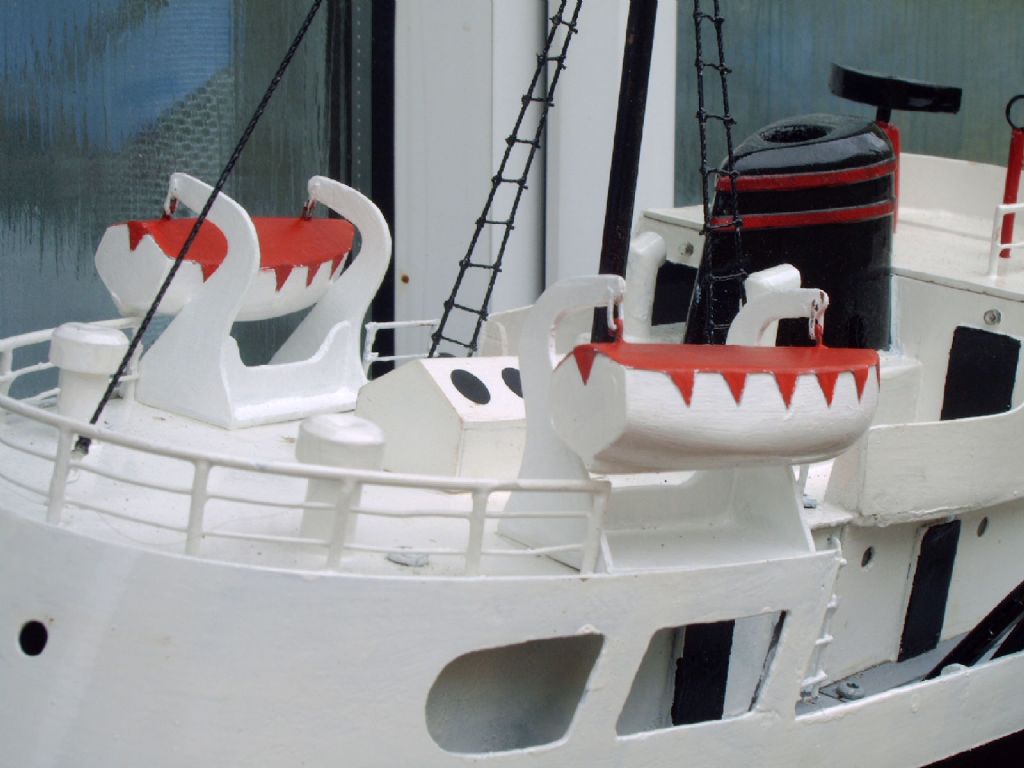

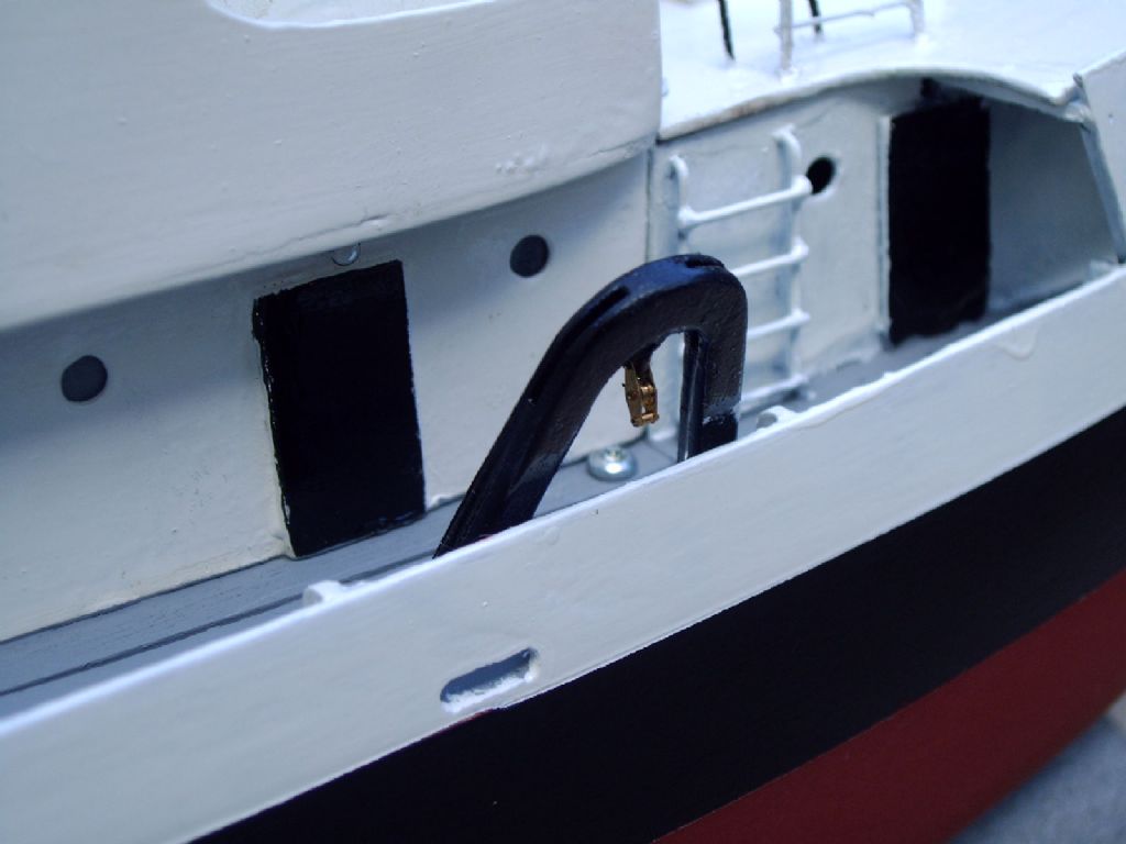

                                A special thanks to Mike Gott for supplying the parts for the replacement davits. They are the original items from an identical kit he’s recently built (it had resided on top of his wardrobe since 1967). This is said items with their 1st coat of paint dry fitted on the boat deck.
                                Full size picture is app 3 time actual size
                                the life boats should be ready early next week and then I need to concentrate on the winches
                                Phil
                                #28007
                                Phil Winks 1
                                  @philwinks1

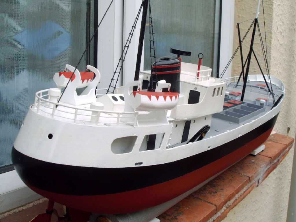

                                  The replacement life boats arrived all nicely moulded in polyester resin by MMB from a master I made from the one remaining boat.
                                  Once again thanks to Mike Gott for the davits. Original items from his kit.
                                  I’ve started on the construction drawings for the winch and need to talk one of my freinds with a lathe into turning the drums out for me
                                  Also need to find some 6 or 8mm tall black letraset or vinyl lettering for the name.
                                  Phil

                                        Looking good, Phil. I’ll put some more winch photos in my album.  On my own trawler, the winch is 110mm wide and the drums 22mm wide, 25mm diameter if that’s any help. The smally pulleys on the end (“gypsies”) are about 1cm – but there’s plenty of scope for variation.

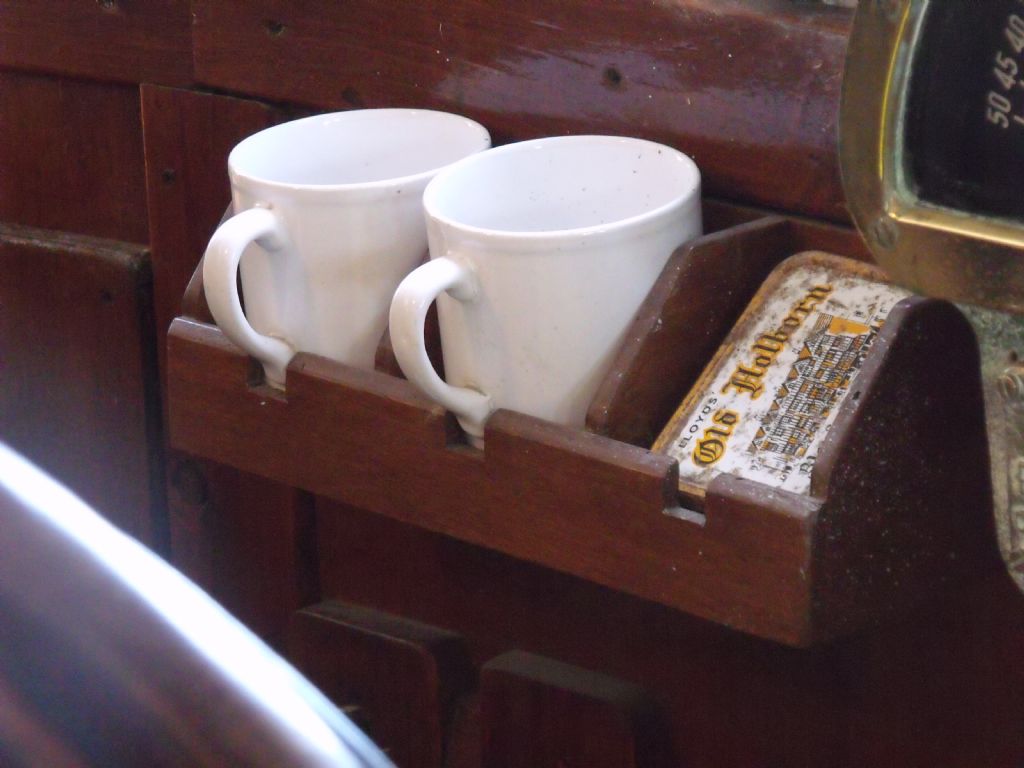

                                          Found this in my Ross Tiger photos whilst uploading the previously promised winch shots. How about replicating this bit of bridge detail -the shiny thing in the bottom left hand corner is actually the wheel.
                                          Mike
                                          #28030
                                          Phil Winks 1
                                            @philwinks1
                                            Now there’s a clever idea nowt worse n spillin ya tea  and the baccy tin dates it a little bet their not allowed to smoke on the bridge these days

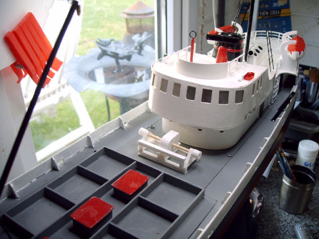

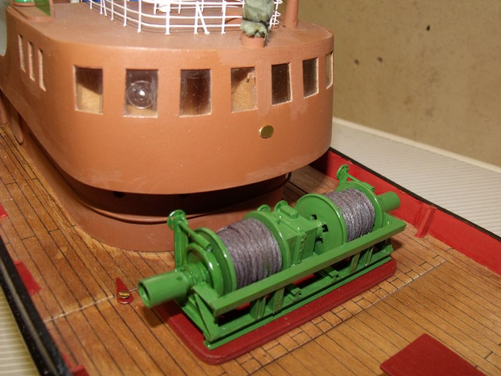

                                                  Here we go the plans for the winch complete and emailed to Bob for him to turn the drums for me. while I set to and made the frame.
                                                  the shaft end plates and end drums (gypsies) are loose fitted waiting for the drums to be fitted
                                                  How’s that for “Looks About Right” a coat of red primer and some colour on her + the drums and I reckon its a “proper job”
                                                  Phil
