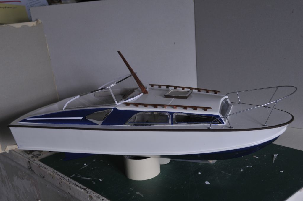

                  LARRY WHETTON
                    @larrywhetton68737
                    HI ,
                    I used silver tape as used to seal metal ducting , and pipe duct,
                    see my picture , a bit of fiddle but worth it …Larry………..

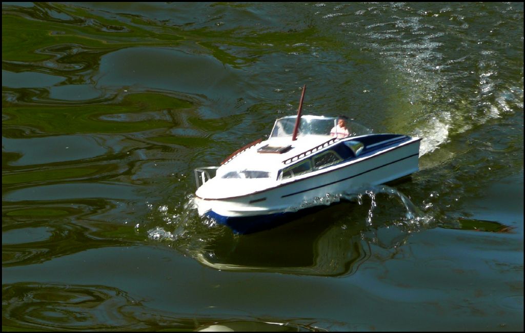

                            #46941
                            LARRY WHETTON
                              @larrywhetton68737
                              Se how detail looks on the water , worth the effort ……………Larry…
                              swordsman
