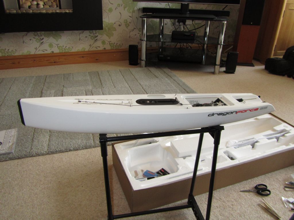

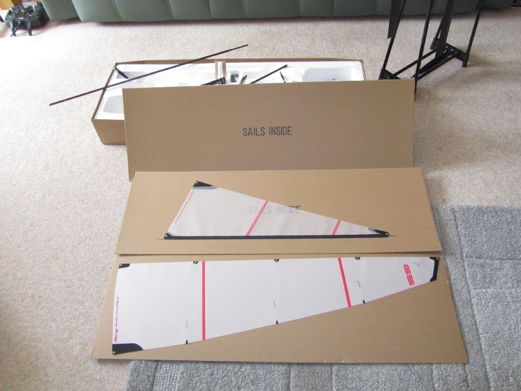

                A big box arrived on Monday, but apart from a quick look nothing has been done as I wanted to finish my Tx boxes and give Scot Free a shakedown.
                Did that yesterday and also gave my HydroPro Affinity a sail, albeit it in light winds, which whetted my appetite to put the DF65 together.

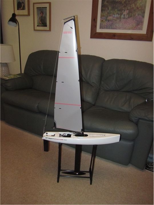

                So today I made a start by fitting the keel and bulb and assembling the mainsail.
                Have to say, that for £149.00 (without radio) from RC Yachts they are very good value for money and everything is very well packaged. The sails come flat and are sandwiched in cardboard. The HydroPro ones came rolled up which was fine as they were unmarked.
                I always take a long time over assembly, being careful and have to retie sheets etc. to get the right lengths. Rigging is fiddly for man sized fingers and thumbs and so tweezers and long nosed pliers are useful.
                It shouldn't take as long as the HydroPro though (which used earlier DF sails and rigging etc.) as improvements have been made and the instructions are clearer.
                Tomorrow I shall fit the jib and the Rx and it will then be ready for sailing.

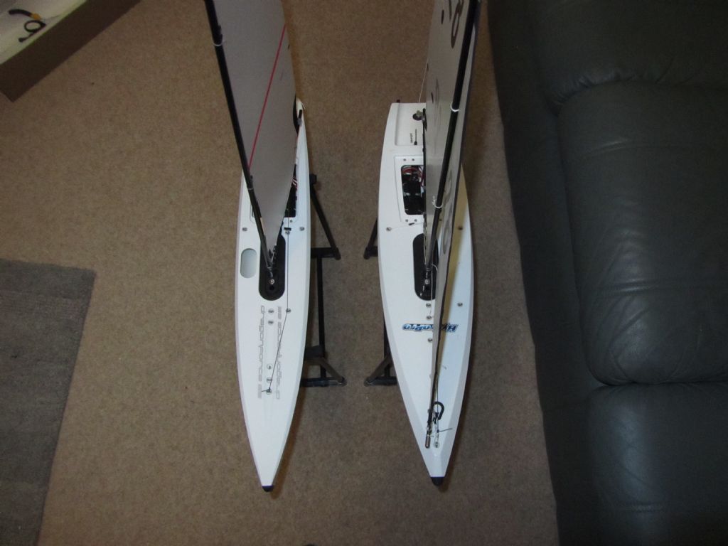

                Photo attached which shows the narrower beam of the DF compared with the HydroPro. Surprisingly the A sails aren't much taller than the B sails on the HydroPro.
                Edited By Chris Fellows on 24/04/2021 21:29:33
