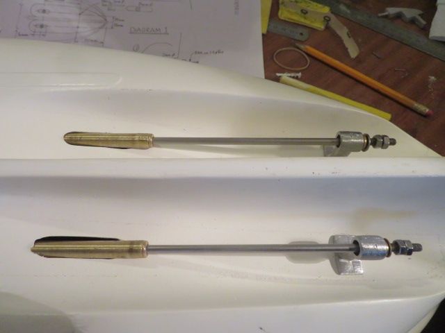

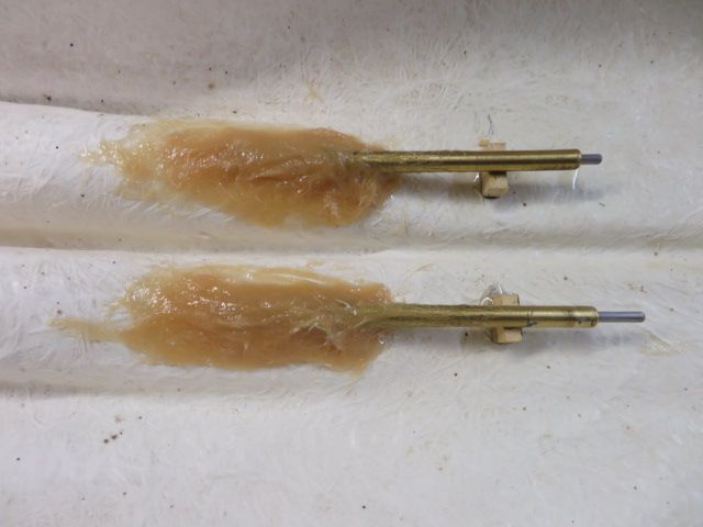

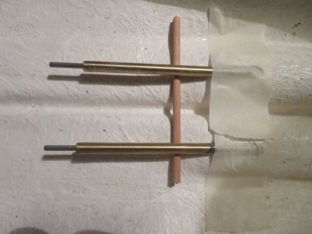

                I have over the past couple of months been developing a small kit that i want to relese sometime in the spring and have neglected the build of other boats, but as the basics of that are now ready to be moulded i have got the lifeboat out.

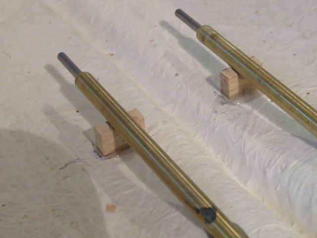

                first job was to fit the propellor tubes, shafts, "P" Supports and barings.
                time must be taken on these, with paramount time taken on alighnment and getting the shafts running freely, and this is what i did. The tubes were set initionally with 2 part epoxy resin from the outside and as it was going off, i blended it into the gaps with a fnger dipped in cold water to give a smooth finish, and avoiding a lot of sanding down once set.
                the insides was fixed in place using P40 reinforced polyester filler with grp glass strands, making a watertight and permanent fitting.
                finally the ends of the tubes inside the hull will be supported from flexing should they need it, by two small wooden supports.

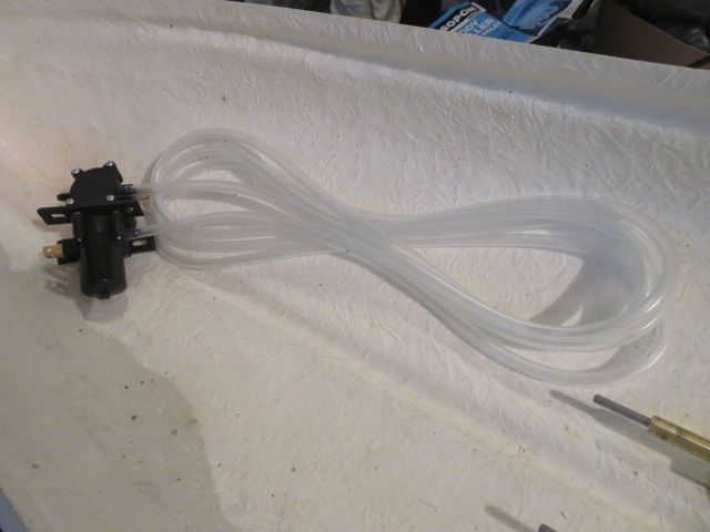

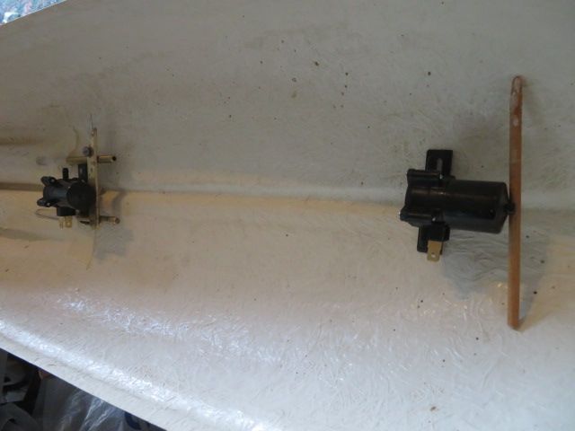

                and just in time for me to think about the next stage, my two windscreen washer pumps arived………..i bought 3 metres of silicon tubing for these pumps as and when i am ready to fit them.
                these are precautionary measures for when i use the model for the Windermere Challenge next summer in aid of the RNLI.
                If the boat does leak from anywhere if the water gets rough, at least i'll be able to pump it out quickly.

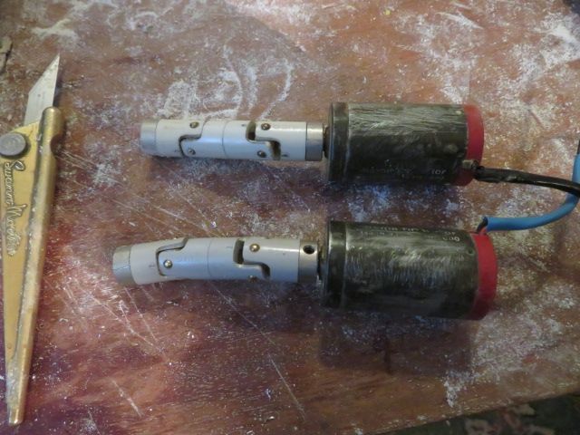

                and then i dug two very nicely engineered Swis 12 pole 12 – 18 volt motors that have a maximum speed of 3500 rpm at 200mah stall speed. i fitted double [to begin ] couplings ready for seating in the hull.

                    They are small motors Neil! What are they?
                    #98671
                      Posted by Chris Fellows on 27/11/2021 21:13:18:
                      i have absolutely no idea Chris othere than when i bought them on ebay some years ago they were described as Swiss and used in some old works computor system that was going for scrap.
                      i have tried to stall them running on a 12v battery, and just cannot between my fingers.so quiet as well……………they dont make a sound. think i paid 3 quid for the pair.

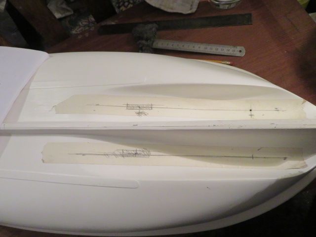

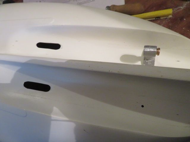

                        When I designed the original prototype, of Davids' kit 17 years ago, Dave and I chatted about the production, and we decided to make it as simple as possible for the kit to be put together, and that is why the boat has a continuous unmollested belting, which the first two or three twin screw Liverpools had, following on from all of the single screw Liverpools!. i'e. no holes in the aft half of the boat.
                        However, I have decided to put the cut outs into my model, as the boat I am building it as had those nine cut outs. a run of 8 together and then a single one each side at the stern quarter.
                        to make sure I had a solid piece of belting to work with, I have back filled the sunken section of the grp moulding with p38 filler.
                        I am now waiting for the filler to cure and then will begin to drill and ream out the rectangles in the belting, which I have marked out ready.
                        But before that yesterday I drilled, pinned and glued in the rudder base pintle and that is also ready for fairing in to the grp hull, which I forgot to do whilst back filling the hull.
