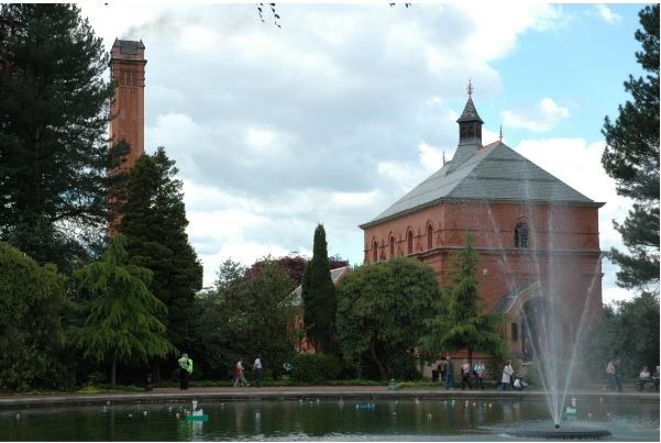

                        Lemon yellow??!! OK, so I reckoned you'd bought a lemon, but painting it that colour was your idea, m'duck. My Faireys travel at about scale speed whereas your models all seem to use warp drive! I always think of you as "Harry the Larrikin". I guess when you have a vast empty lake to sail on you can indulge a need for speed. The pond where I sail is pretty small in comparison, but very scenic and peaceful…

                          Nice house ewe have mate or is that only the workshop !!

                            That magnificent Victorian edifice in the picture is Papplewick Pumping Station (**LINK**) and the pond is probably nearer to 100m x 50m, although there is a concrete "jetty" all the way round it…….and it doesn't have Box Jellyfish or 'Salties'.

                              That is one beautifully pumping station!!!
                              I love the old buildings but they are too cold to live in!!!

                                Seeing it in steam will have to go onto your Bucket List, Harry. To anyone a tad nearer to Nottingham than Hobart I can recommend a splendid day out next weekend, which is the next scheduled steaming event. Details are on the PPS website. Give your soul a treat…
