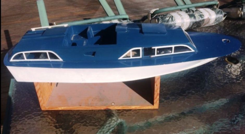

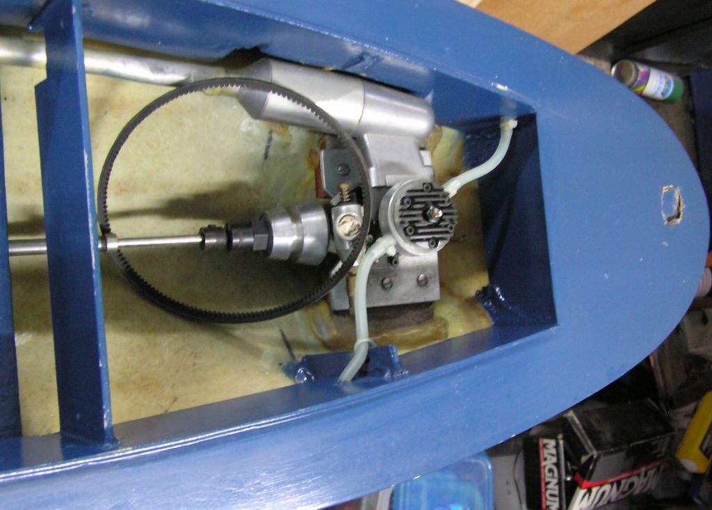

        huntsman6.jpghuntsman5.jpghuntsman4.jpghuntsman3.jpghuntsman2.jpgHi All
        I bid and won this on Gumtree for $200 AU with a Merco 40, starter, glow plug panel, radio, fittings and plans.
        It is an unfinished project and requires a bit of TLC.
        The deck and cabin are painted all blue which looks crappy.
        The radio, motor and starter are to be sold off.
        I am guessing it has old school 3/16 drive line so I will replace the bearing and shaft and install my spare 3648-1450kv brushless motor, 100A ESC, 4S Lipo 5800mah battery to run a 2 blade 40mm CNC alloy prop.
        As I am going on the photos because I receive it tomorrow things may change a bit.

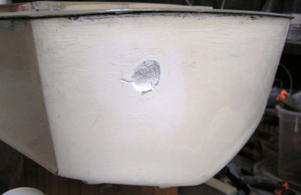

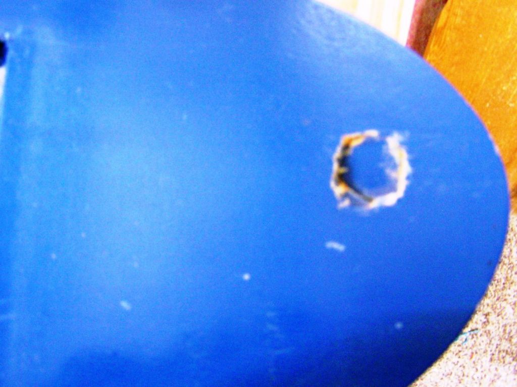

        The forward deck has a hole in it and it looks like it's not glue down correctly.
        I may call the Huntsman Guru, Sir Dave M on this one!!!

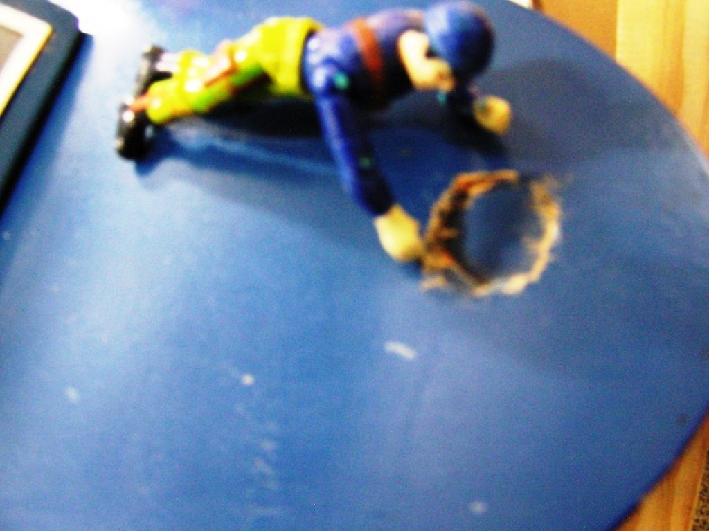

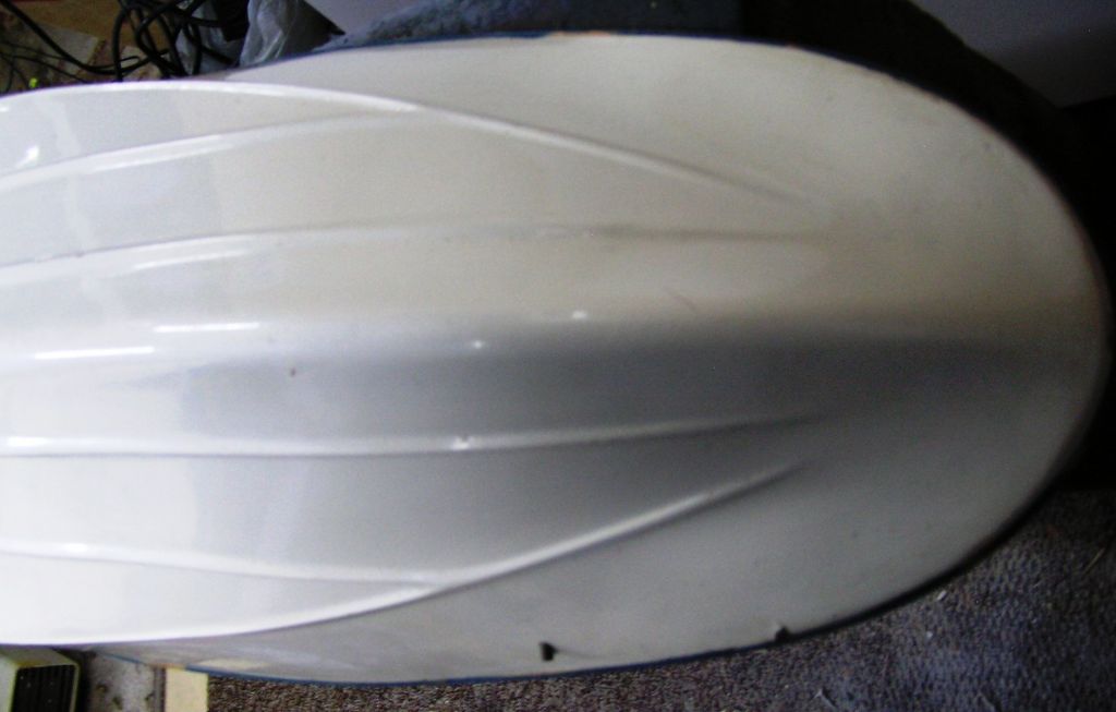

                      huntsman14.jpghuntsman13.jpghuntsman12.jpghuntsman11.jpghuntsman10.jpghuntsman9.jpghuntsman8.jpgHi All
                      Boat arrived today and in a bit better order than I thought it would be.
                      No windscreen so I will be looking for a full size temp. if one of you chaps have one please.
                      The driveline has not been fully installed so I will replace to lot.
                      The rudder looks a bit small, so into my spares for that.
                      The radio box was sitting on the exhaust pipe, so out that went.
                      The hole in the deck is a easy repair and I will strip plank it as well.
                      The crew are right on the ball !!

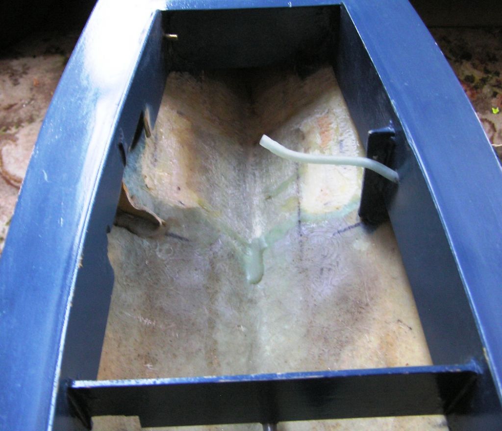

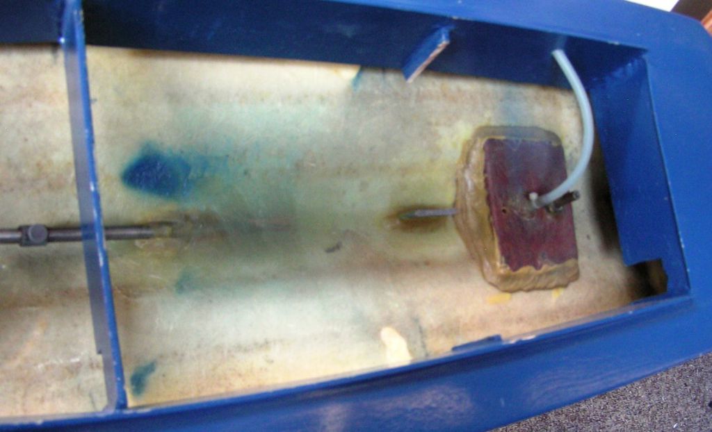

                        removed ic motor.jpgremoved fence paling.jpgHi All
                        Busy day, removed IC motor, exhaust,shaft and rudder.
                        Cleaned up the engine bay( 3 hours what a lovely job I don't think).
                        Removed the blue painted fence paling which look crap!!!!
                        Found a rudder in the box which is the same width but 12mm deeper.
                        The larger prop on the boat is a 5577( maybe 1.4 pitch) far to big for the old Merco 40.
                        Thanks Dave M for the windscreen pattern, you can count on the Huntsman GURU .
                        Nice Bloke !!!

                          Some for the forward deck sanded off and the hole filled in.

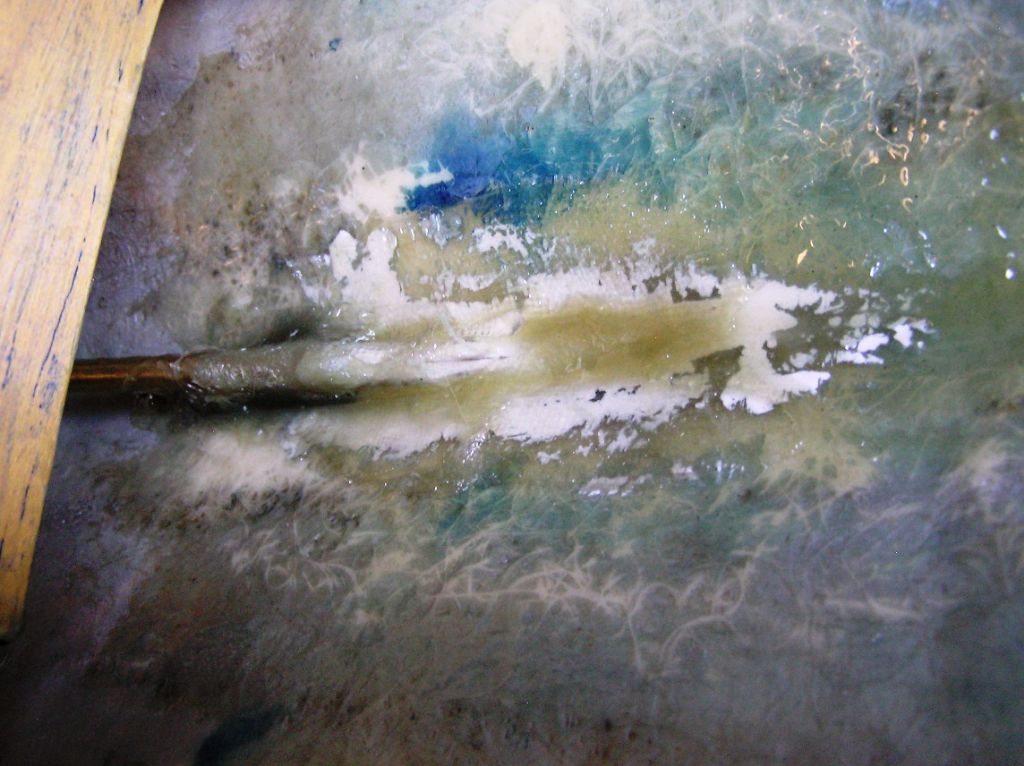

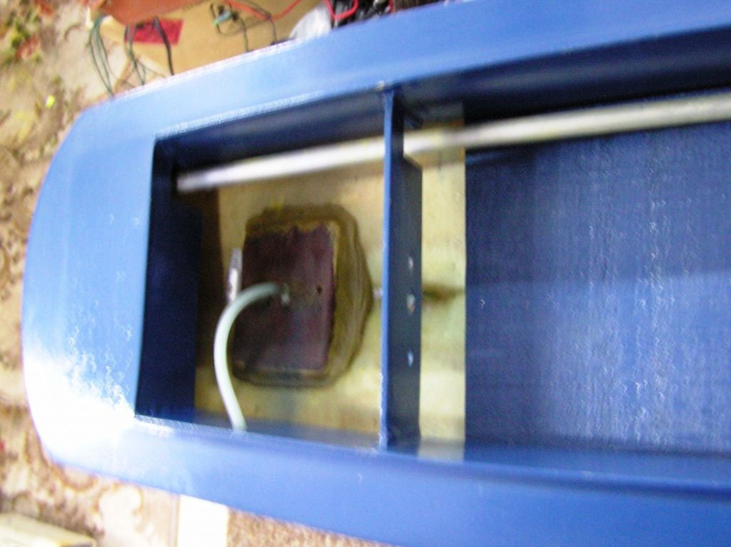

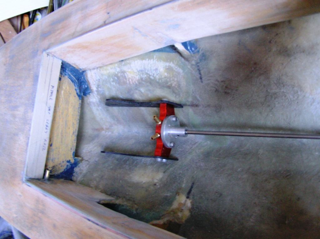

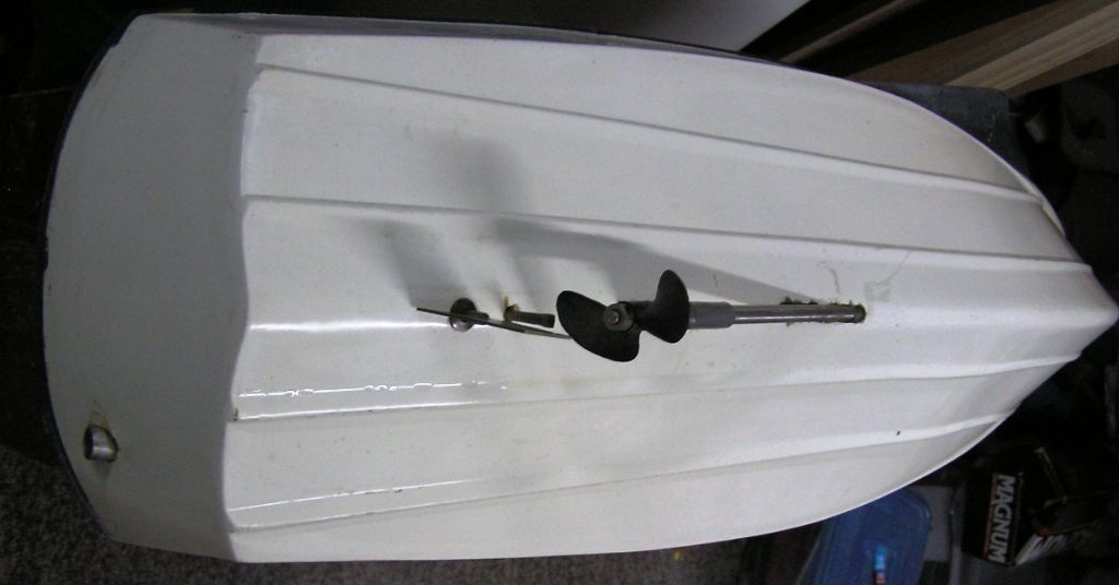

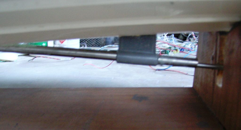

                                    new prop angle.jpgremoved old setup.jpgHi All
                                    Well 4 hours to remove the driveline, rudder and water pickup!!
                                    Rudder and pickup in with a bit of decking timber!!!
                                    As I am waiting for new custom bearings, it's only a rough idea of to new shallow angle .
                                    Maximum prop size is 45mm with 5mm clearance and I still have 10mm clearance under the motor mount.
                                    At present I have not enlarged the driveline hole .

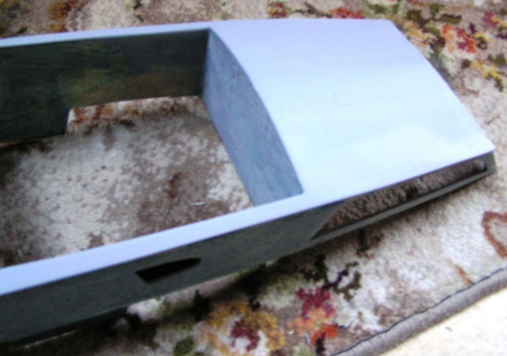

                                      #72028

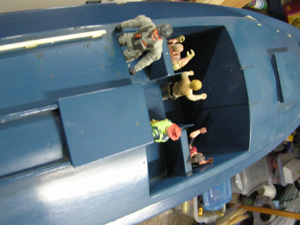

                                        cabin top 2.jpgHi All
                                        Stripped out all the windows, removed both hatches and doors.
                                        Removed the cockpit floor and seats.
                                        The cockpit area is to low, also the cockpit is shorter than the original but the rear cabin is longer!!!
                                        Removed lot of the blue paint, a bit more to go.
                                        I think I require a stripper, that's paint stripper lads!!
                                        My new driveline arrives Thursday.

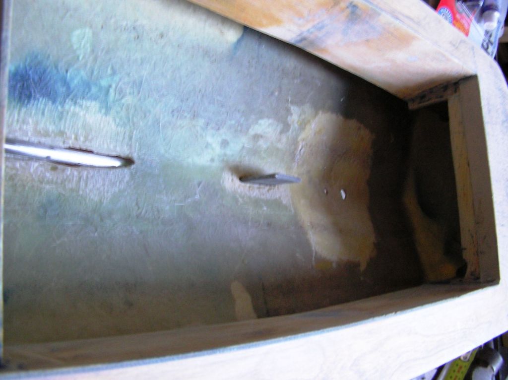

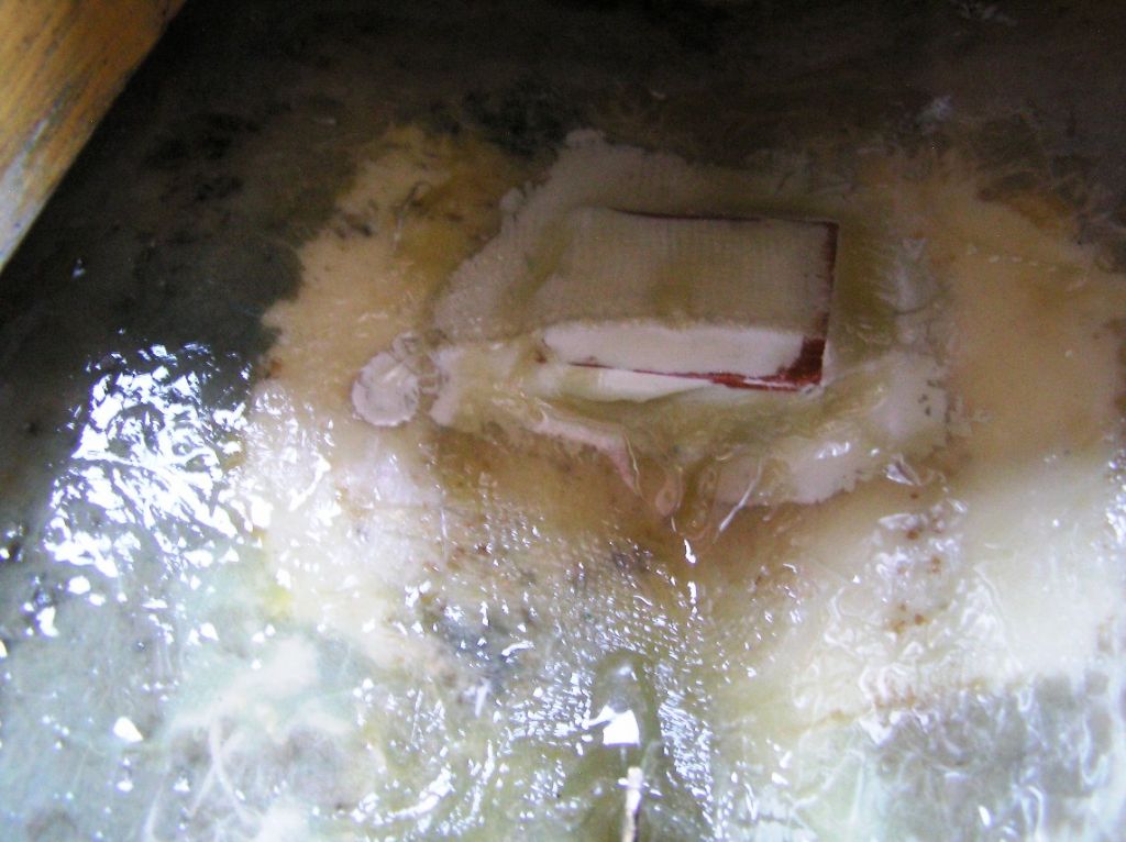

                                            #72152

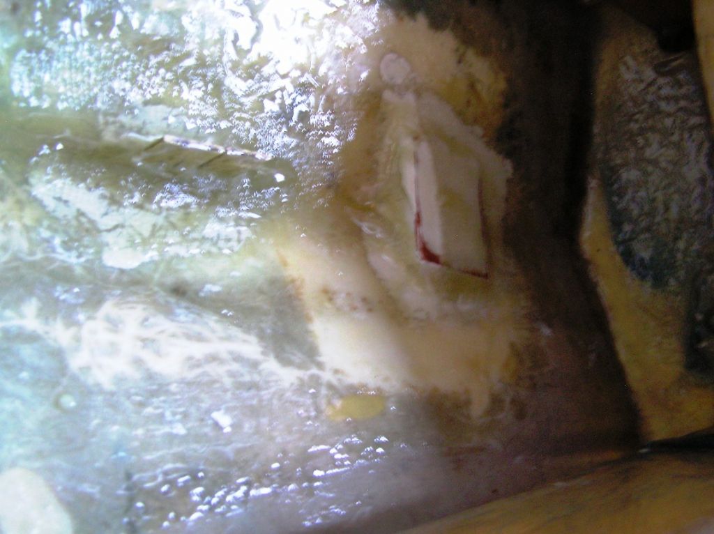

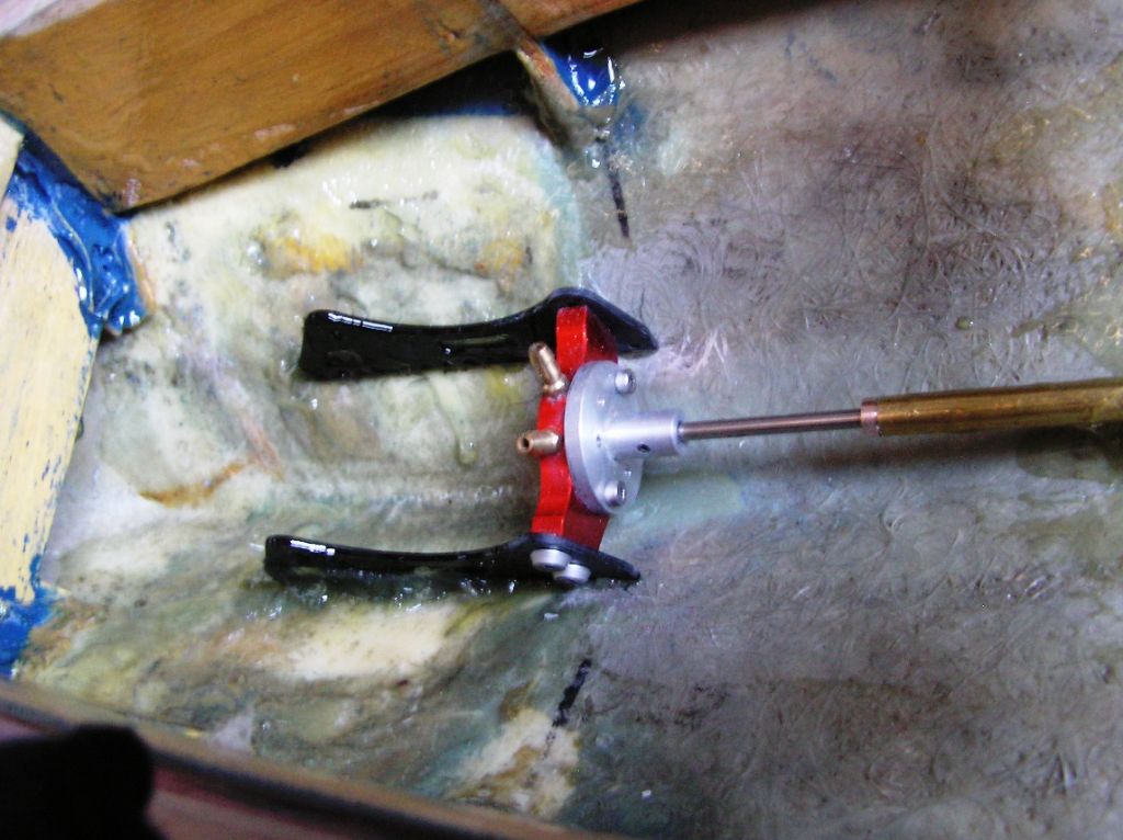

                                              rudder block installed.jpgmotor mount installed.jpgexhaust hole repair.jpgdrive line installed 2.jpgHi Chaps
                                              Glued and fibreglass motor, prop shaft with strut and wooden rudder block, also filled in the old exhaust hole in the stern.
                                              As I have changed the prop angle, I am going back to the original rudder with a 2mm piece on silicon fuel tubing at the bottom of the shaft.
                                              Trimmed a bit of the rudder tube to add a 3mm piece of tubing between the rudder tube and the tiller arm.
                                              My bit of safety so no to loose the rudder if the tiller arm comes off!!!

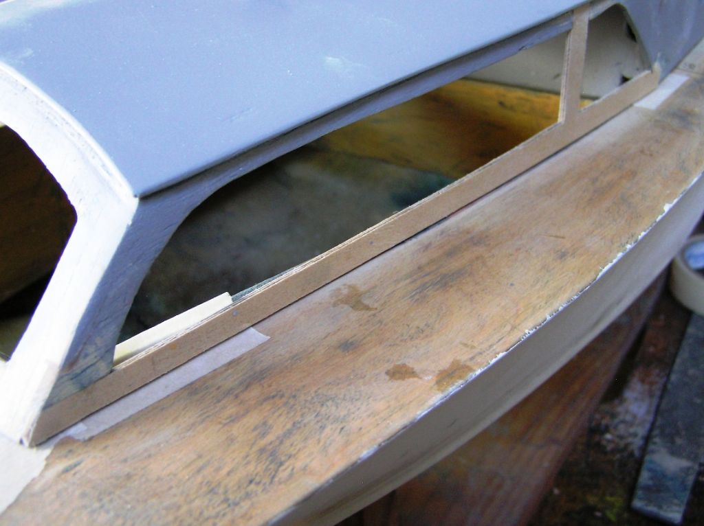

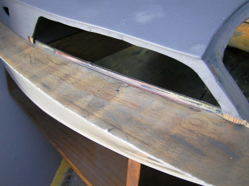

                                                #72311
                                                  Hi All
                                                  Started repairing the cabin by adding an angle timber strip under the forward window and filling the edge to meet the deck.
                                                  This had a gap in the middle so looked ugly.
                                                  The aft window I added a plywood section back to the combing to strengthen the window areas on both the back and sides.
                                                  Harry
                                                  #72482
                                                    Hi All
                                                    Had the same problem with the stern window area, so two layers of masking tape on the deck and combings.
                                                    A big mix of Selley's plasti-bond and spread of the plywood extra panel.
                                                    Push the cabin down onto the deck and leave to harder.
                                                    I will remove the masking tape tomorrow, sand and filler spray undercoat.
                                                    Harry

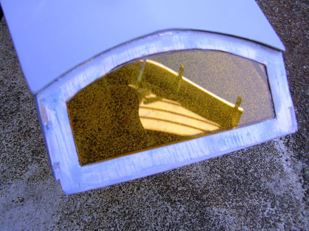

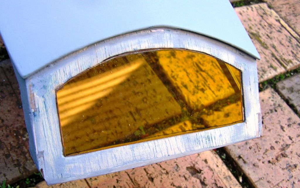

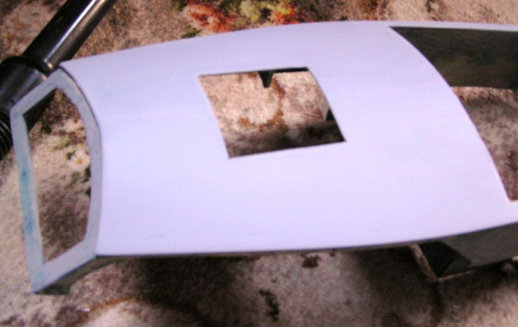

                                                    #72543
                                                      side window 2.jpgside window 1.jpgfront window 2.jpgHi All
                                                      Repaired one side window and played with a car night/day vision plastic for the forward window.
