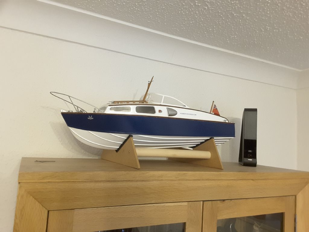

              Absolutely Derek. I'm reminded of him every day by one of his Huntress prototypes.
              DMs Huntress

                I like the photo, Chris – I think I shall have to do a copy of it.
                Derek.

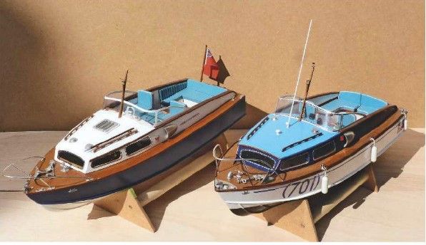

                  Here are the two prototypes side by side. The one on the right was Dave's favourite. I'm guessing that Liz and the family kept it and his Swordsman and Huntsman 31 models in memory of him.

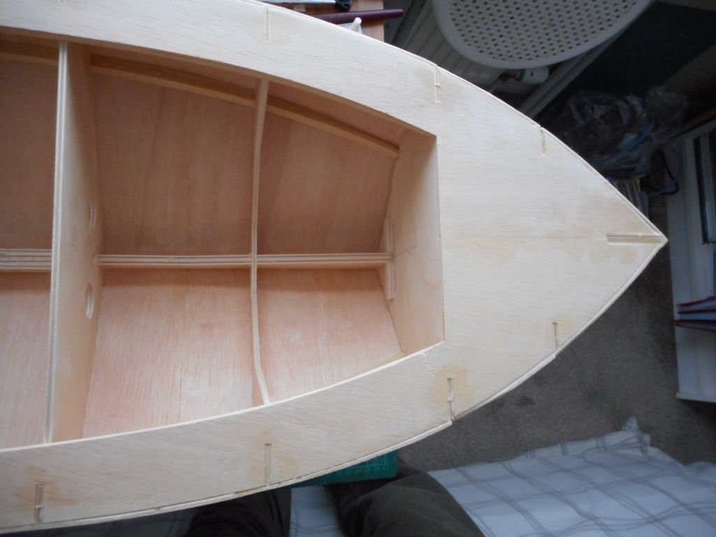

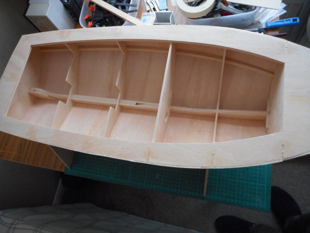

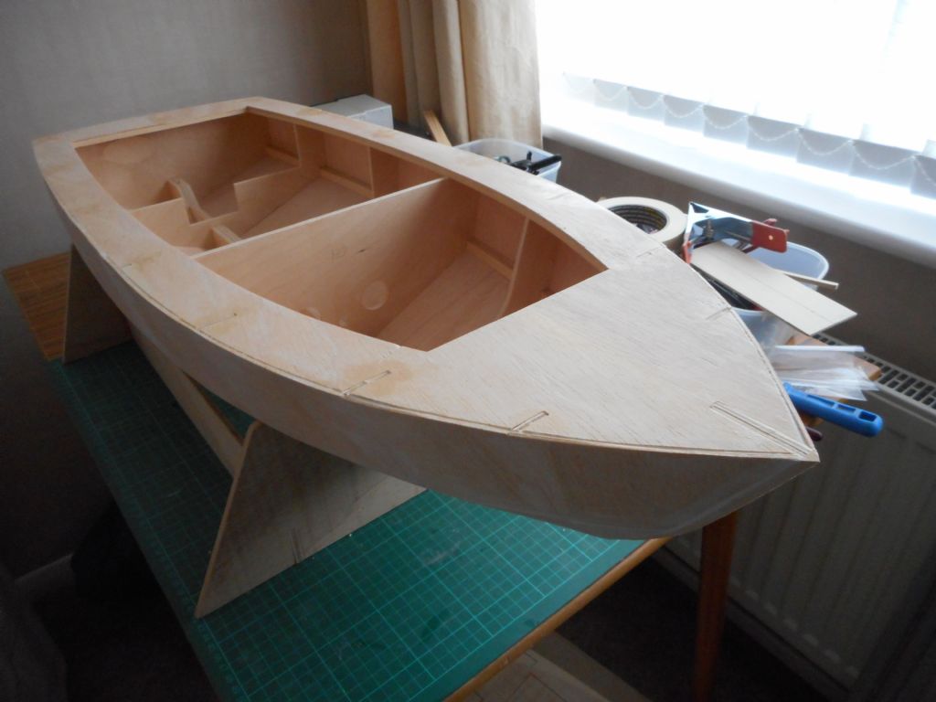

                      We're up and running (or maybe just steadily walking).wink
                      I collected a 1:8 Huntress kit from SLEC this afternoon. A quick look through it and I am extremely pleased with it. SLEC's kits get better all the time and this one is no exception, also I think that they are the best set of instructions I have ever had with one of their kits. I shall have a closer look at it tomorrow and get started with a fairly gentle build programme – looking forward to it.smiley
                      Derek.

                          Couldn't resist the temptation, Chris.
                          The strakes (or spray rails as they are called in the instructions) are 3.2 x 3.2mm bass strip and a quick look through the instructions say that they should be fitted and then rounded off. I think that I may try your ideas to get something better looking and more scale-like.

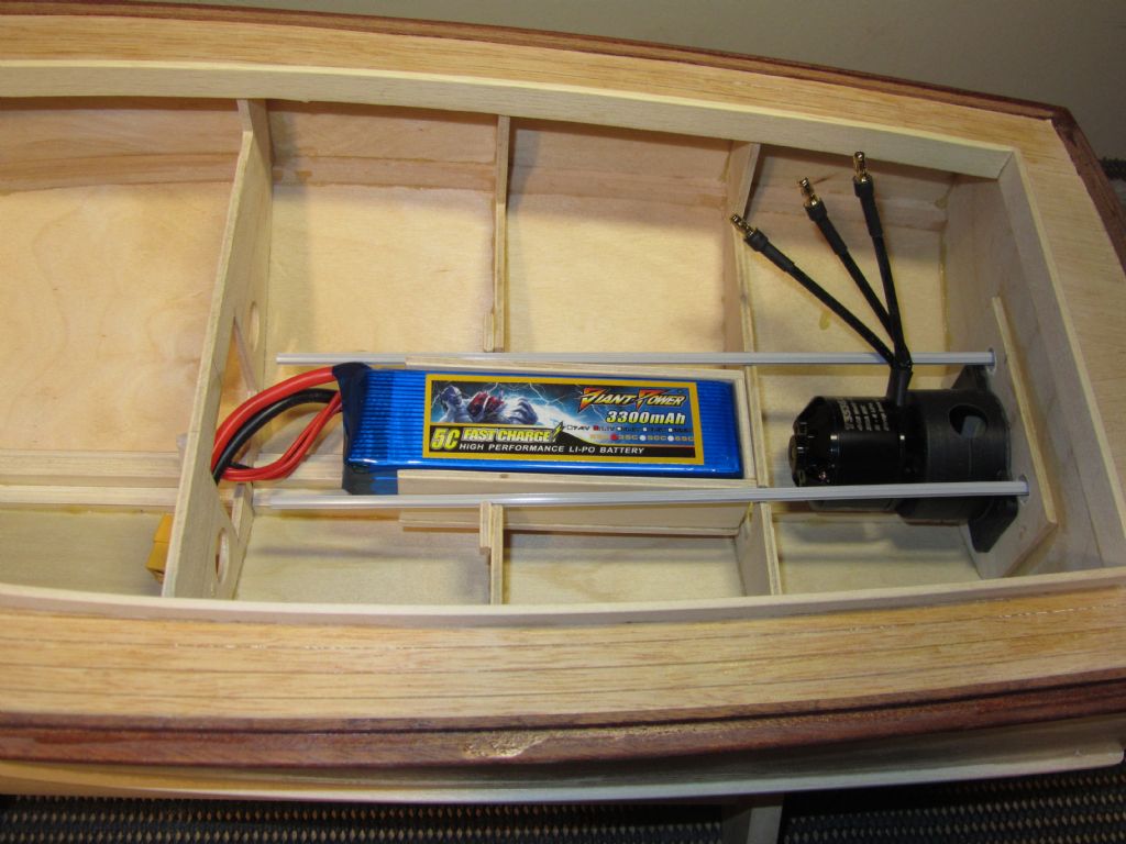

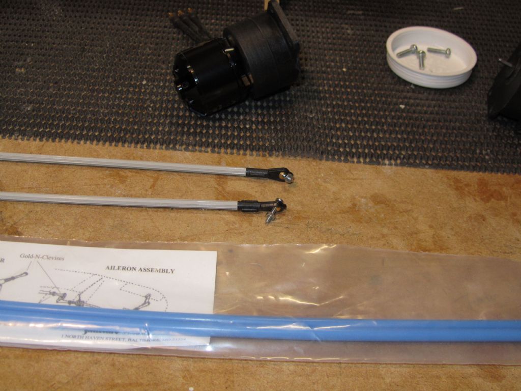

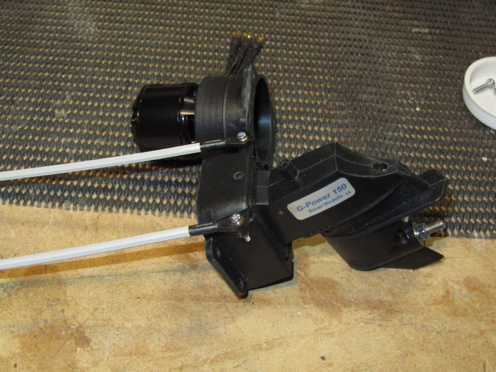

                            Ok, I've got the Huntsman 31 and Swordsman to the point I wanted i.e. prop shafts fitted so that I can leave them for the time being and get back to the Huntress.
                            First thing, as with my other builds after a long layoff was to remember where I'd got to! This is where taking photos is so useful along with this blog and it reminded me which battery I was going to use and what the battery box was for that I kept moving around my work area!
                            First thing was to bolt everything together again. A quick look in a cupboard found two lengths of snake with couplings attached for the steering which explained why I'd got such big holes through the transom. I'd bought two types of snake; one with a thin SS cable inner and the other with a much thicker nylon inner. I chose the latter because I could screw the couplings that I wanted to use into the ends so I could dismantle easily when required. I chose the couplings over simpler clevis types because they are substantial, easy to dismantle (as this was going to be required many times in this build) and black to match the stern-drive!
                            Once the stern-drive was bolted in place and the battery positioned I could take stock. As you can see it's pretty tight in there which is one reason I went for snakes as I didn't want anything moving so close to the battery box and motor etc. Also it will be quite a long run from the servo in the cabin and thought snakes would be better. So the build can now continue with deciding exactly where the servo will go and making a mounting box.

                                Hi Chris,

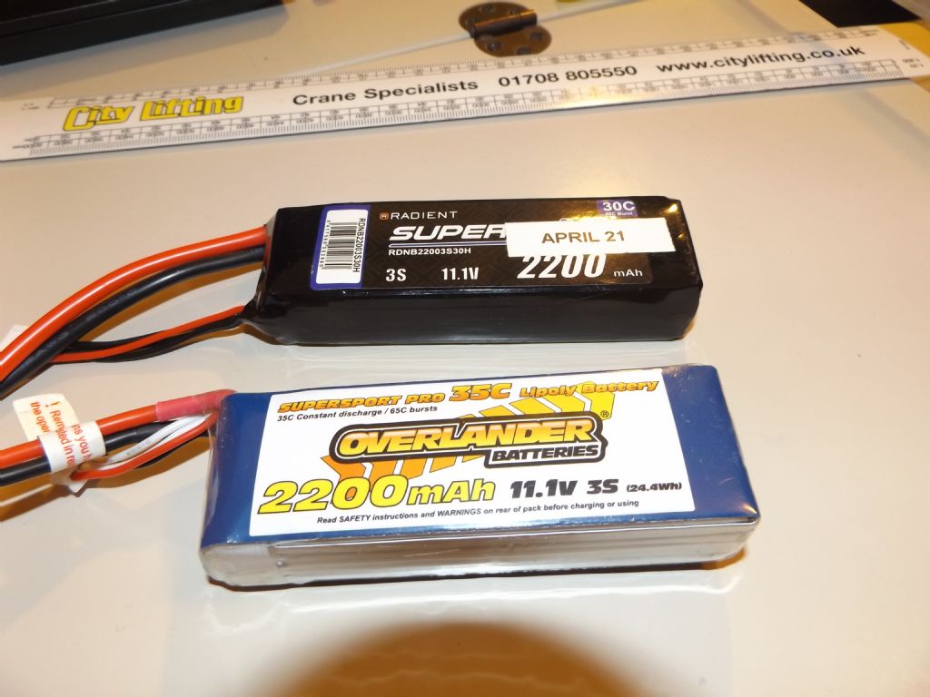

                                Have you tried using the 5C Lipo in your picture ? they are only good for very low discharge rate, I know because I didn't realise you would need a 30C Lipo if you want any performance, please tell me to bugger off if you knoe this already

                                  Sorry but my brain is suffering from a bad case of 'age fog'. I DID use liteply on my original build but fitted it as I have mentioned above. Having now reread the original posting, I did have a few problems but they were not insurmountable.wink
                                  Derek.
                                  #99376
                                    Oops, we've overlapped posts!
                                    Anyway, good to see you making progress Derek. I'm not a fan of liteply either and won't use the stuff. Don't see the point of it in model boat building. At the joint it might be better to vee it out a bit and use some P38? Once clothed and resinned it should be Ok.
                                    Ray, that's another cock up you've noticed, I'm losing the plot! I bought the battery sometime ago specifically for this boat and must have been so focussed on getting a 3S that would fit I missed the output! Flippin', floppin' heck!
                                    What can that battery be used for then? More expense due to energy prices! blush
                                    Trying to remember if I tried it in DM's Huntress which is another reason I wanted a 3S. Whether I did or not I'll give it a go/another go!

                                          #99380
                                            Phew, it's Ray that's losing the plot!! cheeky

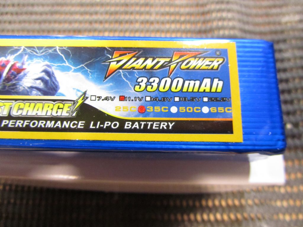

                                            That 5C is the charging rate, it has a 35C discharge rate as per my other batteries.

                                                  To be fair Ray it is very difficult to see from the photo what the discharge rate is. I had to look at the battery itself and the box before I realised it was Ok.
                                                  They are making a big thing out of the fast charge capabilities and that leaps out at you on the casing but I use my smart charger on auto on low amps anyway.

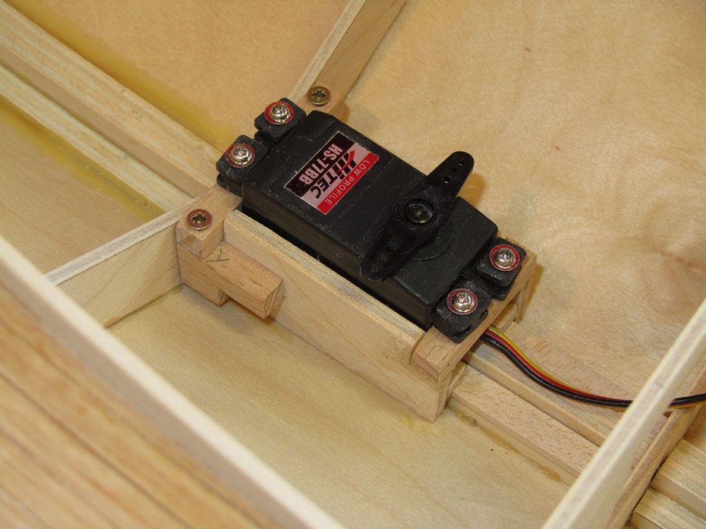

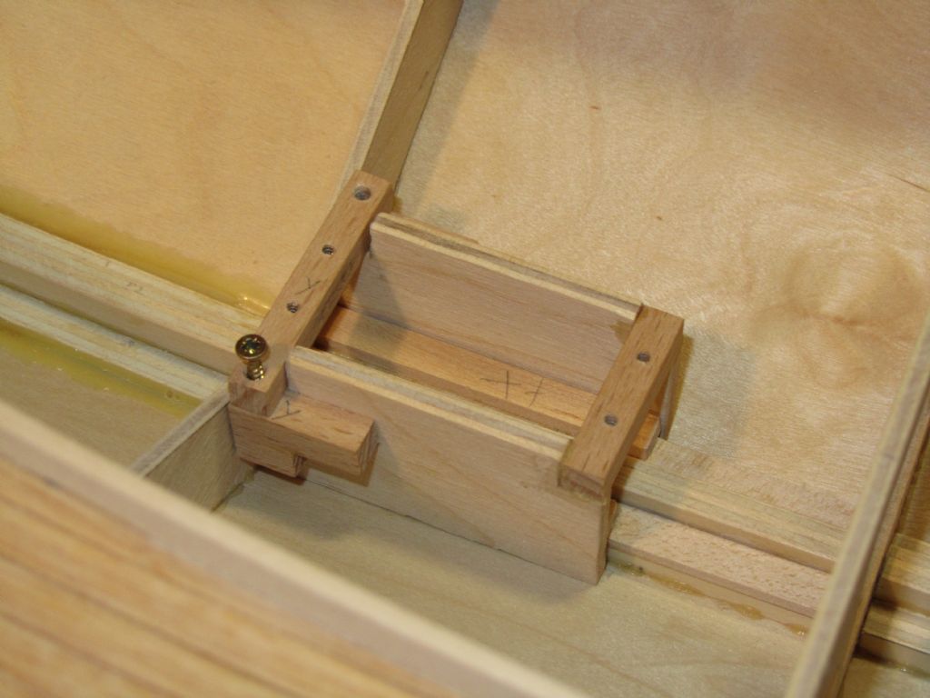

                                                      Well this took longer than it should! I've made a couple of more complicated servo mounts before but this one was fighting me all the way.
                                                      Cut the parts out of ply and beech and glued together with bnthe servo as a spacer. Then realised I couldn't get the servo out due to the wires! So removed one of the beech bearers before the glue had dried and added some more pieces so it could be screwed in place. Even though I pre-drilled the holes one of the pieces came off the side as I was screwing into it so replaced with bigger pieces pre-drilled and screwed this time. The box was a little out of square and when adjusting it the bearer at the other end came loose! Having one of Neil's recent experiences!
                                                      Anyway, glued the sides in place in the boat and the bearer again and left overnight and this morning fitted the servo. All good and secure.
                                                      I need a bigger and stronger double servo horn so have ordered a couple of different alloy ones. All good fun.
