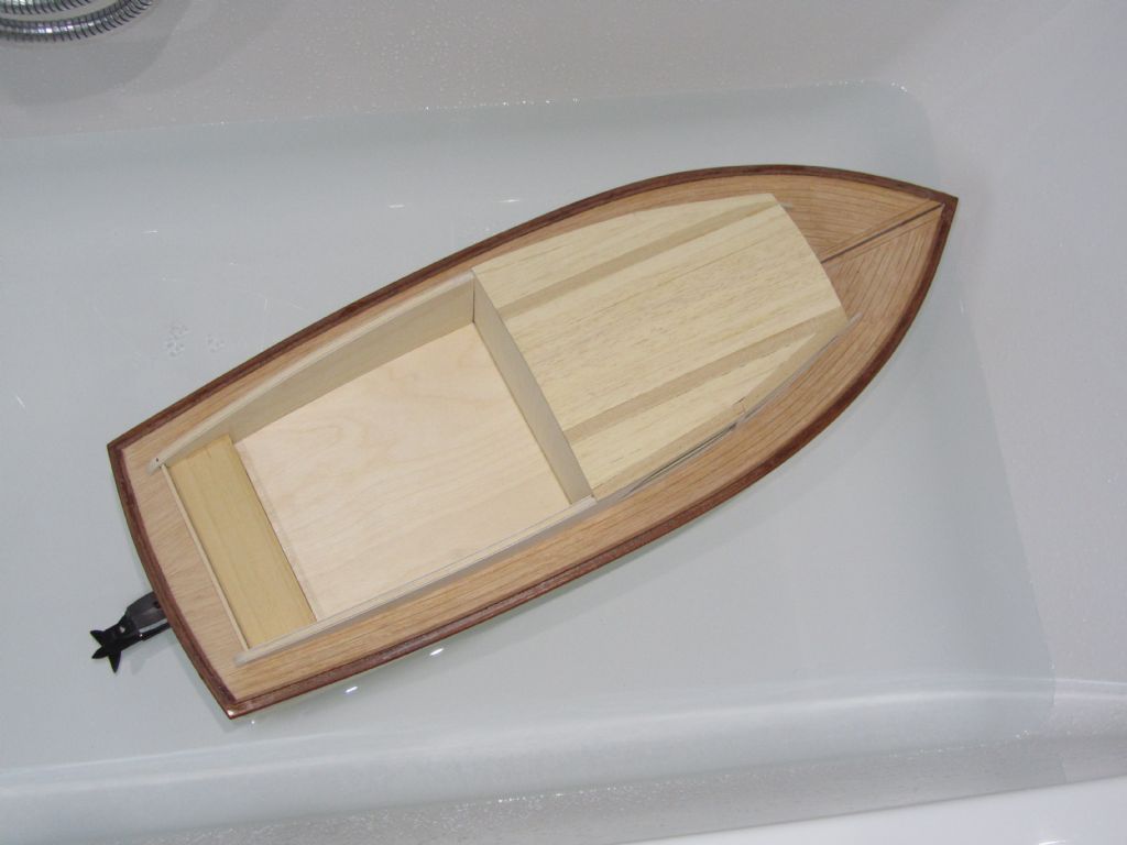

        Nothing for the last couple of days as I had a bit more to do in the kitchen and then had to put my big boxes of screws etc. and tools back into the garage.

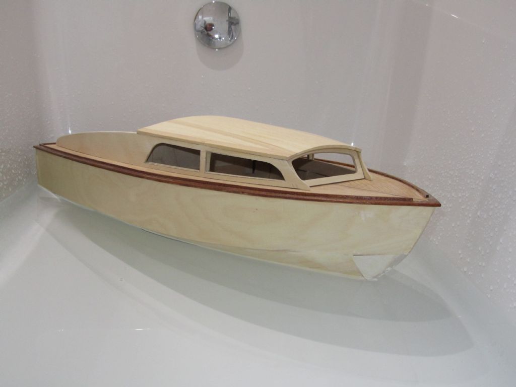

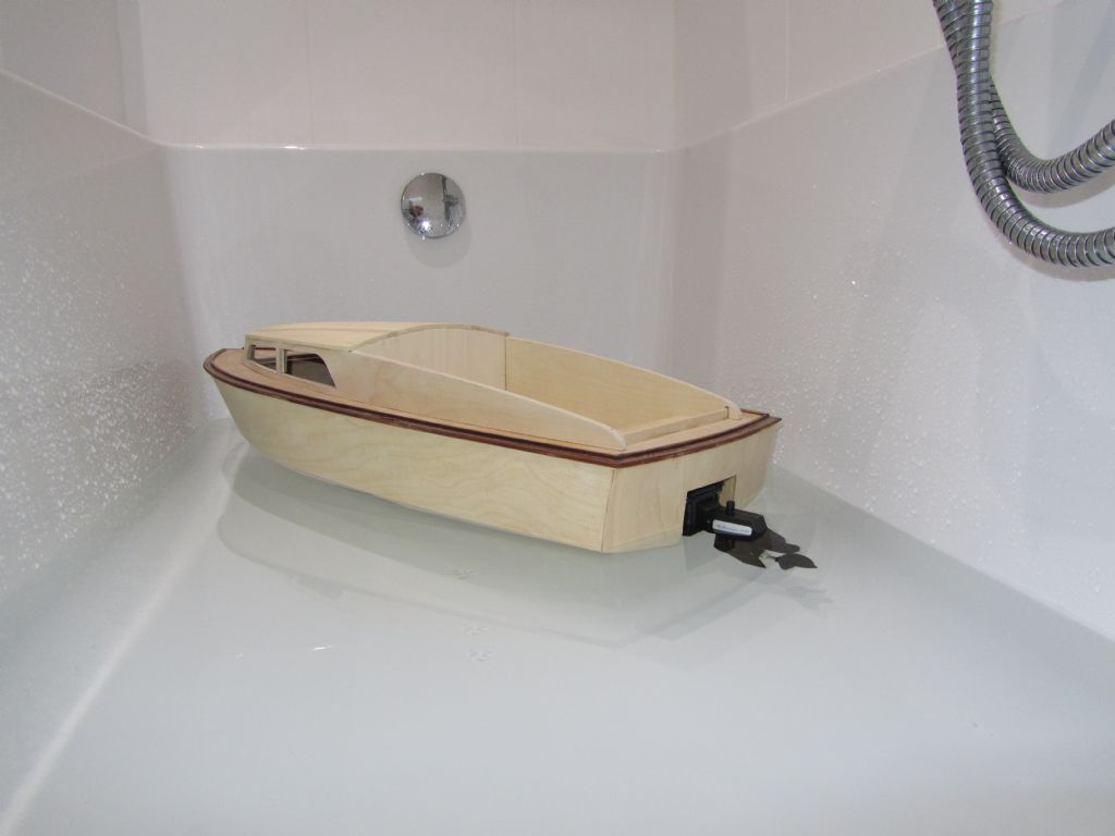

        Today though I fitted the stern-drive and motor, put the 3S battery in what I'd hoped would be the right position i.e. not in the cabin area and laid a servo for the steering in the cabin. Obviously a bit more weight will be added with the windows, paint and other finishing touches but this is pretty much it as far as most of the weight goes and its distribution.
        With these items and the superstructure fitted there's quite a bit of weight in this little Huntress now! Followers of my builds will know that I don't build light. I like a bit of weight in my builds though as I think they will sit better on the water and not be affected as much as a lighter model by wind, ripples and choppy water. And of course with brushless motors power isn't a problem nowadays!
        Bath partly filled, I had some trepidation as I placed the boat in, given the position of the stern-drive and motor, but I needn't have worried as it sat perfectly on the water. Right on the chine and with a slight bow up attitude. Brilliant! Note that I still haven't screwed the prop right on as it is quite tight which is why it's sticking out more than it should.
        Knowing where the battery needs to sit is important, as if it had encroached into the cabin I would have to make allowance for supporting the snakes where they pass through the bulkhead into the cabin and the positioning of the servo and pivot. Now knowing this I can proceed with the installation.

        #94383
          Hi Chris,
          History is made well done, looks like it needs plenty of ballast .
          #94387
            Hi Ray
            Ballast in a Fairey, never!! surprise
            It's difficult to see the water in the photos and the freeboard looks greater than it is which gives the impression it's sitting a bit high.
            Looking at the full-sized craft though it is sitting pretty much spot on so I'm happy with that.

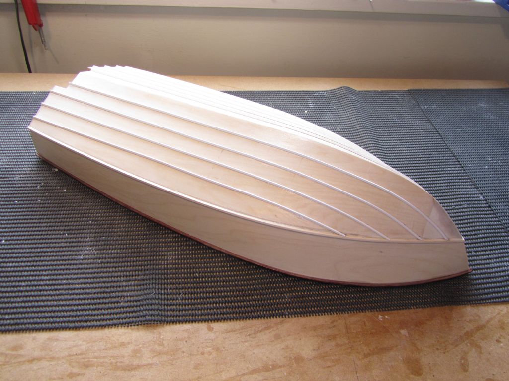

                  #95577

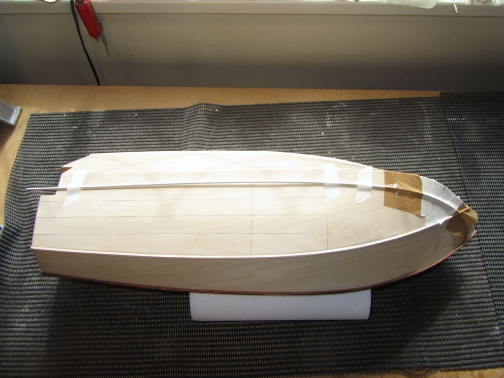

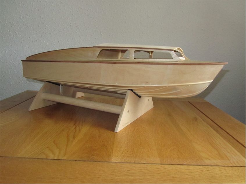

                    Since the last post I've fitted the chine rails, though that was quite some time ago now. Should have fitted them before the bath test!
                    Whilst waiting for the glue to dry on the Huntsman 31 strakes I've made a start on those for the Huntress. Straight sections marked out on the hull in pencil and then the first one glued in place at the bow. Due to the amount of curvature definitely needed steaming and plenty of tape!
                    strakes1
                    strakes2

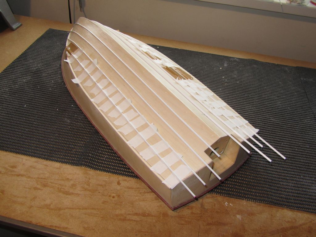

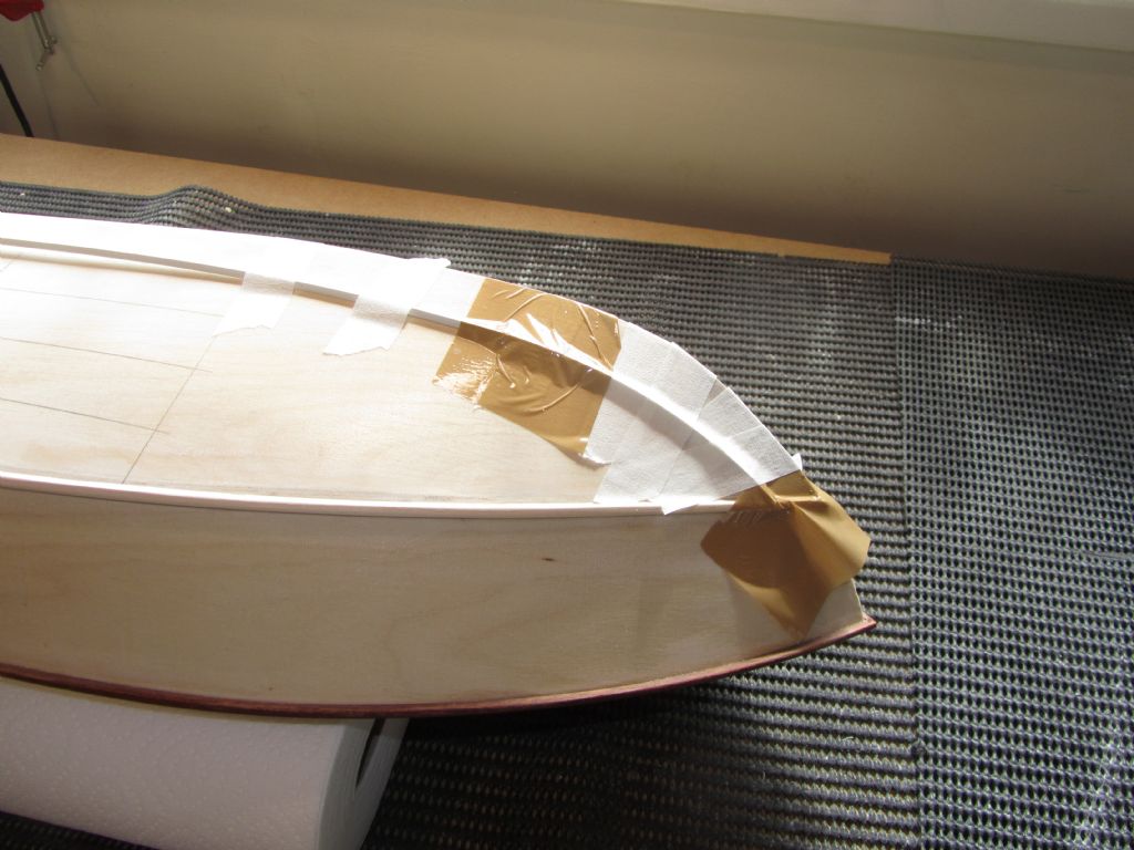

                    #95701
                      I don't know why my last post double posted? It's done that before.

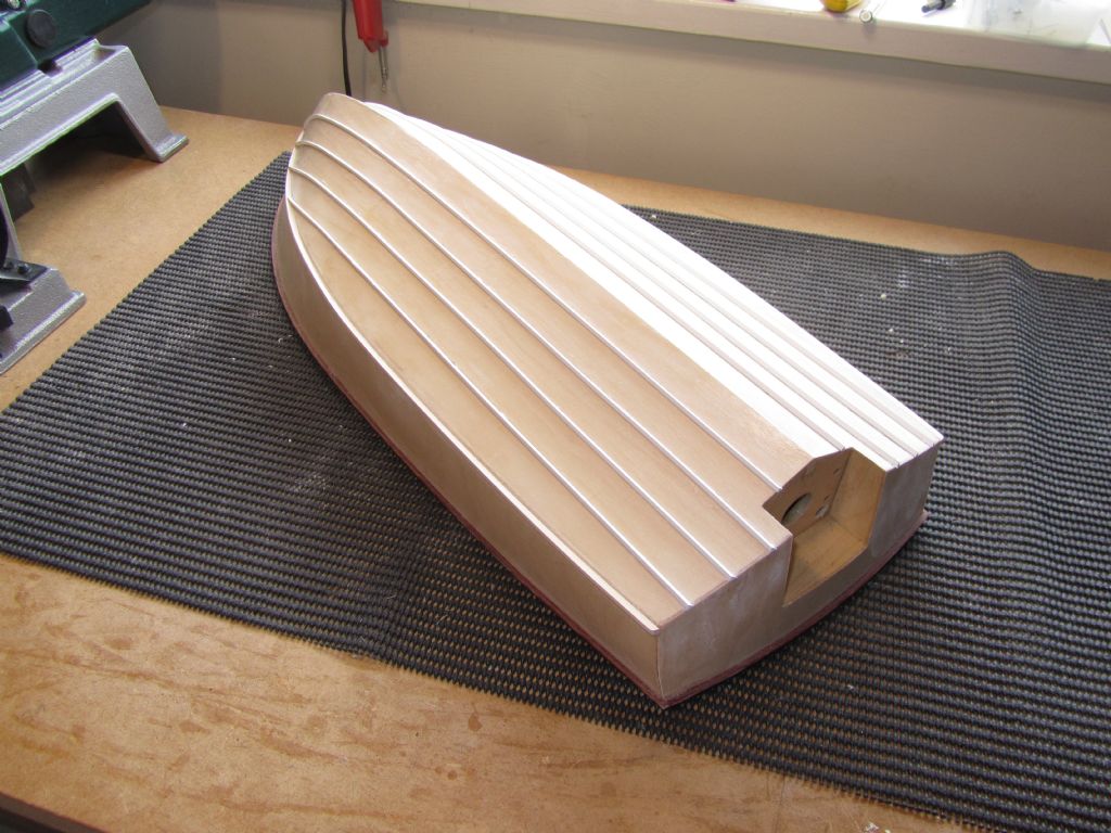

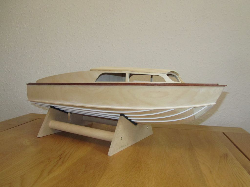

                      Anyway, all the remaining strakes were glued and taped into place. Left overnight to fully dry and then the ends at the transom were trimmed back with the razor saw and sanded flush. As with the Huntsman 31 I've used the 3mm 60 degree triangular styrene section which I feel is just right. Whilst the hull is substantially shorter I've fitted 4 strakes per side so still quite a lot of work. Happy that's done!
                      strakes6
                      strakes7
                      strakes8
                      strakes9

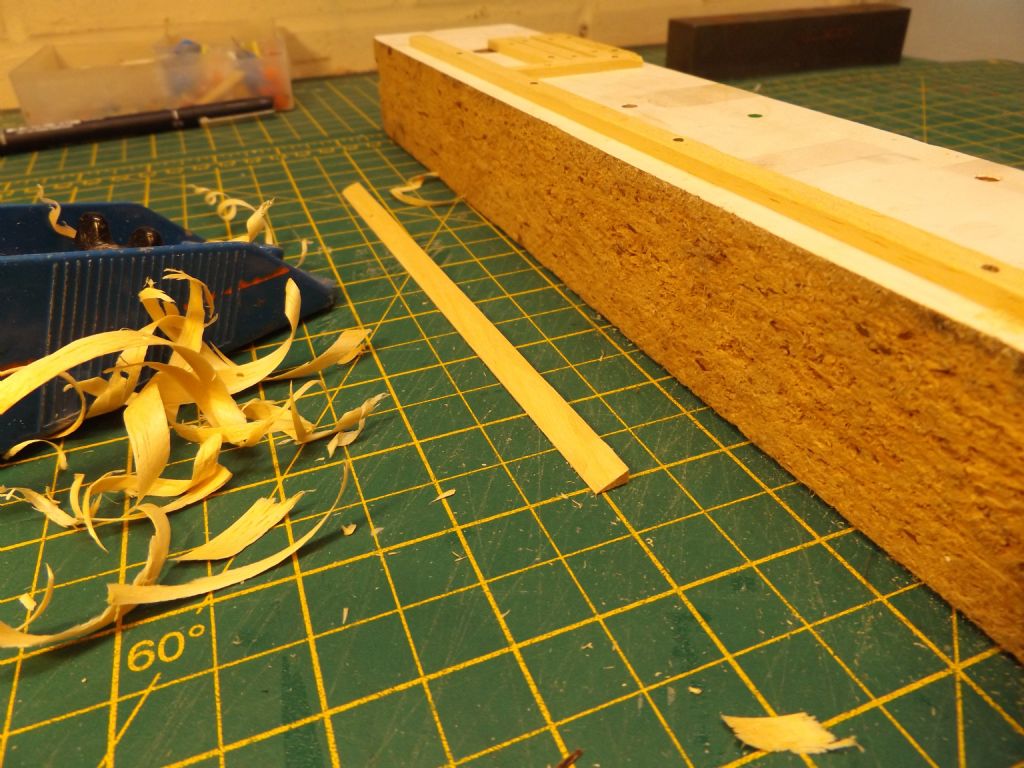

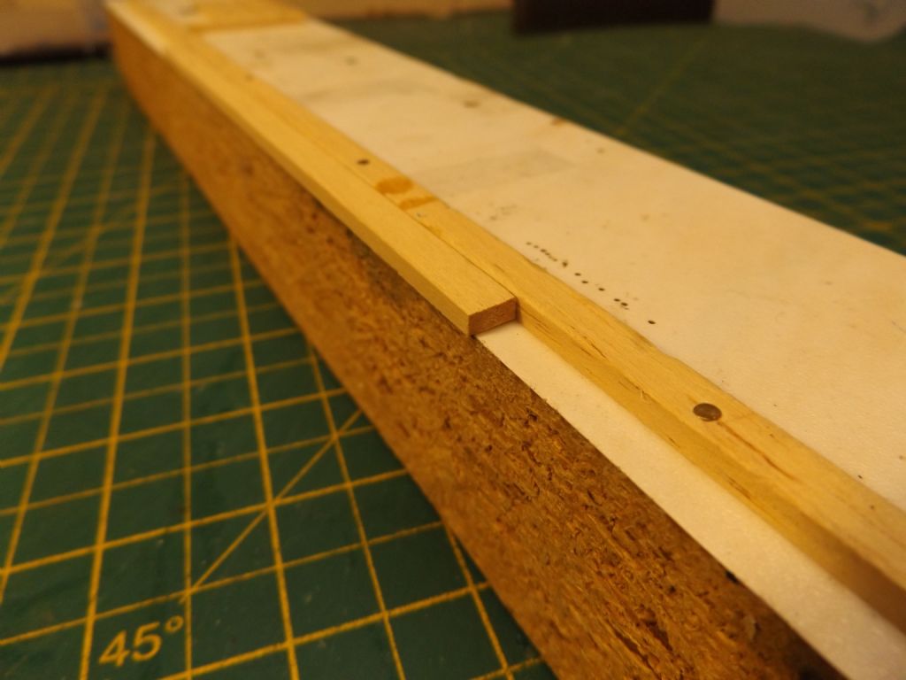

                              As regards the strakes I turned to styrene as despite many searches I just couldn't find a supplier of triangular timber section in the lengths required and didn't have the means or fancy cutting them myself. Styrene has the advantage of being very accurate along it's length. But again it's difficult to find in long lengths but eventually found that Deans Marine can supply in 1 metre lengths, postage is expensive though!
                              Using it though was subject to finding a suitable glue. I made a test piece by covering some ply with thin cloth and coats of Eze-Kote as per my hulls. Glued one piece with slow setting cyano (even though I don't like it!) and another with canopy glue which I figured would be Ok as recommended for gluing styrene windows to painted timber superstructures. Didn't fancy epoxy as it doesn't run well enough and is messy for that use. Left overnight and the cyano one pulled off without too much effort so was a fail. The canopy glue (Deluxe Materials) stuck hard and so that was it. In fact it's become one of my favourite glues now as grabs well, little odour, excess can be wiped off with a damp finger or tissue and it dries clear. I've glued planks etc. down with it.
                              Fixing the strakes is pretty straightforward. I didn't steam them on the first hull as the styrene bends easily but that was a mistake and I had a job holding them in place and tight to the hull. Subsequent hulls I did, steamed over a kettle like timber and much easier. Start at the bow and glue in sections and tape as you go along as per my posts. Very pleased with how they went on and look.

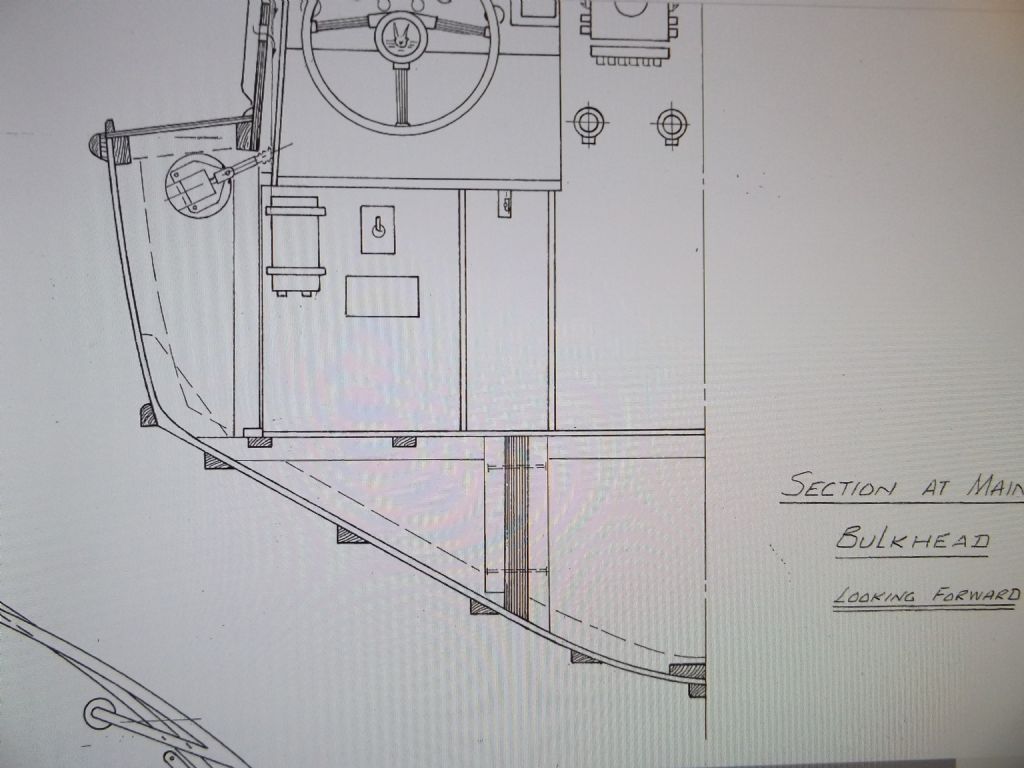

                                                    #99039
                                                      Hello All,

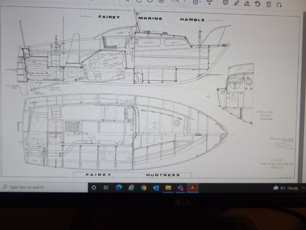

                                                      Well looks like DM sent me these drawings some time ago pre-construction, now found on my portable drive, I also have his 2 sheet plans for his model version as pdf's If anybody wants them. PM your email address to me.huntress ga.jpg
                                                      Gone but not ever forgotten
