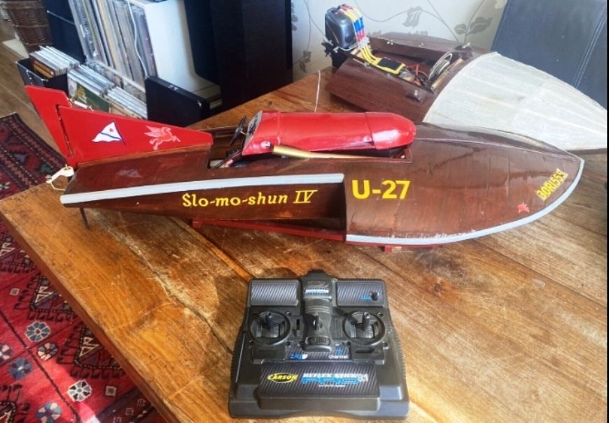

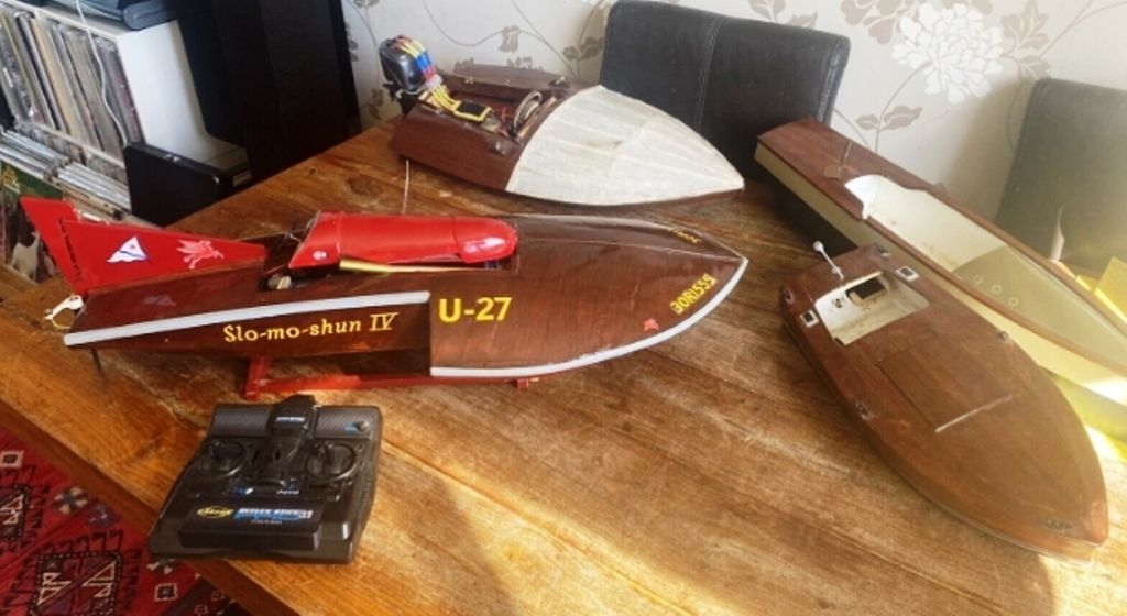

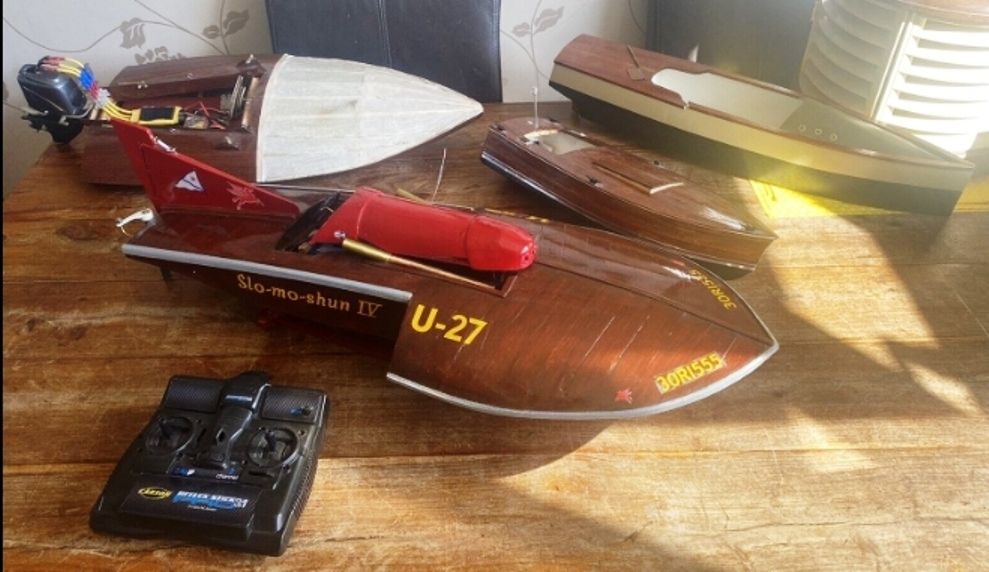

      sa9.jpgsa8.jpgsa7.jpgsa6.jpgsa5.jpgsa4.jpgsa3.jpgsa2.jpgThese boats finished at 8PM Australian Time for once !!!
      Two runners, the Slo Mo Shun4 and the Spitfire.
      The other two unknowns and no size, but they look in good condition.
      I found the Cg point for the spitfire, but none on the Slo Mo.
      I have downloaded the build manual for a start.
      If someone can help with the CG for the Slo Mo would be lovely.

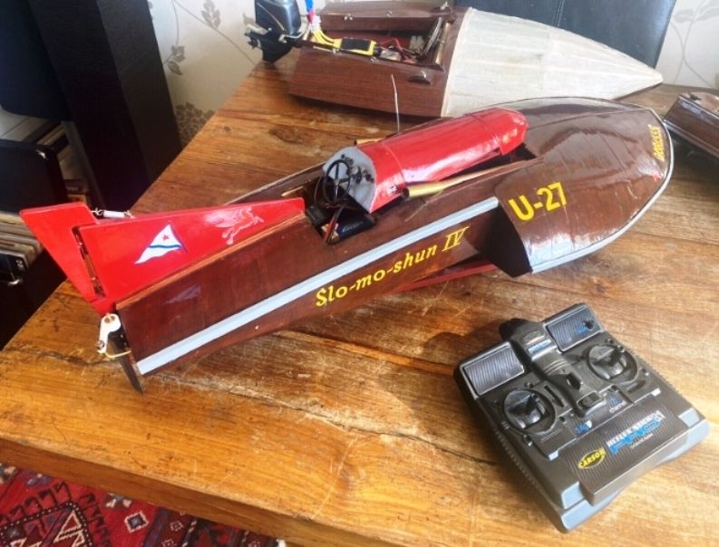

                    #101527

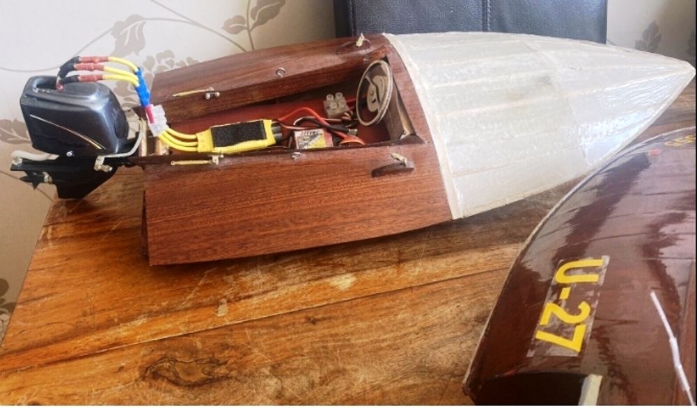

                      Hi All

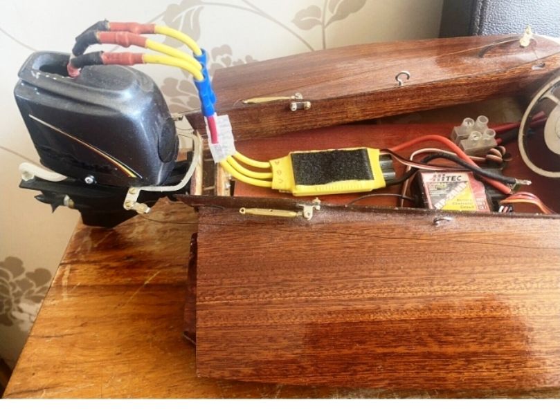

                      The Slo Mo Shun 4 with Carson 2.4G radio, Carson Nimh 2100mah battery and Viper ESC work OK.
                      The tail fin requires repairs.
                      The Spitfire, well the outboard works OK, but the ESC is dead.
                      Found the Lipo battery under the forward tissue cover dead and burn marks on it.
                      Strait in the bin, will replace with two small 3S Lipos with the throttle at 70%.

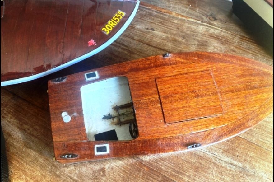

                      The Little deep vee (590 x 110mm) has a brush 380 with shaft and prop.
                      The river steam like launch (710 x 220mm) has no motor or shaft.
                      Both these are up for sale at the club.
                      Happy with the two main boats, just waiting for the weather to warm up to get back in the garage.
                      Harry

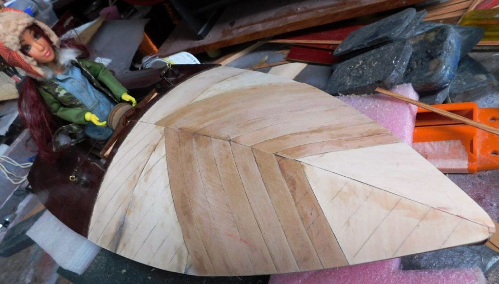

                        #101636

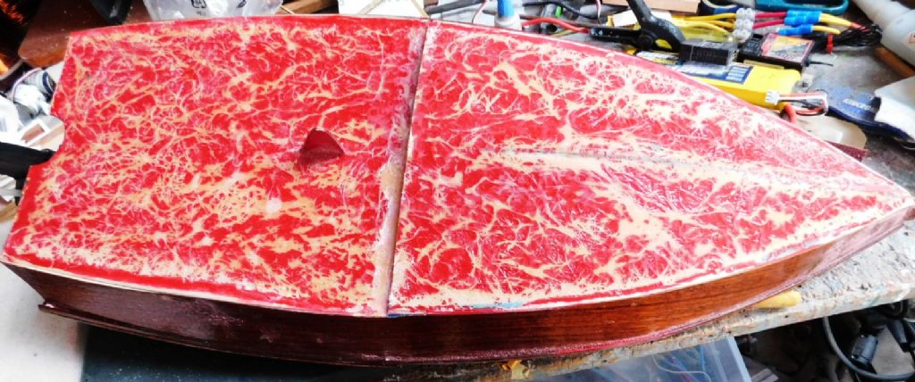

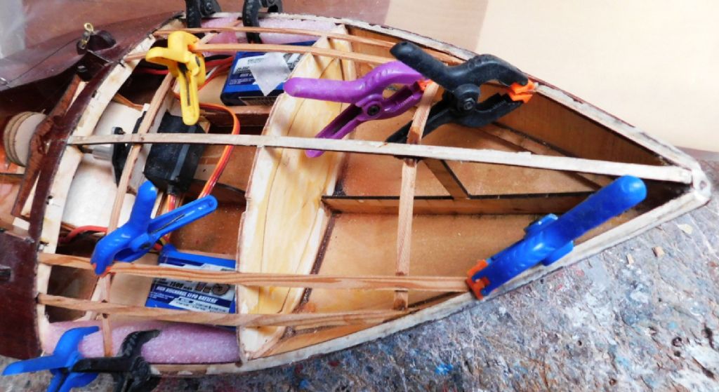

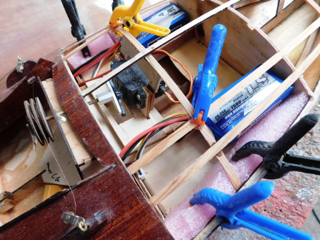

                          spitfire 4.jpgHi All
                          We have a few warm afternoon of 14C.
                          So I started on the Spitfire !!
                          The bottom was a very rough fiberglass job with holes and lumps.
                          I bit like an English road !!!
                          All sanded down and ready for paint.
                          Removed all the forward stringers and added two cross stringers as well as a small plywood support.
                          Installed two battery supports so I can slide the batteries in and out.
                          The foam glue into place to stop the batteries moving about.
                          The batteries are 3S 80mm long and the same weight as the old battery(6 volts).
                          With the motor a 3600kv (about 21600 rpm).
                          So with the 3S batteries ( about 39960 rpm).
                          I will have to trim back the throttle stop on the transmitter to about 50 %.
                          For testing and trimming a bit less me thinks !!!

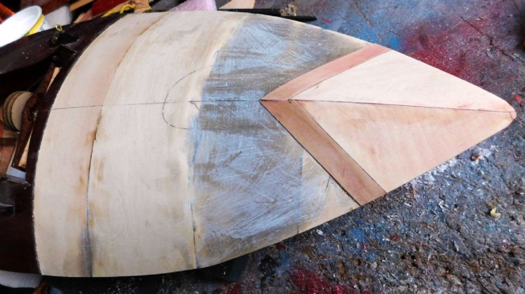

                            #101866

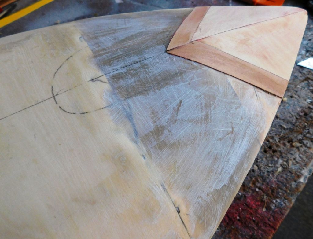

                              spitfire 12.jpgspitfire 11.jpgspitfire 10.jpgspitfire 9.jpgHi All
                              A bit more work on the Spitfire.
                              Reskinned the bow section with veneer.
                              First skin done and started on the second skin.
                              The third finally layer will have to be good, if not it will be painted.
                              Found a driver for the boat !!!!!

                                  The bottom was red fibreglassed very, very rough.
                                  This was after hours sanding back.
                                  Respray with filler/undercoat and repainted later.

                                    Harry. What is the little…fin??..under the Spit, in the centre?.
                                    #101880
                                      Hi Ashley
                                      It's knot a shark fin, but a turn fin just forward of the CG.
                                      Harry

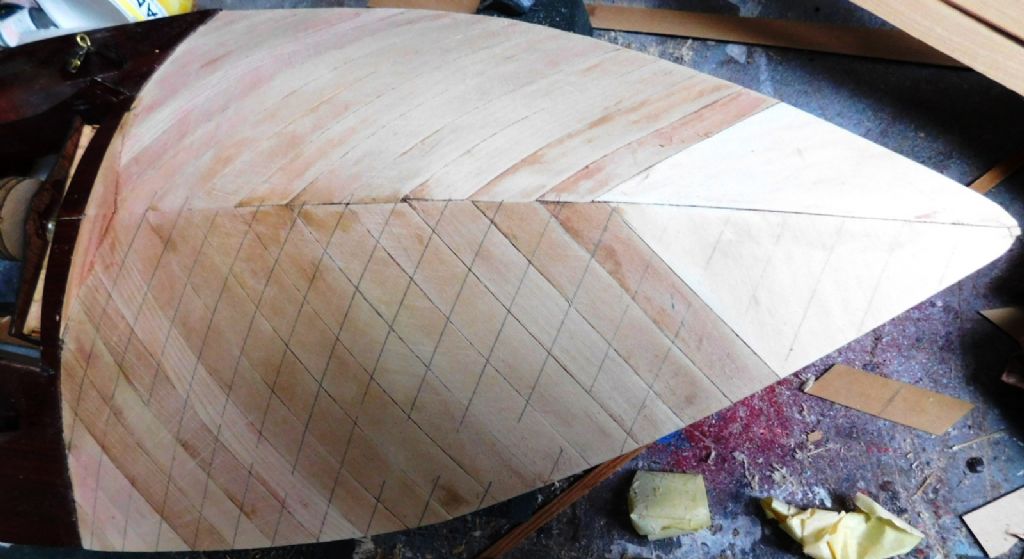

                                        #101942
                                          Hi All
                                          Finished the second layer of veneer and just started on the third and final layer !!!

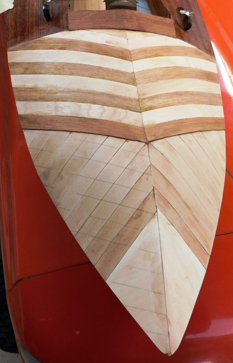

                                          #101994
                                            Hi All
                                            About half way thru the finally layer !!!
                                            Harry

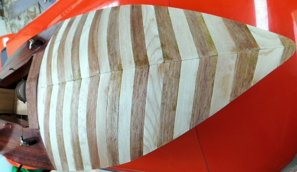

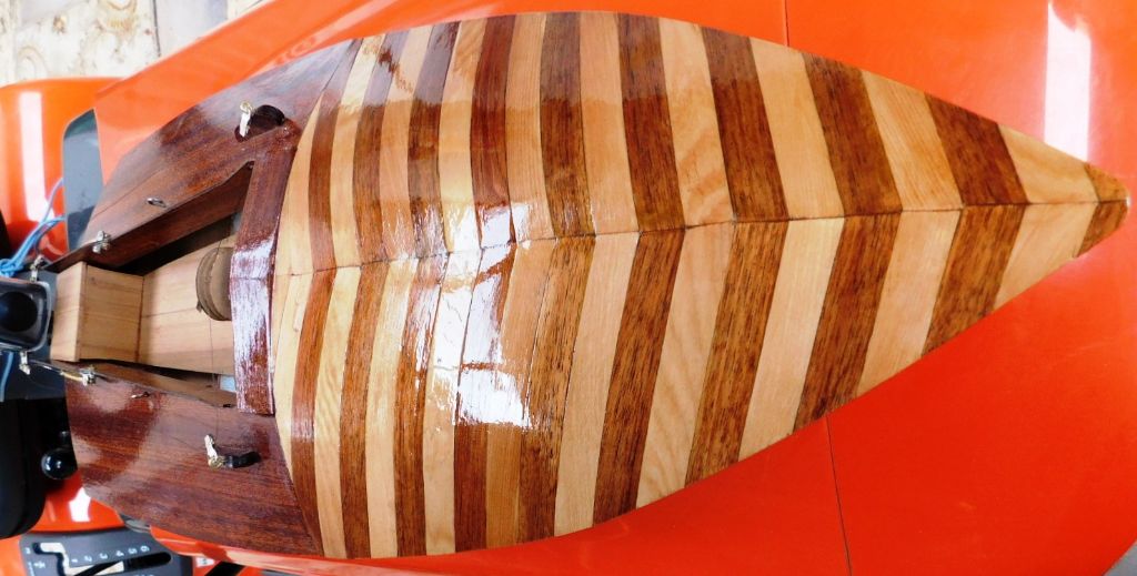

                                                  Hi All
                                                  The third layer of veneer on the boat, ready for vanishing.
                                                  #102032
                                                    Very nice Harry as always. Again your signature bling antipodean stripy finish.
                                                    #102052
                                                      Hello All
                                                      Four coats of BLING juice to keep Ashley happy !!!!
