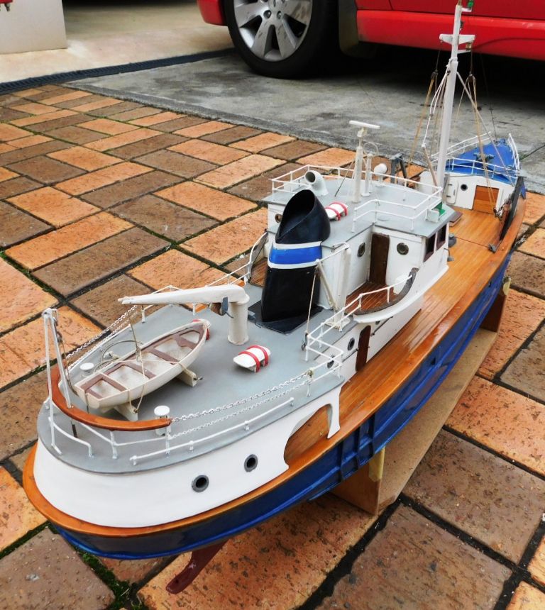

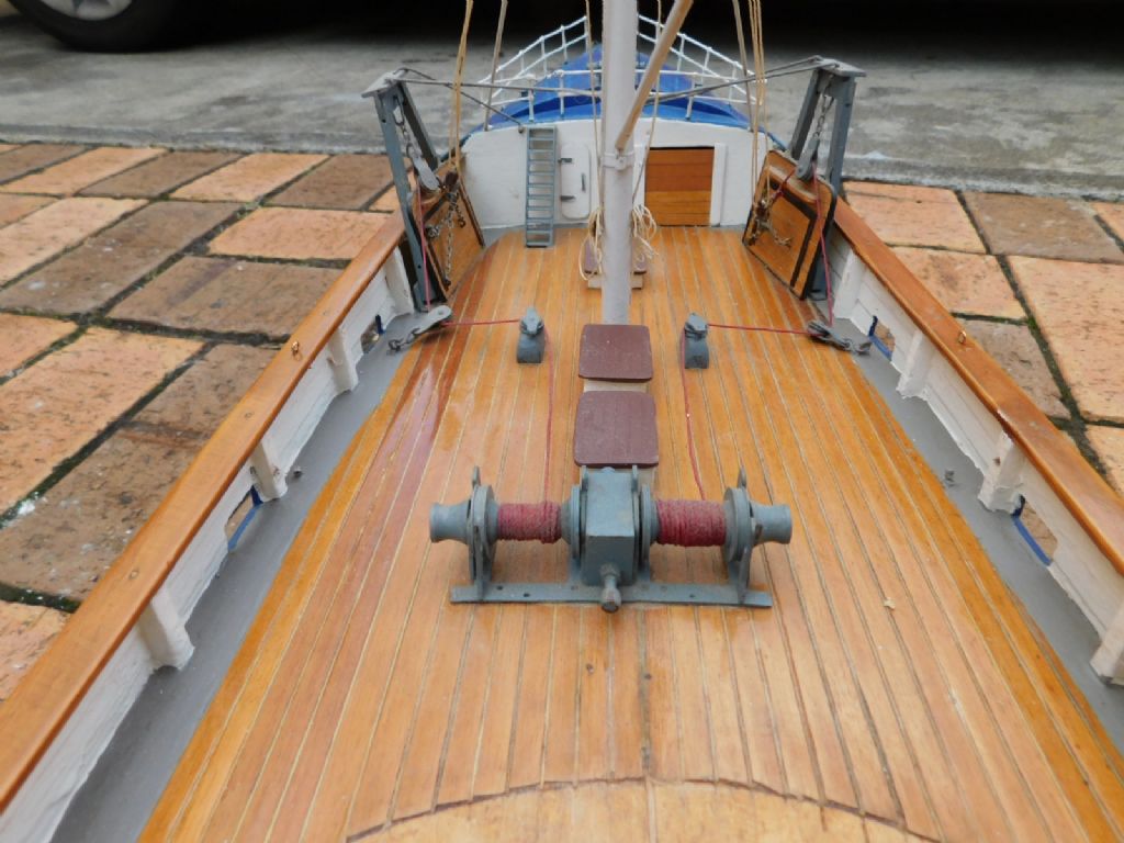

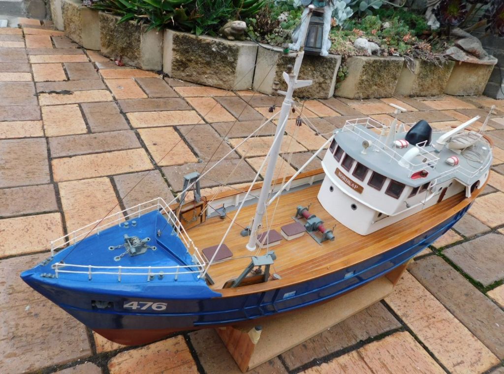

        nordkap 1.jpgnordkap 2.jpgnordkap 3.jpgI ended up with this as part payment for restoring the Moorcock(Shove It) tug boat.
        Downloaded the plans from Billings and off to the copy shop for a print out to the correct size.
        First up as a cleanup and repair to the top of the mast plus restring the forward stays.
        Next add a lock down for the rear of the wheelhouse/cabin and two magnets to hold the wheelhouse/cabin from moving forward.
        Fired up the motor and what a noise !!!
        Checking on the drive the bearing total shot !!!
        Board out the shaft which required removing the rudder.
        Installing a 4mm stainless prop shaft with Teflon rear bearing and a ball race inner bearing.
        The replacement is a 40mm 3 blade brass prop.
        Oiler for both the drive and rudder.
        Next installing the rudder servo whilst waiting some machine work for the rudder shaft and a thread to be cut on the prop shaft.
        I have replace the 4.8 volt motor with a slow turn 540 motor which sounds slower revs that my go to 80 turn rock crawler motors(5400 rpm @7.2 volts).
