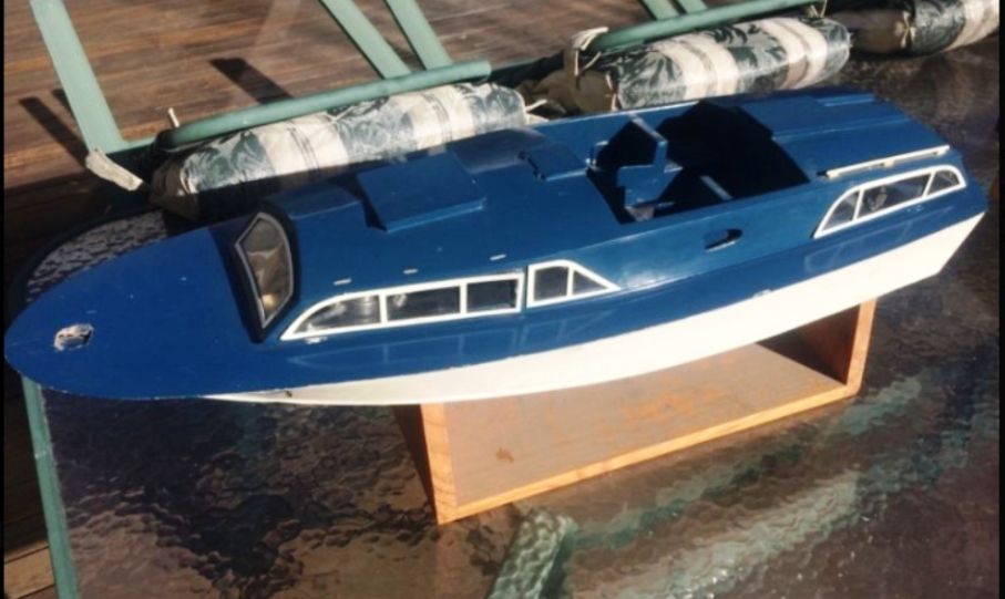

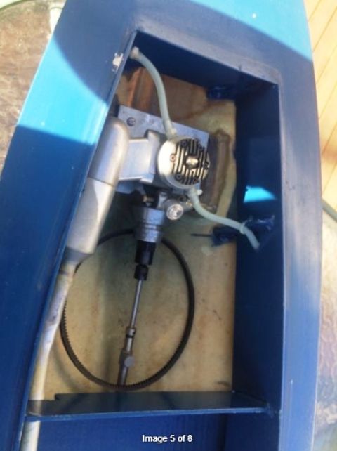

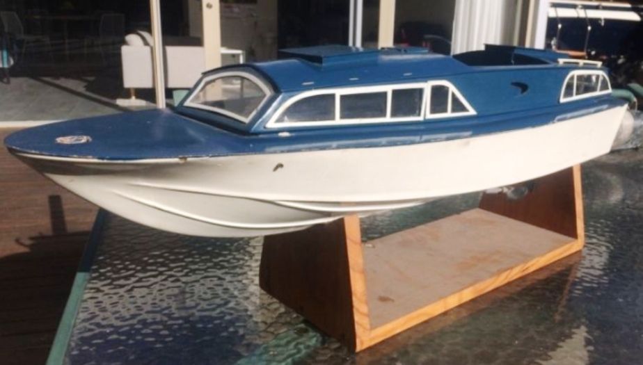

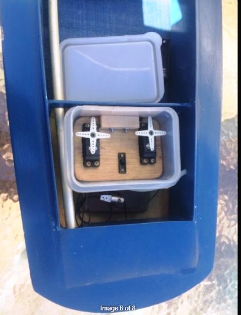

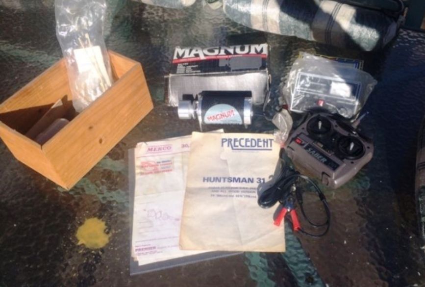

        huntsman6.jpghuntsman5.jpghuntsman4.jpghuntsman3.jpghuntsman2.jpgHi All
        I bid and won this on Gumtree for $200 AU with a Merco 40, starter, glow plug panel, radio, fittings and plans.
        It is an unfinished project and requires a bit of TLC.
        The deck and cabin are painted all blue which looks crappy.
        The radio, motor and starter are to be sold off.
        I am guessing it has old school 3/16 drive line so I will replace the bearing and shaft and install my spare 3648-1450kv brushless motor, 100A ESC, 4S Lipo 5800mah battery to run a 2 blade 40mm CNC alloy prop.
        As I am going on the photos because I receive it tomorrow things may change a bit.
        The forward deck has a hole in it and it looks like it's not glue down correctly.
        I may call the Huntsman Guru, Sir Dave M on this one!!!
