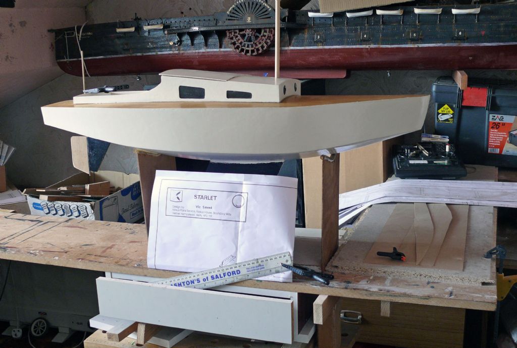

                  #42002
                    Hi chaps
                    Finally have the plan from My Hobby Shop…….Delivery was about 7 days…..Excellent
                    First job…..Turn a bung on the lathe, then cast the lead

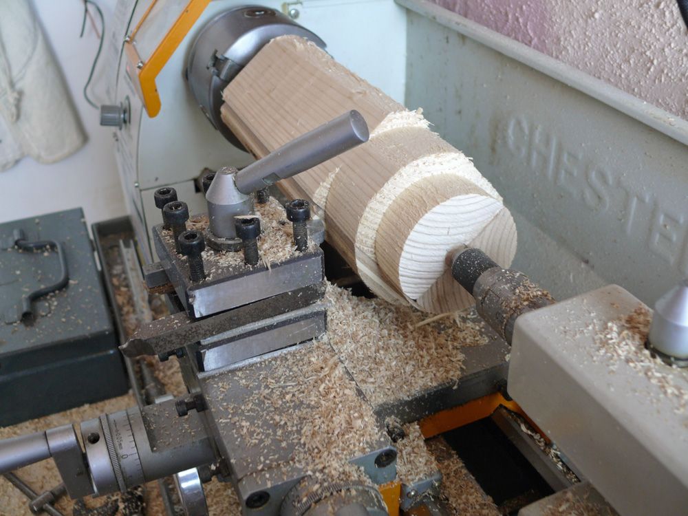

                      #42064
                        Thanks Kimmo
                        Just started making the plug………All great fun, turning chunks of wood in the lathe!
                        Will split the plug and use one half in plaster
                        All I need now………….Is 5lb of lead
                        There`s not much of this stuff lying around these days!

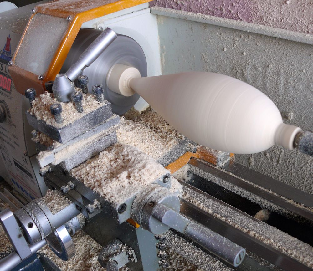

                            #42091
                              The wooden plug was great fun to turn on the lathe
                              The next job is to split the plug along the centre line to make one half of the pattern
                              In my good old engineering days at work, the patterns were painted orange and black
                              So I`ll do the same……..For old tymes sake?

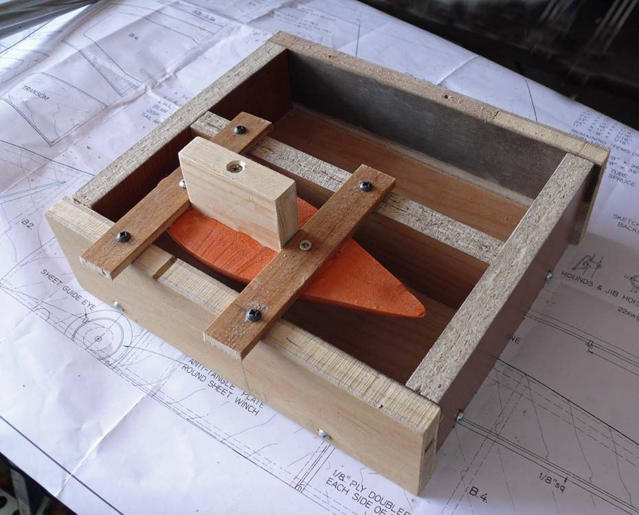

                                    The mould box and plug pattern
                                    The plug is screwed down to prevent the plug from floating in the liquid plaster

                                      A quick question for the hard of thinking (like me) how will you prevent the plaster from sticking to the plug as it sets?
                                      Paul…Perplexed sad
                                      #42106
                                        Hello Paul
                                        For starters, the plug is painted
                                        I will probably add a coat of Vaseline too
                                        It's not much of a problem really

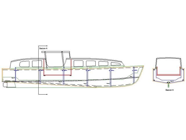

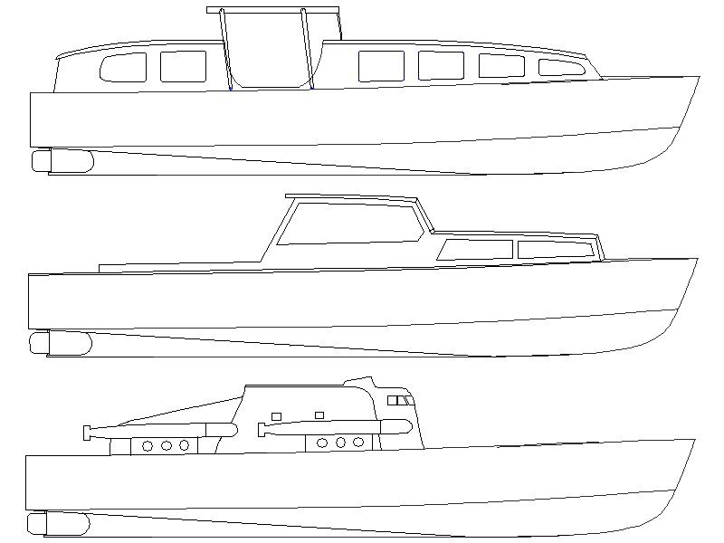

                                          I am busy working up the drawings for the multi superstructure hull that we discussed a few weeks ago
                                          The full cabin version worked very well as a prototype so I decided to work them all up into full drawings. At 3ft they are a little on the small side for my liking but at least I can have the prototype on the table whilst I do the detailing.
                                          How is life with you? Its a bit hot where I am.

                                              #42110
                                                Hi Bob
                                                Here is the cross section that you requested.
                                                Hi Kim
                                                Its a straight forward Perkasa but oddly enough its also the one design that I am having trouble with.
