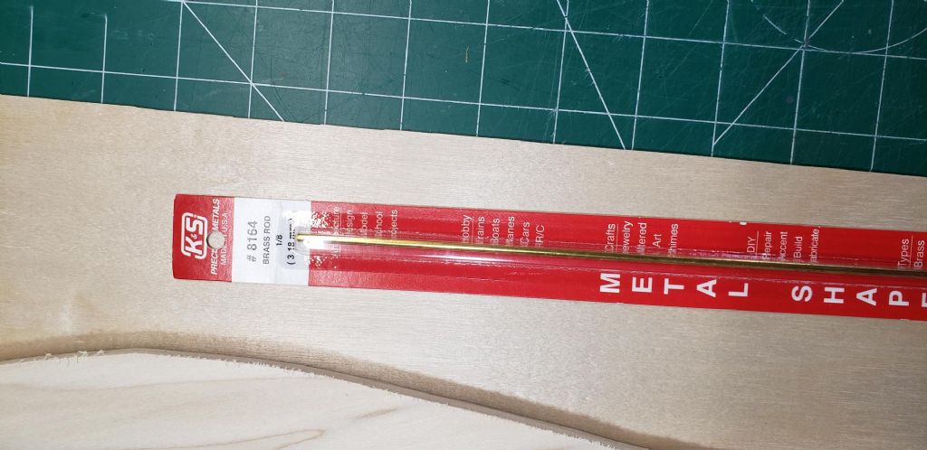

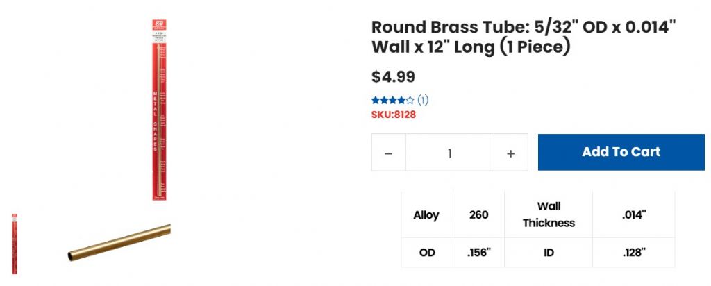

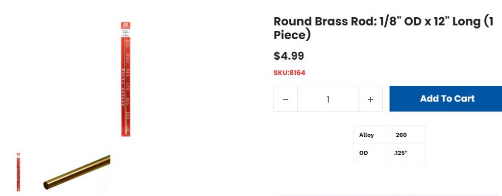

                                  Hi Mike – this is the 1/8 brass rod and 5/32 brass tubing that we use for rudders. It is from K&S Precision Metals and can be bought at most hobby shops or on line.

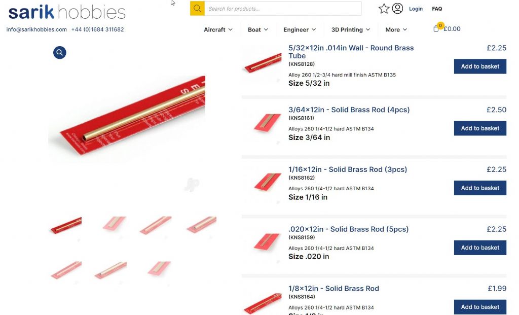

                                      Just checked and Sarik Hobbies stock them. Handy is you are in England.
