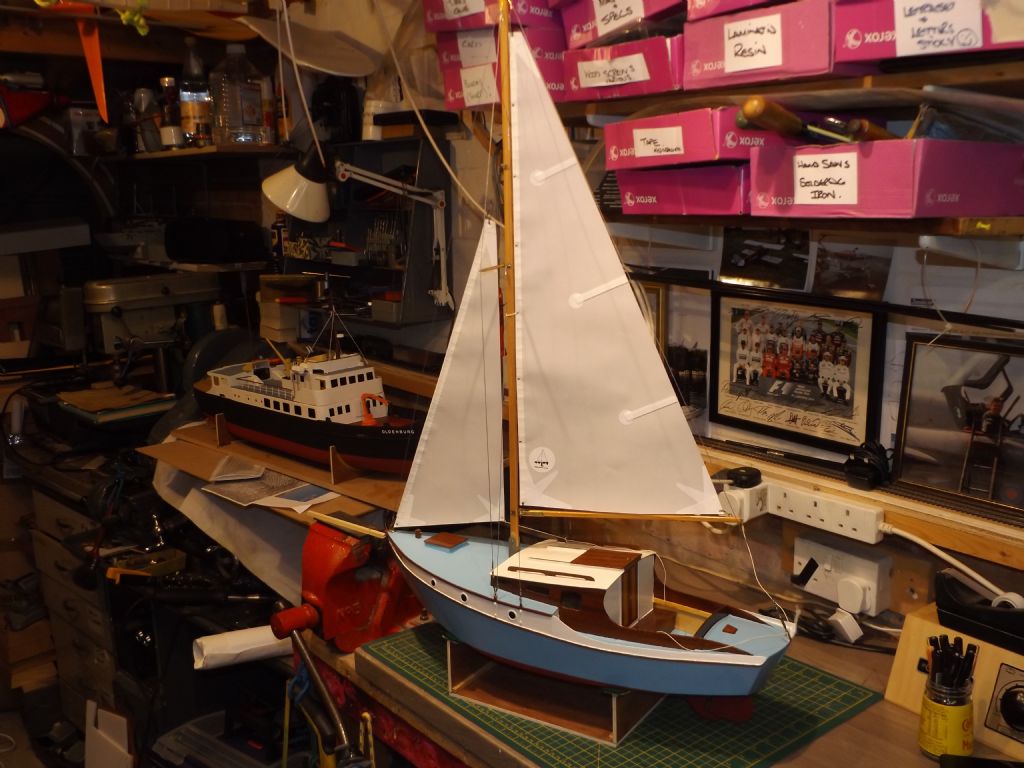

          Hi Ray…..Nice 'yard cradle'! Everyone seemed to notice that first! Nice sails too! Boat's not bad either!smiley.
          Sails looked at first to have been starched with built-in 'camber' (can't remember if that's the right word so early in the morning) but see from your text that they've been rolled up for a while.
          For what it's worth, the sail sailcloth that I have, came from CMB. Armati -"sail cloth for modern yachts". I think it's nylon -not sure- but deffinately synthetic. Bought also some dark blue cloth from CMB, that's from CAP Maquettes and is 100% cotton. It'll be a few more months before the sewing maskin needs to be plugged in.
          Is your Jet Provost / aircraft arsenal pictured in some other forum? I'm impressed by the number of different projects you have goingsmiley

                Taking a break from the fittings and painting Oldenburg, not the a finished job just yet but pretty close, almost ready for me to sail off into the sunset The foresail will be self tacking on a horse, and the lever arm servo will control the main sheet also from a horse across the back of the cockpit as did the original.
                Next sailing project to rig & sew the sails for will be my Thames Barge Portlight !!

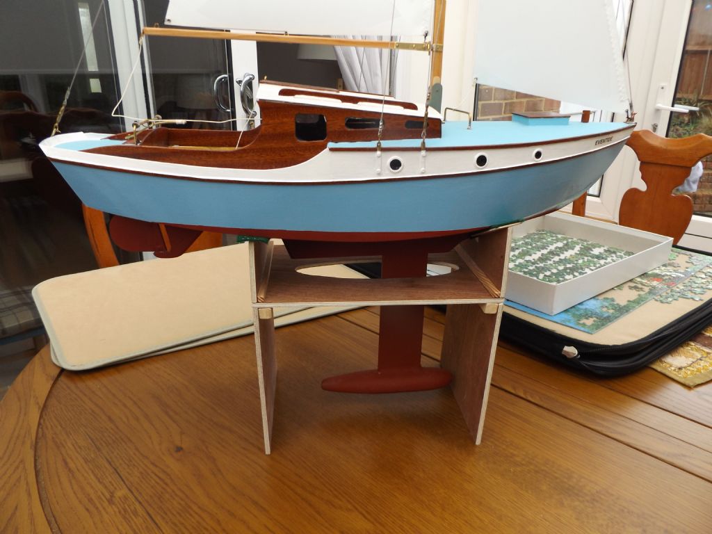

                            Nearly finished this build with the detachable aluminium/lead bulb keel 2 lbs fitted, the build stand is extended with ply to allow her to sit higher up in the world, I'm thinking Easter could with luck be the beginning of our season at the Chantry MBC at Bluewater Shopping Centre in Kent

                              Hi. Ray, she does look good,I like the colour scheme.We should be able to meet in pairs from next Monday as we can spread ourselves around the lake and not everyone will want to turn out just yet.

                              #94023
                                @timrowe83142
                                Bags of character Ray. I like it a lot.

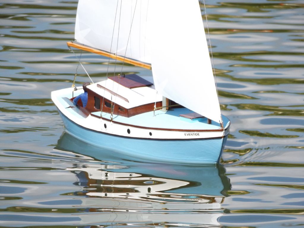

                                      eventide bw 1.jpgHi All,
                                      Just to let you see Eventide finally on the water this weekend for her first proper voyage, I think she will need some heavier crew in the cockpit to lift her nose slightly, All in all pleased with the bigger sister to Wild Duck, who by the way I met one of our new members Phillip AKA ( Philby on here) at Bluewater Chantry Club eventide bw2.jpgwho is building WD, good luck

                                          Looks really good Ray.
                                          Are the sails self-tacking or servo operated? Looking to nick for the Fisherman!

                                            Chris. I think Ray is controlling the main only leaving the jib to self-tack. The main is much larger than the jib so shouldn't affect the downwind performance that much.

                                              Yes only a self tacking jib on a horse, she hasn't have much sail area really, and yes a standard good quality AVOX servo with a 3" brass extension lever lets the main out enough for reaching & running.

                                                The eventide looks really super Ray.
                                                If you can get at the inside of the transom, maybe you can glue on wheel ballancing weights? Halfords?
