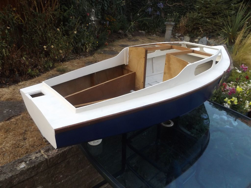

          Pressing on with the brass rudder blade being soft soldered to the stock, with the skegimg_20200910_130316.jpg it's the only way fixing it insitu 😀👍
          #91401
            @timrowe83142
            Hi Ray
            Coming along very nicely indeed.
            I have a fear of building movable things in permanently so I would have chickened out and made the skeg with a removeable heel fitting.
            Will that rudder be big / deep enough for sailing or are you planning to fit an extension TB style?
            Tim R

              Hello Tim,
              Yes your right 😀 not enough thought on that rudder, I'm fairly good at building problems in !! She is fairly a fairly small model, I hadn't given much thought to access to the servo either , which is now tucked under the rear cockpit deck , wish I had built her slightly larger now. Extension rudder is a possibility if needed 👍

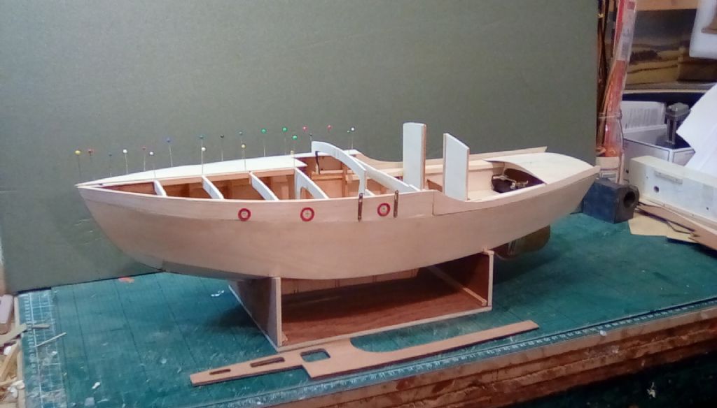

                Fair progress with the cockpit, rear cabin bulkhead and brass chain plates fixed with 10ba bolts & nuts and half the foredeck glued and pinned, I'd better order some sails from Frankimg_20200919_210116.jpg soon 😀

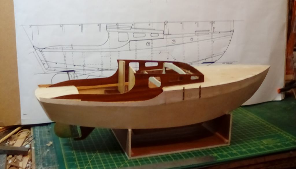

                  Eventides coming together fast now, mahogany cabin sides & front in place with a coat of varnish to protect the brightwork from the painting, I'm going to make the whole cabin roof removable for Access to the lever servo winch and the pin to retain the fin keel. I didn't make Wild Duck with enough access so we do live & learn 😀

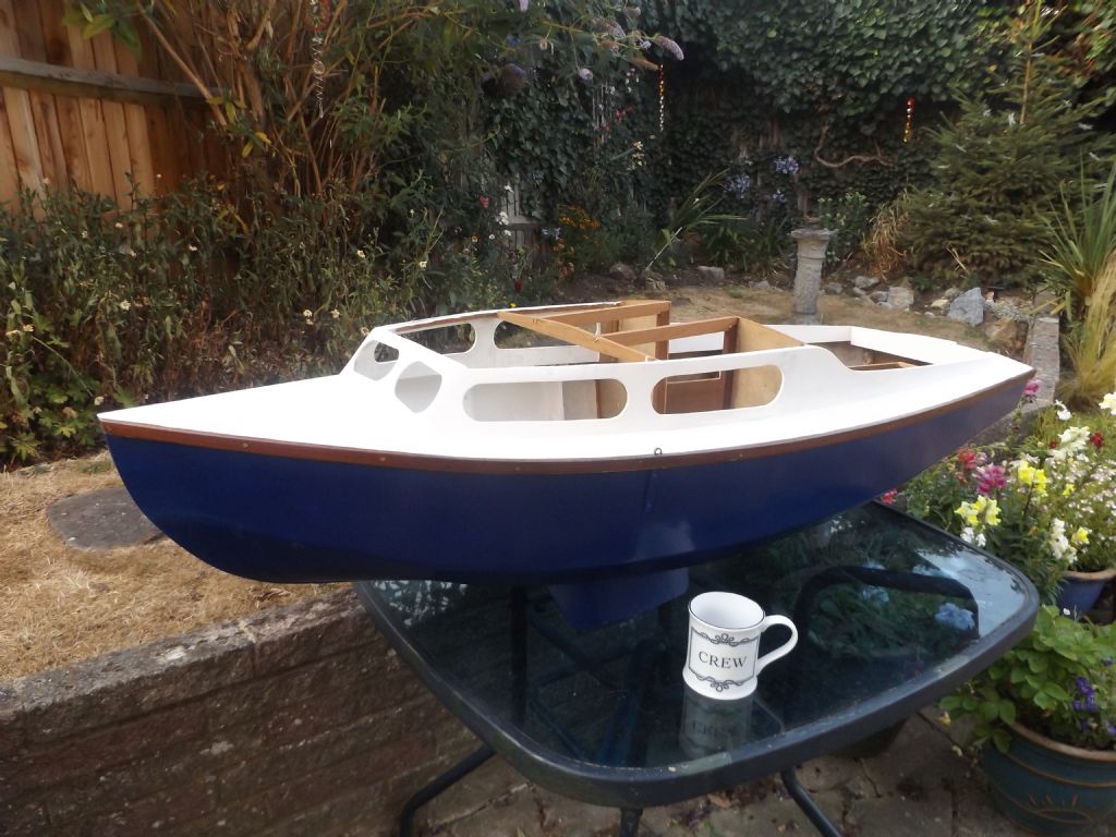

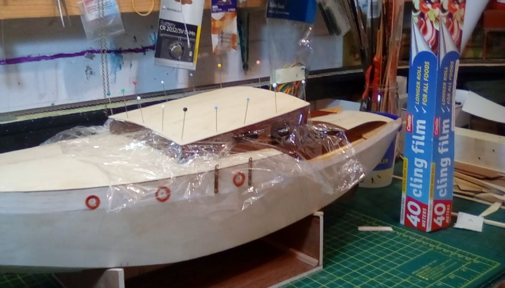

                          Still some more mahogany to be fitted with rubbing strakes etc,
                          Here is my top tip for making the cabin roof insitu, make the subframe fit the opening and clingfilm the joint before the top sheet is glued in place, only an old aeromodelling trick for building wing root fillets, still works hopefully

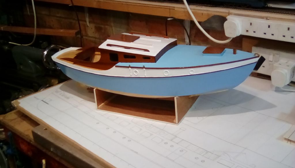

                            Eventide in the paint shop on the drawing of the next project 😀 MV Oldenburg, fancy a small ship ??
                            Oh yes and I ordered her  sails from Frank at Nylet today 👍

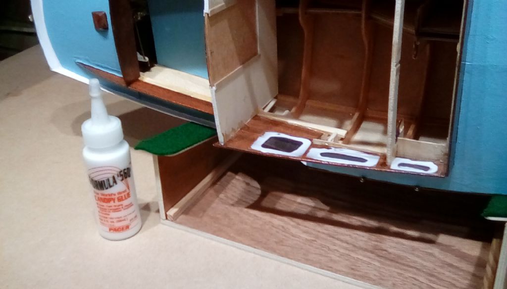

                                      Cabin glazing in progress, with most of the painting complete, fixtures & fittings next 😀
                                      For anybody new watching Formula 560 canopy glue is brilliant and drysimg_20201019_163854.jpg clear so acetate Windows are a doddle 👍

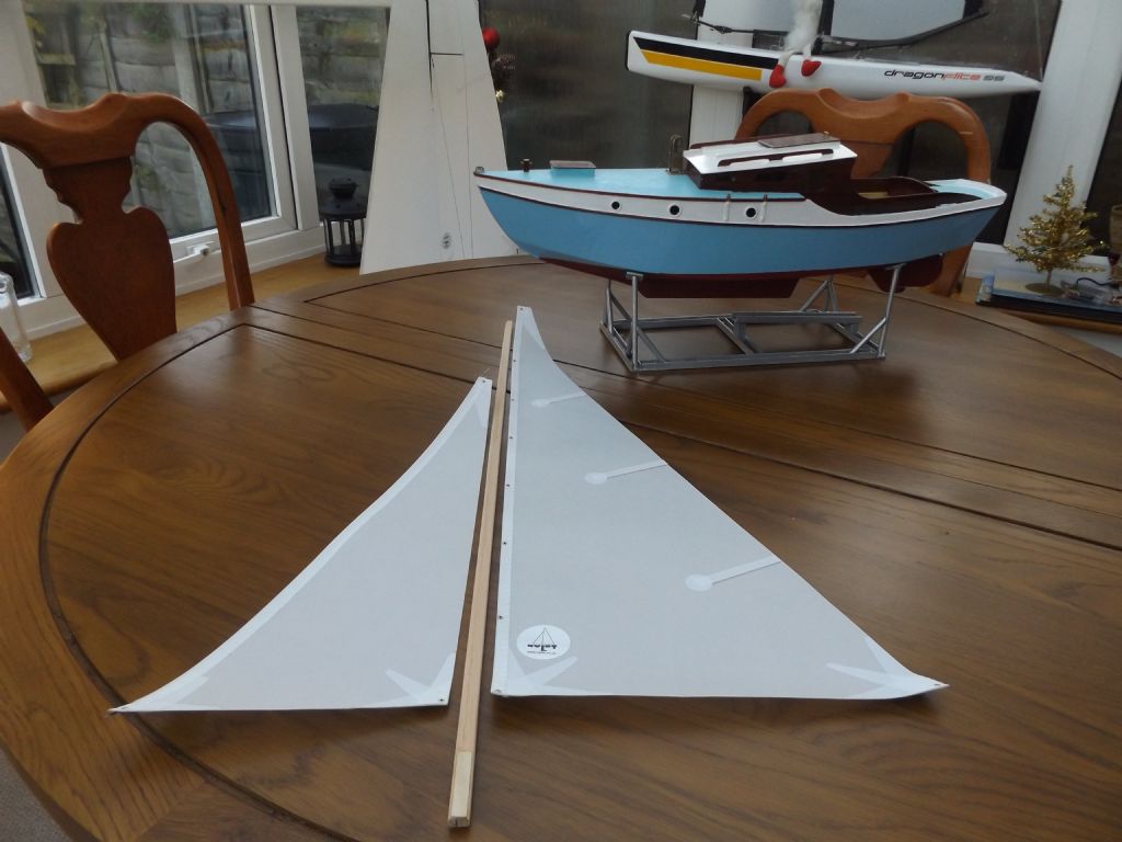

                                                Remember this one ?? well the sails have arrived from Nylet, and very nice they are, this is the third set I've had made by Frank and worth every penny they come rolled in tube and take a while to uncurl once hung upeven sails mast.jpg. The original Eventide mast would have been made from solid or built up timber I have glued 2 pieces of spruce together and planed down to a slight taper at the top, fittings next

                                                  @timrowe83142
                                                  Very pretty Ray
                                                  Are the sails woven cloth? If so, do you know how many grams per square metre?
                                                  Like the cradle too. Very authentic
                                                  Tim R

                                                      Hi Tim & Chris,
                                                      The sails are white dacron, but I'm not sure about what the weight & if woven but I will find out for you
                                                      The yard cradle pinched from Wild Duck, she doesn't mind as she has her own shelf/stand over our staircase with my sailing barges, the management has lodged a complaint about the number of boats in the conservatory !! but if have put some Christmas lights on the Dragon Flite which has eased the situation
