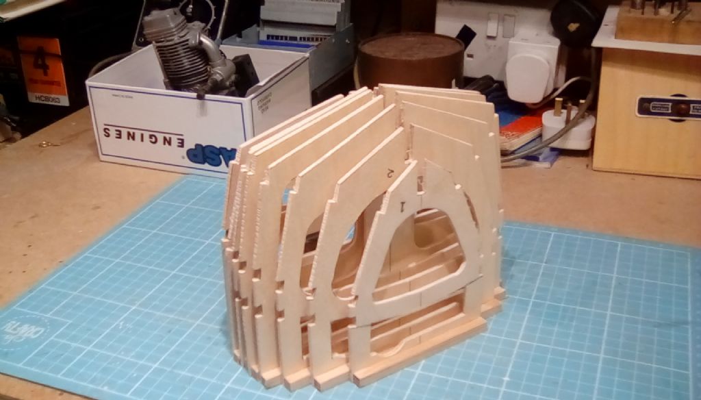

      Being back at work is a mixed blessing! But at least I have weekends again 😀 the tedious but also enjoyable process of cutting out the bulkheads is done 😉 should start having something looking like a boat soon 👍
      #90870
      gecon
        @gecon
        They look beautiful compared to the chopped up bits of ply in the hull of my Fisher. All glued onto the keel by today maybe? Looking forward to the next -and subsequent- photos.

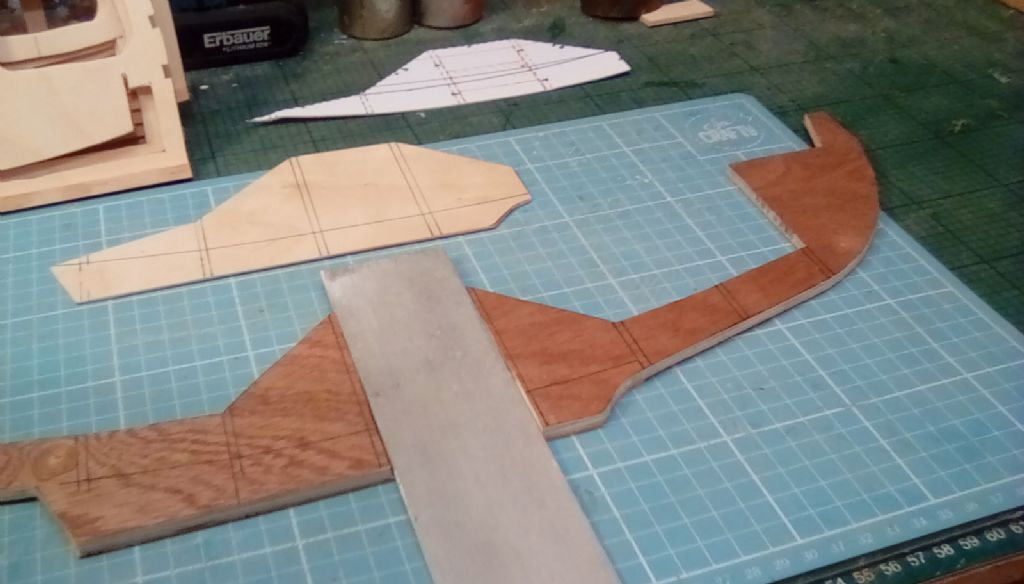

            This is my method for installing a removable fin keel in the Eventide for better sailing performance, it's rather like a dagger board in a dinghy, with a slot for the 1/8th aluminium keel contained by a doubler both sides of the central keel which is 1/4" ply some packing of 1/32 ply is required to make it a good fit, it will have a retaining pin inside the hull to prevent it falling out once the lead bulb is attached to the bottom.

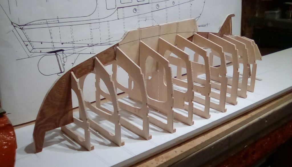

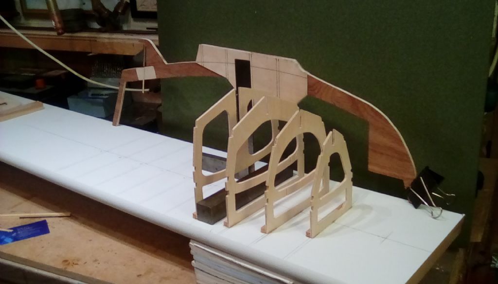

                    Splashed out on a new mdf window board from Wickes for a building board, now epoxying the bulkheads in position, this requires a little adjustment to fit the keel, I like this part as we see the shape of the hull developing 😀

                      Ray you Devil. You have really pushed the boat out on that window bottom.
                      Bri

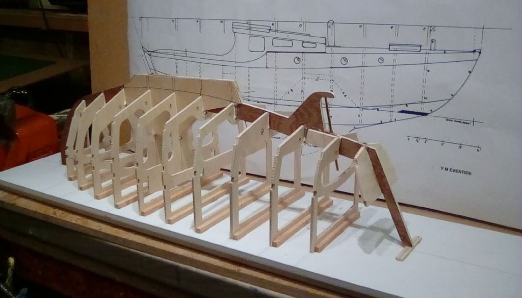

                          Interesting how things dawn on you along the way ! I had thought about putting the rudder tube in early for convenience, then realized the rudder blade will have to be soldered on to the stock in situ !! And make provision of a bolt on addition for sailing, chines & gunwhales next 😀

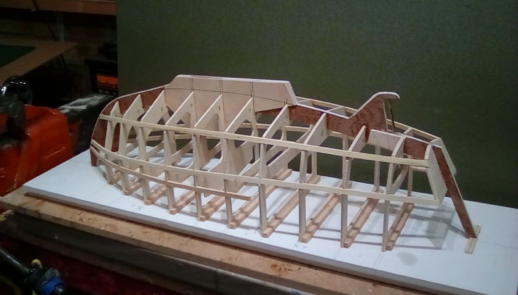

                            Chines & gunwhales from 1/4" X 1 /8" obeche strip in place and not to much jugging of the various notches in the bulkheads, always some re-alignment required, not bad this time 😀 now ready to overlay with tracing paper to get the 1 /32" skins the right shape 👍
                            Photo to follow 😮

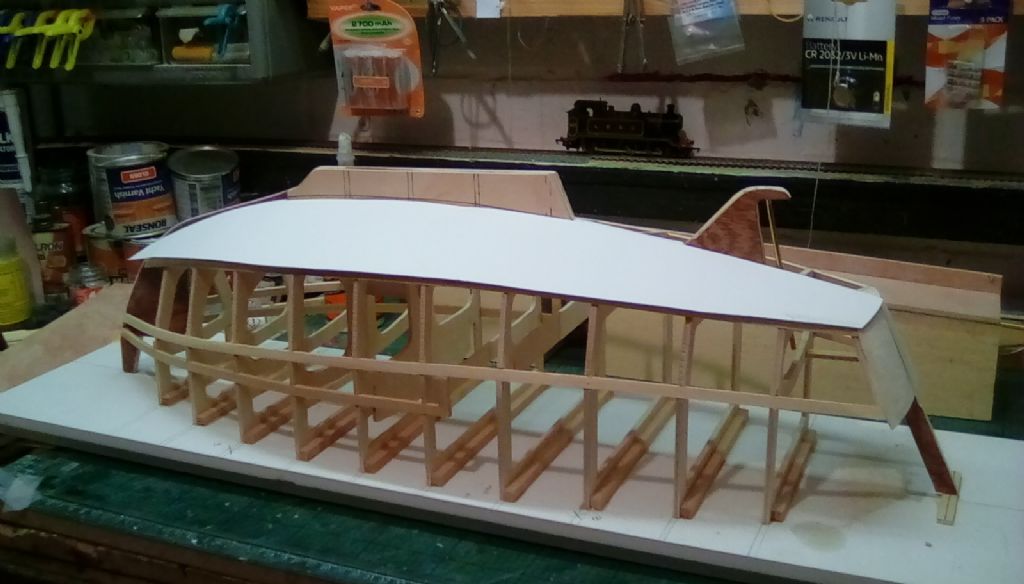

                                      Having spent the weekend 're-rigging a sailing barge, it was a good break and back on with the Eventide's bottom skins which sit on the bulkheadsimg_20200901_203818.jpg and butt up to the keel, finding doublers to much hassle and trusting internal glue fillets to provide a good joint.

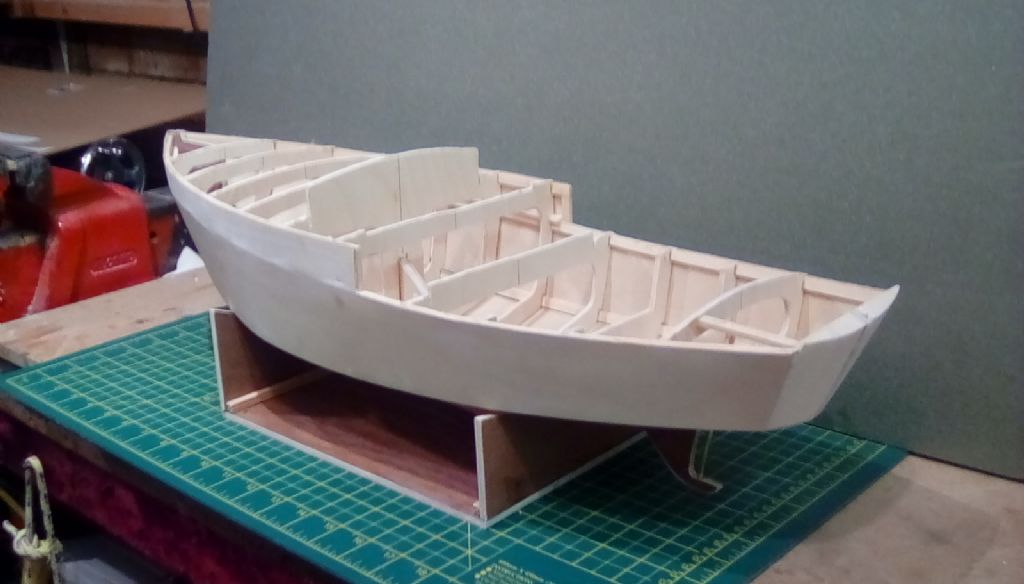

                                        Hull complete and free from the building board, sitting in the stand 😀 deck & cabin next.

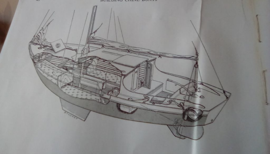

                                                Hi Ray,
                                                Are you going to have battened down sails -as in the drawing- and only motor power? Or will you be able to sail her too? It will look great either way I'm sure. Lovely subject.

                                                  Hello George,
                                                  I didn't bother with a stern tube so she will have sail power only, makes life more interesting 😀 I love making motor boats but they are fairly boring after the first lap of the lake !!
