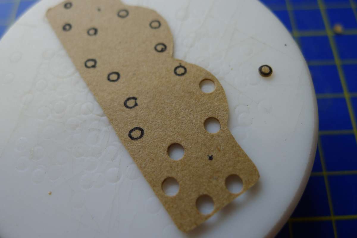

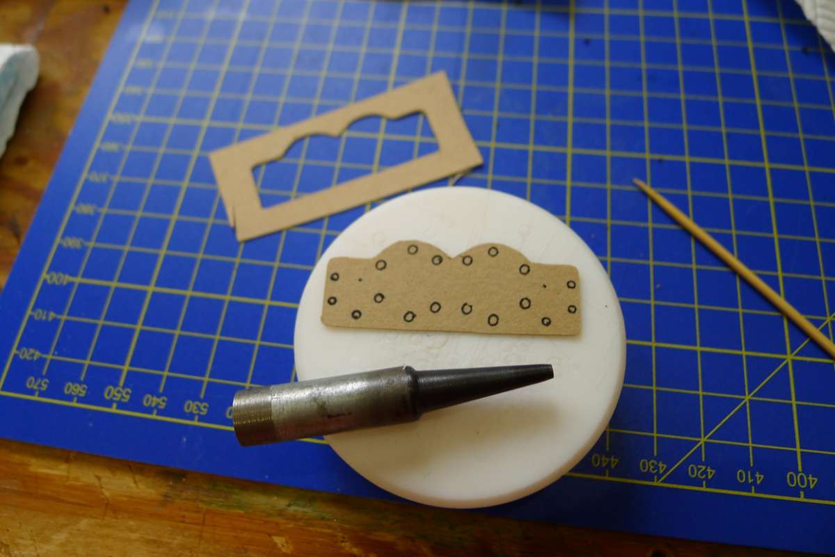

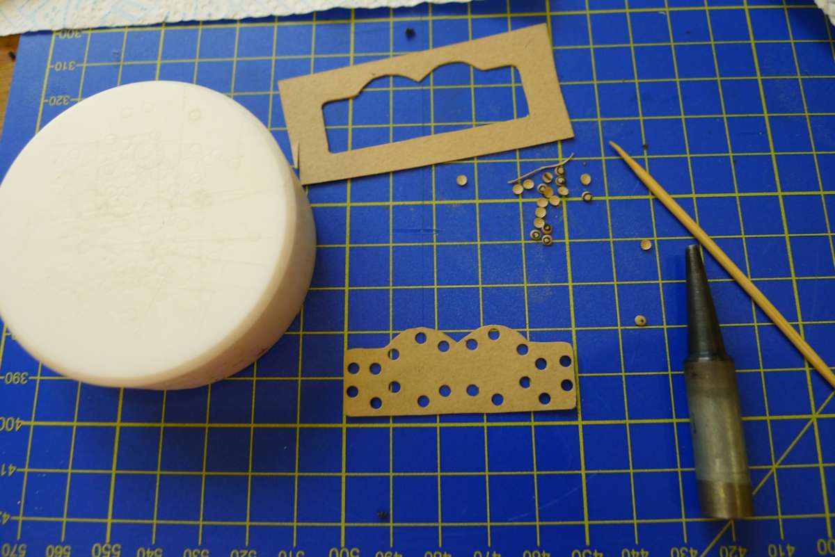

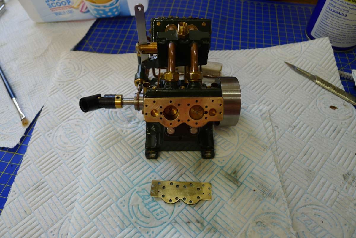

              Spot on Len, many cheap punches are sharpened on the outside so they leave a hole far larger than the size they quote.  They are usually a poor quality metal and badly sharpened as well.
              As with most things you get what you pay for so buy a good quality set of hole punches that are internally sharpened.  The trouble is with plasticard you are almost certainly still going to get some deformation and there is no second chance if you get it slightly out.  I’m afraid the best way is to use an abrasive and work to a line in the surface.
              If you do go for a punch I would experiment first and get yourself a good anvil.  If you punch onto a surface that is too soft the work piece will deform more and could become misshapen and if it is too hard the punch will blunt.  I use a nylon block, which seems to work well and gives good results with the trickiest of jobs such as this head gasket.  The punch was home made.

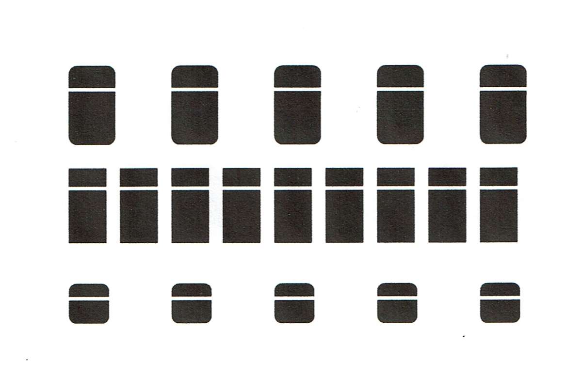

                    @bobwilson59101
                    I make them on the computer, print them onto glossy self-adhesive film, cut out and stick on.
                    Windows on computer - Copy

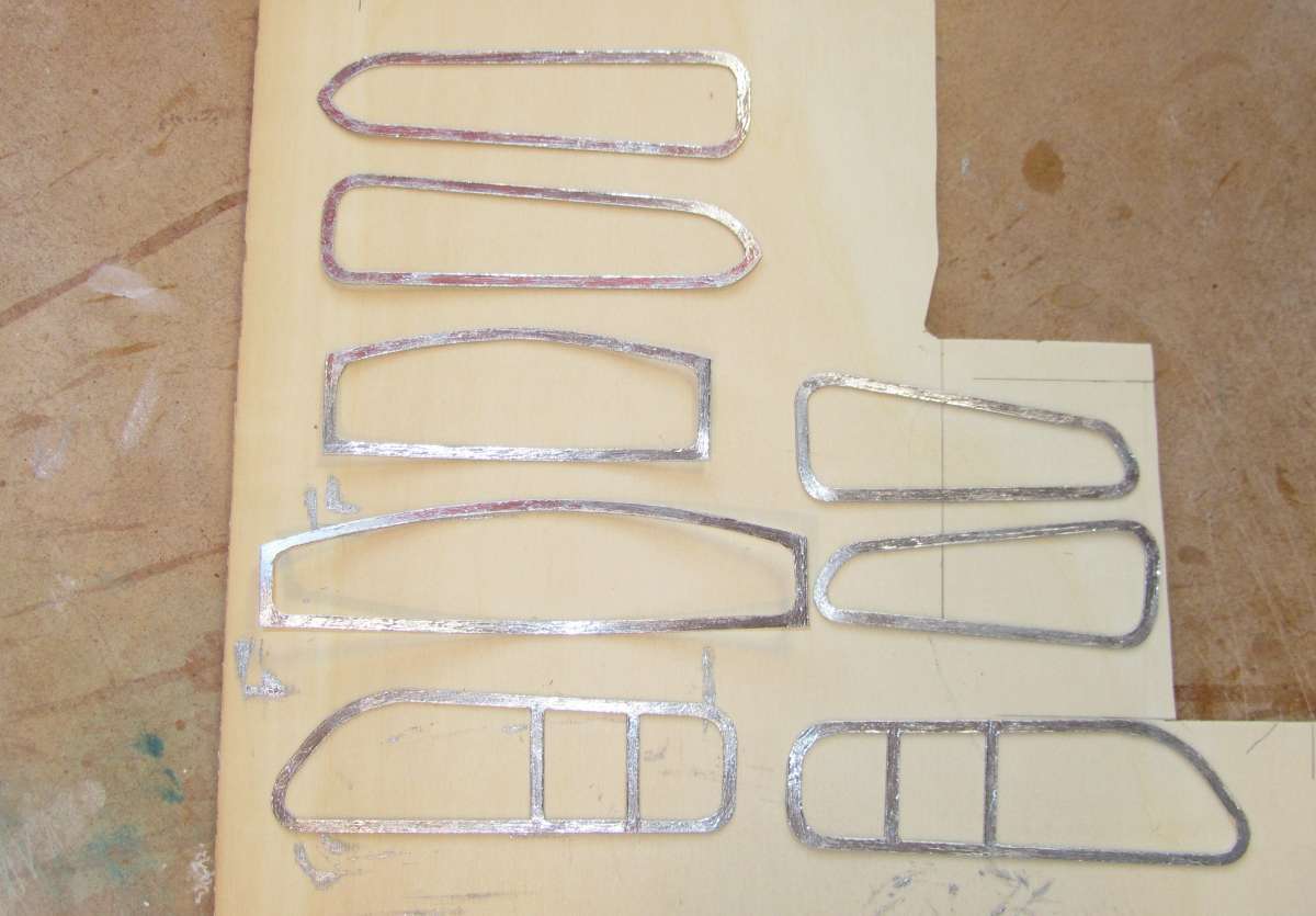

                                I was apprehensive about making my first windows, which was using thin Plasticard. My method is to use a knife for the straight bits and a good pair of nail scissors for the curves and finishing off with fine files if needed.
                                Windows 2
                                j0wduhq8xdw4t8lwcabebbft0ux6tplh
                                #123530
                                Fred Ellis 1
                                  @fredellis1
                                  Chris that does look good.

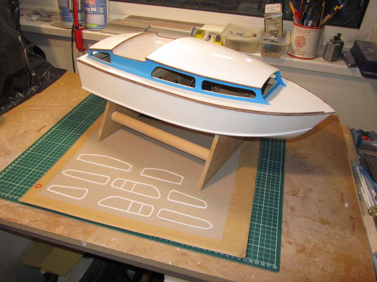

                                  gecon
                                    @gecon
                                    May as well chuck in my boat too… if you write in ‘Search’  the words “Fisher 34 Motorsailer” and go to pages about 6-8 you’ll find som photos of the Fidher wheelhouse windows. I only rounded the inside corners a little. The outer ‘frames’ are about 2-3mm evergreen strip. The outer corners were first fitted ‘square’ to each other, then rounded off to form a curve. If there’s some wood showing inside the curve, a small dab of paint conceals the square corner and makes it look like it’s curved….ish.

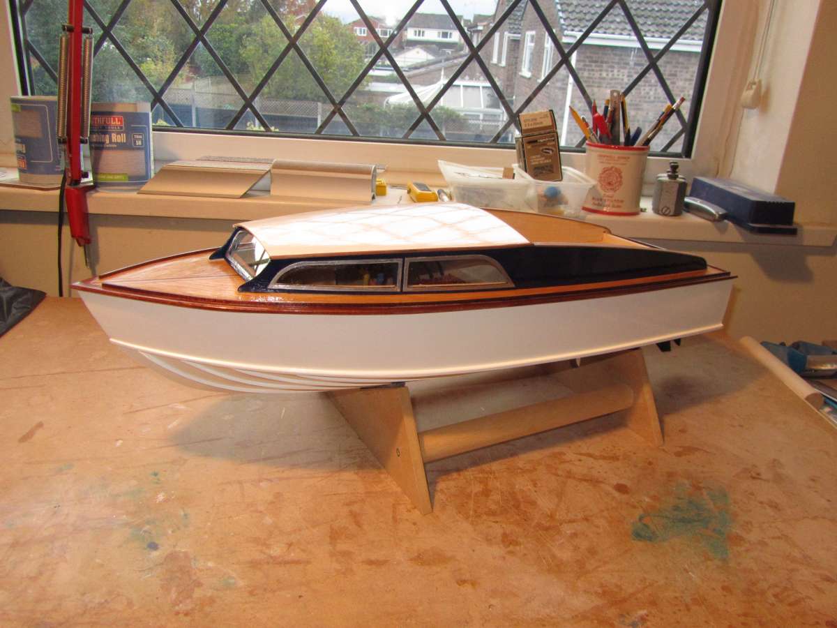

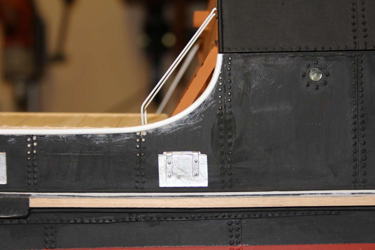

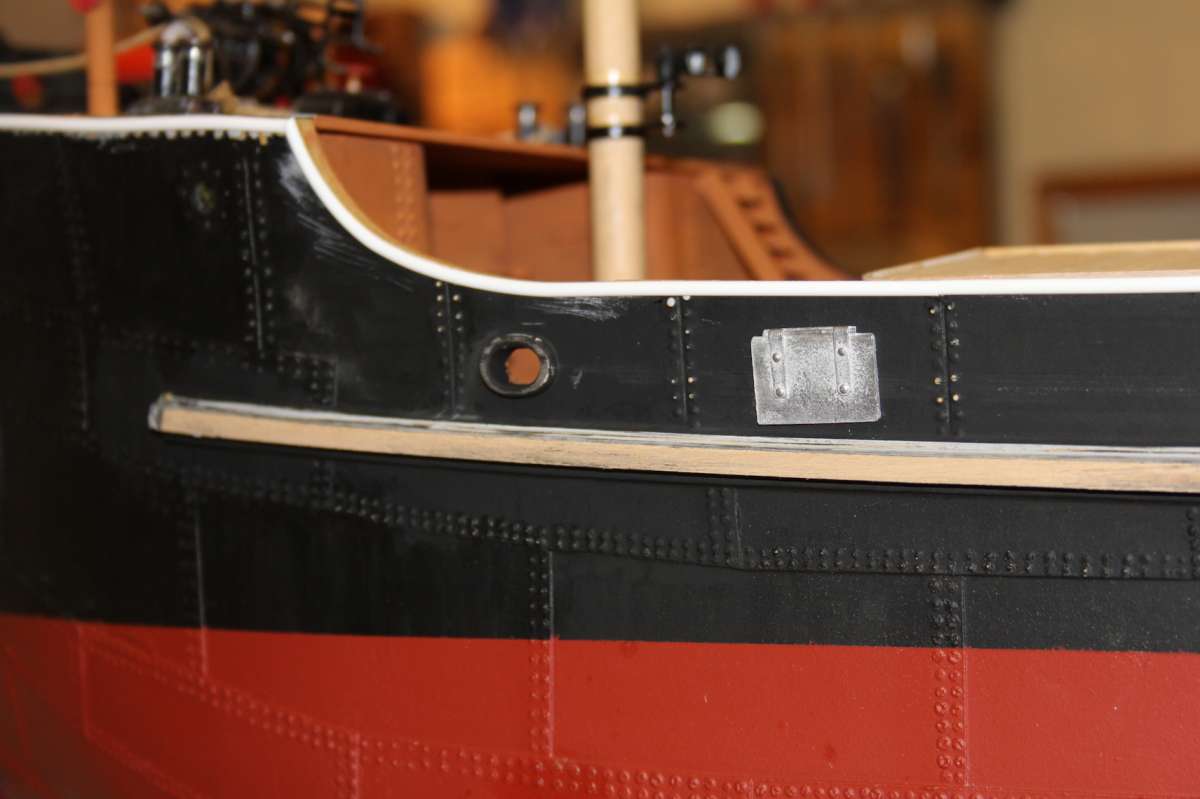

                                      I have to say Chris those windows look superb.
                                      Something someone might be interested in having a play around with, I have used Evergreen strips for various contour purposes and had good success with simply heating it with a heat shrink gun to bend it round corners.  One in particular was a bulwark capping edge that I wanted to follow the curve of the rail.
