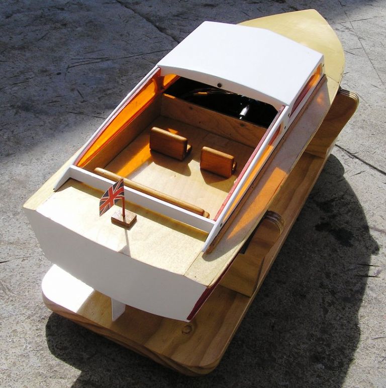

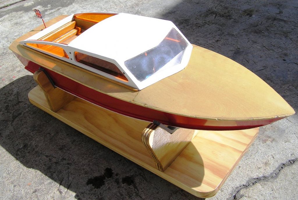

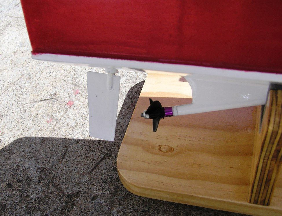

      p1010126.jpgp1010125.jpgHi All
      I think this is a Waverider 30"(710mm).
      It had a set position rudder with a Johnson 888 brush motor.
      The prop and prop drive bearings shot .
      The hull bottom has battle scars, but the top sides are in good shape.
      Removed the whole prop drive and motor.
      Installed a 35mm brushless 1450kv with a 40mm prop.
      Sanded down the hull bottom and undercoated back to the prop shaft.
      Also made a stand for the boat.
      That's in the first day!!!

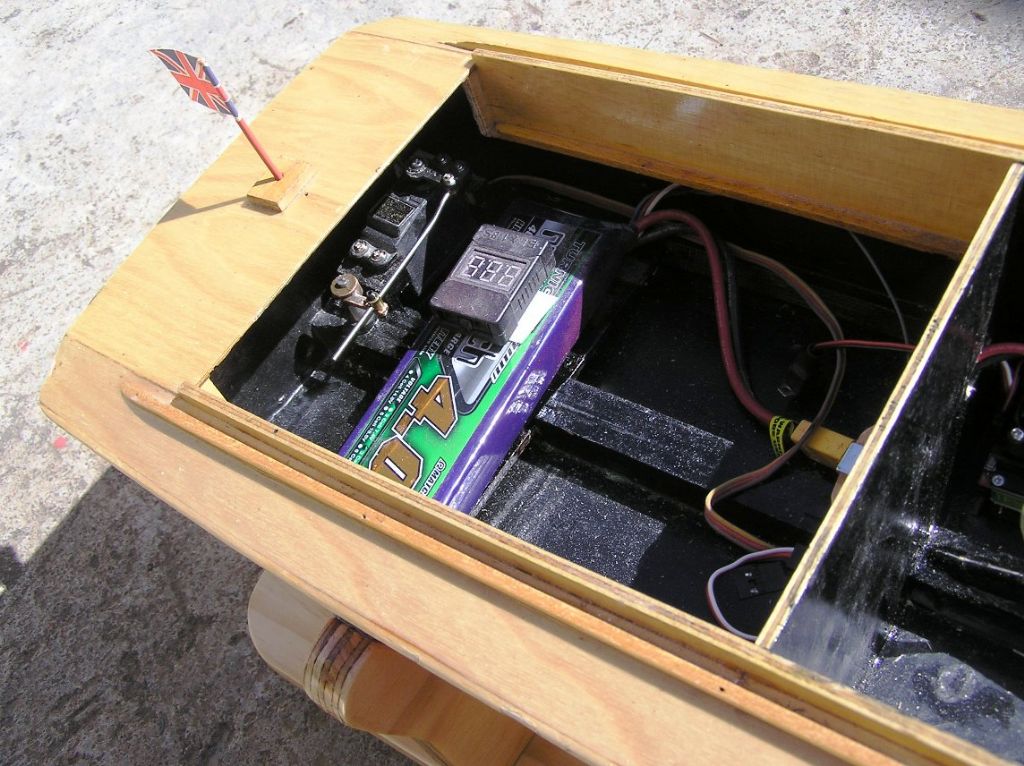

            Having real fun setting up the rudder without lifting the rear deck, plus the battery needs to be aft as possible for the CG.
            Seen a kit on Mayhem so I can see why the boat is bow heavy.
            The keel and stringers are more for a 60" boat.
            Harry

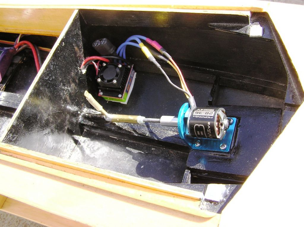

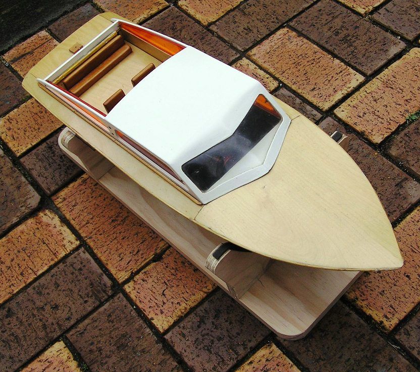

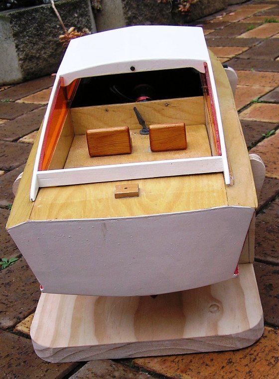

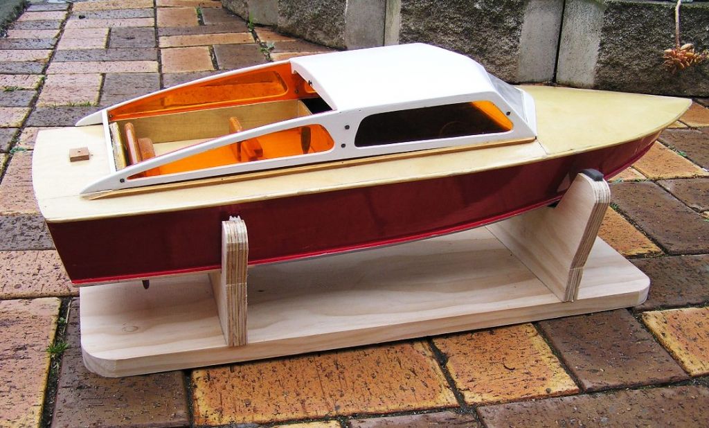

              p1010131.jpgp1010130.jpgp1010129.jpgp1010128.jpgHi All
              Mistake in measuring the boat is 28"(710mm) !!!
              Decided to install a 2836-1800kv motor on 3S Lipo (11.1volts).
              Prop is a 3 blade 30mm and I have a 2 blade 32mm CNC prop.
              I have a few other motors to test, 28mm 3000 and a 3700kv.
              Also planning to test a 35mm 2400kv from an old buggy.
              Finished the boat today and dry tested the systems.

                #84617
                  Hi Ashley
                  The only list of motor/prop/ battery combinations is it old grey matter !!!
                  3639-1100kv/ 2 blade 40mm or 3 blade 37mm/ 3S or 4S Lipo.
                  3648-1450kv/ 2blade 40/42mm / 3S or 4S Lipo.
                  Prop Drive V2 2836-1800kv/ 2blade 32mm/ 2S Lipo.
                  B28-57-15L 1900kv or B28-57-17L 1700kv/ 2 blade 32mm/ 2S Lipo.
                  Ran the Wave rider with the Prop Drive 2836 motor on 3S, but it chine walk on full rpm.
                  Drop back to a 2S Lipo which works very well with a good turn of speed and quick turning.
                  I have a 28mm 3000kv from an old Hobbyking outboard may test it next on 2S.
                  Harry
