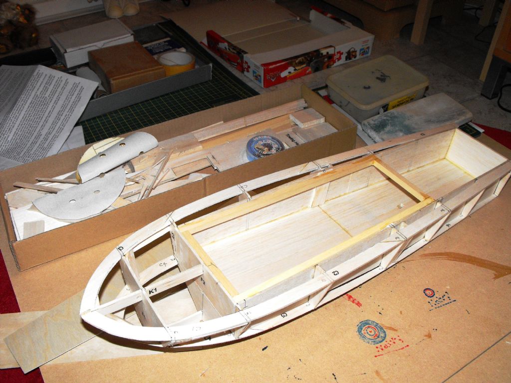

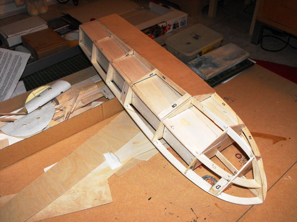

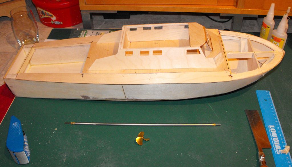

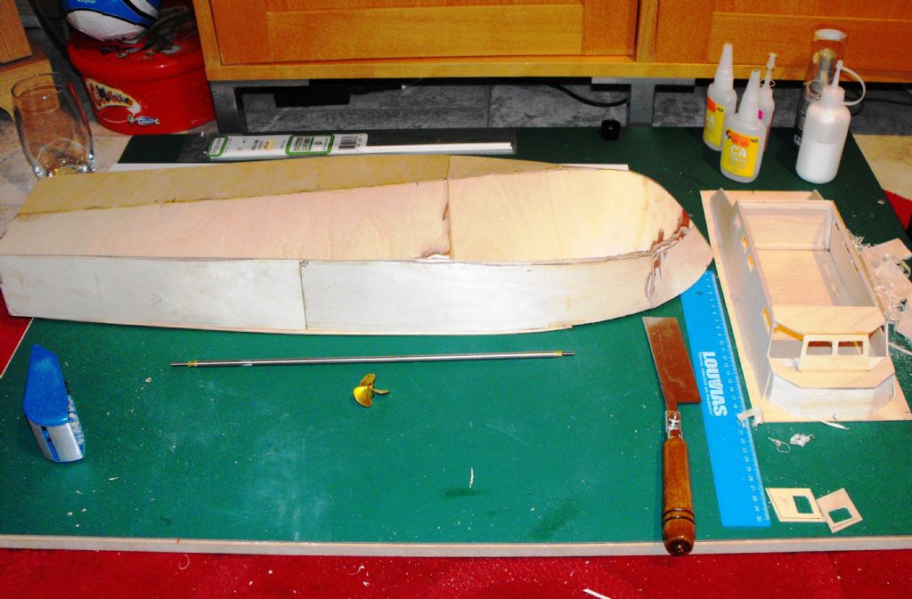

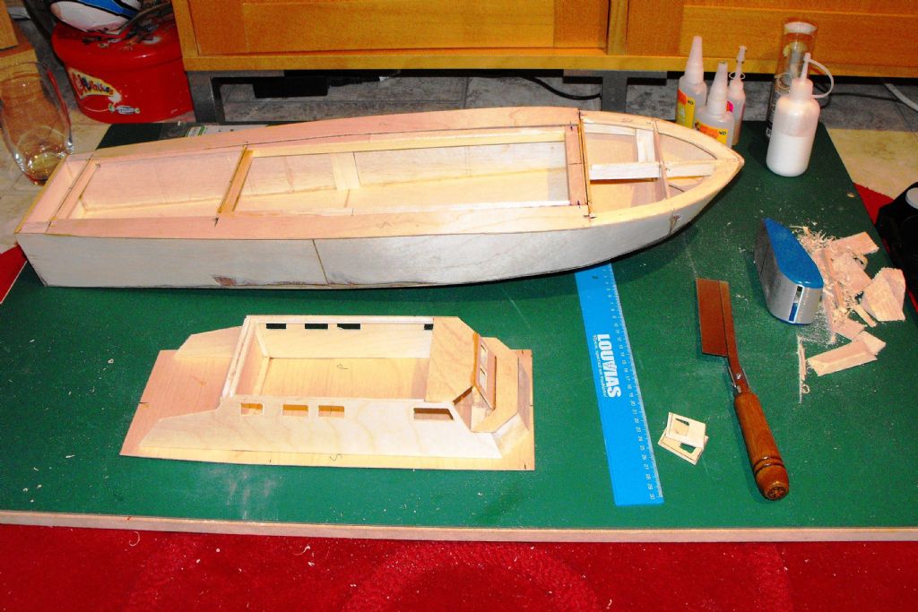

                A company called Kitshack produces the modern version of the Veron Kit as a semi-kit.
                I am building this with my 10yr old grandson with hopes I can entice him away from his computer & Xbox!
                Kitshack Vosper ASRL

                  its looking good so far ojay what are the dimensions on this modern 1? what size motor does it take?

                    and I wonder if it is a complete replica because the hull construction looks very much the same as mine

                      Yes I think it is.
                      It is 27" long, and I haven't got round to deciding on motor size as yet.
                      It is produced as a semi kit by a company called Kitshack. They produce several kits that appear to be copies of the old Veron kits.
                      If mine turns out half as good as yours I will be happy.

                          Ref suitable motor; Ashley's favourite MFA 540/1 on 7.2v would be just fine, with something like a 35mm x 3-blade scale prop. Avoid SLA batteries – too heavy for this model.
