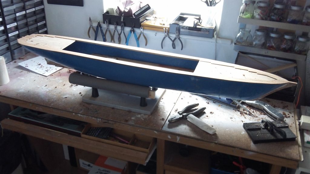

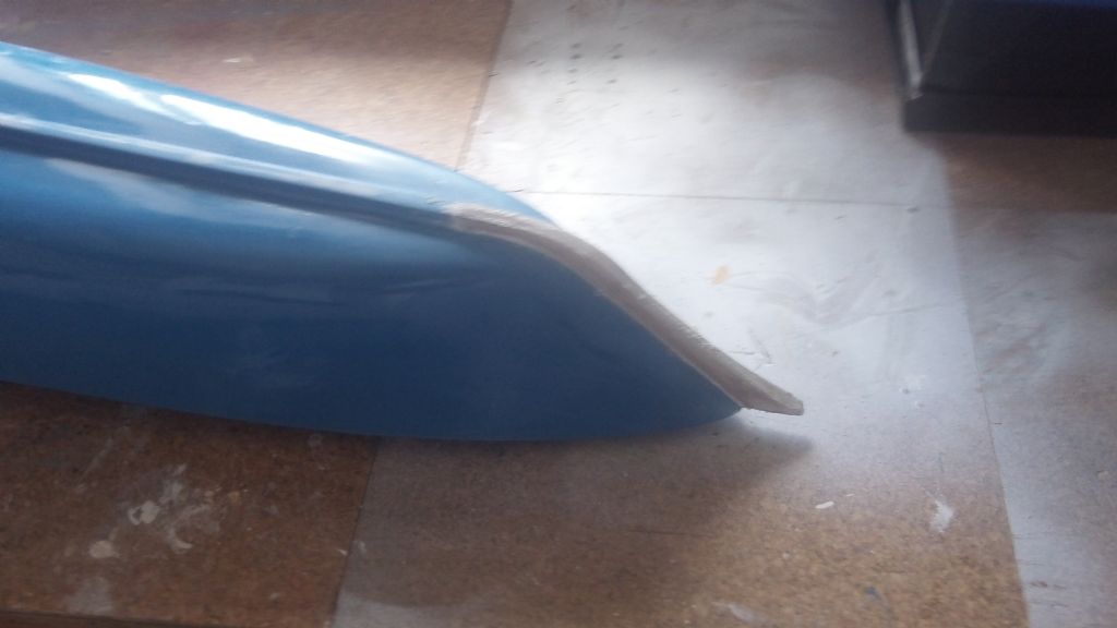

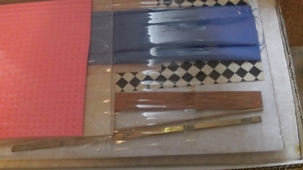

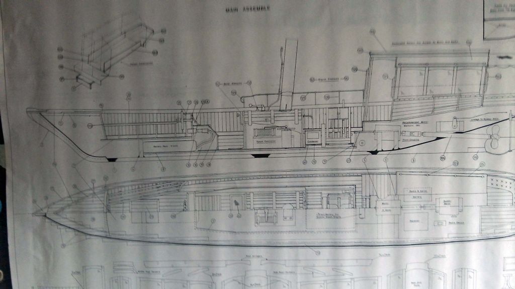

              #49771
              John Raine
                @johnraine98675

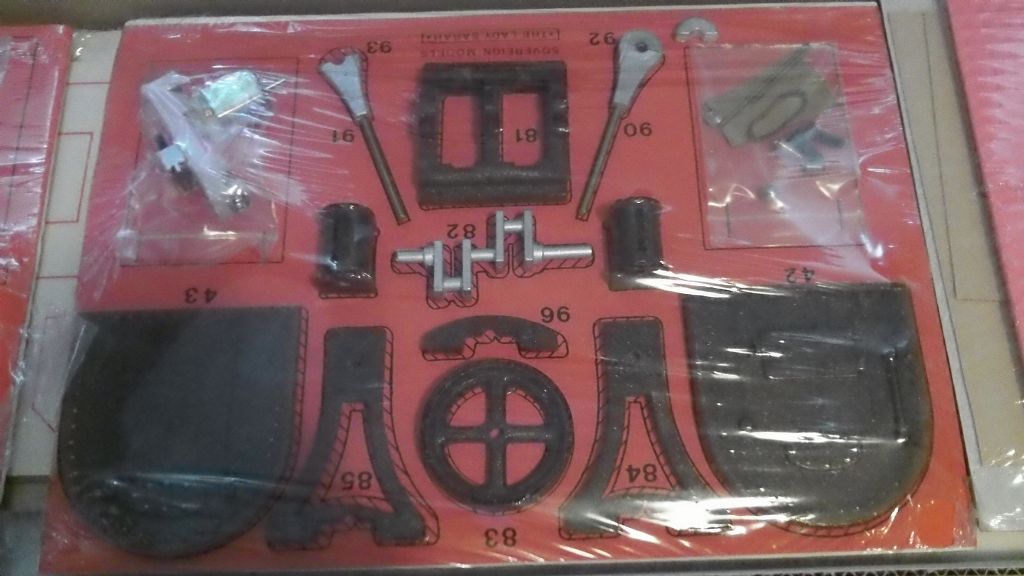

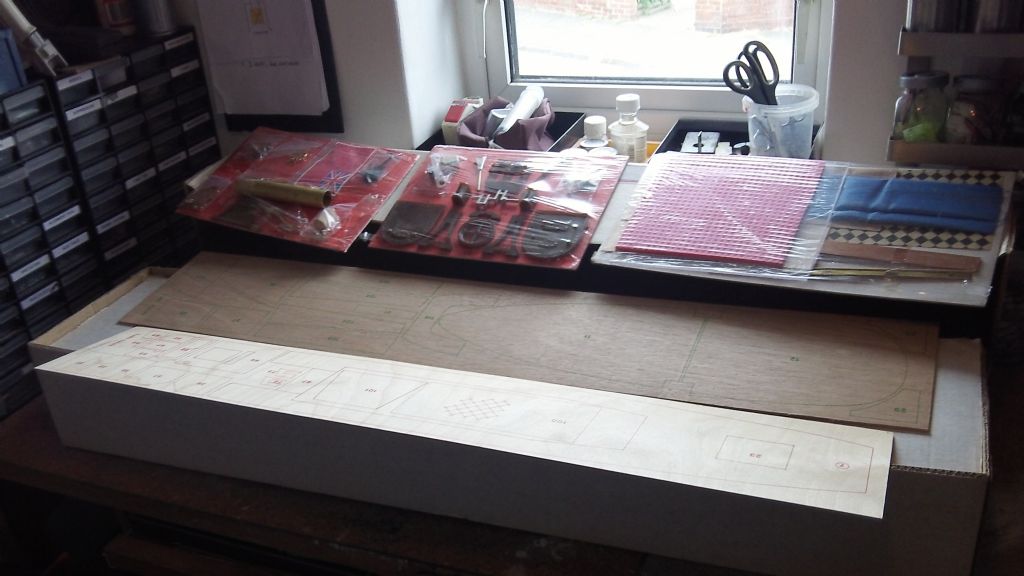

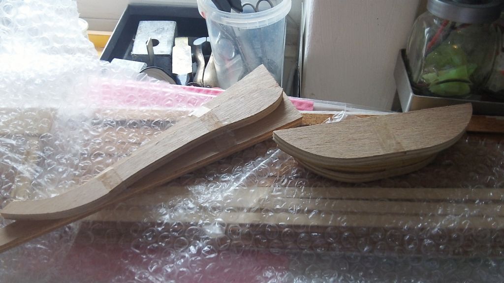

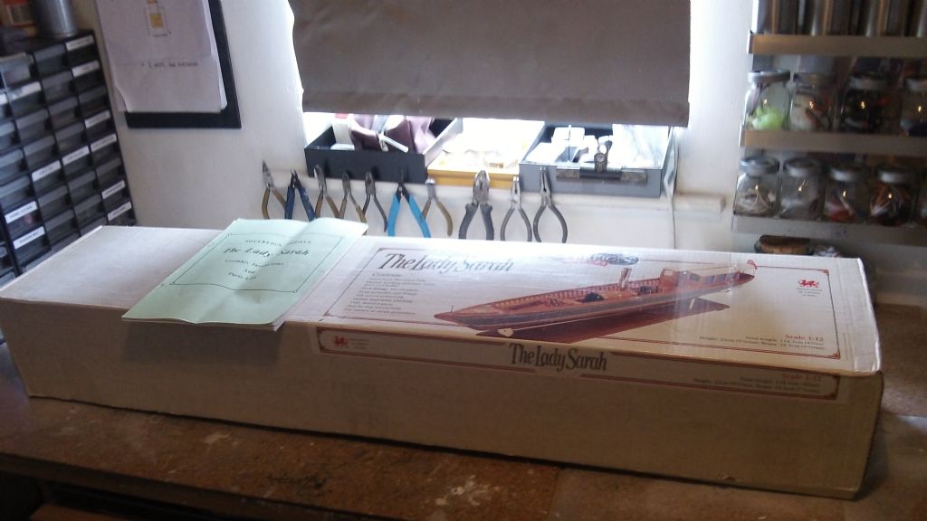

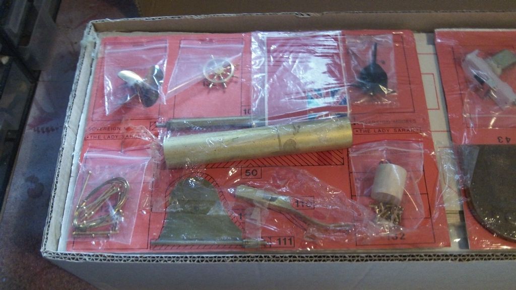

                Just started build, but first some pics of the kit.
                Some info' 1/12 scale. 45 inch Length x 7 1/4 inch beam. Came with a good plan plus a good comprehensive build plan.
                Now remember this came from e-bay so I was not expecting the kit to be such good condition. But what a surprise full kit no missing pieces, no damage (box a bit faded for its age). So a very happy bunny so far…thumbs up

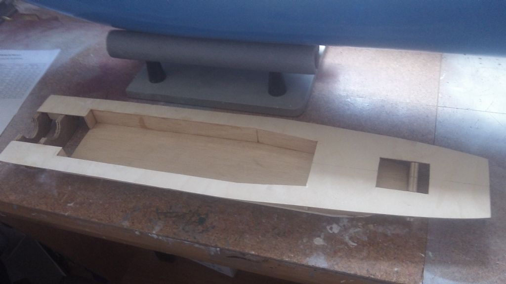

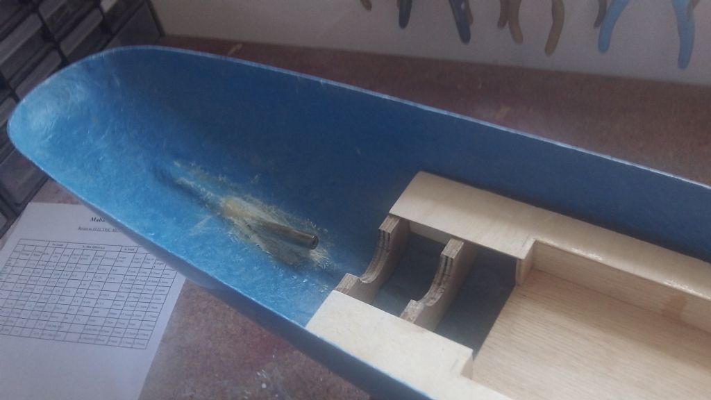

                  #50016
                  John Raine
                    @johnraine98675
                    More to come….

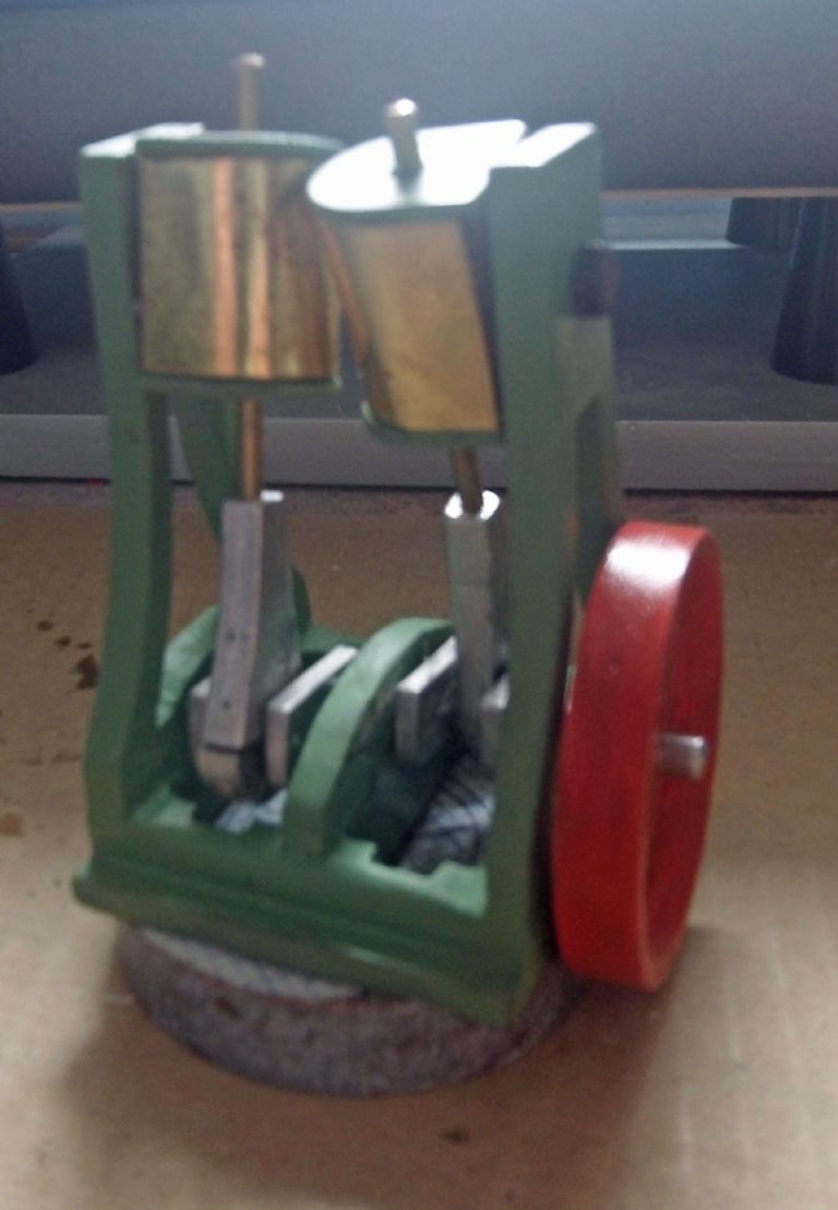

                      The dummy steam engine on youtube see link below.
                      Edited By John Raine on 30/06/2014 21:41:42
                      Edited By John Raine on 30/06/2014 21:42:45

                                        #50076
                                        John Raine
                                          @johnraine98675
                                          Thanks Guys,
                                          Forget to mention the brass prop came with the kit.

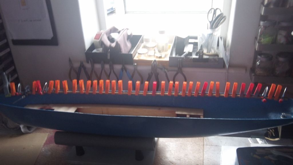

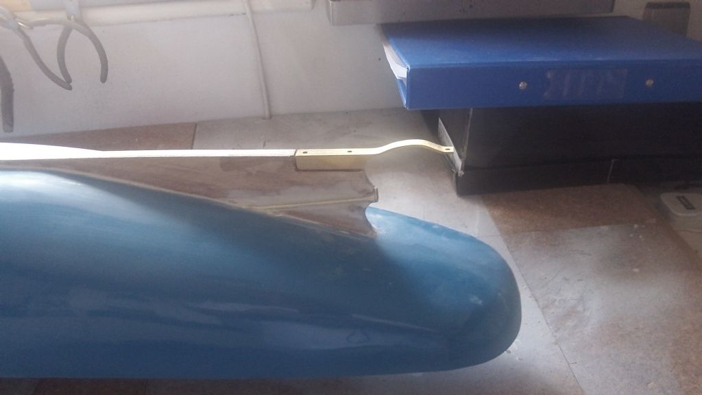

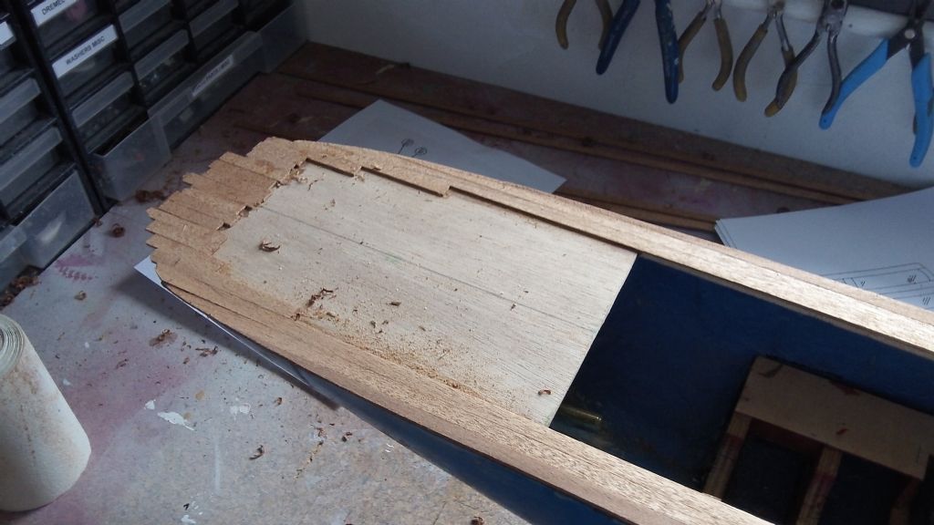

                                          More pics of progress…

                                            #79438
                                            Martin Field 1
                                              @martinfield1
                                              That looks like a very nice kit. But the motor looks a little out of line with the prop shaft currently.
