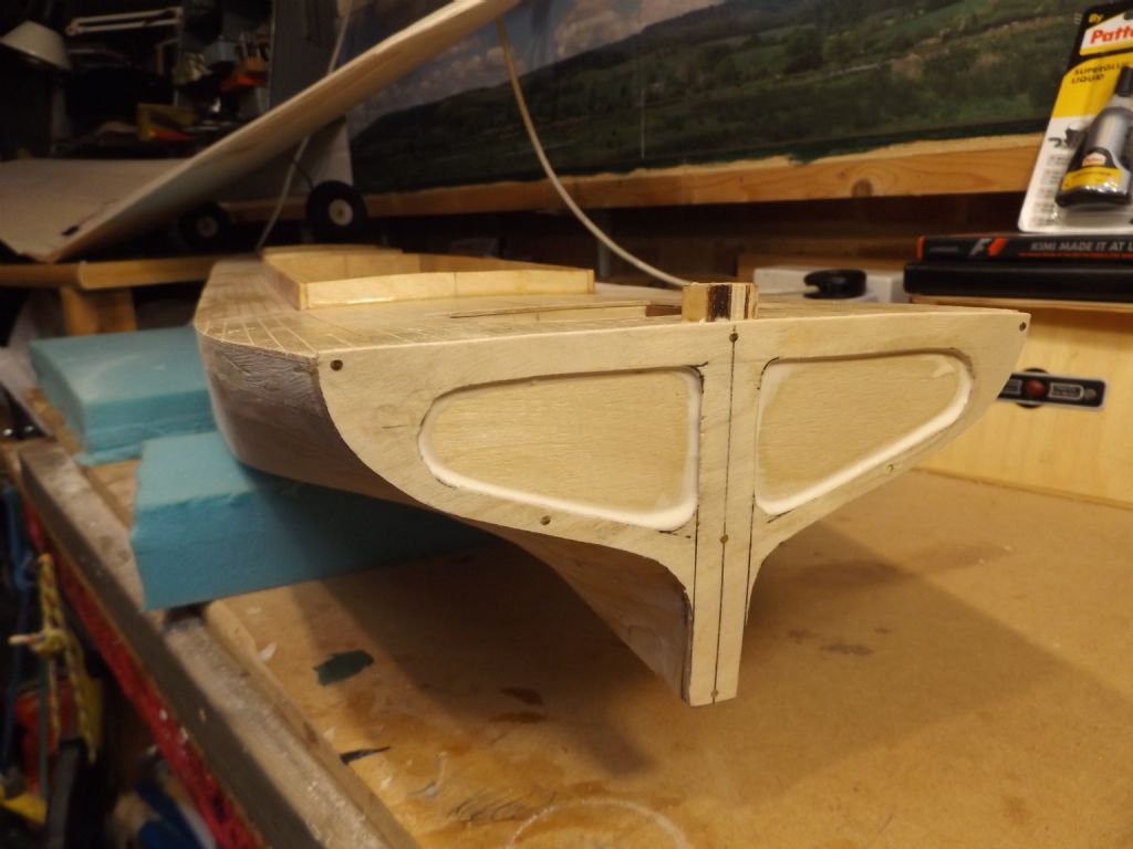

          Just fancied get back to some woodwork last night, so here is the false transom and overlay from 1/16" ply glued and pinned in place, bulwarks next which maybe laminated round some formers.

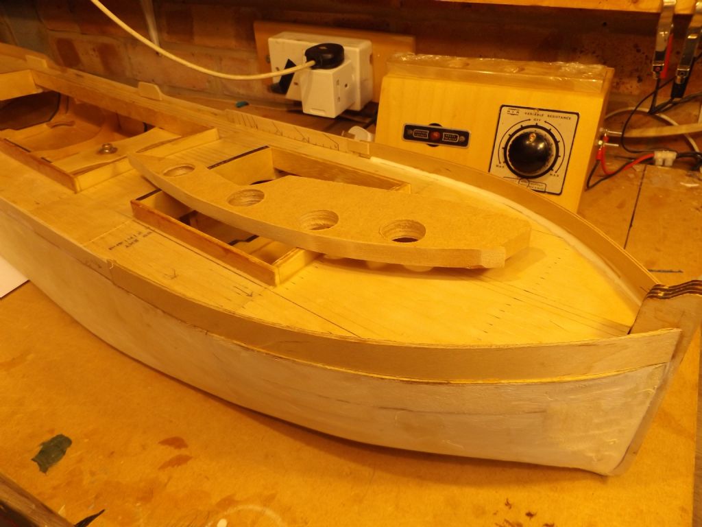

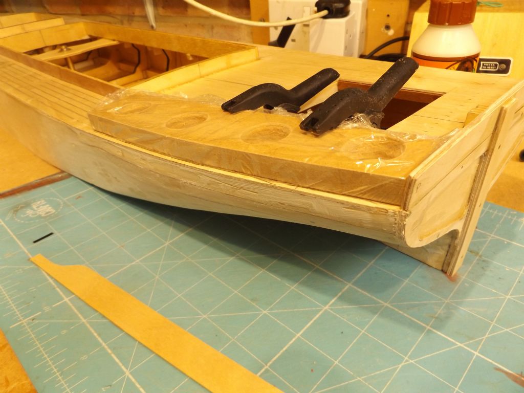

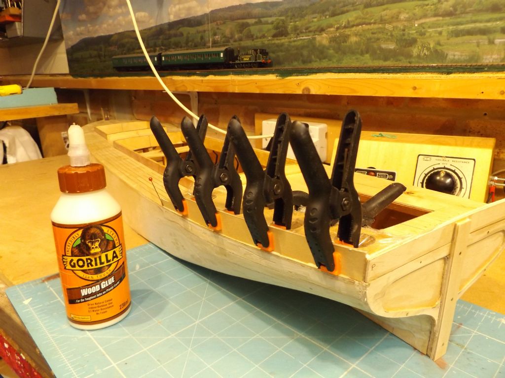

            I like making jigs & templates to make life easier, here is a MDF former cut the shape of the deck with 1" holes drilled to take the clamps whilst the 2 lamination of 1/32" are in position to form the rear bulwarks, on a roll now
            The clingfilm round the template ensures it doesn't become attached to the barge !!

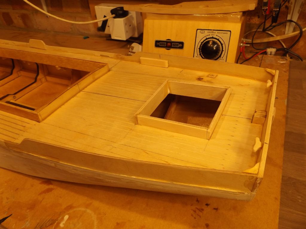

              Veronica progress update, bulwarks complete now with the former used for the laminated bow sections, lesson learned so far – dont give the deck a coat of sanding sealer too early as the PVA Gorilla glue doesn't like it !! had to use epoxy in the end stated with the stern cleats from pine and the rear cabin upstand.
              Pictures to follow, I forgot to upload them !!

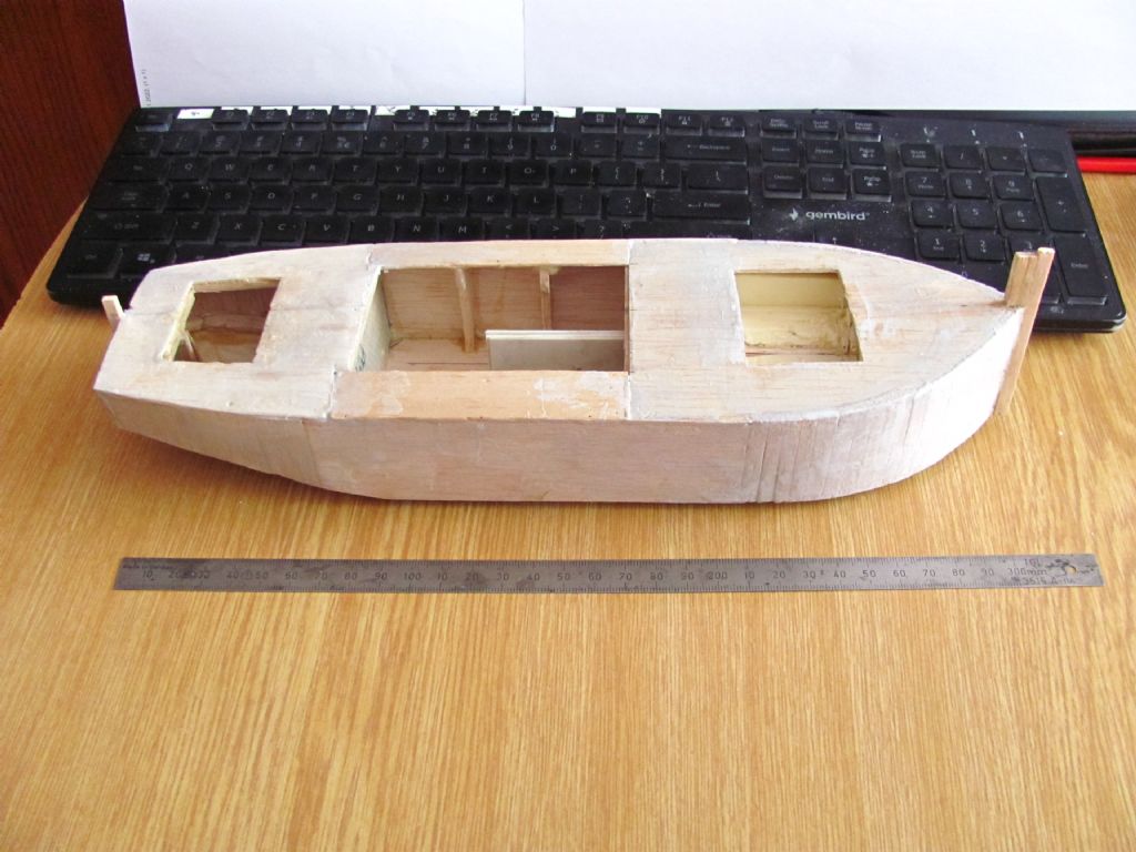

                tomarack
                  @tomarack
                  Hi,
                  I'm slowly continuing to build the sb Kitty model, in Footy class (fun 12 "barge model class).
                  I currently have a finished fiberglas laminated balsa hull. ,in the picture the model before lamination.
                  SB Kitty
                  Breadth: Beam 19.38 feet (5.91 metres)
                  Length: Overall 82.13 feet (25.05 metres)
                  Depth: 6.59 feet (2.01 metres)
                  Tonnage: Gross 79.00
                  The resulting scale for this model  is 1/82
                  Plans for simple Kitty model from Model Boats Magazine.
                  Greetings  !!!
                  Tom
                  more photos are in MB album – "Minikitty"

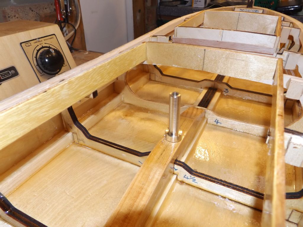

                                        img_20200503_123456.jpgHi All,
                                        As Robert Wagner had asked about the fixing of the removable barge keels, I thought these pics may help, they are both based on a 5mm stainless rod being fixed into the fin or wing keel with standard measurements to the locating pin to keep the keel straight. Here we have both a timber build Veronica and my GRP Portlight barges, it can be a washer soldered onto a tube if you don't have access to a lathe.

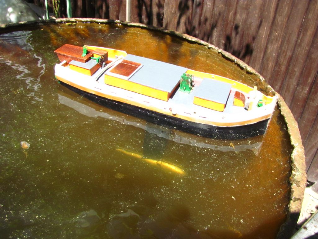

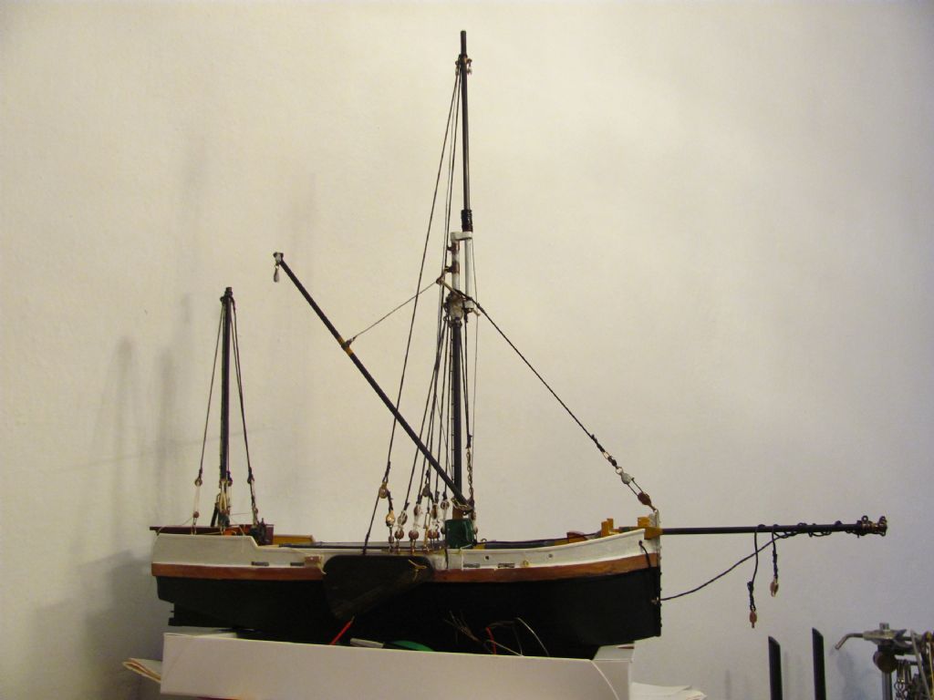

                                        tomarack
                                          @tomarack
                                          In the summer, I did a "swimming" test with my Minikitty model, now I have the rigging left, hopefully,img_4324.jpg the model will be ready over the winter. I put the photos in the album here, I also added some photos of the construction progress to my Piscataqua gundalow album..
                                          #104585

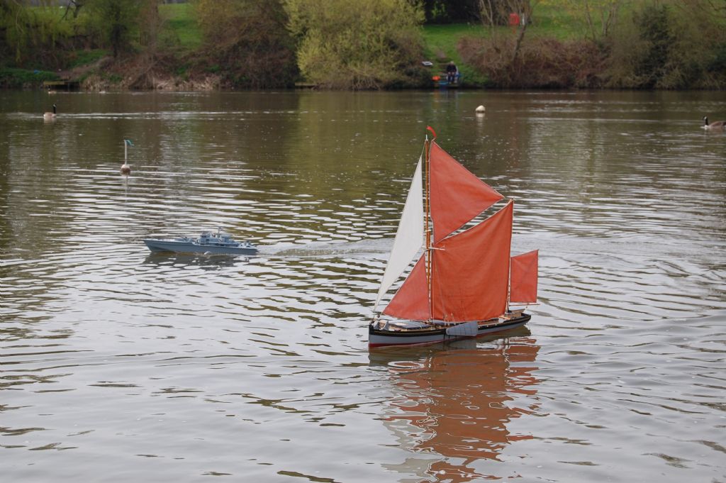

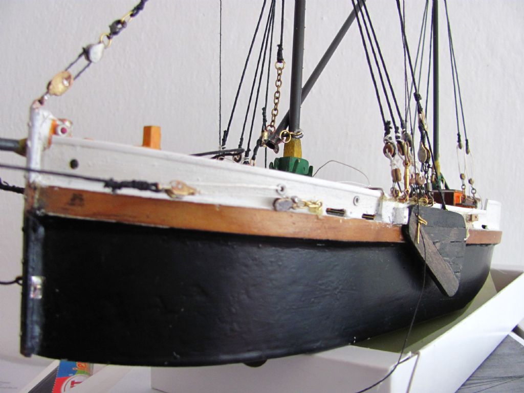

                                            Good to get Veronica back on the water for the first time in 2023, she has been in my ownership for 8 years since I bought her from Peter Simmonds, although I have built a few boats over the years but she remains my favourite
                                            Not much breeze at all this morning at the Mote Park lake Maidstone Kent, home of the Cygnets MBC , a good turn out of members, glad to have some reasonable weather, the sailing section are having a get together next Sunday 23rd to promote the sailing section activities.
                                            I just remembered I have Portlight to rig & another Veronica to finish !!!
                                            #104595
                                            tomarack
                                              @tomarack
                                              Hi,
                                              According to the calendar, we have spring here, but according to the weather it's still winter with morning temperatures below 0°C.No suitable surfaces for sailing now.
                                              I have made some progress in building the MINIKITTY, but the work is going slowlyimg_5080.jpg

                                                  tomarack
                                                    @tomarack
                                                    Hi Ray,
                                                    I'm mainly curious to see how Minikitty will sail.
                                                    My wife resolutely told me – "this is your last ship…. you have several models of boats, so go and finally put them on the water.".well.. she's probably right…
                                                    A long time ago, I tried building model airplanes, but I wasn't very successful. Today, airplanes are really fast for me. I can still control the ships, especially the slower ones.
                                                    What I have .. a Lulonga 1:32 paddle steamer model,,(quarterwheeler)img_4901.jpg a small motor model completed last year(50 cm long), then two 1:24 barges, and finally two Footy sailboat models .. and now basically finishing the Minikitty as the third Footy class model.
                                                    greetings
                                                    Tom
