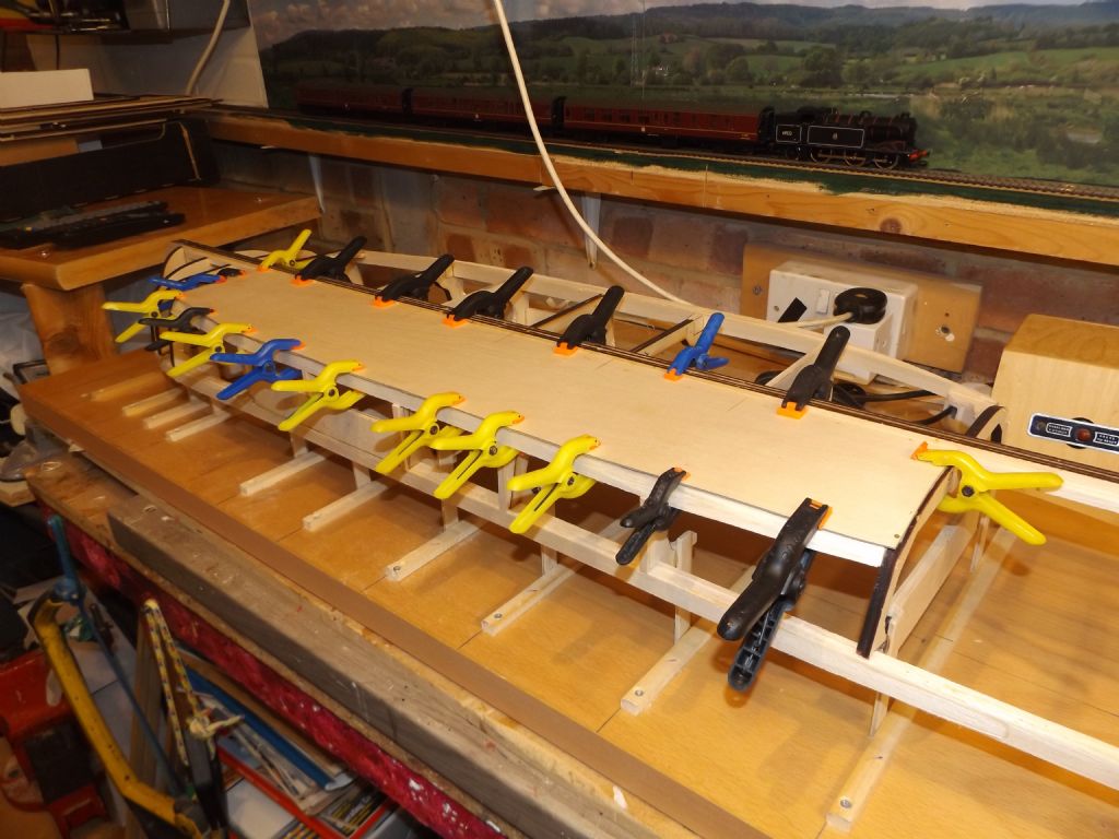

        Well the first ply bottom panel is straight forward as with many clamps it's easy to hold in place but the second panel needed to be tacked along the keel with brass pins while the glue sets, the holes pre-drilled no. 70 drill helps the tacks not to bend as they don't like being driven through 1/16" ply
        Pictures in the wrong order !!

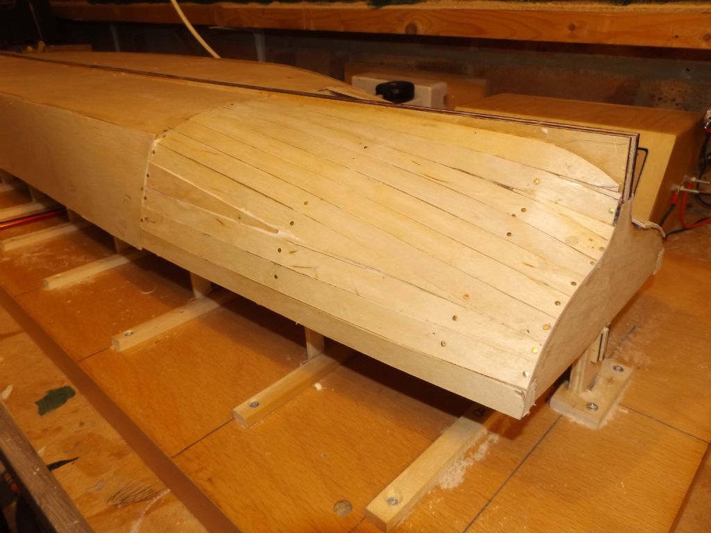

                    Well to round off the weekend I have been planking with 1/16th ply cut into 1/2" strips, not pretty but once filled with P38 and glassed inside we are getting near to having a barge hull

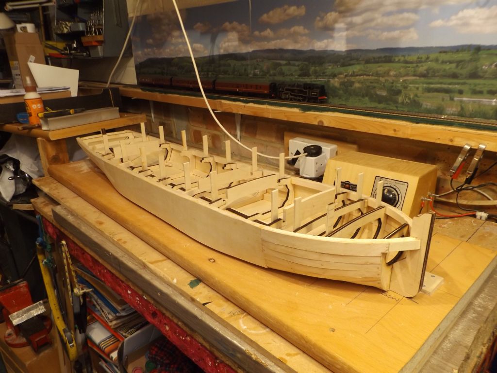

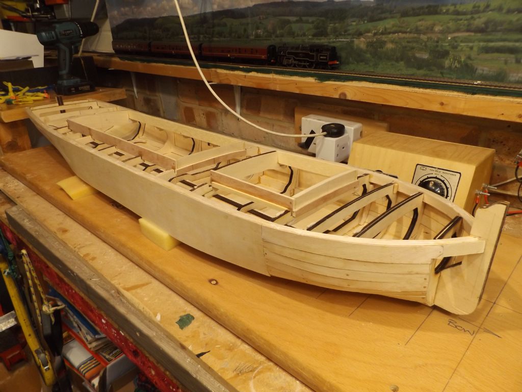

                          Progressing on with the frame extensions having been cut off, and the main and fore hatch sides in place, which starts to give the hull some more strength, there are quite a few bulkhead doublers to install to receive the deck. I want to locate the keel fixing tube position next from my original Veronica built by Peter as she is going to have the GRP winged keel moulded by Mastman, who can supply most of the fittings If you need them.

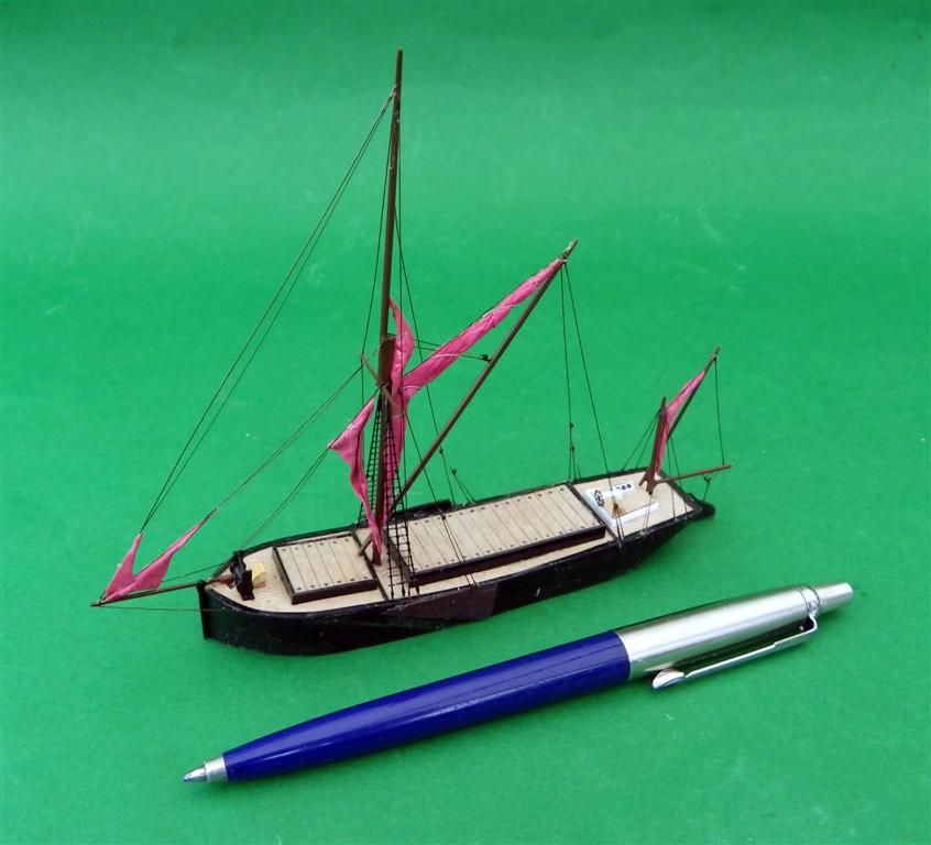

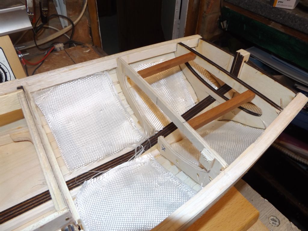

                                    ver 9 240122.jpgver 10 240122.jpgHi All,
                                    Thanks Bob she's a little beauty ! I think I'm going to need a bigger pen for 1/24th scale
                                    Quite productive building weekend, grotty weather as usual so cracked on with the woven glass cloth & polyester resin to the internal bow & stern planking messy horrible business, but to tight to buy West epoxy !! @ £45.00
                                    The keel support tube turned down from 5/8" brass bar with a shoulder to stop the keel falling out, drilled M5 clearance for the stainless studding in the wing keel, this will also have a cross brace with a washer soldered on to form a handle for lifting the weight of the barge's 6 lbs keel, the hull currently weighs in at 3 lbs.
                                    Fitting the deck panels next which is straight forward but scribing the 6" wide planks in the ply at 1/4" intervals is tedious but will be effective in the end I hope

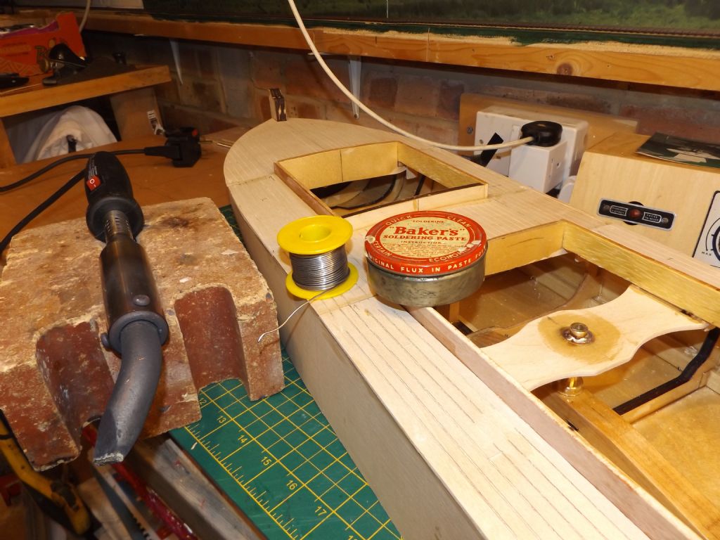

                                        This is probably the main structural element of the whole build so far is the ply cross brace which makes a good carrying handle with the main hatch cover off, the 300watt soldering iron made short work of attaching the brass washer to the turned tube which helpsver 12 270122.jpg take the load of the keel.
                                        (The Bakers Flux paste is probably as old as me !!)

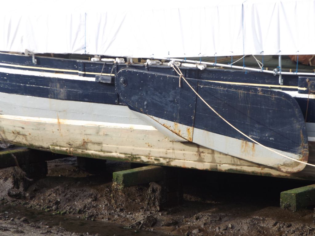

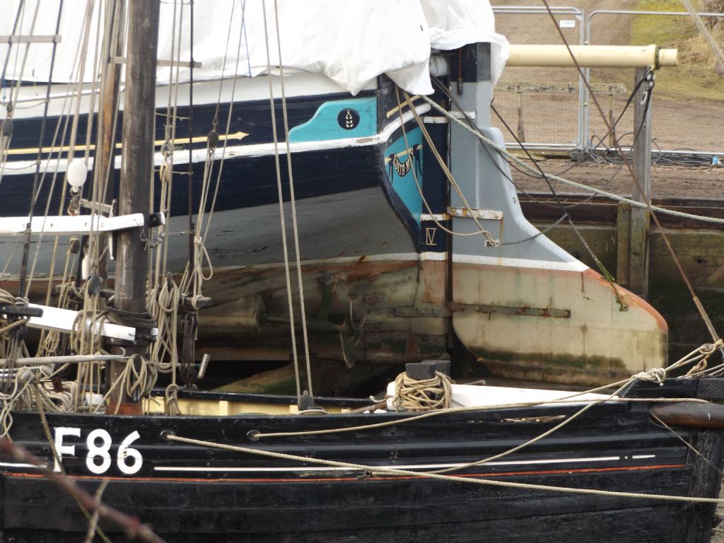

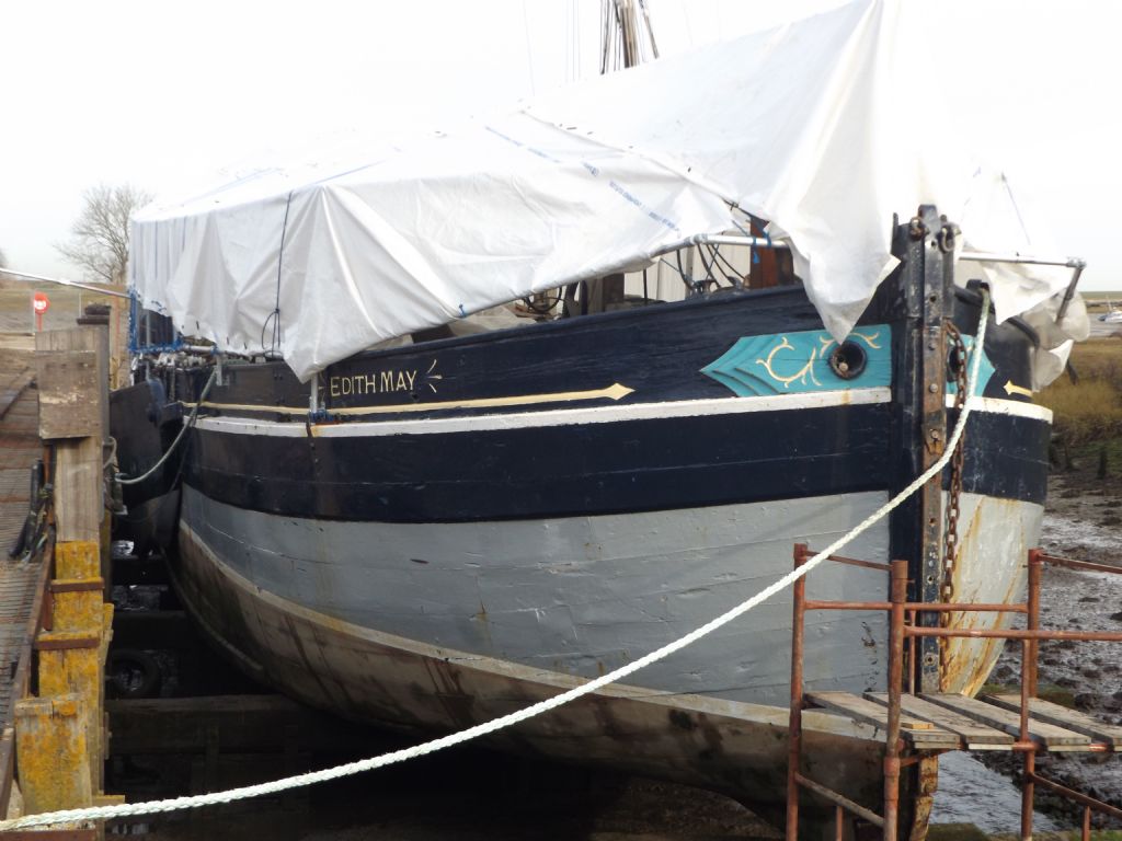

                                          Some times I have to get out and see a real barge to remind myself how impressive they are and take a couple of snaps
                                          Here is Edith May owned and operated by the Gransden family, based at Lower Halstow on the tidal Medway, she is protected under her winter cover from the rain, which I believe is most harmful to the deck and upper works, she is sitting up on her blocks and looks quite cosy waiting for the spring, as we all are

                                            Looks like she could do with a repaint though Ray before going back in the water?
                                            #99303
                                              Hi Chris,
                                              She's floating twice a day on the tide, the blocks give give her a nice level platform to sit on rather than sitting in the mud berthlh5 280122.jpg, I'm sure she will be spruced up around Easter, as she races regularly during the summer.
                                              I've seen on Facebook the Brightlingsea Model Boat Club have model sailing barge racing on the 1st Sunday of the month visitors welcome, which will be worth the trip for me, as they are on the coast there should be a good breeze

                                                Edith May is owned by the Gransden family but they have set up a not-for-profit company to operate both her and their smack Thistle, which is called Tiller & Wheel. They are trying a new funding arrangement which involves "patrons" making a monthly subscription payment via Patreon which then gives sailing opportunities. They are also trying to widen the support base for barges by offering free trips to people – especially families -in the hope that they will become patrons and get children involved. Lowest level of "patron" is just the cost of a cup of coffee per month, i both sail on barges and make models, and I think they deserve support. Details on the Tilller& Wheel website http://www.tillerandwheel.com
                                                #99318
                                                  ver13 300122.jpgThanks Steve,
                                                  I think I may become a patron, as I can only imagine how expensive the upkeep must be !!
                                                  I used to race dinghies at the Medway Cruising Club with Geoff Gransden back in the 80's, but all of a sudden that's 40 years ago !!

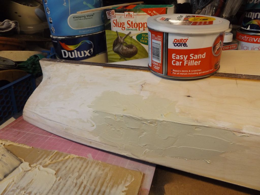

                                                  The Veronica build is getting there but I'm not a fan of the suggested ply planking which I did, it has needed lots of car filler and a power belt sander to knock into shape in the outside building facility (Shed).
                                                  If I get round to producing a build plan for a 30" Westmoreland I will use Styrofoam for the bow and stern & glass cloth it, maybe 2024 project ?

                                                    I have to say … styrofoam needs – to use your own words – belt sander and lots of car filler too.
                                                    Moreover … those brushed polystyrene balls have an electric charge and hold on to everything … but I still use this material a lot…but the work is fast. I mainly use extruded polystyrene, it is harder and has a finer structure. It works better than conventional soft polystyrene…in addition, it is easier to shape.
                                                    I use polyurethane wood glue for gluing polystyrene (and almost everything). In our country, it is the Soudal brand, slightly foaming.

                                                      I use the grey close grained Styrofoam these days because it's easy to cut & sand, for many years I used BlueFoam insulation for aeroplane building as I'm in the building trade and easy to liberate a few sheets, but seems to not be available now , now the foam I use is relatively expensive from an architectural modelling supply company in London.
