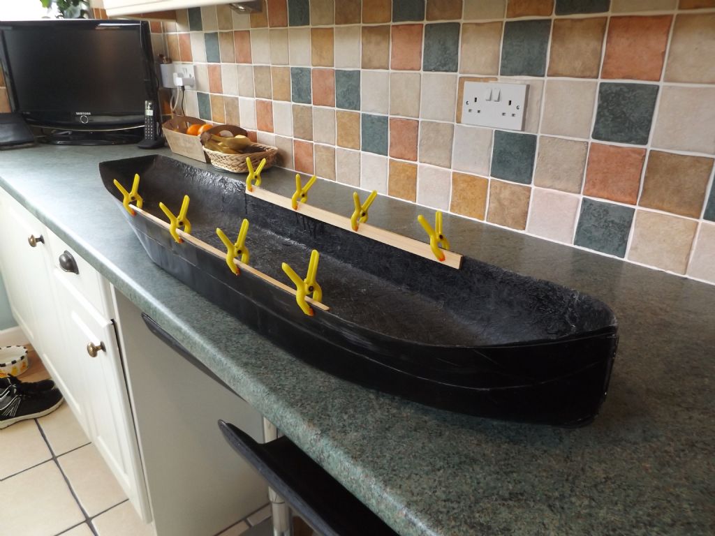

                    portl 1 bow.jpgMorning All,
                    In my attempt to bore everybody and as a couple of my other projects are at the painting stage and realising how much I am missing the AMBO barge racing, I thought at the moment with furlough time on my hands something rather more time consuming was required, and I need a barge with a bowsprit, so happy days
                    A couple of years ago I acquired a 1/24th a hull for TSB Portlight from Dave Watts (Mastman) who has a fabulous range of hulls and all the fittings you may not want to make. The hull came with a CD with drawings of the fullsize barge and rig, but no model information, which is fine by me as I have Staysail rigged Veronica built by Peter Simmonds as a bench mark and a smaller 30" TSB Giraldaimg_20200429_163601.jpg which is earlier on this thread.
                    There are a good set of photos of Portlight online she is not in commission currently.
                    The first stage is to establish the setting out of the hard points required for the rig ie mast, shrouds and keel position as Veronica is a known quantity I'm using her dims as a guide, and she's fast
                    I will be bonding some spruce strips to the sides and have marked the centre line on the bottom of the hull and marked the keel bolt hole position, I have a spare bulb keel and will be using it to save time.
                    Please jump in at any time !!

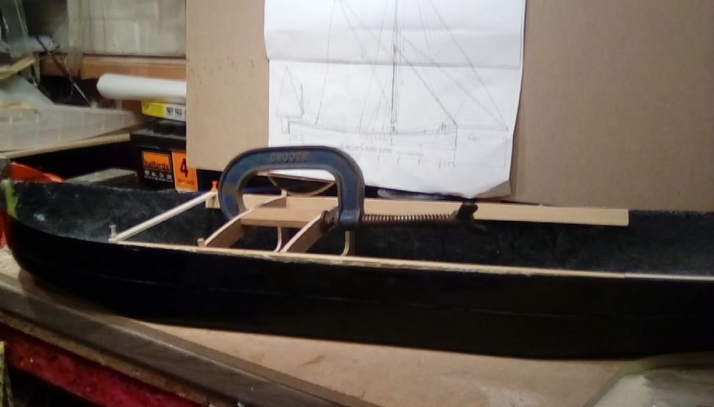

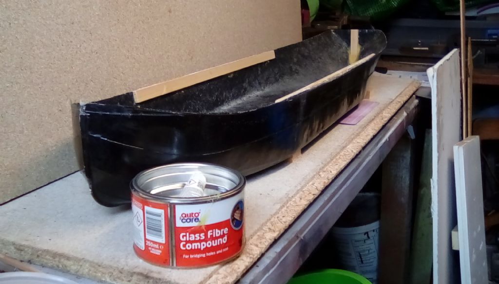

                            Not much progress today 😯managed to bond a couple of lengths of timber for the inwhales and an internal stern post with some fibre glass compound from Wilko's must be 5 years old and jolly glad it set !! Will be making some card templates for 2 internal bulkhead s Fore & aft of the mast position.

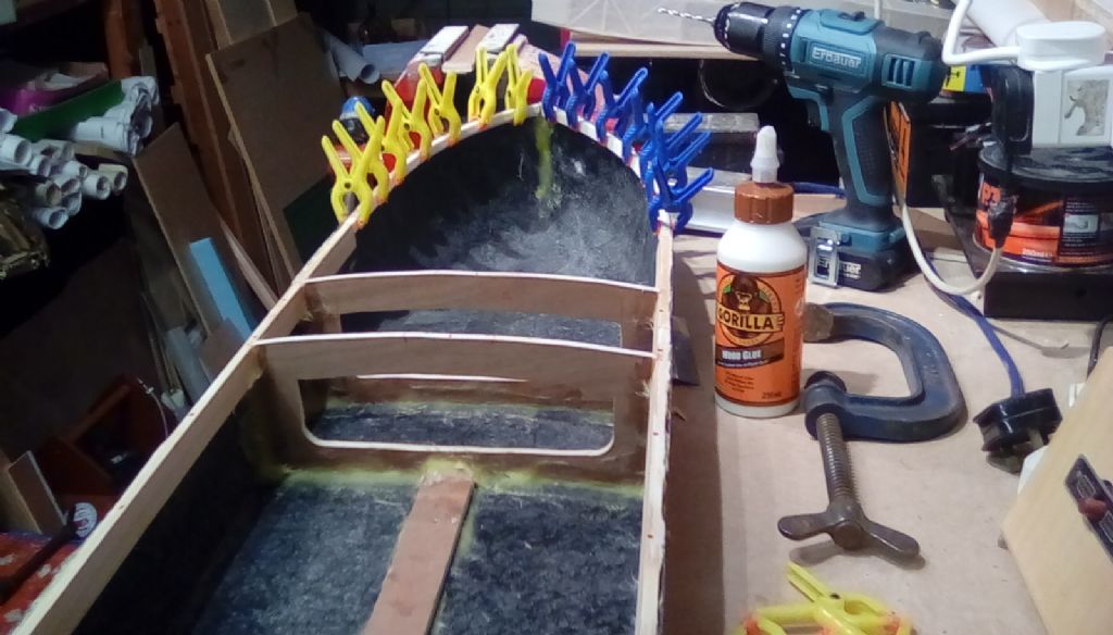

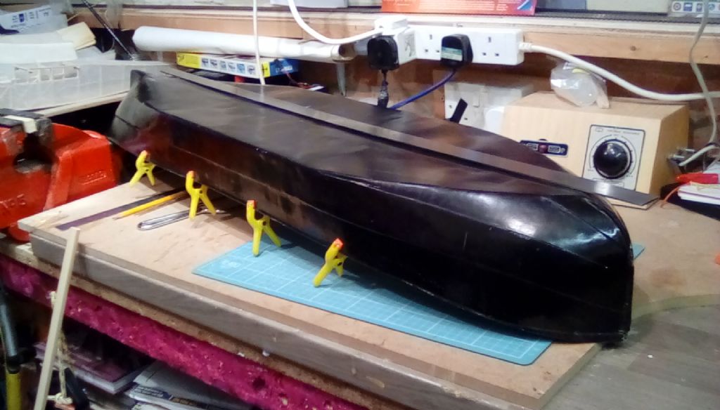

                                        Back to the tsb Portlight, bulkhead's clamped and tacked on position with the mast support and one of my smaller gee cramps , using balsa laminated inwhales round the curved sections for attaching the deck later. Bonded the bulkheads and keel plate all 1/4" ply , now thinking of the shroud attachment points from sheet brass, as Portlight is constructed with steel I don't think she would have external chainplates like a wooden barge ? ?

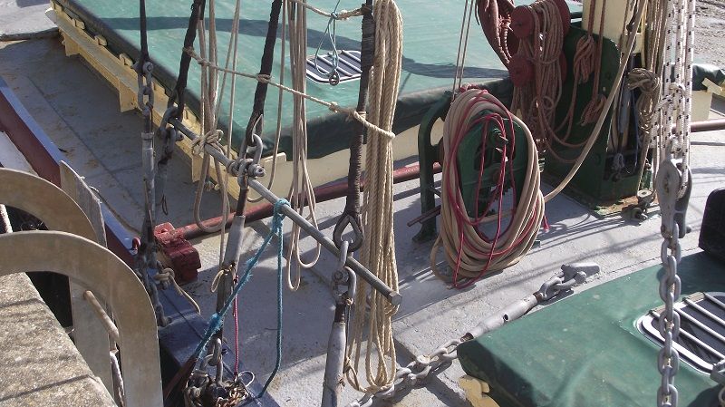

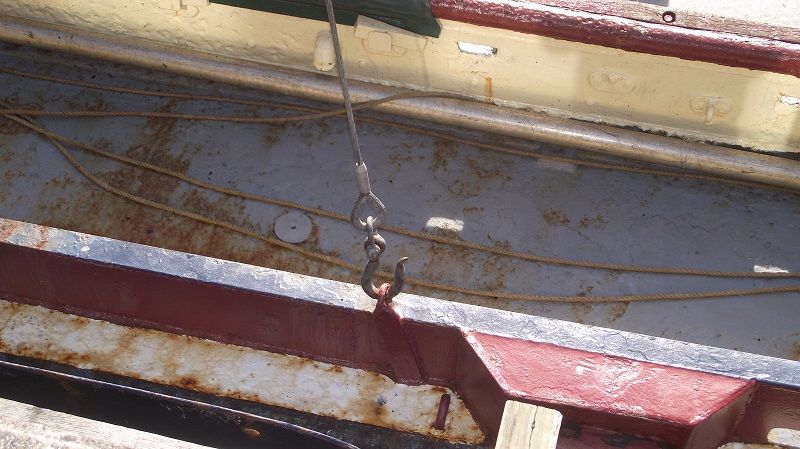

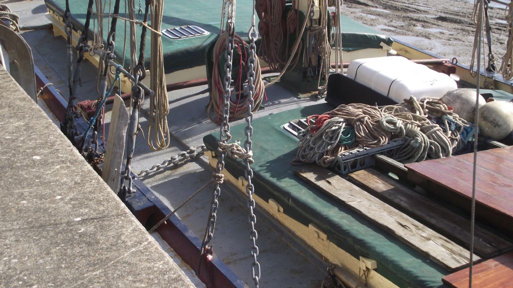

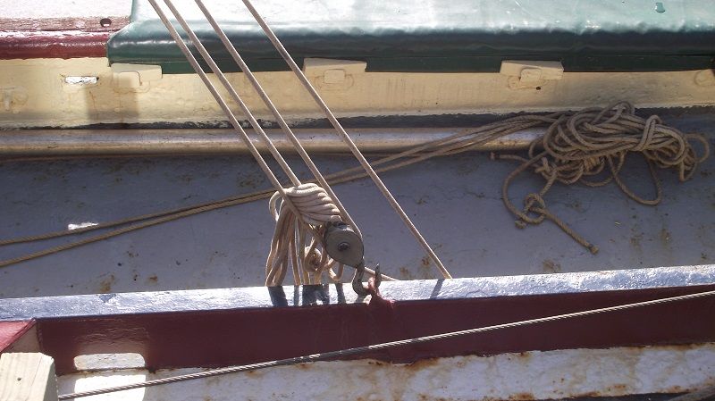

                                                  Good Morning Ray, Do these help, they are pictures of Reperter at Faversham.
                                                  Regards.
                                                  Eddie.

                                                      Eddie,
                                                      You are a life saver with your photos as we can't just pop down to Faversham to see her, but Tim R was right the shroud attachment points seem to be built into the bulwarks, and as they will be fitted after the deck I will put some brass tag fixing points along the gunwhale. I think is important to get all the structural works right.
                                                      TSB Defiance appears to have extensions to her frames, but she is relatively new.
