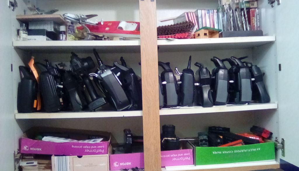

                                    But has it got a 25 model memory ?? I have, but have trouble remembering where I might have put the model😄
                                    That's only half of them !

                                        OMG Ray. That’s a bit of a stressful shelf.
                                        I hope you have them marked up to models. How do you keep up to the batteries?

                                          Hi Brian,
                                          I have shares in Duracell 😄 and I bought a Dymo label maker £3.99 in Aldi 👍😄 is brilliant all tx's labelled and when the batteries were new, my Radio Link set for my sailing barge are 2 years old. Interesting to note the Dymo machines are £32.00 in WH Smiths ???????I
